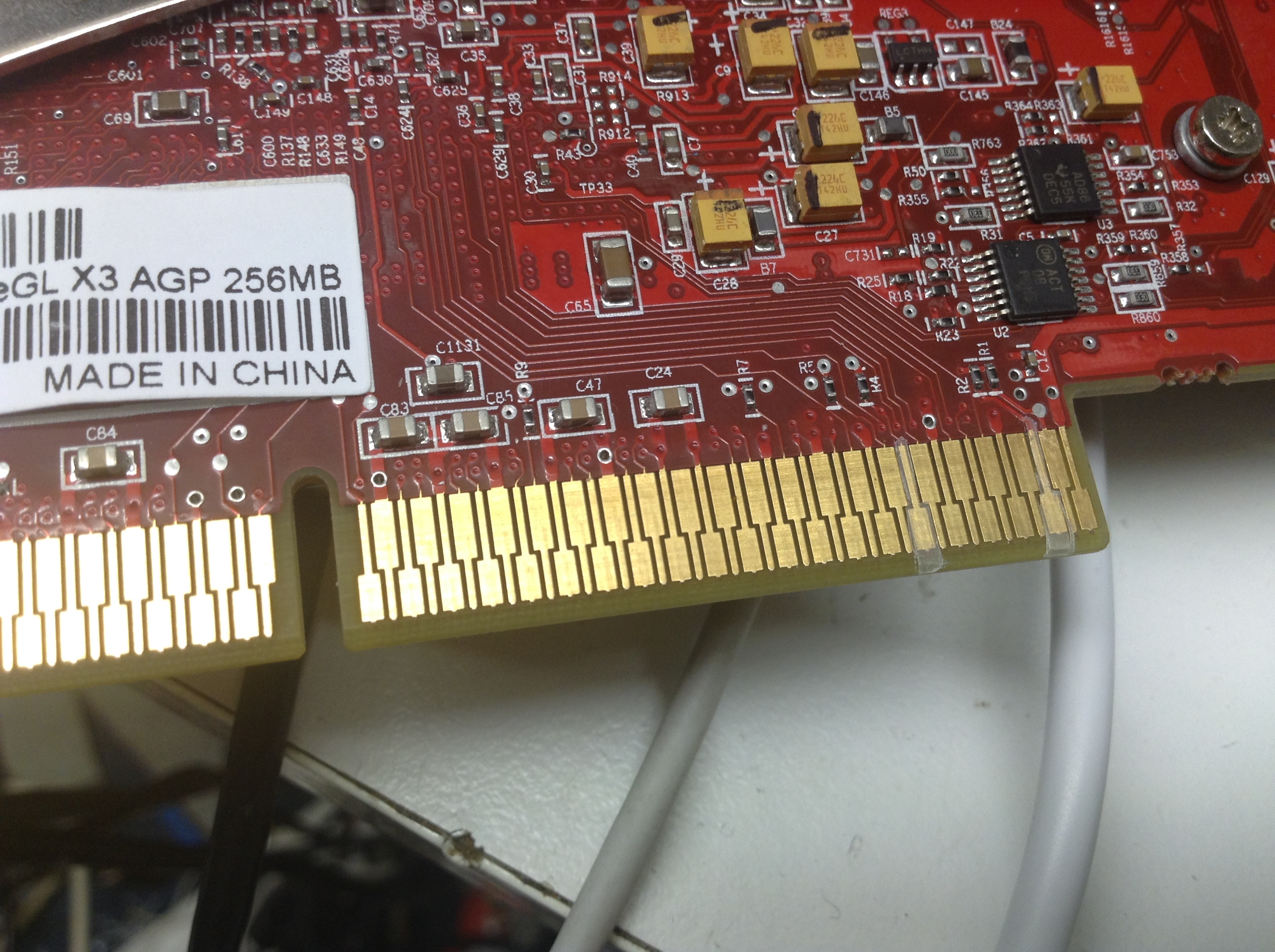

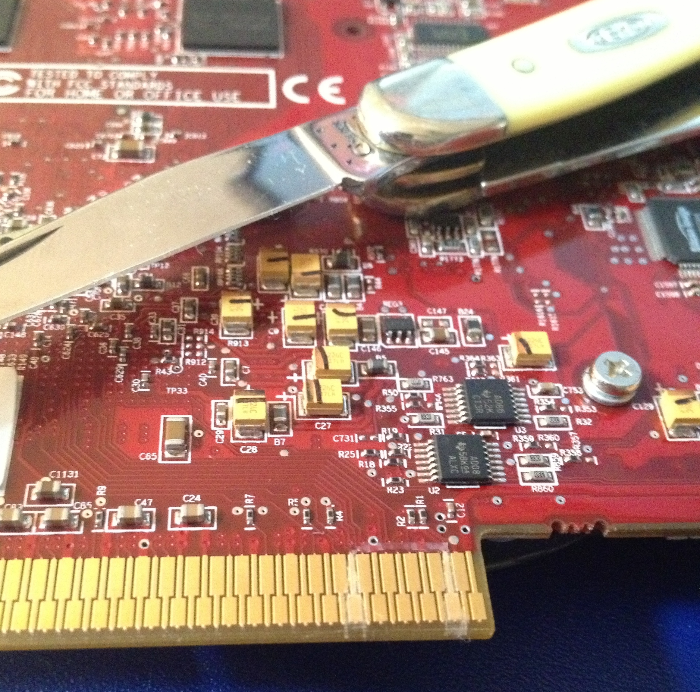

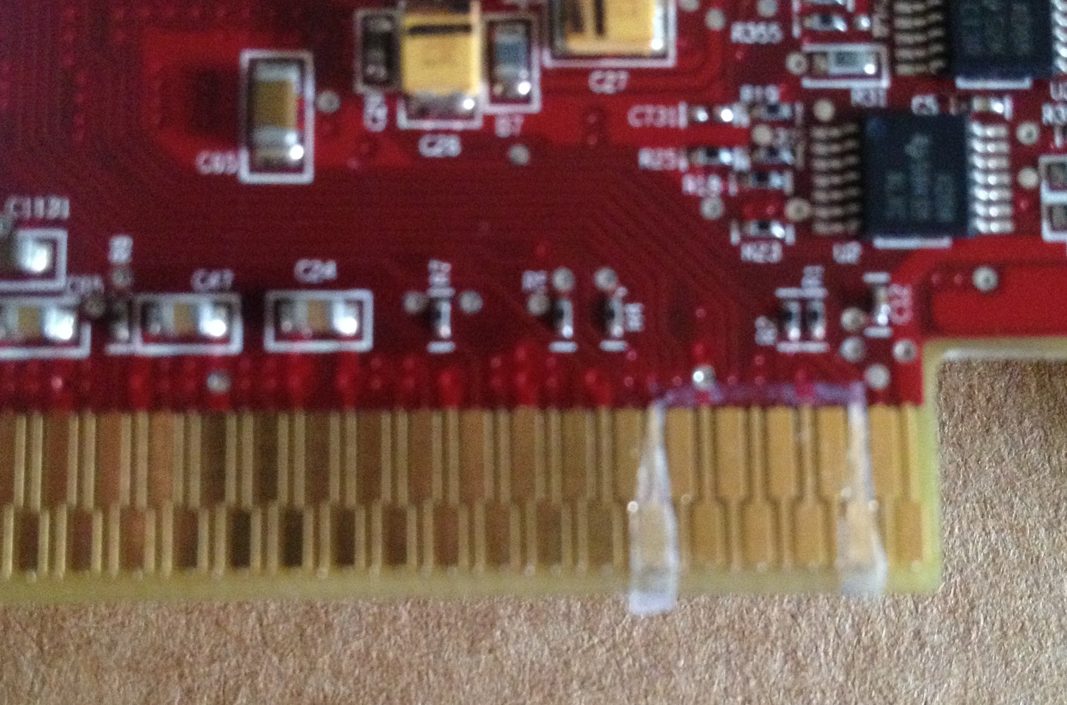

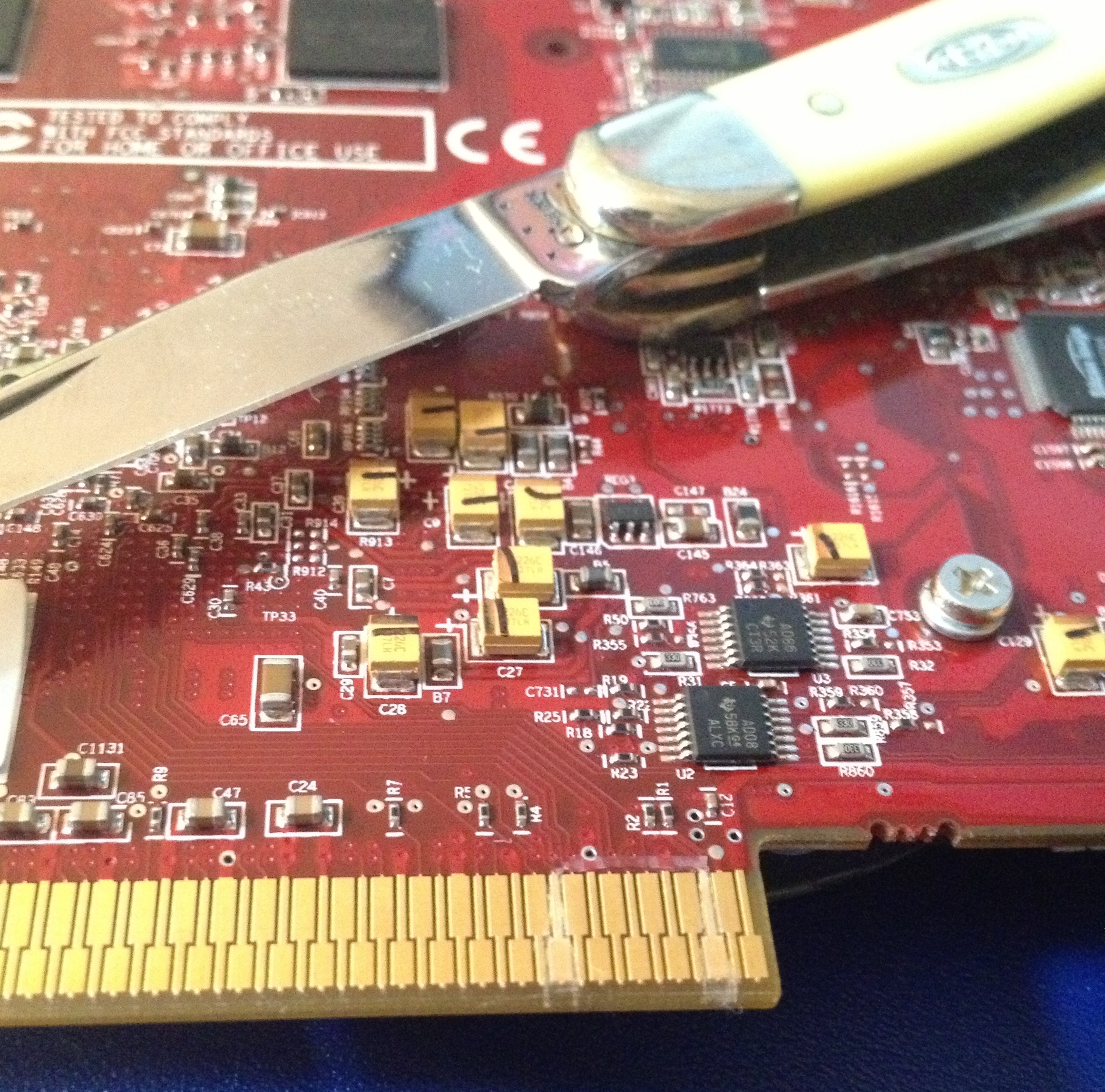

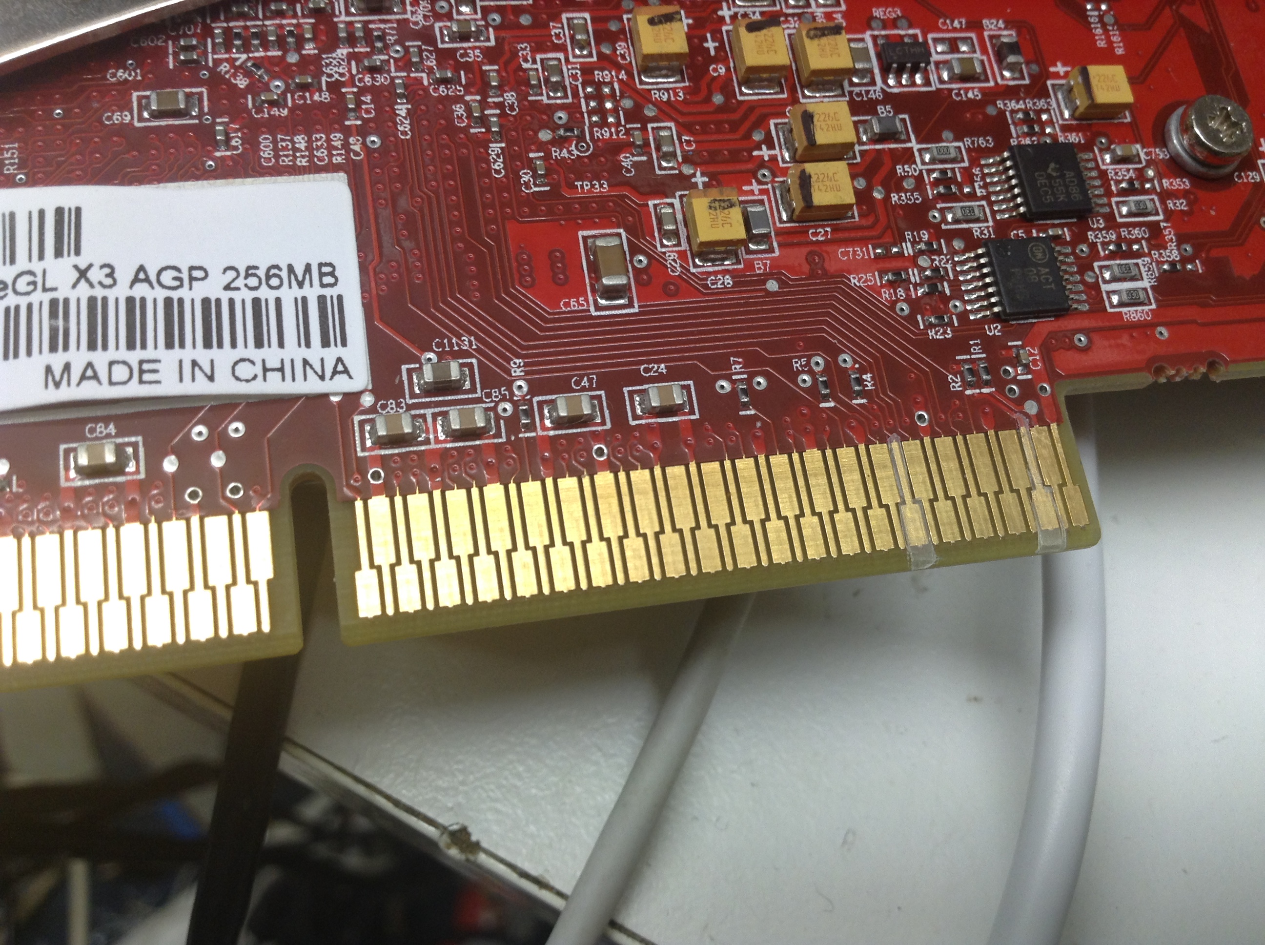

Here's my current tape job on the FireGL
I looked at ur Picture it looks mostly fine but I think the tape on Pin 11 is slightly over lapping to pin 12 by a bit and also it extends past the pin and PCB into free air thats not good either cut it off or stick it down I will also attach a picture of the tape Job on my FireGL X3 and as I said Before Also Try Cleaning your Cards Pins and Your AGP slot.
Okay, I cleaned up the tape on pin 11 a little bit. Unfortunately, any further testing will have to wait. I'm in the process of replacing the hard drives in this computer, and am cloning Leopard from its current 120gb drive residence to a 325gb partition on a lightly-used WD Caviar Blue 500gb drive that I've been meaning to put in this computer for a while 🙂

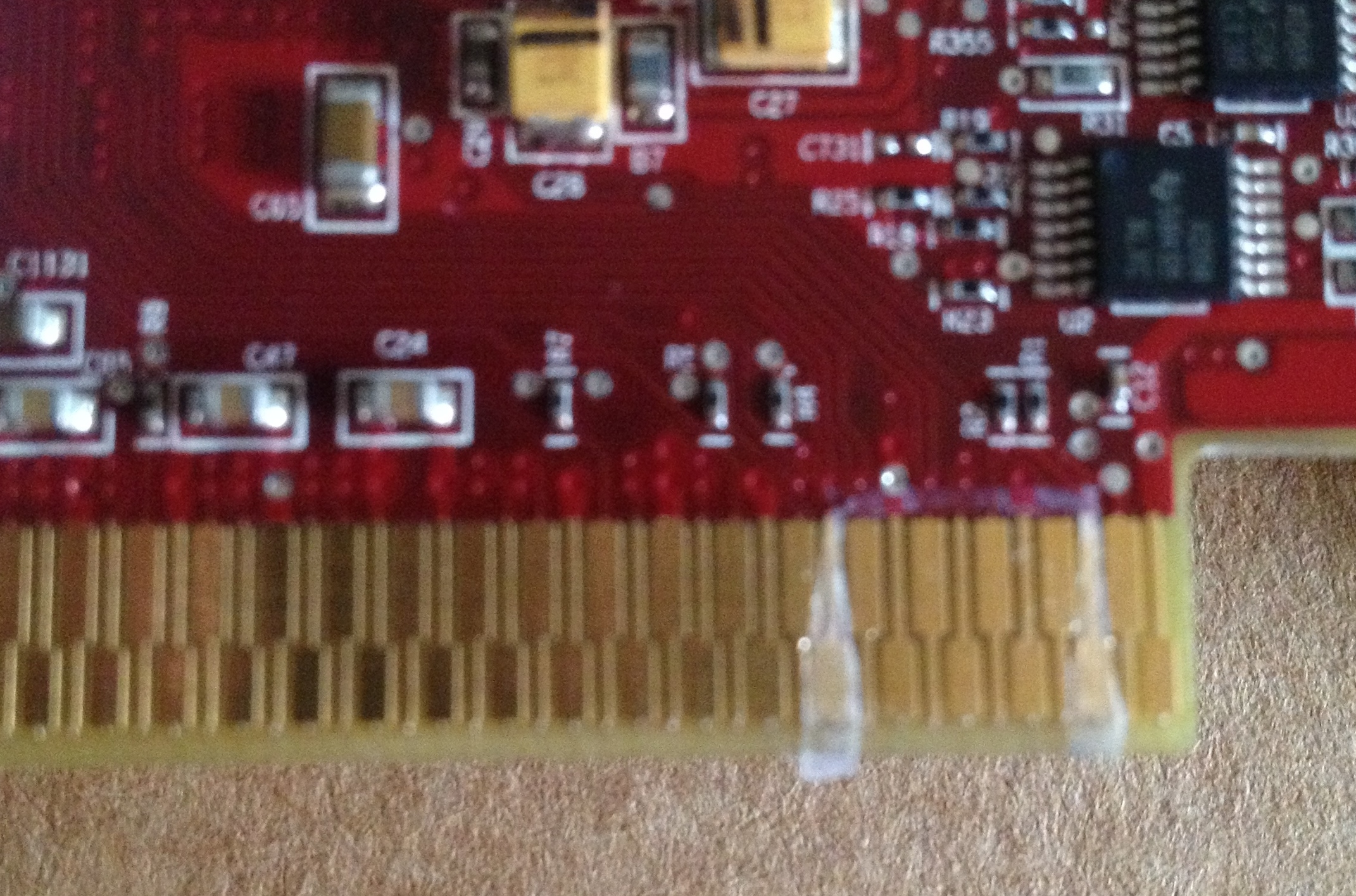

I'm calling it an almost success with the MDD.
I was able to get my MDD to boot to the Apple(10.5.8), but it would hang there. I tried to get it to boot in verbose mode, but it would hang before even switching over to that screen.
So close, yet so far away...

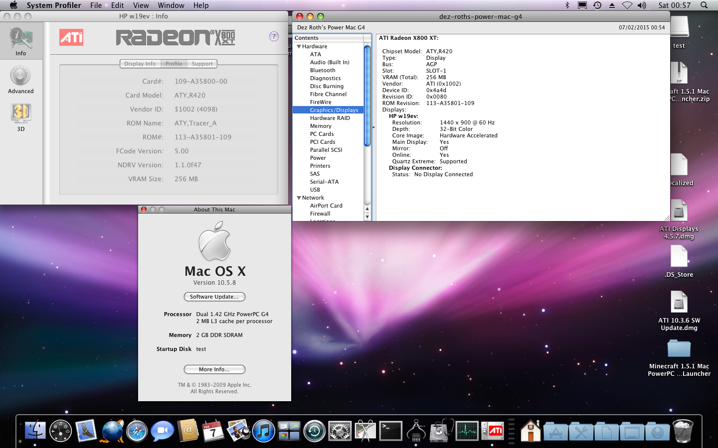

Wow I did not expect MacVidCards to comment on this thread heh I Have been browsing the strangedog forums and I have read the 28 Page long X800 Flashing post LOL it has some very interesting info about GPUs for PPCs heh. I have taken a screen shot of my FireGL X3 (X800XT) Under leopard to prove it works on an MDD under 10.5.8. at bunnspecial when You say You looked for X800XT drivers what did you download/get? as the what you need is the ATI Displays 4.5.7 update (like you see in the screen cap on my desktop ignore the OS X10.3.6 xtender update i believe thats not needed since the 4.5.7 update contains it already)

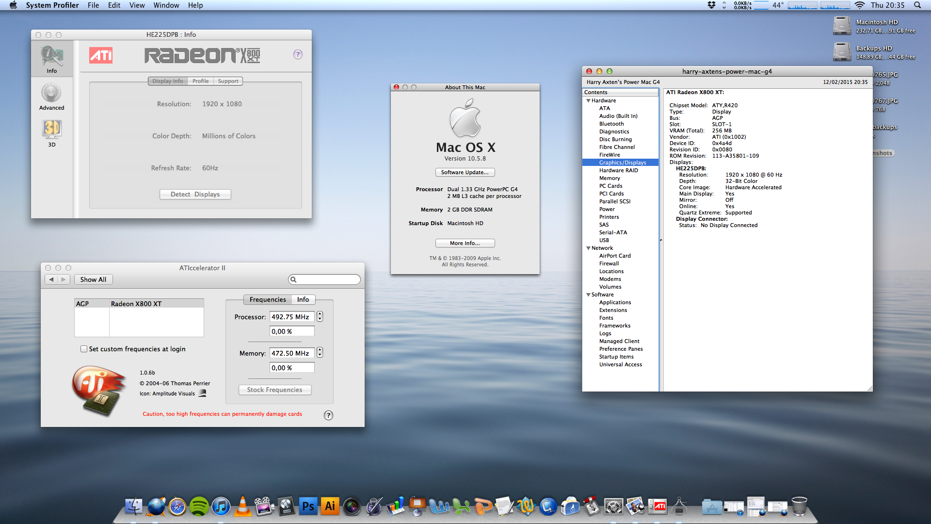

  • ATI FireGL X3:X800XT-Mac.png

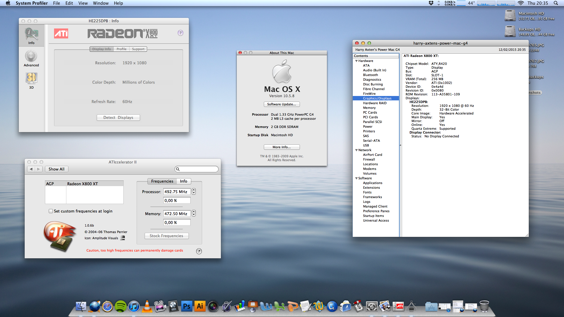

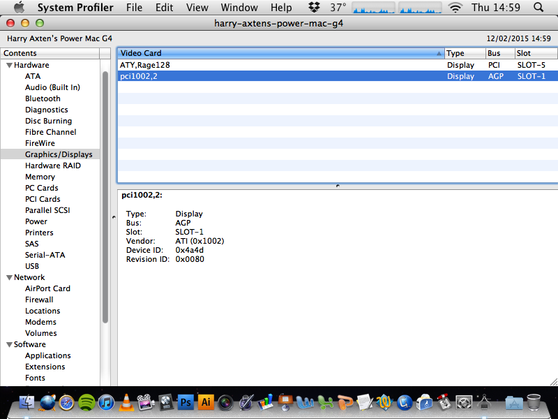

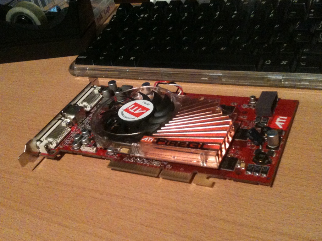

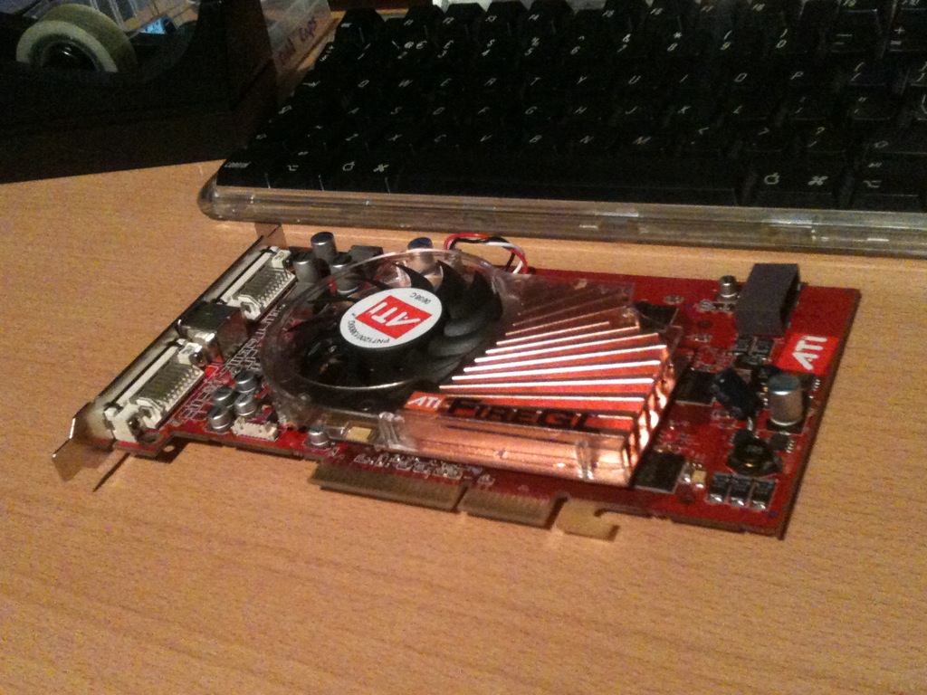

I had a chance to play with my Fire GL X3 today (thanks Erik!). Two of the capacitors had come loose during shipping, so I soldered new ones back on and checked everything was working in an old Win XP box. Thankfully, the card worked fine.
Having established that the card was fully functional, I taped pins 3 & 11 and installed it in my G4 along with an old PCI Rage 128. I used the 64K reduced Fire GL X3 ROM from The Mac Elite and the ATI flash utility that comes with Graphicceleator. It flashed without problems and after a restart worked first time. By the way, it did show up in System Profiler before it was flashed with Mac firmware.
I can say that it's quite a bit more powerful than my Radeon 9800XT, especially running games at high resolutions (Halo plays at around 40 FPS running at 1080p). It also runs considerably quieter than the 9800XT as the variable fan speed works. Overall - I'm happy with the performance increase and maybe now I can stop spending money on this machine! 🙄

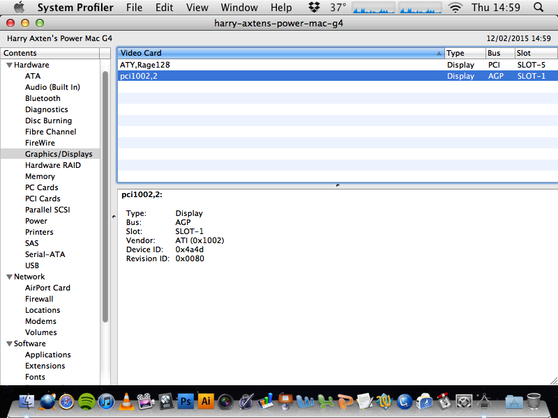

No worries about the minor damage - I doubt there's much that could have been done to prevent it, the packaging was fantastic. I suspect that it's just the vibration that did it. It took maybe 5 minutes to solder on a new pair of caps so I'm really not fussed.
That's right - an FW800 MDD. (with the CPU from an XServe)

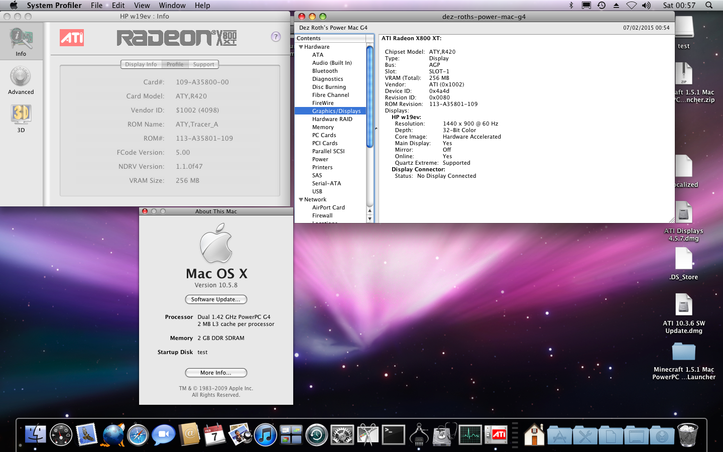

its good to finely see some good luck with the FireGL X3 🙂 I am glad it all works in ur FW800 MDD. My MDD is a 1.42Ghz FW800 one But I downgraded the Boot ROM To the FW400 one to let me boot into OS 9 (this was before the OS 9 unsupported machine rom was made) Sadly it disabled my air port card slot... if any one has the ROM image for a FW800 MDD do let me know as I want to upgrade back to stock now the new OS 9 ROM exists
