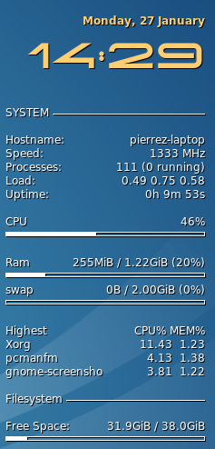

Can't find an analog clock widget for Lubuntu 12.04 so far, so instead I have edited the conky config file /etc/conky/conky.conf by inserting the following code at the top of the TEXT block :
Code:
${color ffce72}${font  Verdana:bold:size= 9}${alignr}${time %A, %d %B}
${color ffce72}${font abnes:bold:size= 28}${alignr}${time %H:%M}
${font Sans:size= 9}
which yields this below, good enough for now :
interestingly enough, conky auto updates this above as soon as I CTRL+S (save) the config file, very convenient to quickly check various parameters like font type/size/color/...

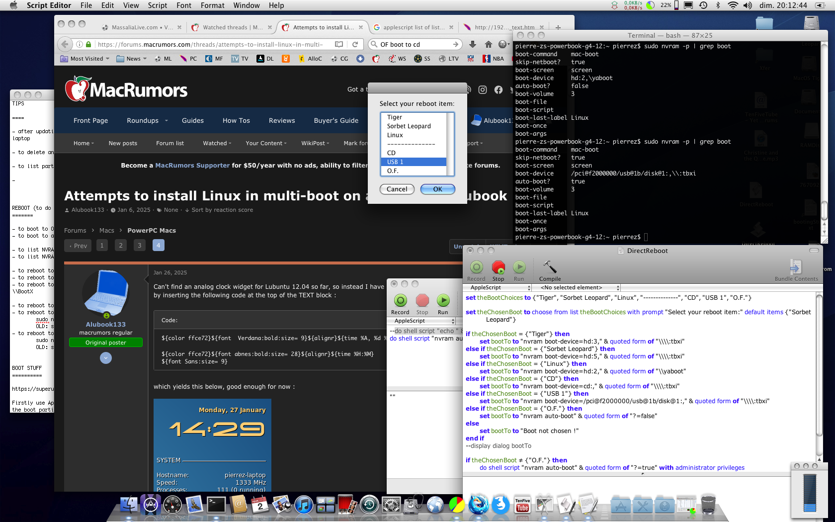

Speaking of which, I'm still wondering what will be best/easiest in terms of U/I for this direct reboot functionality : alias for each reboot choice, a script with 4-item menu, a simple GUI would be nice but what I've read about coding a GUI in OSX 10.4 or 10.5 is pretty discouraging, I might opt for a small web/JS app with Python to help exec'ing system commands (I've looked into Applescript but from what I understand it doesn't apply here). Any opinion on the matter ?
I think AppleScript can run shell commands.
Or you can create a shell script and give it a .command filename extension like I've done for the get-new-world-rom.command script.

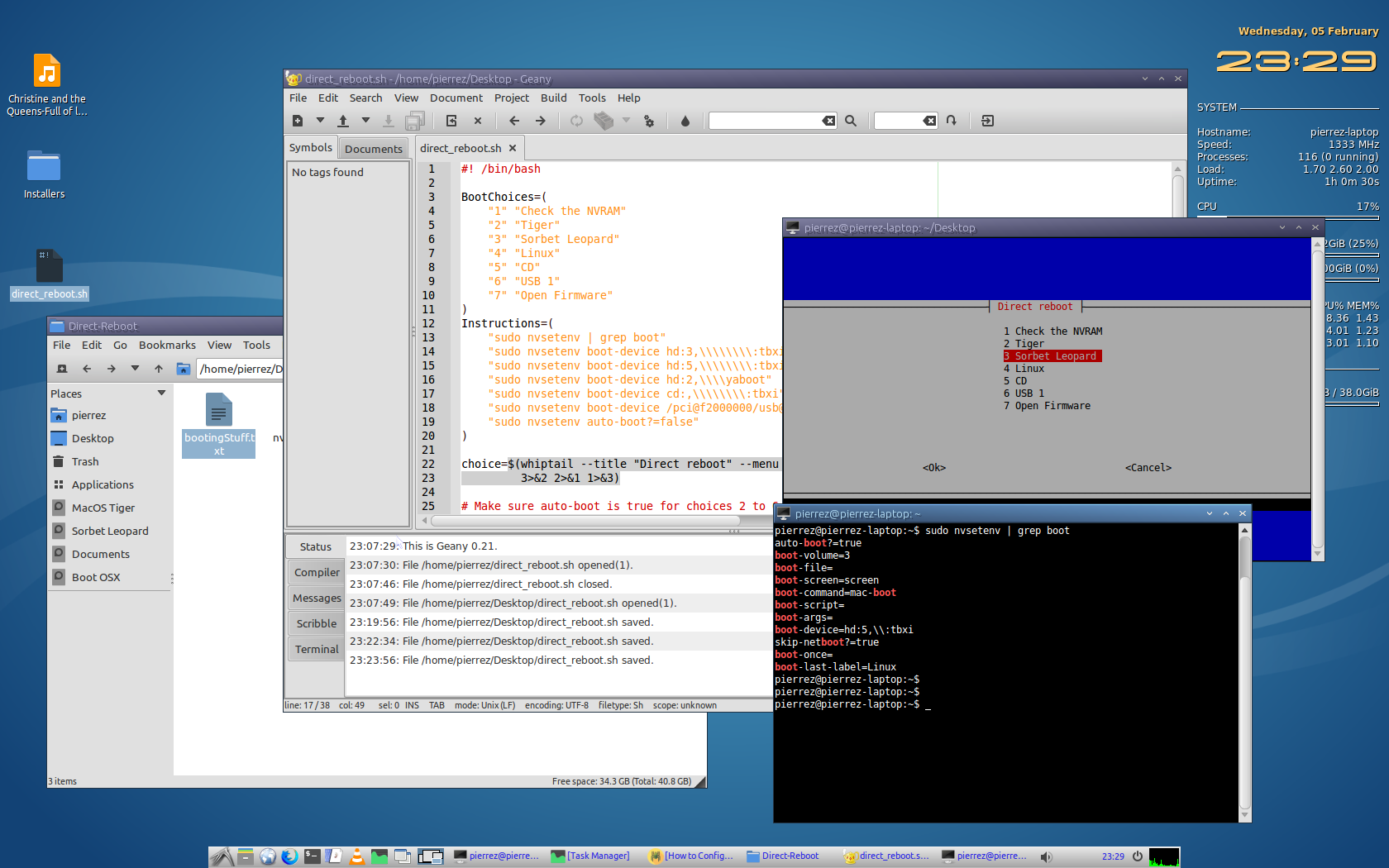

Oh sh*t ! I've fu*ked up Sorbet Leopard reboot (Tiger and Lubuntu still Ok).
What I did was to modify the /etc/yaboot.conf config file to reduce the yaboot timeout from 100 to 10 (i.e. from 10s to 1s) to save reboot time to Lubuntu (still don't know if and how to more directly boot to Lubuntu w/o going first thru the yaboot prompt, if anyone can help here, TIA), then did the required sudo ybin -v for the change to be effective, and that's all.
And now when I boot to Sorbet, directly or even via the boot picker, I get the grey apple on white background and the spinning thingy, however it spins forever... :confused:
Ah ! well, I let it spin for a while this time around, and it ended up auto rebooting, then had the chime then the apple and then... yes ! Sorbet Leopard booted. Looks like the thing fixed itself or something... good ! 🥹

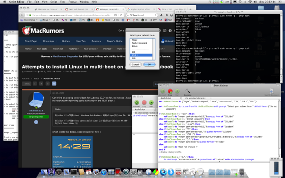

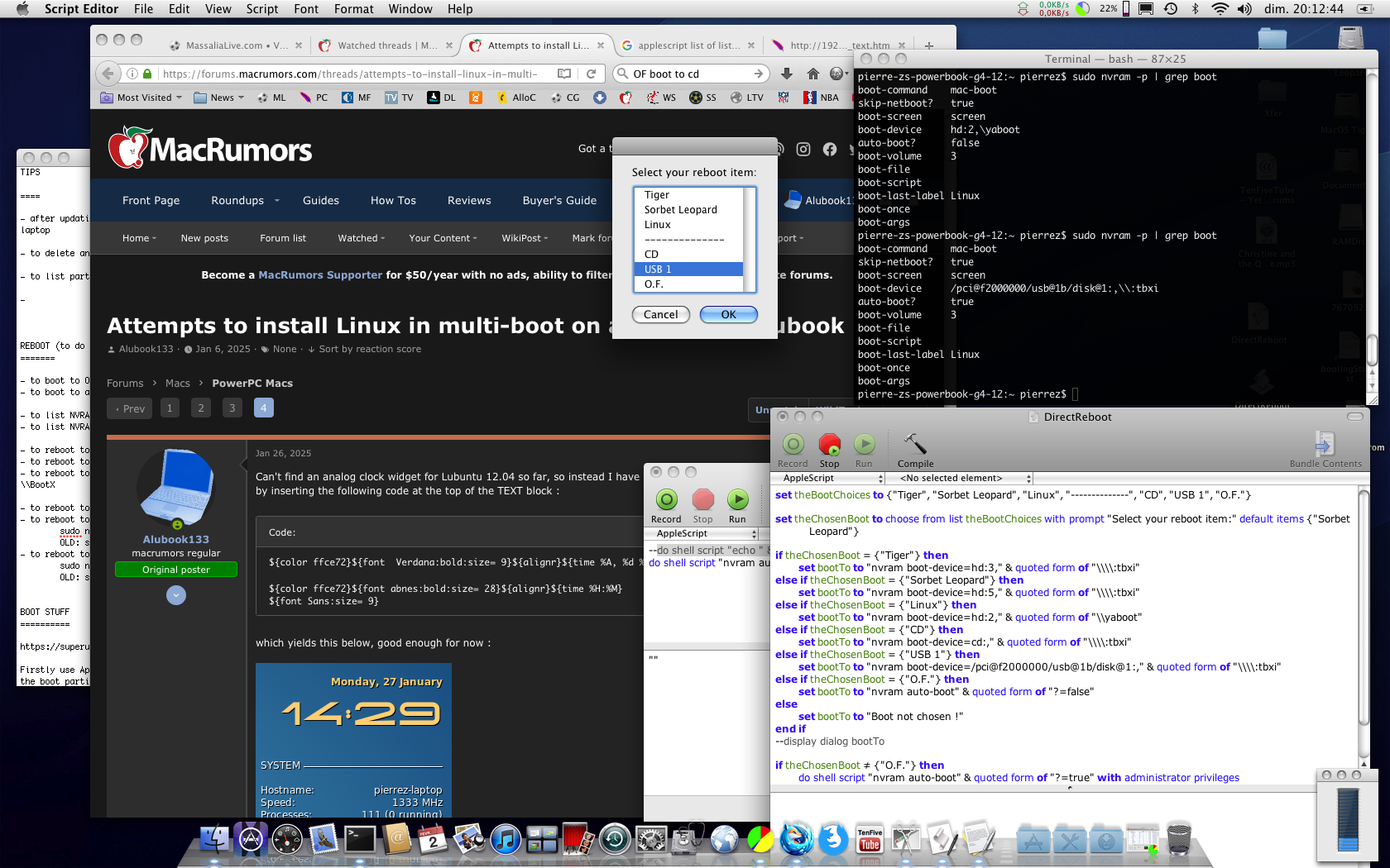

After dealing with some intricacies regarding Applescript escape chars vs shell (noteworthy : while OS X Term uses bash script, Applescript sends code to sh script, not bash...), I've put together a crude, brute force script with minimalist UI that allows me to select the next reboot destination with a couple mouse clicks :
Easily beats having to press (Option then boot picker wait and select) or CMD+Option+O+F at reboot, if you ask me. :cool:

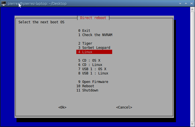

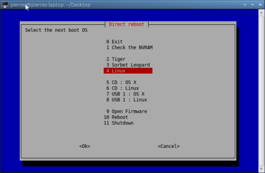

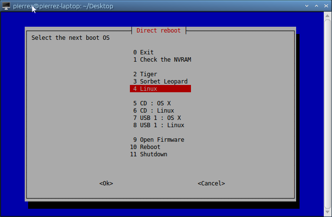

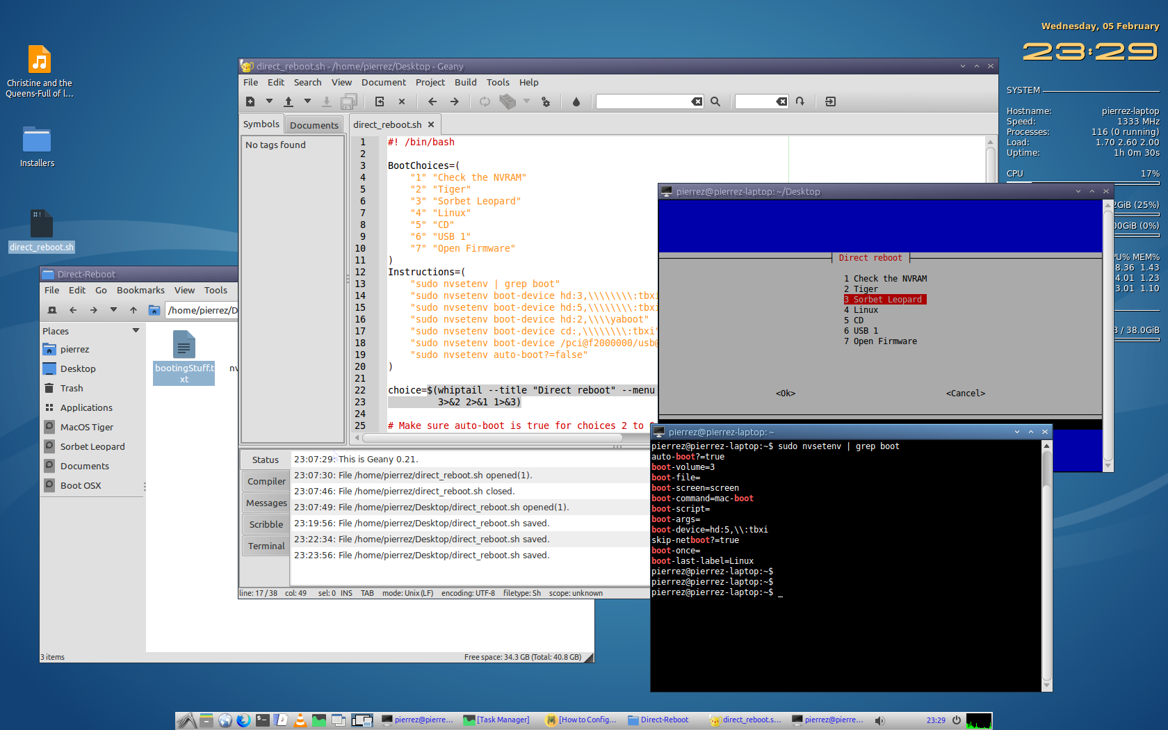

Now on to coding similar stuff on Lubuntu-remix, probably using dialog for a basic UI (provided it was available in 12.04).
Unfortunately dialog is not available in Lubuntu-remix 12.04, tried to install it but got this :
Package dialog is not available, but is referred to by another package.
This may mean that the package is missing, has been obsoleted, or
is only available from another source
Since this is a slimmed down/custom version of Lubuntu I will avoid screwing around looking for solutions that might break it. So will look for something else at this point, worst case I'll code a simple textual bash script, after all there are only so many options to look for, a simple 1)... 2)... 3)... etc... menu will do (though I'd much prefer a basic GUI like I've done in OS X).
Have you tried whiptail? It serves effectively the same purpose as dialog does, and probably is available in-repo if not installed already.
Reactions: Alubook133
@Doq, nope, never heard of it - but I just tried a bunch of whiptail code examples in the terminal and it seems to be doing pretty much what dialog does (except maybe for using the mouse to select an item in a menu), so that's better than the bash script I've started to code and I'll probably use it for my "direct reboot app" - thanxx a lot ! :)

Moving along playing with Lubuntu-remix, this is getting fun with coding some scripts and aliases, setting programs to auto start at boot-up, and beefing up the "direct_reboot" script (will show on next post).

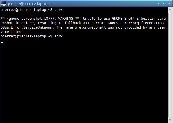

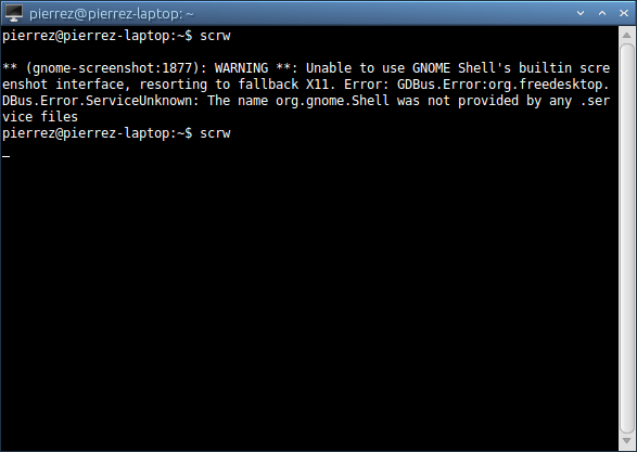

Also finding some quirks and limitations, for instance the gnome-screenshot GUI is annoying in that it closes at each snapshot taken, so I've created aliases to run the app from terminal and take care of capturing a window, all screen or part of it depending on what I need.
Btw doing this generate an error message below - however screenshots are actually produced (in the pictures folder, either by default or maybe because I had set it up when using it via the GUI).
Also, I miss the possibility to keep some apps in the "dock" (menu bar), so instead I'm launching those apps at boot-up, but it's not quite the same, esp. because I can't start them *minimized*, resulting in a bit of a mess on the screen...
Besides, I tried to connect to my mini-PC via Wifi to exchange info/files, didn't work in Filezilla so I scripted an ftp transfer thing and it works fine from terminal. Not ideal, but can live with it, I'll get back to it later.
Just to spoil the next post, a screenshot of the beefed-up direct reboot menu, script now works 100% on Lubuntu-remix (lots of fun coding this in bash and with whiptail ! ^^), need to do the same update on the OS X script, anyway I'll elaborate a bit around it later to show how it goes.

Cool stuff. You can skip gnome-screenshot if it’s bothersome. I believe i included ‘scrot’, a nifty command line screen shot program. As for the persistent USB image… looks like MS/OneDrive deleted it on me. Didn’t realize stuff you upload there could “expire”. I’ll dig around some old disks and see if i still have a copy. I wouldn’t hold my breath though.
