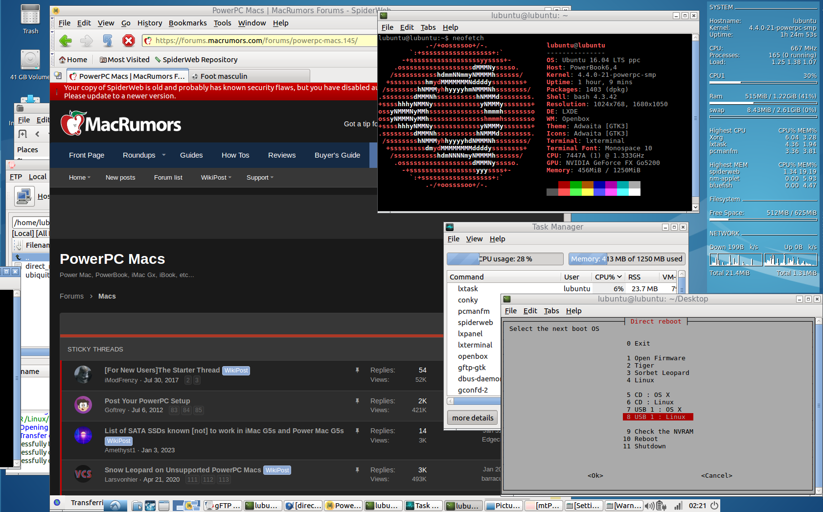

Hou... neat icons in the taskbar... looks better than 12.04 from what I can tell, battery icon says "Battery fully charged 0% ^^) , did connect to my mini-PC via ethernet just like 12.04 was doing so it'll allow me to xfer iso's and dmg's and stuff from there, just had a funny error message from Gparted ("File system is bigger than its volume", I'd want to LOL at this one), oops error message from conky I'll have to edit the included conf file after installing, ah pesky desktop 2 is back but I know how to get rid of it, wifi found and now connected, browser choice just had a crash with FF an another w/ Spiderweb but not w/ Arctic Fox, well I'll look into this and the rest later, but bottomline so far is : seems to work fine (from usb, so it should only get better should I then install it on the SSD...).

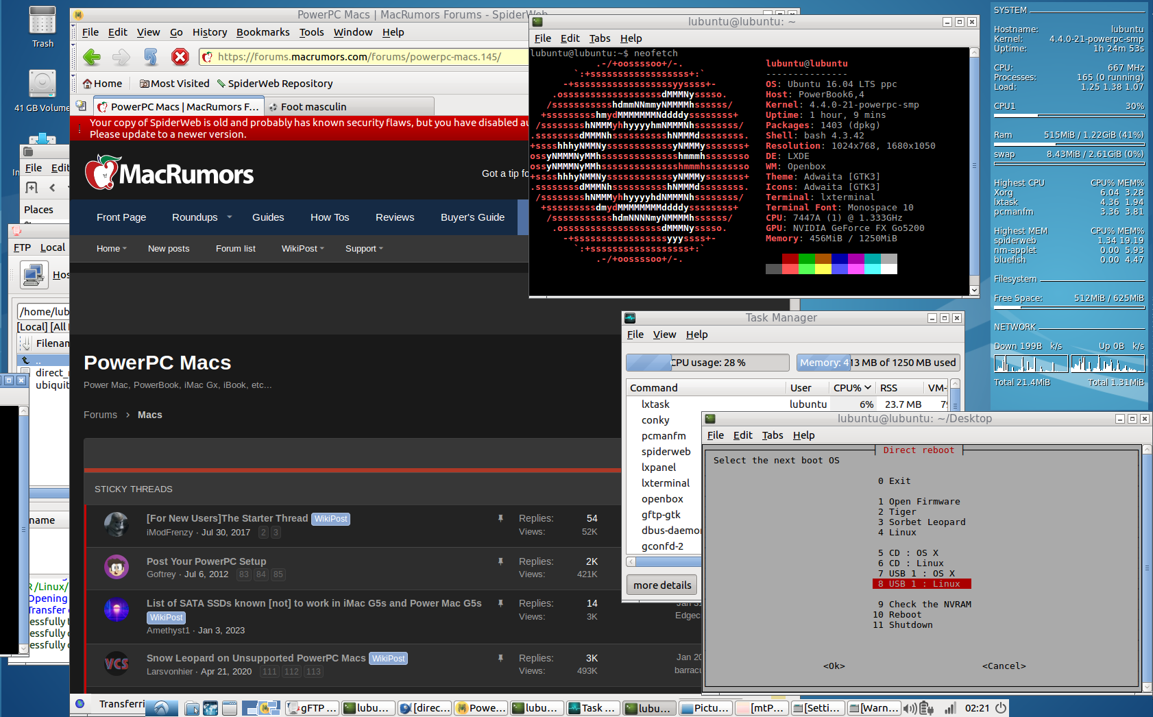

A screenshot of Lubuntu-remix 16.04 still run as live from usb, noticed graphics refresh (windows) not always optimal, spiderweb quite slow to load pages when compared to 12.04 but I haven't applied any of the tricks used on 12.04 to speed up things a bit.
Pondering whether I will overwrite 12.04 w/ 16.04 or rather make space for 16.04 and keep 12.04 in case things aren't great even after install on SSD... anyhow I plan to install 16.04 and see how it goes, also because there's an update that could make it look even modern-er, while 12.04, good as it is (and I like it a lot), is "stuck" to older stuff.

I see... indeed, dragging windows around one can see the re-paint in action with multiple window corner drawn, and sometimes when closing a window a grey rectangle appear for a second before the screen is fully refreshed, doesn't bode well for the future since unless I'm wrong this has nothing to do with the fact that I run it live from an usb pendrive, should be exact same behavior once installed on SSD I think. :?

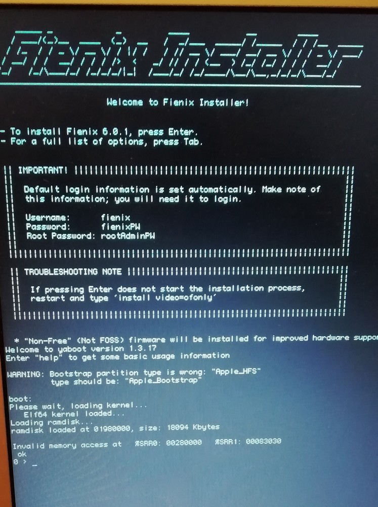

Yep, and that's what I did right after reading on Casey Cullen's blogspot that usb boot/install was doable, and...

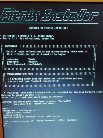

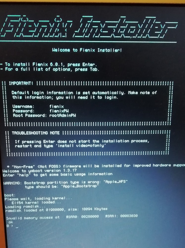

... it das does boot, however I get a warning and an error message, and then nothing. I'm sure I've read somewhere about these issues, but don't remember having read solutions for them, so I'll continue my research.
Just for reference, a picture of the boot screen with error message :
Ah. You are trying to boot with the default 64 bit kernel. Wont work on a G4. Use the 32 bit kernel in the boot options menu.
Duh ! One of these days I'll learn to READ whatever's on the screen i/o rushing to frustration status. 🙄
It does say "Elf 64 kernel loaded", as well as "For a full list of options, press Tab", pretty clear stuff, sorry for the unnecessary heads up.
But that had me realize this is not a live session thing, it's meant to directly install Fienix onto your machine, there's no trying first prior to install... so I went to (re)watch this Action Retro clip where Sean installs Fienix on a G5 iMac, at some point (around 5:10) the installer offers various ways to partition the disk, so while he lets the installer auto partition the entire disk I'd probably want to choose the first item "Guided partitioning", hopefully it'll allow me to pick non-used partitions/volumes on my SSD to install Fienix there. (and I see the partitioning is about the same as what I did for Adélie or Lubuntu, quite logical).
Reactions: wicknix

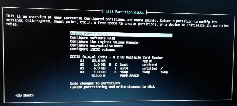

So... strangely enough, when I select the right installer things move along (incredible, right ?), I've let the installer go thru a few stages (just to see how it goes, no intention yet to complete the install, need to decide for further partitioning the SSD), I've had the "missing firmware" page unsurprisingly (but sadly) related to the B43 chip (Broadcom chip for Airport), then got to the "Partition disks" page.
The only disk listed in details (with existing partitions) is the... 8GB usb thumbdrive "disk" (sdb) from which I've booted this installer ^^, so as said above I selected "Guided partitioning", which provides 5 choices from which "Manual" returns to the previous screen, 3 choices start with "use entire disk" so nope I think, the first in the list "Guided - use the largest contiguous free space" is probably the one I'll want to choose, though not very confident about it (and therefore a bit nervous, not wanting to lose the 3 existing OS partitions).
What I do is in the Leopard disk utility prepare a blank partition (shrink, create, delete), later in fienix using the guided partitioning choose use the largest contiguous free space

So I'd prefer that the Fienix installer leaves it 100% to the user to partition their disk as they wish, I thought the "Manual" option would do that but instead it just returns to the list of "Guided - etc etc...".

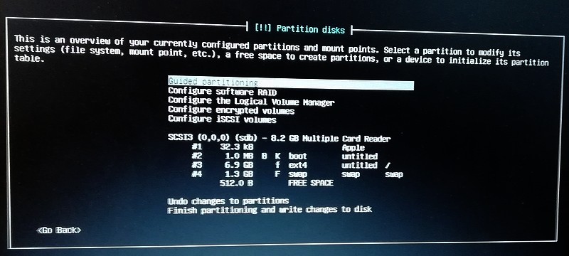

Well, this is not going anywhere, the installer refuses to offer to partition the main drive (SSD) and only allows me to install Fienix on the pendrive, as if the main drive was non-existent. 🤨
In fact when getting to the partitioner page I see that it prepares the usb pendrive for install (divides it in 3 partitions), so I just did an "Undo changes to partitions" and indeed the pendrive now shows its actual partitions.
I've now gone thru all menu items (including "largest contiguous free space" and even LVM) just to see if at some point the installer would realize there IS a main drive in my machine, but no, it totally ignores it, no /dev/sda nothing, iow maybe I'm missing s'thing but I can't install Fienix at this stage. 😒

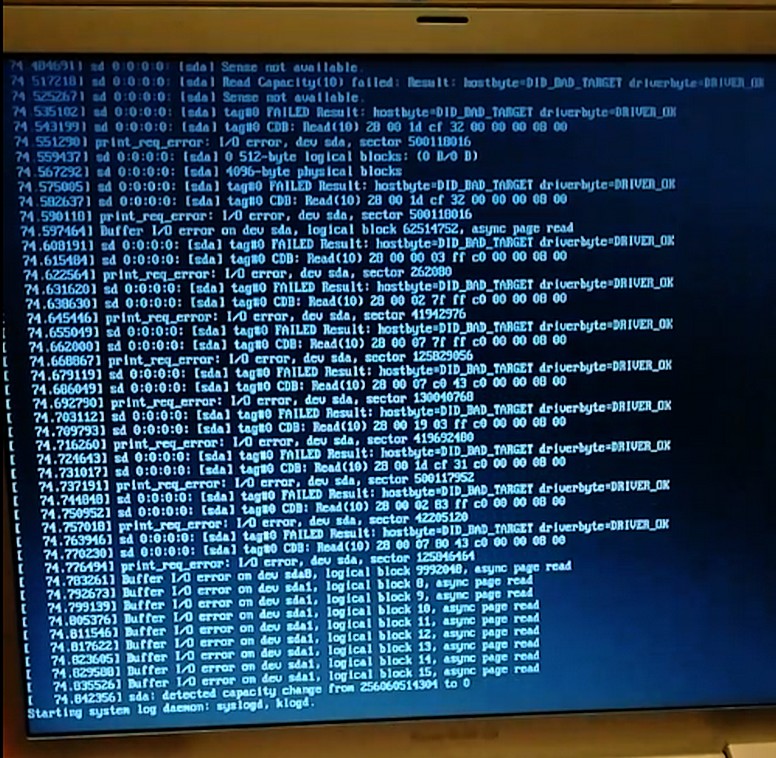

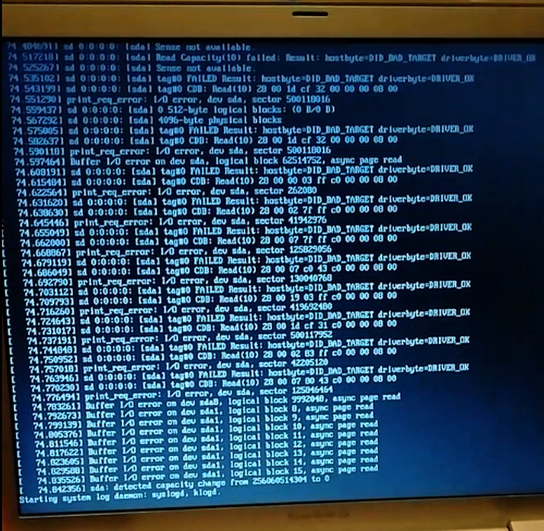

I have captured (video->picture) the last error messages displayed by the Fienix installer at the point where it sees the SSD drives and tries to set it up for partitioning but fails miserably, the last message bluntly saying :
"sda detected capacity change from 256GB to 0"
Clearly the SSD _is_ detected, however the installer claims that it has a bad structure, issues with blocks/sectors... as if it was wrongly formatted or something. Maybe I should re-scan it entirely in Lubuntu and see if it can be "fixed" (and if not, redo it within OS X). But then why don't the OS X or other Linux type installers have any problem with the same SSD ? What's Fienix expecting from it that it doesn't get ?
Anyway, hoping this info will help someone around here understand what's going on, and tell me if and how to workaround this issue. TIA ! 🤞

Together with this post on the Fienix blog :
Unfortunately I wasn't able to make the installer recognize/use any drive attached to this G5. I tested many drives, both mechanical and SSD, neither is recognized properly, whether it is blank or has a partition table. Here is an example of what I see in dmesg, and this is the case for all the drives I tried. The particular drive used in this case had a MBR partition table with an ext4 partition. https://i.postimg.cc/J7f5rH2Q/IMG-20241027-090851.jpg
So yeah, unfortunately it is very possible that a specific installer will not agree with your hardware, here the SSD+mSATA<->IDE combination (most likely the latter specifically, at least the model I have), which prevents installation of Fienix on my laptop.🙁
From what I've read it's probably related to the kernel version included in the installer, in which case I don't know if it's possible to update/downgrade it and I certainly wouldn't know how to do it on a closed/frozen OS like Fienix.
