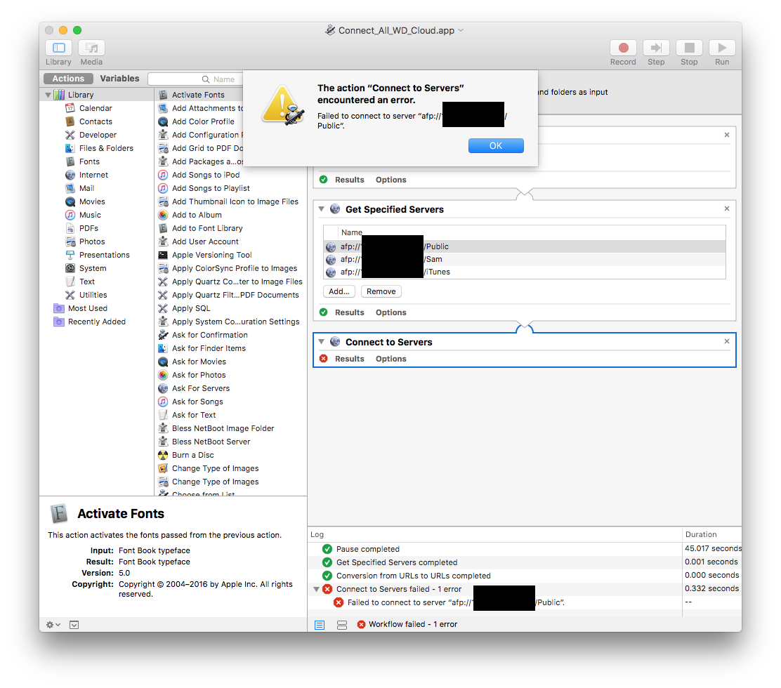

Hi
Yosemite and El Capitan I connect my WD Cloud share using automator without any problem. Then I upgrade to Sierra and it won't work properly.

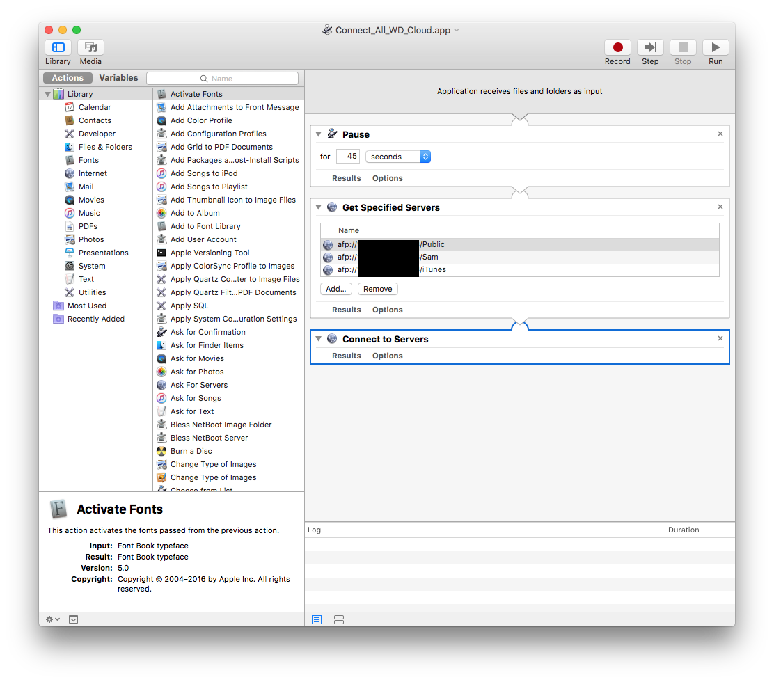

When I try connect 2 my WD Cloud NAS in same automator program (this my usual one). First WD Cloud will connect and 2nd WD Cloud always fail to connect. I try move swap them around and 2nd one always fail. I have to rerun separate automator for 2nd WD Cloud manually and it fine.
So I try split two WD Cloud have their own automator program instead of together like above. When I try connect 1 my WD Cloud NAS and first share alway fail. Doesn't matter which one: top one always fail. I move order around for different share and top one always fail.
I save my automator as App and add it in Login Items for start up.
My automator look like this in screenshot below.
I am not sure what do now. I try find out why but I still don't know why it not working in Sierra when it work fine in Yosemite and El Capitan.

Don't think so. I not that advance.
I know people have popup ask connect network or NAS problem. That fine by me. I don't mind that popup if I get it (I don't).
My problem it can't connect and come up error like screenshot. I don't want error. I want it connect.

Hmm. None of those match my problem. They don't use Automator to connect. They just use finder Go to Server thing. Problem I can't do that cos too many shares I need connect so that why I use Automator to connect all for me. I can't find anyone have same problem as me.
Well you are using the same process except it is wrapped in automator try in Terminal the server address you have in the action now with a mount_afp preceding them if that works then change the action to execute bash script copy the lines used in Terminal into it and it should work.
Finder connect to server works fine but too many shares for me. Automator not working properly for me. Error box in my first post.
Something in automator not let me connect properly.
It won't solve your problem but I would point out you shouldn't be using AFP anymore, it has been deprecated. Use SMB instead.
I try that too. Replace AFP with smb and exact same error still appear.
It works fine if go by finder again. Just Automator it won't.
Look like I have to accept this problem can't be fix. 🙁
