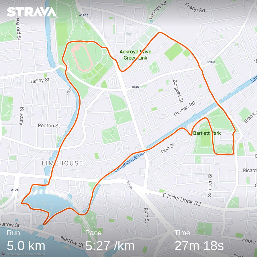

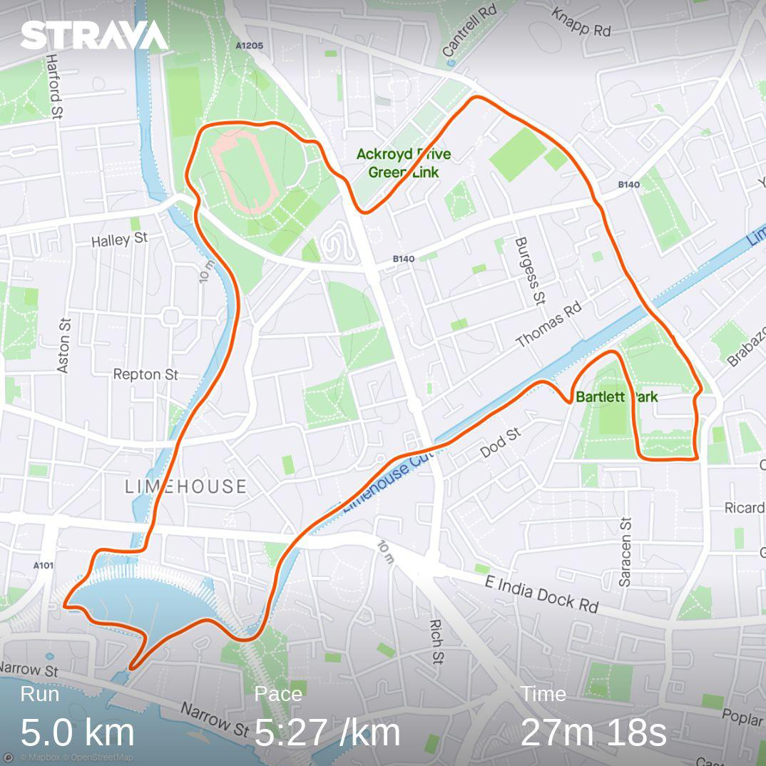

I did a small test today: knowing that WorkOutdoors has an actual GPS fix indicator, I decided to get a good fix by waiting for a few minutes with the app open.
I then minimised it, opened Stryd and hit start (while streaming Apple Music); The result? An actually reasonable GPS track recorded by my watch:
https://strava.app.link/xqBCWKJAG5
Let me know your thoughts!

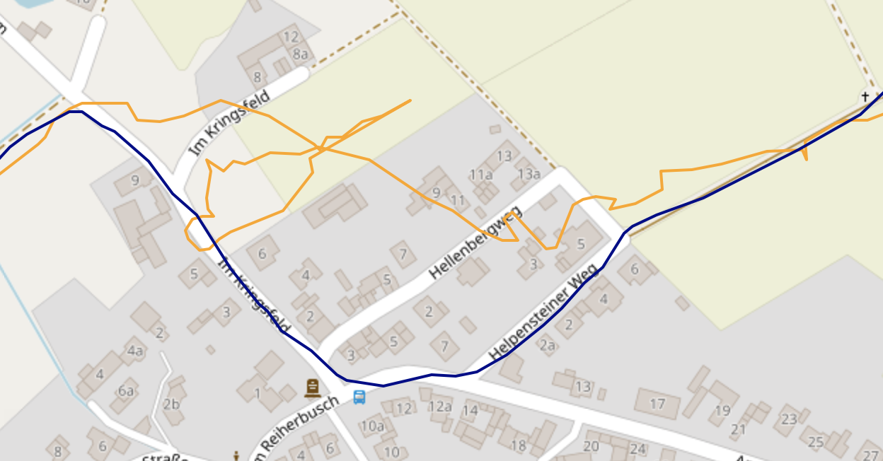

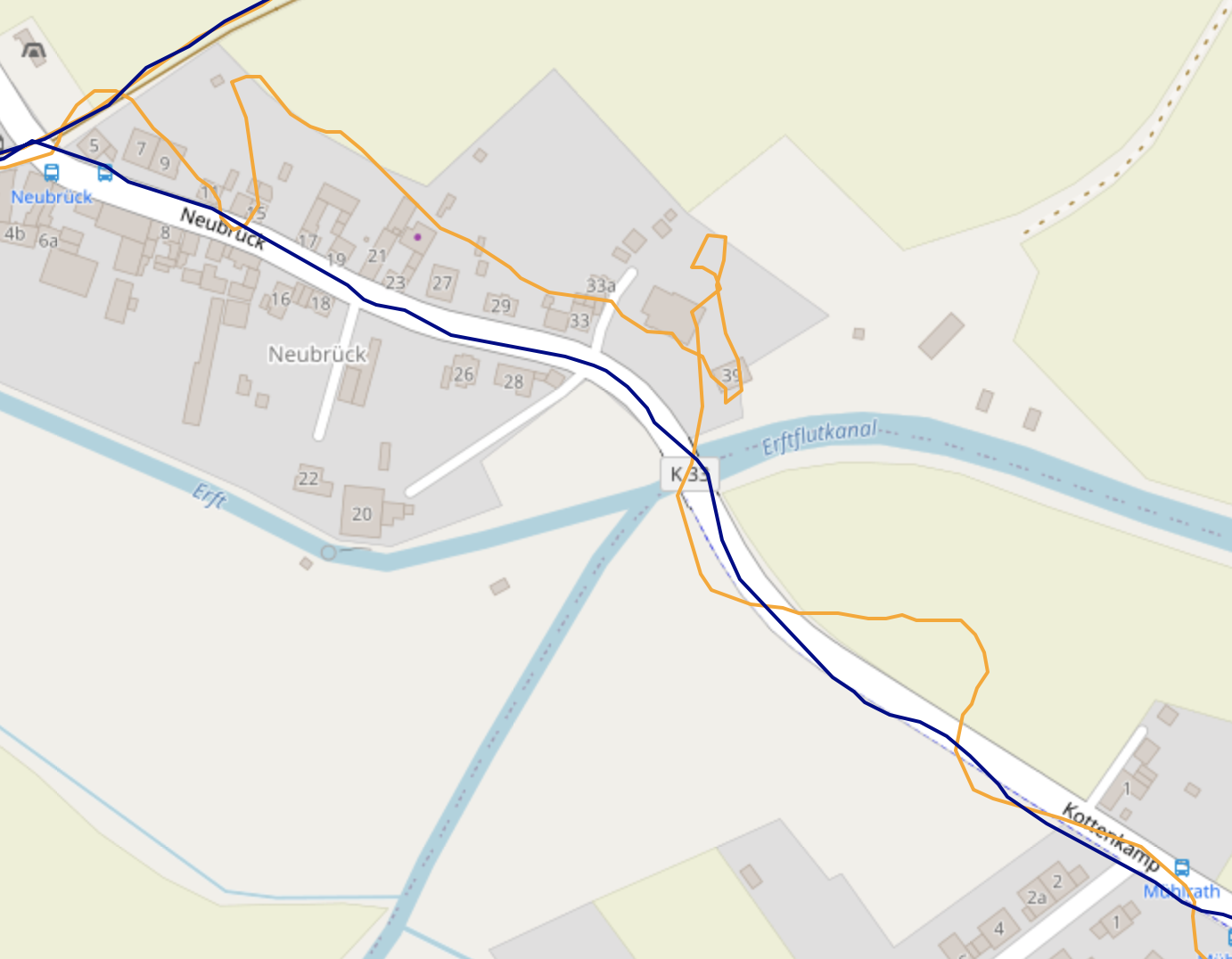

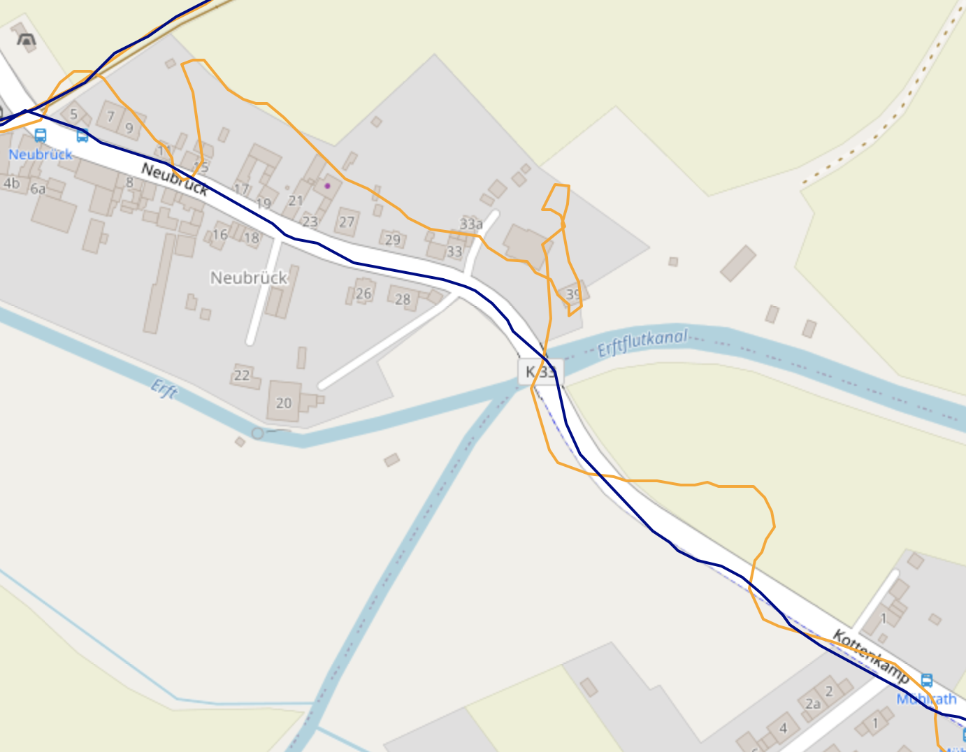

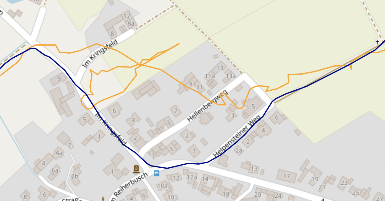

Upping this thread so that it is clear that the problem is not fixed. AT ALL.
Am currently providing information Apple about the problem, maybe it will be fixed. Found several other folks with the same issue (mostly German Facebook group). Also, same problem is reported for iPhone 11.
Just to show what the current status is, did today a run with LTE/cellular enabled. Blue is run from yesterday (no LTE), yellow today (with LTE). Disgusting.
It's really a very bad track, but I am not sure it has an impact on the distance measured by the watch.
Most of distance calculation are done by pedometer, so maybe this ugly tracking is not a very big issue ...
If you check the distance with the 2 tracks, do you have similar values ?

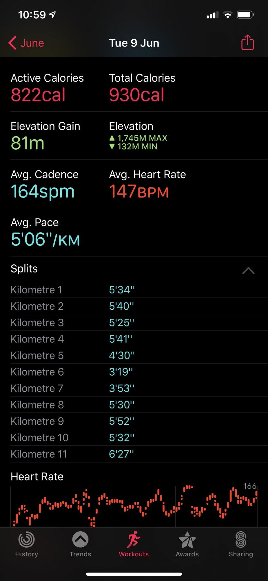

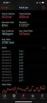

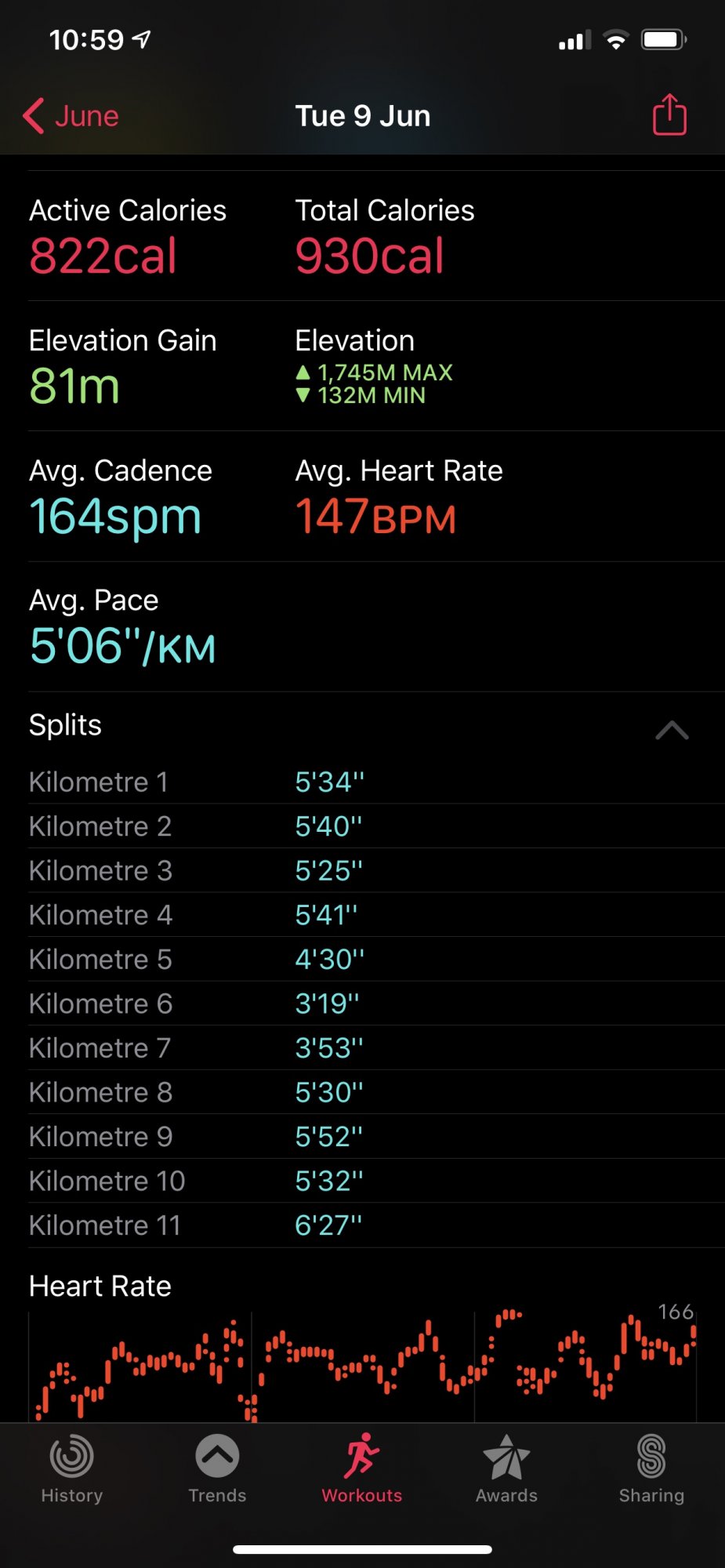

I find the gps route to be accurate but the splits wrong
i have cellular aw5 my wife has non cellular. we will start off accurate together, hitting 1k at the same time, then apparently I drift further ahead. Even managing to walk 1k apparently in 8:45
todays 10k run has these splits, which is incorrect, as I can’t run 1k in 3:19
