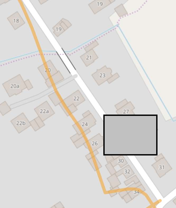

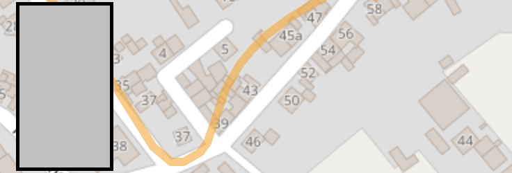

I did a test just right now. Switched off BT on my phone, Wifi on my AW off and LTE on AW on.
Waited until I had a blue bar in Workouts with 4 satellites, started a walk for 1km and the result was mixed:
From a distance perspective, I measured 1.025 with GPSies and the resulting track is 1.04km which is within tolerance.
What makes me nervous are the very strange hiccpus the watch takes from time to time.

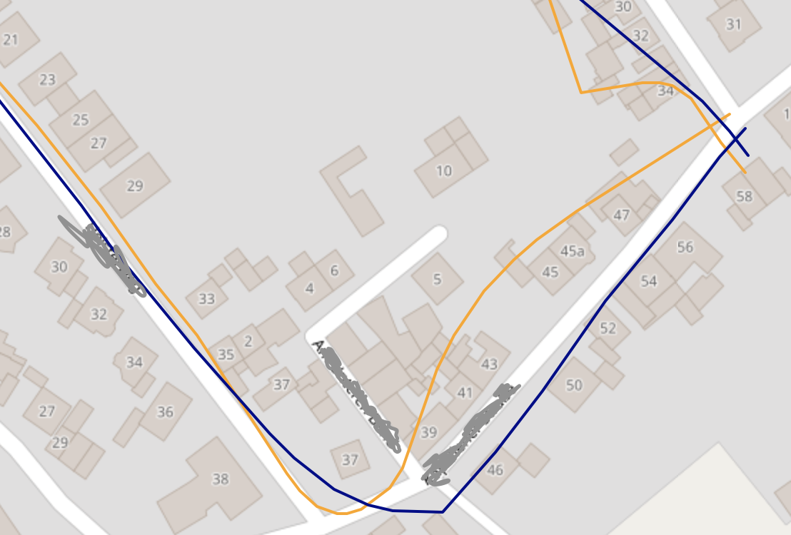

Did my second test today. Same procedure (disconnected from iPhone, pre checking of GPS reception) but now with LTE off.
Track looks better, but not perfect. (Yellow is with LTE, blue is LTE off):

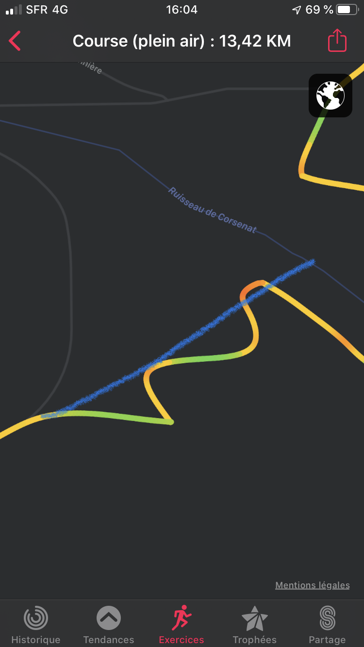

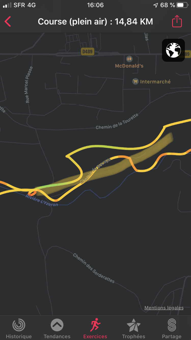

Two samples where we can see big glitches:
On the firt one, it shoult be on the blue line, on the second one, the top track must be near the yellow mark
It was at the middle of my run, but in some areas where LTE was probably poor and GPS also.
But I never has such glitches without LTE
