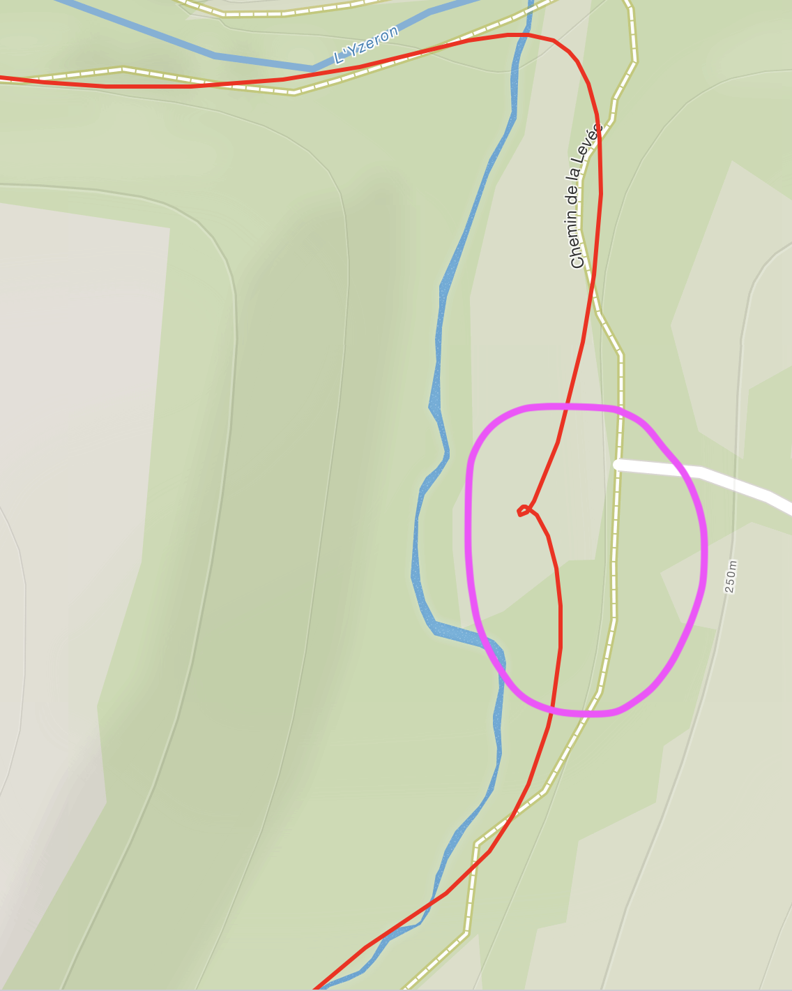

I have used LTE in a more difficult area today. Not too bad, but one noticeable glitch ...
It was not a lot off road, but the track is a bit strange ...
Looks strange. As if a whole lot of trackpoints are missing.

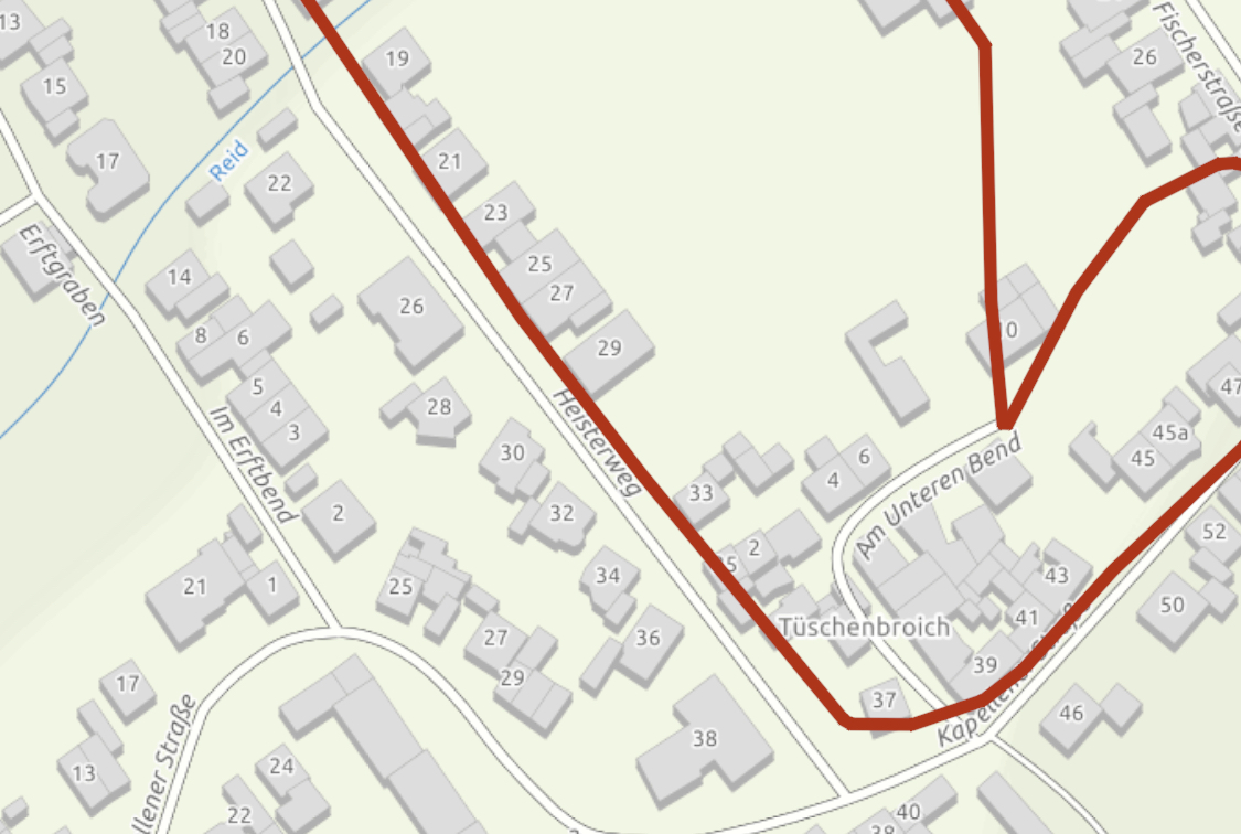

Did my walking test again today. With LTE on and this time did not disconnect from my iPhone which I left behind at home.
Track was not bad apart from a really terrible hit at the very beginning. It bends about 30m away from the street and comes back to be about 10m left from the road. This could well be related to the GPS from the watch taking over.

Yes, I know what you mean. I have checked with both Apple maps and Open Street maps. A slight deviation from a street/path is normal.
What I meant was this crazy deviation of 30m that was never compensated.

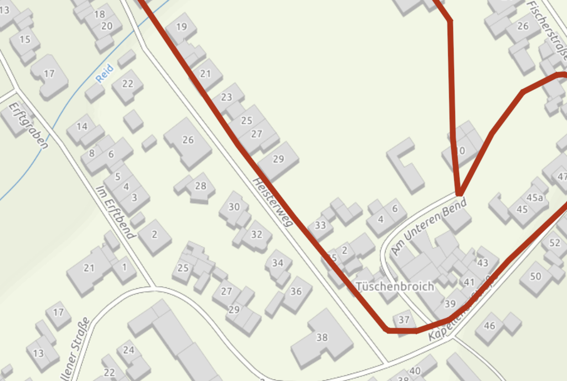

(Attached the map image)
There are clearly software issues with the power management of the S5. I ran my regular 10K route the other day with my S4 and yet again it is within the 0.5% window of accuracy.

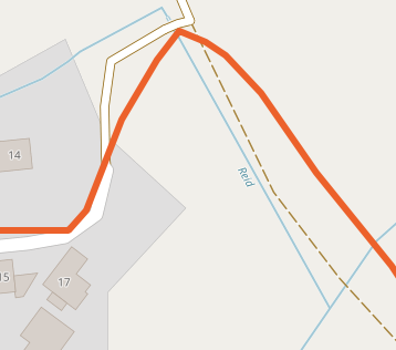

Track has no hiccups! But was still amazes me is that corners are shortened brutally, have a look:
So my bottom line: it improves from run to run. Hope it will be better with the next run and hope my next run will be soon. Getting the iced bottle now out of the fridge to cool my heel.

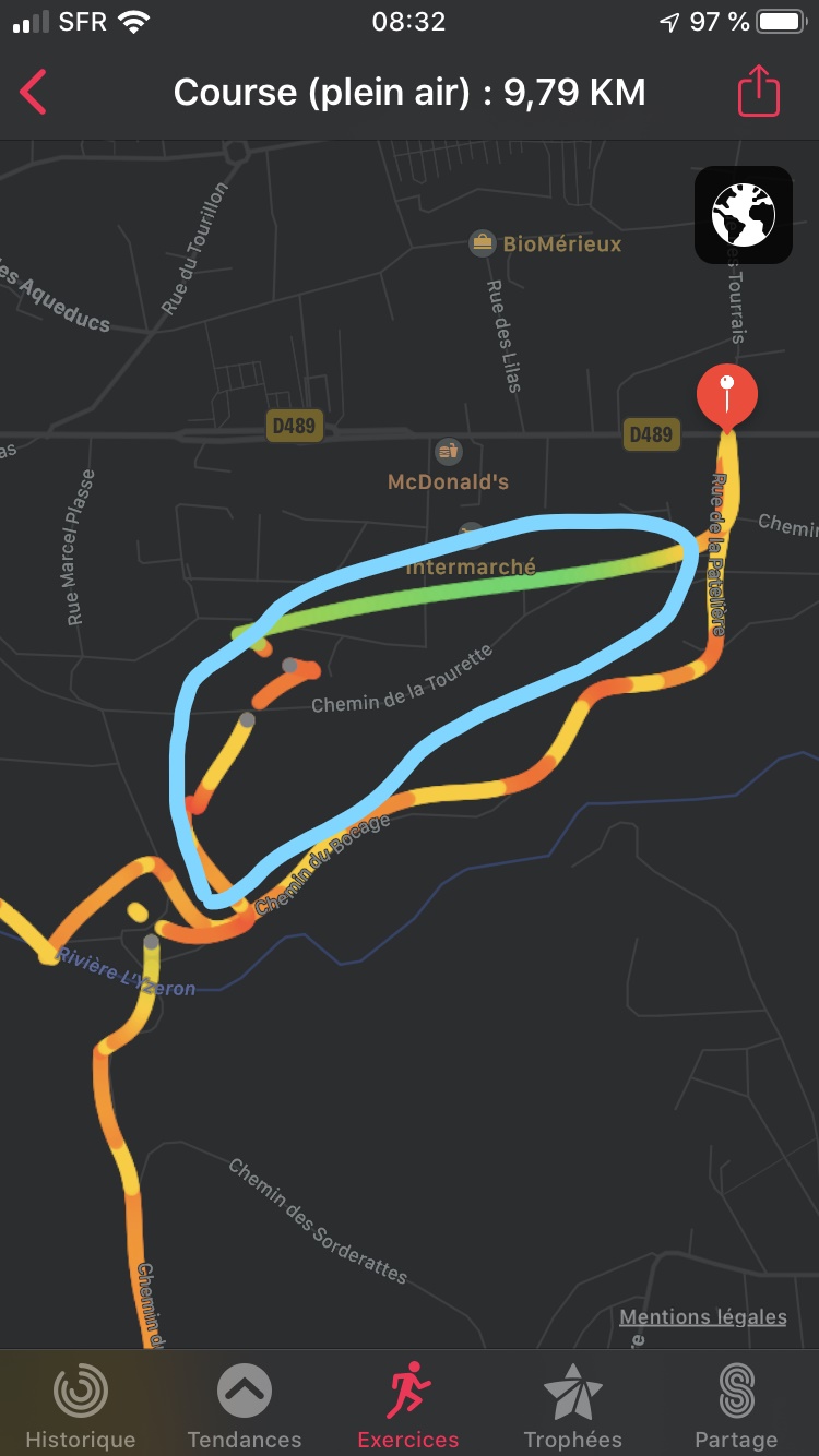

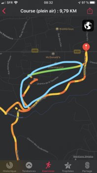

A trail un difficult lte reception and a terrible track....
There is really a big issue, it´s not reliable at all
Bad news for me.

Yesterday, it was terrible. I am proud to announce I have run a 400m in 44s during a trail 😀 !
I have never seen such errors when disabling LTE on the watch.
So I have bought a cellular version to run without phone, but I must disable it to have a reliable tracking: funny 🙁

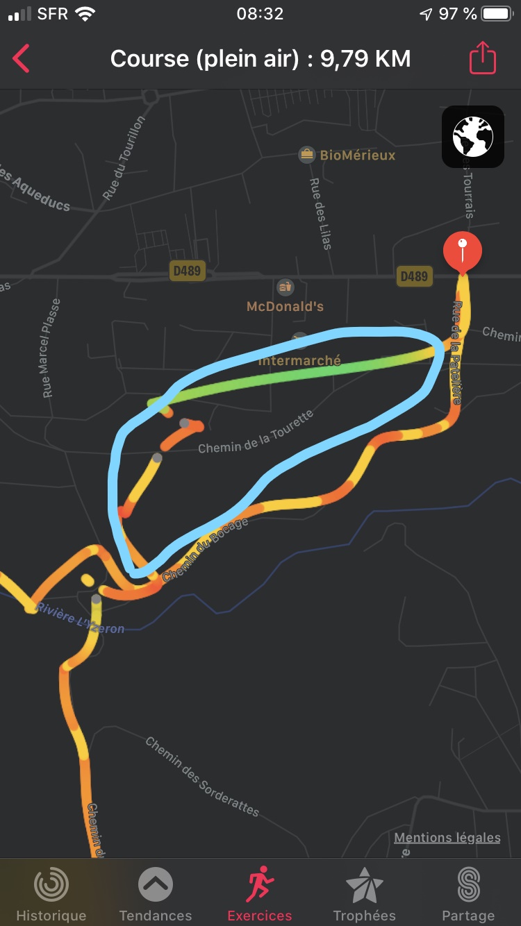

I have tested with watchOS 6.0 , 6.0.1 and 6.1beta3 and 2 different watches.
On the attached capture, the part I have undernlined in blue is supposed to be on the same way as the track on the bottom. I have used the same path in both ways.

Repeated my first run with the AW today. Same setup as yesterday (iPhone off, Wifi off, LTE on) but with audio streaming via BT.
