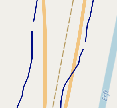

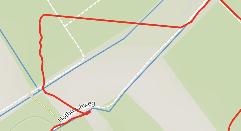

Repeated my run from last Saturday, this time with crown left and I am absolutely impressed with the result. Almost no wobbling anymore, no hiccups. Just compare (yellow is today with crown left, blue is crown right):
One new test with buttons on the left side: no improvement. Still the same problems of GPS not accurate.

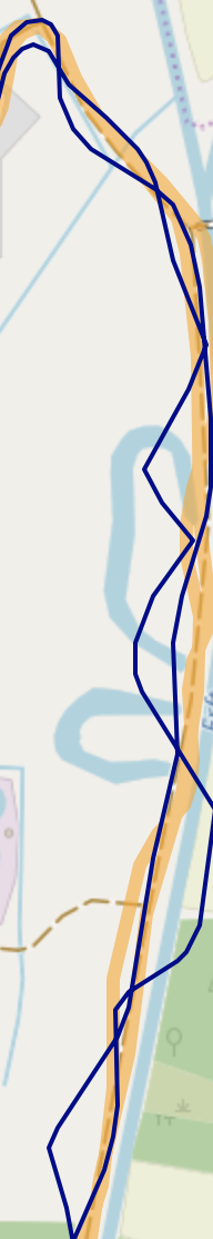

Reposting it here as it is not wanted in the Workoutdoors thread:
Repeated my run from Wednesday with same conditions (LTE on, iPhone disconnected). This time with WOD instead of Apple workouts.
The track is a little bit more wobbly and distance overall more or less the same.
One area is completely off, have a look:

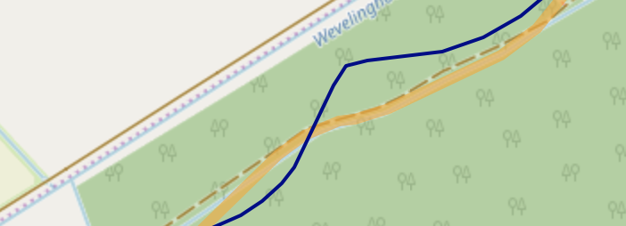

Yellow is the workout from Apple workouts, blue is WOD from today. The area is (obviously) a small forest. Not too dense tree covers though.

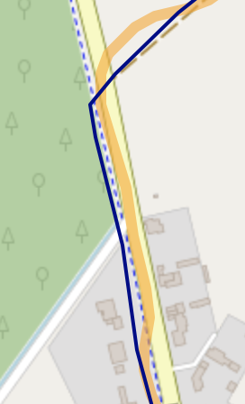

Also, what can be seen in the track, sometimes the track is not connected.
Can be seen here better, interestingly one my way from and back home almost at the same position (no idea what is there exactly, nothing obvious):
@cfc : I can share the TCX Files with you, if you want.

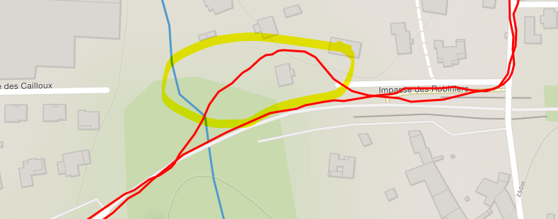

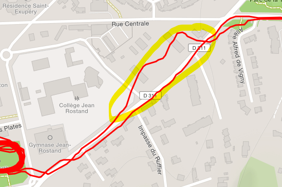

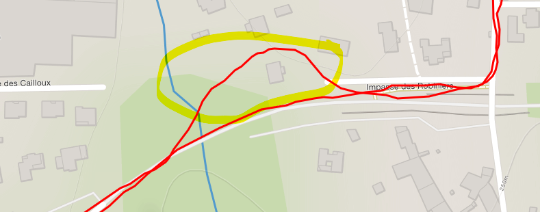

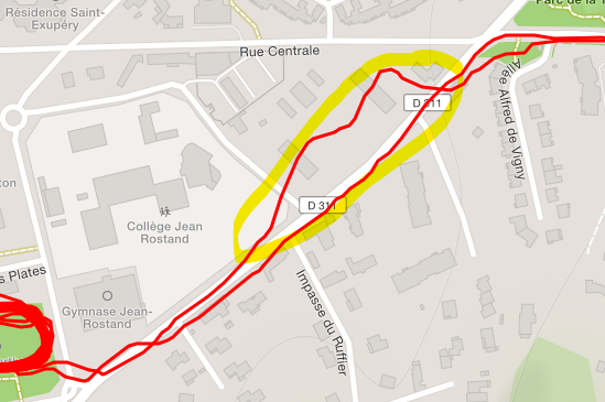

I have a Series 5 44mm LTE watch for 5 days and I have noticed terrible GPS accuracy when running with LTE ON (without phone).
It seems better without LTE activated.
The GPS trace is completely strange, with big glitches and the distance is false.
Does anyone has noticed the same ?

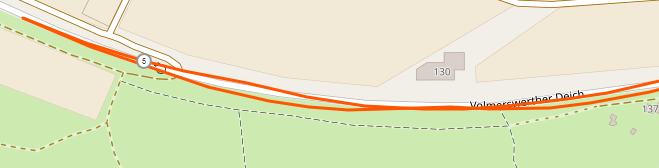

Two samples (again, only a hypotheses). Weather conditions similar, tree cover also.
One from last Friday, with WOD with LTE on:
Today, Apple workouts, also LTE on:

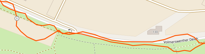

This is where iSmoothrun with LTE failed (I followed the path):
This is also the area where I had major hiccups with WorkoutDoors, but not on this series of runs.
Ok, to sum it up: three runs with LTE off: no problems. Three runs with LTE on: one with problems. Distance in all six runs in reasonable range. Could of course be random, as I have no better explanation why WorkoutDoors worked under the difficult conditions with LTE activated without a hiccup.
