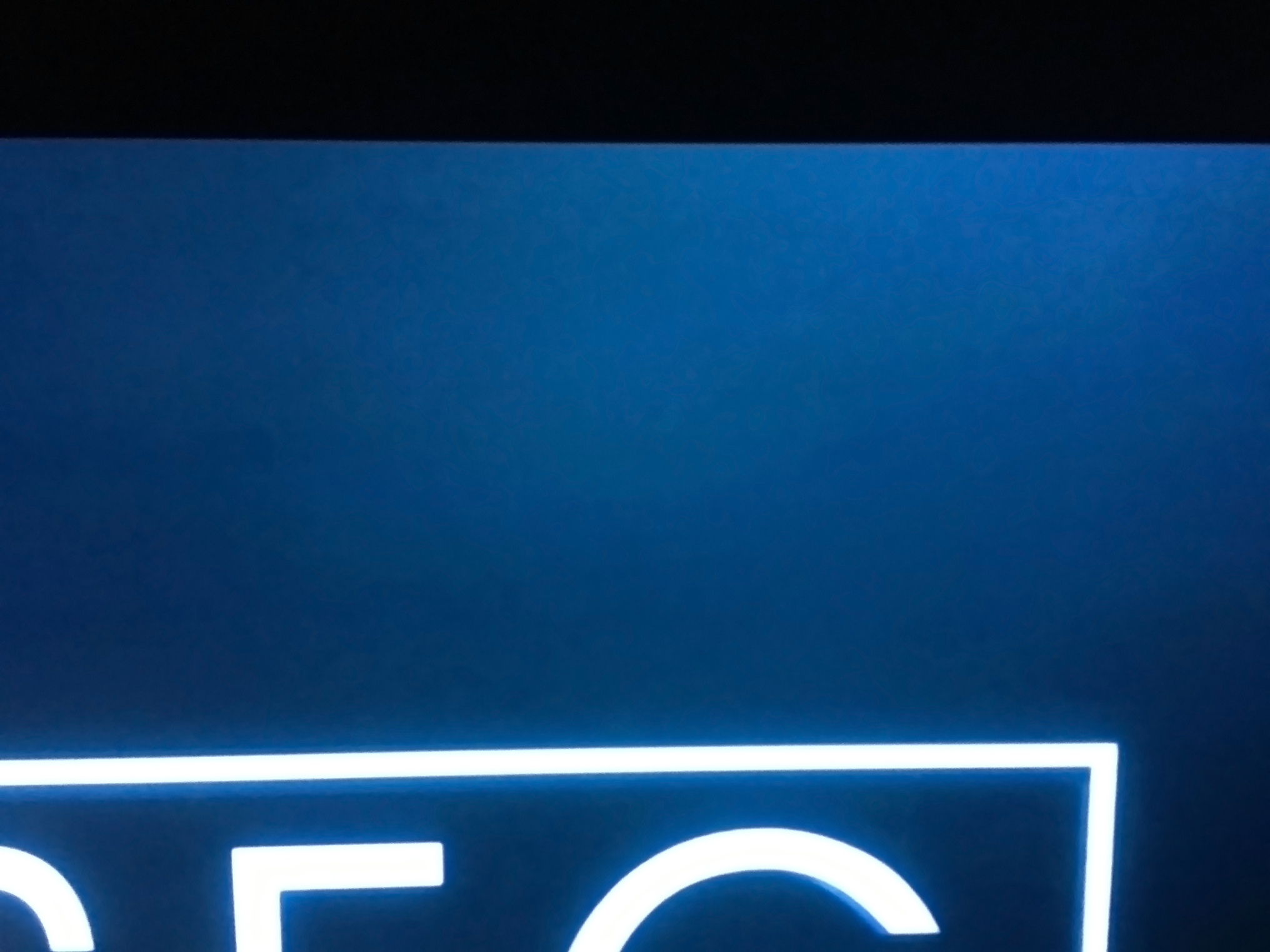

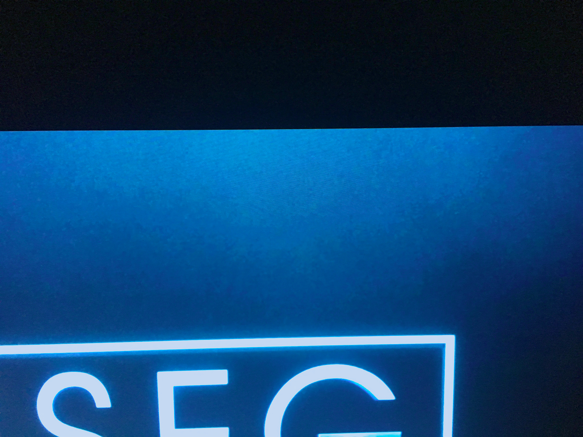

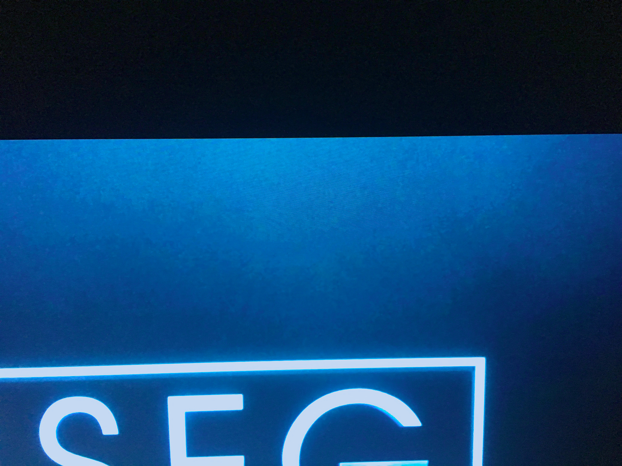

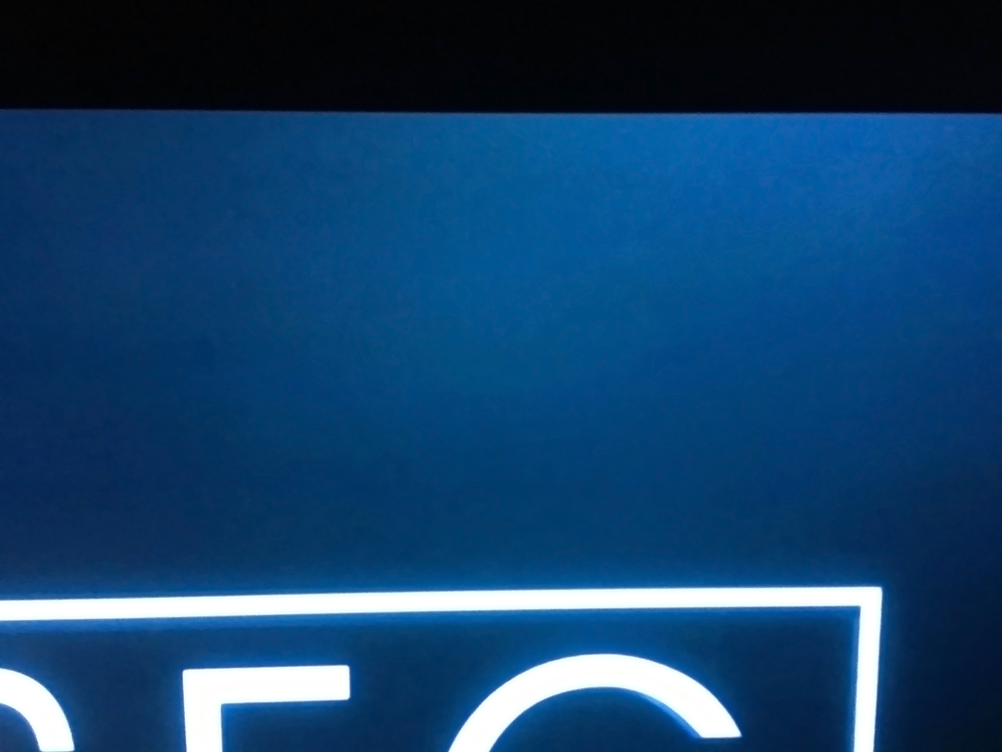

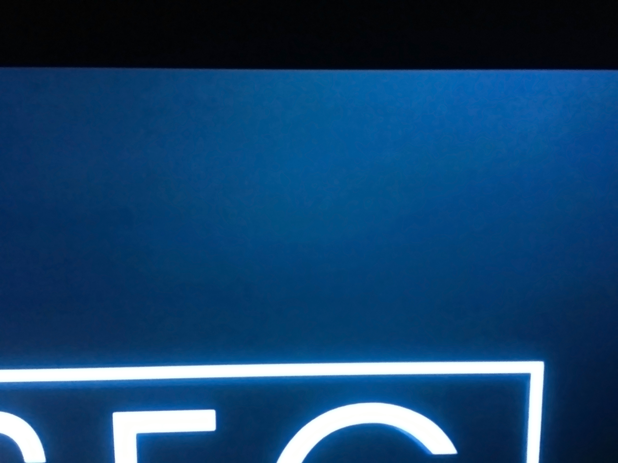

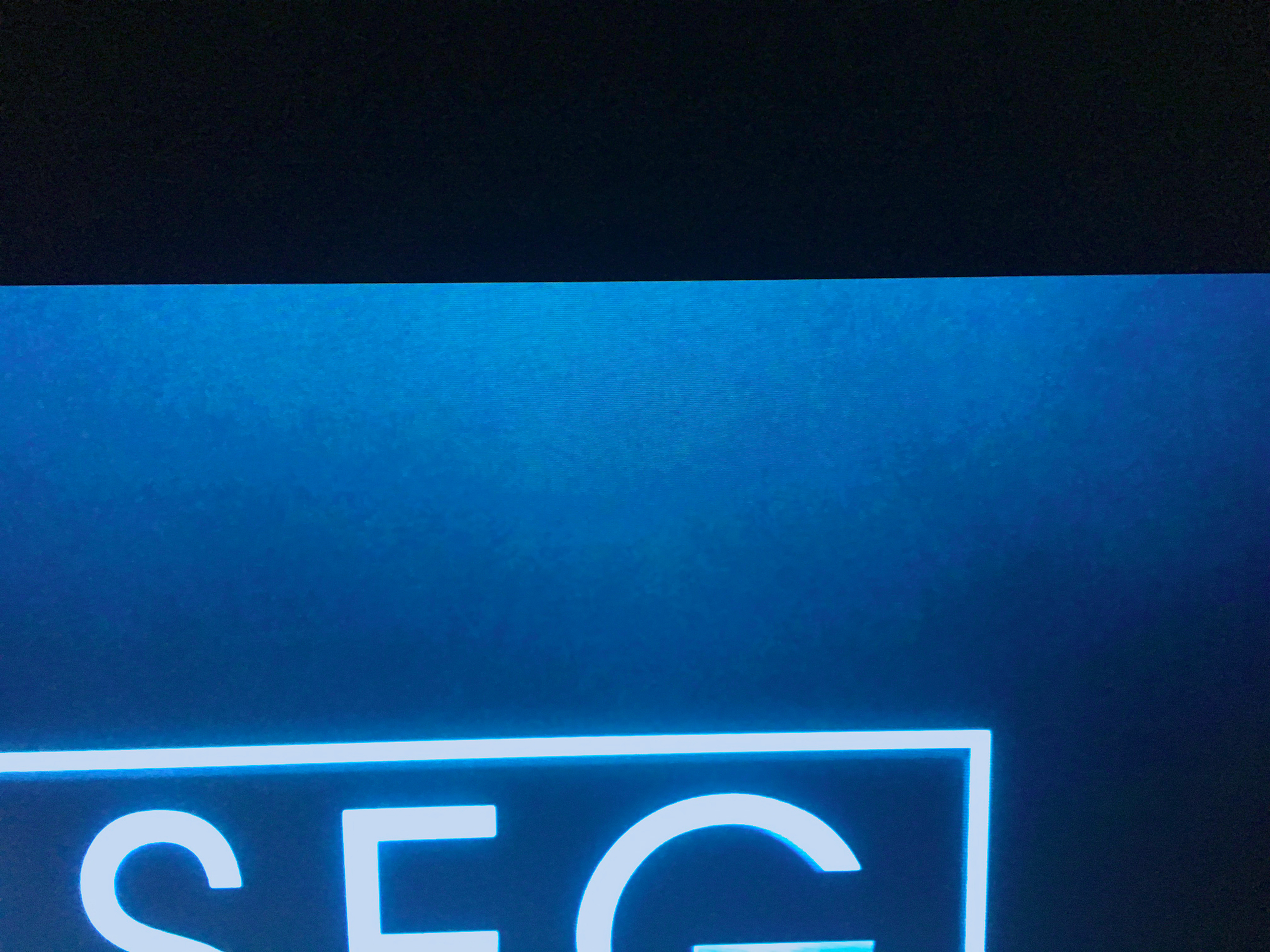

See these two screen shots showing he difference is noise from the TV's Netflix and the AppleTV 4K. (note these are not screen grabs but photos, so are in no way scientific, but do show the difference in quality)
I have also included a short video showing Blade Runner 4K. This was actually difficult to watch as the noise was so bad.
