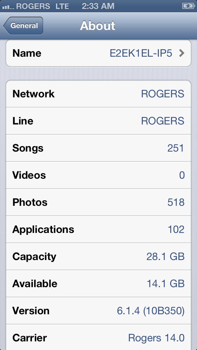

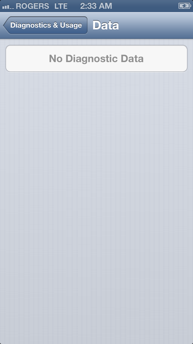

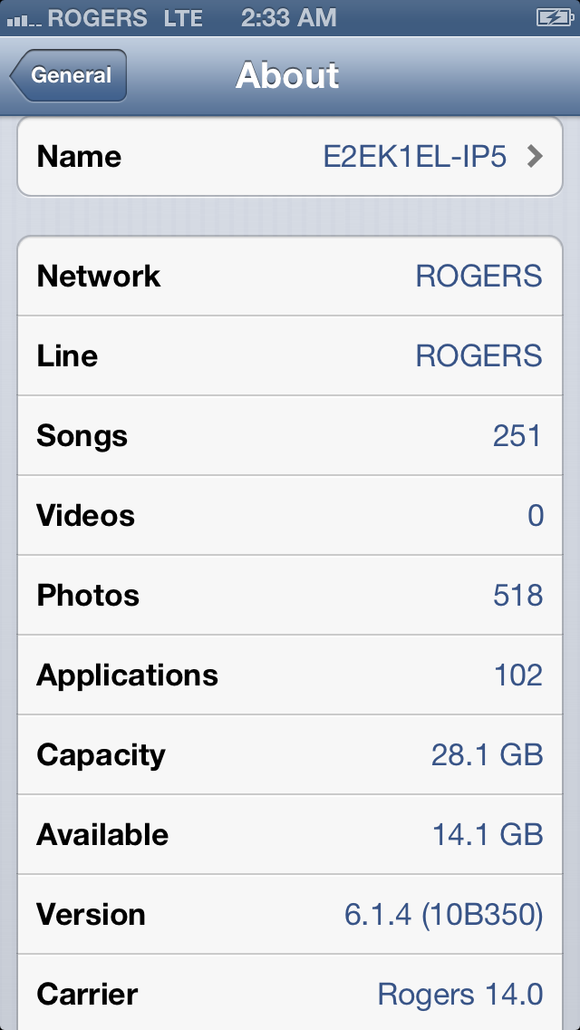

I can assure you its happening on IOS6

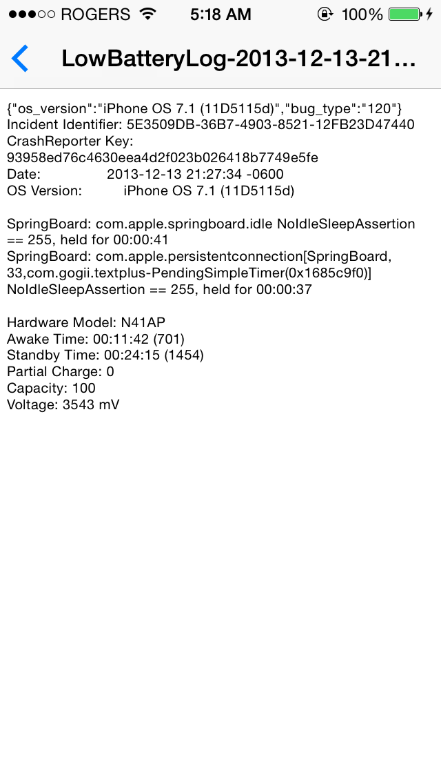

I have an IP 5 on IOS 6 and in the hospital this past week it shut down with 17% left.
While it could be software its not limited to IOS 7 so I suspect hardware.

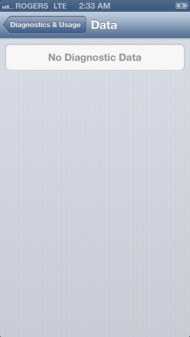

Negative, this have never happen to me nor to anyone know who "reverted" back to iOS 6. A faulty battery causing an unexpected shutdown, the error will be in the logged in the diagnostics logs just like the above post.

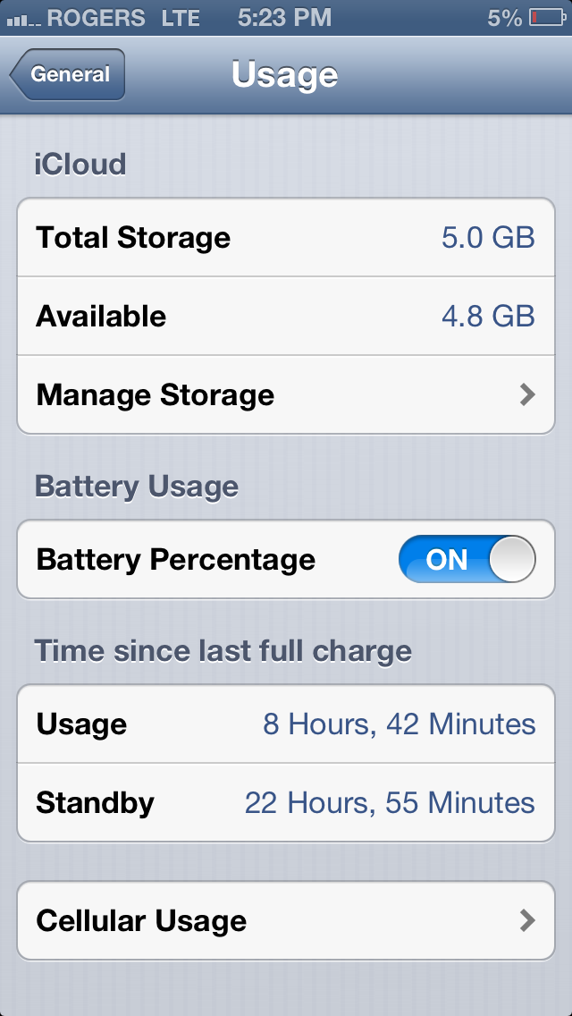

I am on IOS 6 and my phone goes from 17% to dead. You clearly don't know many people…

Sure I do and often yet 17 to zero. Had iphone since v1. Never had this happen until the 5.
Its likely a bad battery. But the issue is not exclusive to ios 7.

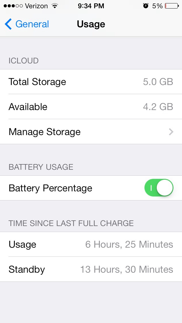

Yesterday I backed up my iphone (to my computer not icloud or via wifi) and did a complete restore and loaded the backup back onto the phone. Afterwards I haven't had one crash and the battery ran down to 5% with no issues at which point I plugged it in for the night.

I finally decided to fix the shut down problem on my phone. So I restored my phone as new and put it on 7.0.4. I gave up on my beloved jailbreak. I tested the phone for two days and every time it got below 20% it will shut down. One time it was at 5% and the other was at 14%. When I plug it i, it will come back to life and the meter would read more than 20%.
So since my phone is doing this on iOS 6.1.2 and iOS 7, then it had to be hardware problem.
