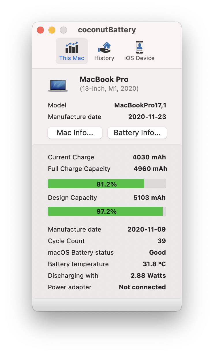

This seems like a huge decrease in battery health. Cycle count is 39.
Coconut battery report below:
Computer has been in daily use for six months and is usually always plugged in.
Doesn't look right, coincidentally I'm at exactly the same cycle count! Your temp is rather high!! I try and not use the laptop when plugged in.

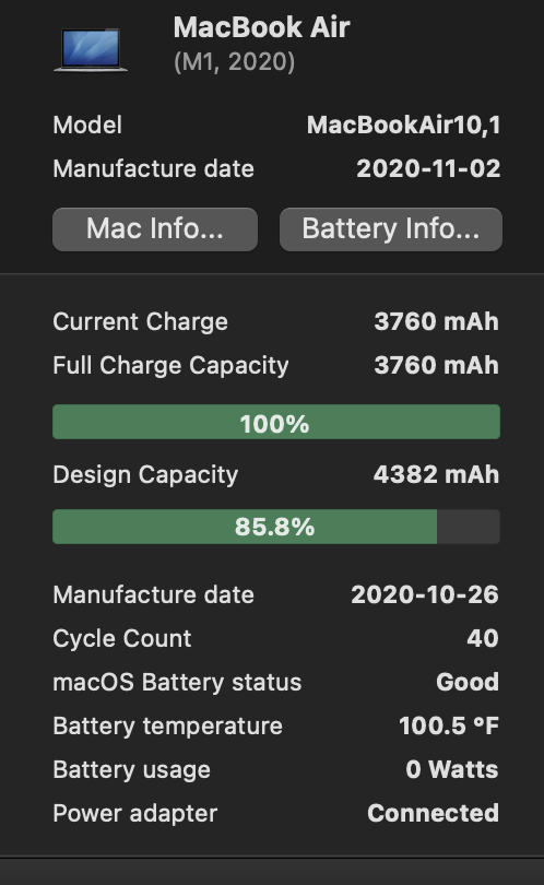

OP here... just one week later and I'm down to 85.8% according to Coconut Battery. And to 93% (from 94%) according to Apple Battery Health.

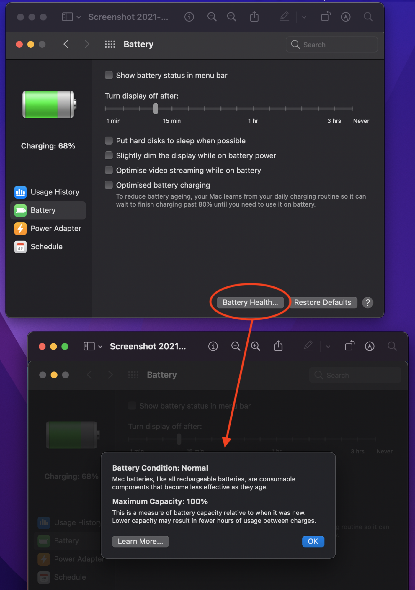

Two places:
1. System prefs > Battery:

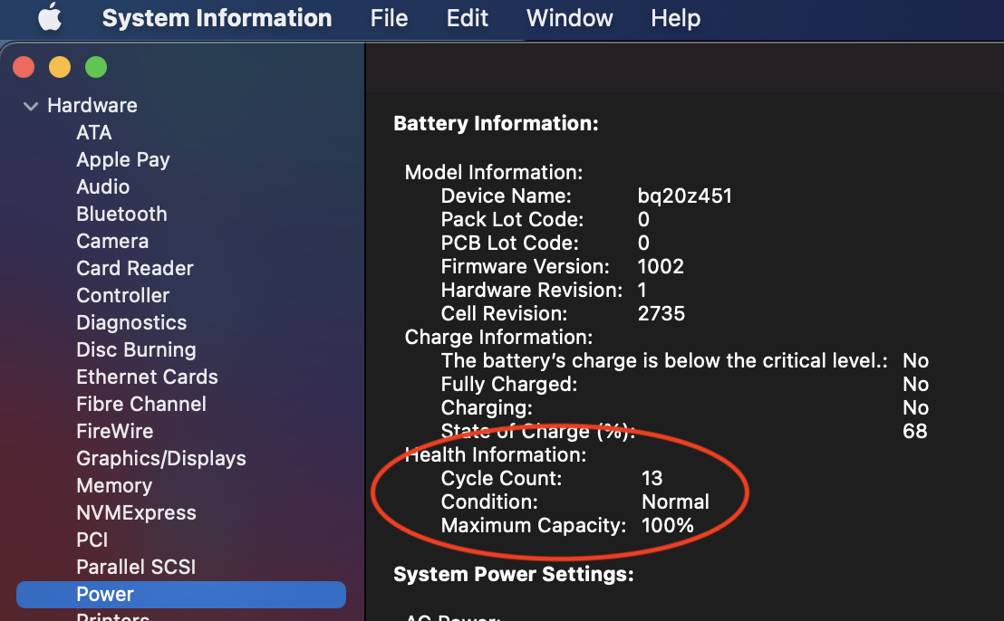

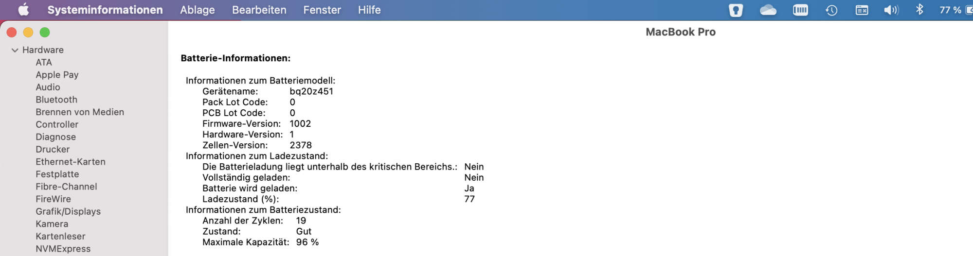

2. About this Mac > System Report > System Information > Power:

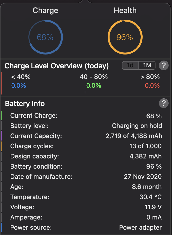

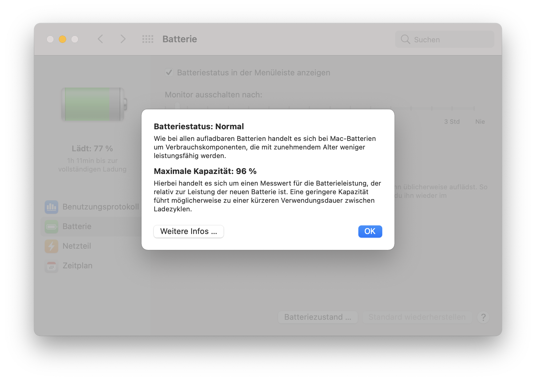

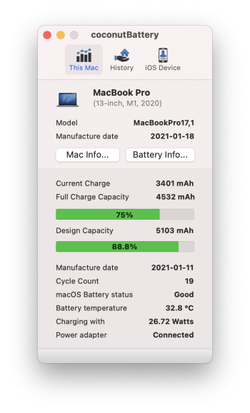

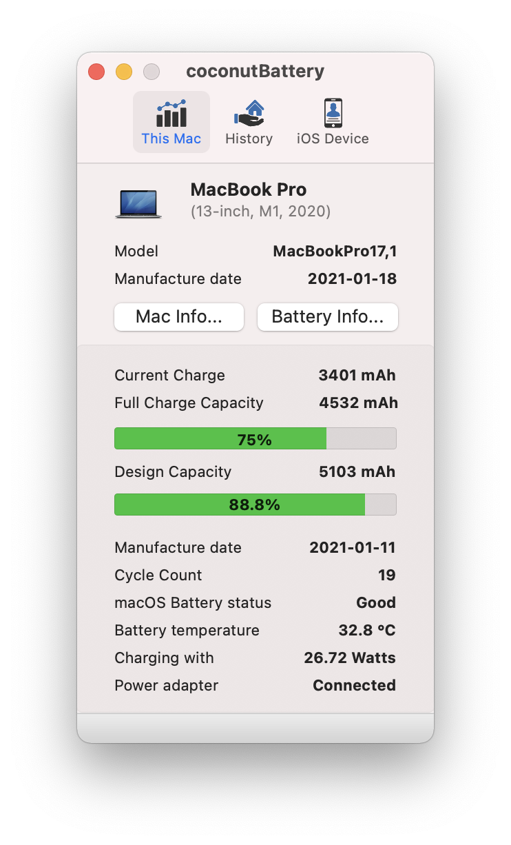

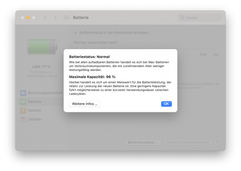

As said earlier, Coconut and other third party apps use the ioreg number which fluctuates daily and the reason why Apple gives us a averaged/damped number. I use Better Battery 2 rather than Coconut. This is showing my Battery Health as 96%.

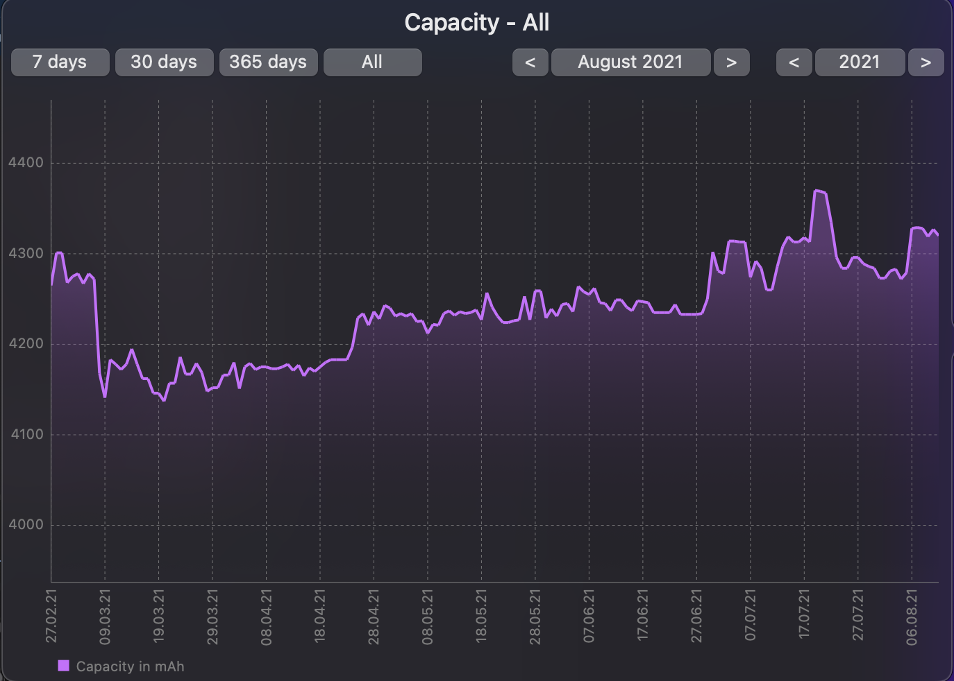

To show how much the ioreg/Coconut/Better Battery2 number can fluctuate, and that health can go up as well as down, here is my max capacity plot since February. (this is from my other Mac not the one above)

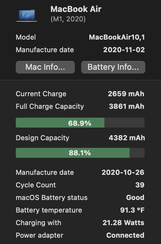

M1 MacBook Pro (built 1/18/2021) with 43 cycles
Currently
Coconut Battery reports 88% Health
Apple (via Battery Preferences) reports Maximum Capacity: 93%
I routinely exercise the battery and now started using Al Dente with a charge limit of 60 - 80% earlier this month.
For the first three months, battery health (according to Coconut Battery) was great:
Month 1: 100%
Month 2: 99%
Month 3: 98%
Month 4: 93%
Month 5: 90%
Month 6: 89%
Month 7: 88%
Very surprised that battery health on my M1 dived so quickly. Never had this issue so soon with my Intel Macs. Funny enough my 31 month old iPhone XR also has 88% health @ 716 cycles.
