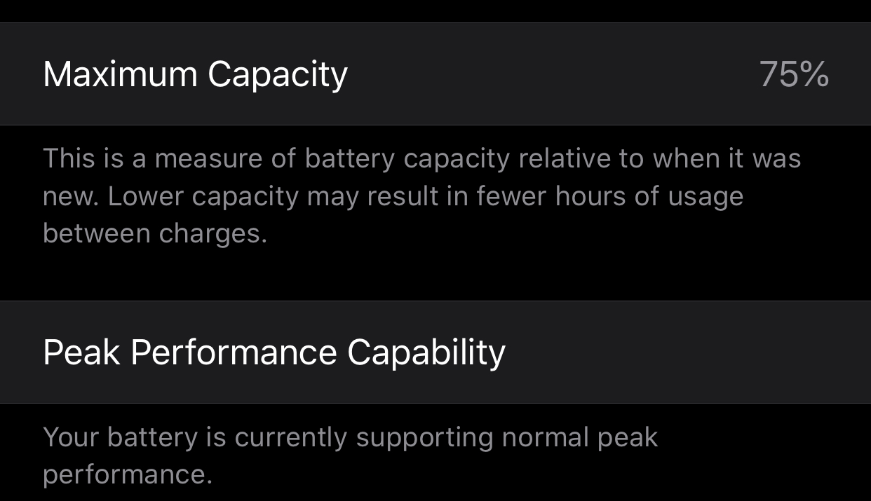

As it stands now, my iPhone 7+ battery is at 75% Maximum Capacity. I’d like to learn a little more as to what exactly this means, and how it might be affecting my device’s performance. I’ve noticed slowed animations and general freezing over the past month or two, but I’m not exactly sure if it’s at fault of the battery. If anyone has some information to share, I would greatly appreciate it!

Pretty interesting. What’s weird is that my phone says it’s still working at peak performance, and I’ve never experienced a random shutdown.

That is pretty interesting. Typically, Performance Management is enabled when the capacity drops to around 80%. If the Battery health is correct, then your performance issues are unrelated to the battery.

The shift from peak to degraded performance is not dependent on the battery % the software might have a monitoring system for unexpected shutdowns before it switches over to degraded performance Label and management.

The battery health app will show Peak Performance (un throttled) until there's an unexpected shutdown. Crashes almost always happen in the winter when the phone and battery is cold.
If there's just one crash due to low power, iOS will throttle the phone from then on until you reset that setting
