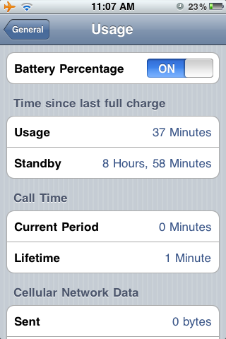

I too was seeing terrible battery life. I had the following on -
Light surfing (both 3G and wifi)
Approx. 30-40 txt
5 phone calls ( less than 5 minutes each)
Push on 3 accounts
BT off
Location on
Notifications off
Movie searching from Fandango app
And it looked like this -
I did a complete discharge, a full charge over night and then shut off notifications, changed two of the push accounts to manual fetch and left the other on push - not sure which one(s) made the difference, but I am now seeing much better battery use. I am going to drain it completely again and do the same thing, then slowly turn things back on and see what happens.
Yeah try the charge/discharge. I never thought that it would help but as you can see my battery life this weekend was AMAZING! I was shocked!
