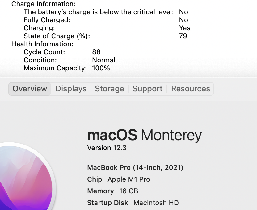

Furthermore, on my M1-Pro, which I've had for around 6 months now, the battery health is 100%. It's used the same way I used the 2020 Air which was 82 percent after under 100 cycles in 12 months (M1-Pro has 30 cycles - 2/3 the discharge cycles over 1/2 the time - but that's because the battery life is so damn good).
