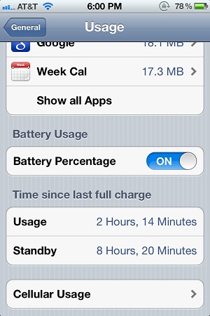

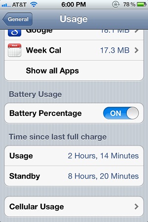

here's my 4S screenshot
Usage consists of browsing on a mix of Wifi and 3G, making a few trades on the Ameritrade app, live Level II viewing. The Exchange email push was turned on (received about 8 emails), iMessage also turned on. Notifications turned on for text messages, phone, and emails.
No iCloud (deleted account completely), and all location services except for Maps were turned off.
This averaged to about 6 minutes per 1% drop. Brightness was at 1/3rd with auto turned off.
Seems pretty good to me.
