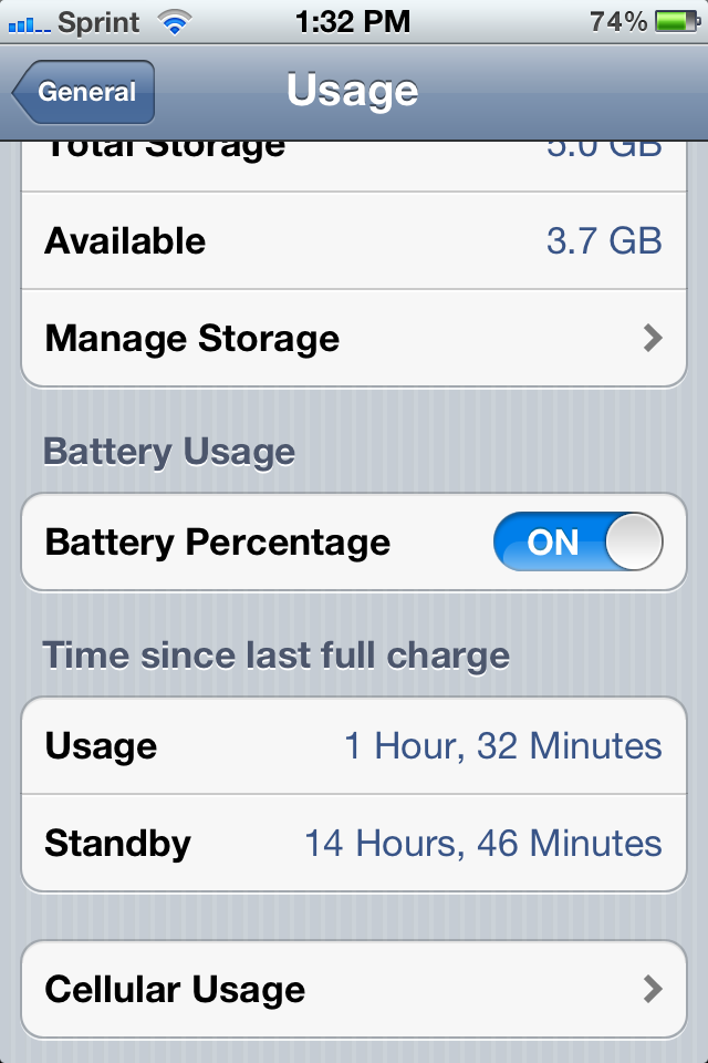

I too noticed an increase in power consumption with iCloud turned on and showed it above.
Here's my updated usage after getting the new iPhone 4S at the Apple Store
Key thing, look at the difference in standby vs. usage. I am using the phone more now, yet the usage is exactly what one would expect from an Apple battery. On my other 4S, these numbers were within 20 minutes of each other after 8 hours, and that was the 20 minutes I tested it in Airplane mode.
Some rogue process always ran when an internet connection was available, regardless of what setting, app, or e-mail account I deleted. It just flat out drained. I bet for most who aren't finding battery improvement through settings, this is occurring to them.
If you are at your wits end, go see the Genius Bar. They'll make the switch.
With these statistics, you are projected to get a little less than 6 hrs usage time.... How do you feel about that? It seems to me you are getting similar to performance as the others here who are complaining.

... the usage is exactly what one would expect from an Apple battery.
Since you have WiFi on and your around 75% battery left after 1.5 hours I can assume that you will get 6 hours total of usage with WiFi.
6 hours of usage while on WiFi is not good battery life for the 4S according to Apple. Should be at least 9...
(btw mine is the same: 6 hours of wifi browsing max)
It was pretty heavy usage, including time with Bluetooth. It's LIGHT years better than bleeding 6-7%/hr, so happiness in this case may be relative :) :apple:
I guess I was focusing on standby time, rather than usage. My usage was pretty heavy this morning, including Bluetooth and Location Services.

You aren't taking into account standby time. The more standby time you have used the less usage time you will have.
For an accurate test, you would have to charge your phone to 100% and then continuously browse the web using wifi until your battery has exhausted. Who wants to do it?

Agreed, and I wasn't on WiFi for all usage; I was in 3G for at least half of it. I'm happy with those usage statistics, particularly the standby, which is light years better than the 4S I returned.

You should be very happy with your standby performance. I have been following your posts and I think you had a real honest to God problem with your iPhone.
The drop in standby time problems are very much real. But what about those that are complaining about usage? Are these problems real or perceived?
What is killing me is usage. I can barely get 5 hours of mix usage (some games, surfing, music listening). I don't think this is good but I really don't know what to expect.
Thanks, yea, something was just off, and I think the Genius Bar finally caved to it being something out of my control since the factory restore did nothing and they saw my awful standby stats with no e-mail accounts or major services enabled LOL.
The usage does appear to drain faster than I'd like, but I'm not normally a very heavy user (I deflect a lot of web browsing to the iPad), so standby was more important to me. It was killing me to be running out of battery at the end of the day right before leaving after only using it three or four times during the day.
