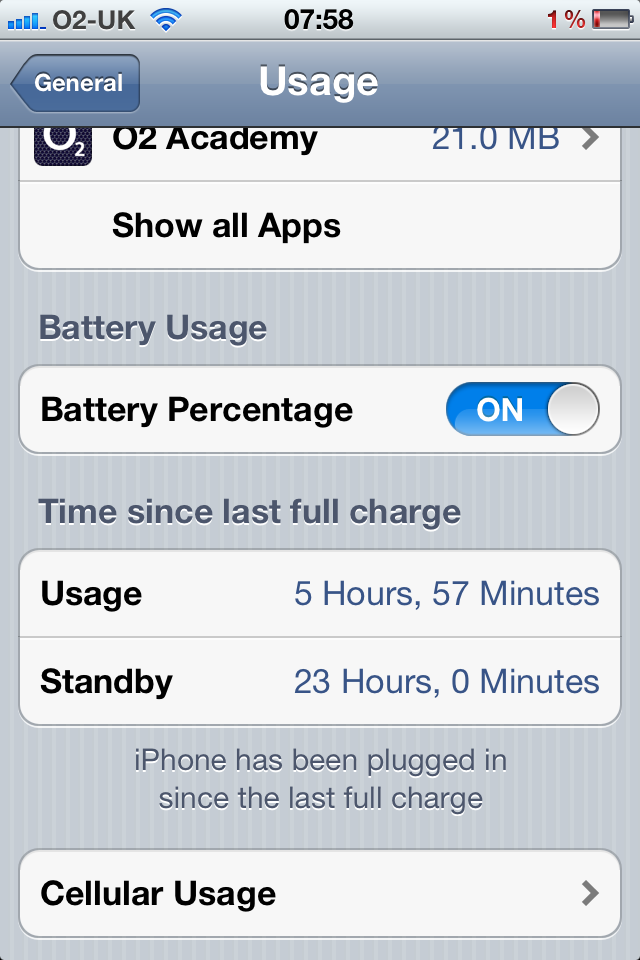

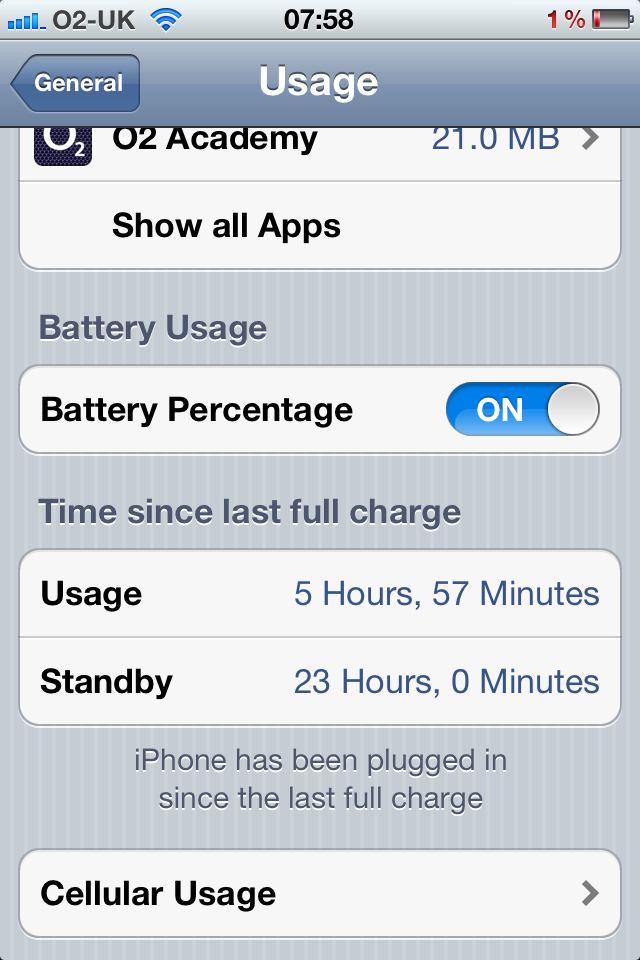

What are peoples thoughts on this useage?
Pretty standard IMO
Mostly apps, browsing, afew calls, quite alot of iMessage/texts
