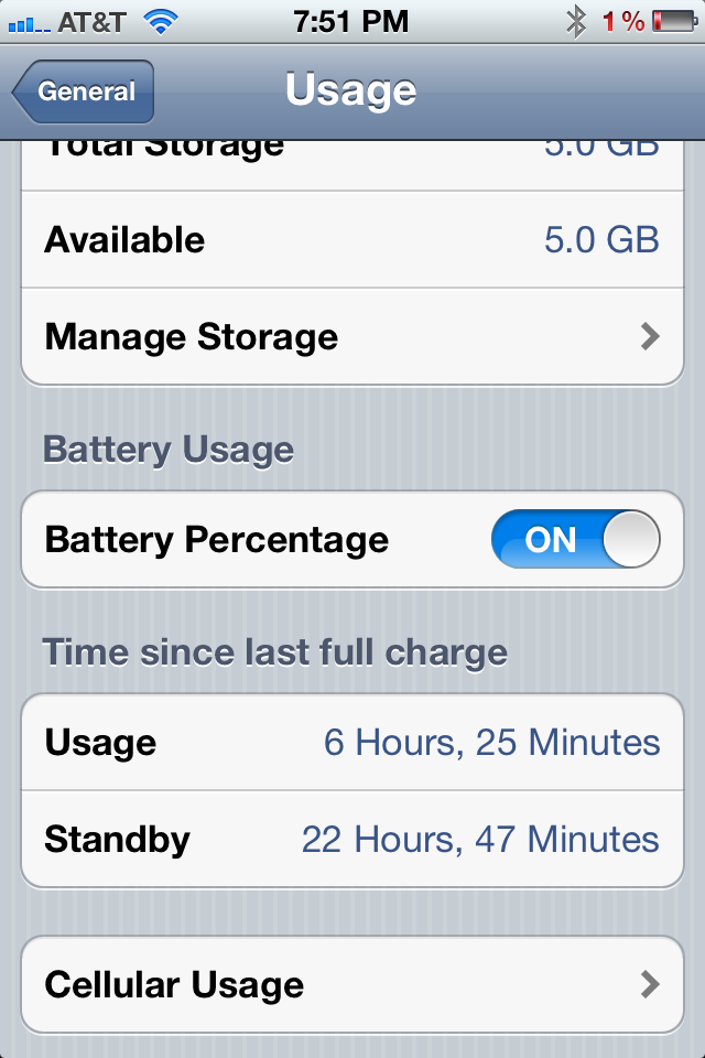

Alrighty, finally got some battery life I can live with. I (i) reset network settings, (ii) ran two consecutive full charge cycles, (iii) disabled notifications for everything I don't regularly use (which isn't much); and (iv) disabled Location Services for Time Zone Adjustment, iAds, and Diagnostics & Usage Reports.
Other than that, brightness at 80%-ish and pretty much everything else fully on, including bluetooth, wi-fi (incl. wi-fi sync), dozens of app-specific network services, about a dozen notifications (including mail), an Exchange Account with everything on including push, an IMAP account with everything on including push, and iCloud with everything on including push (except iCloud backup).

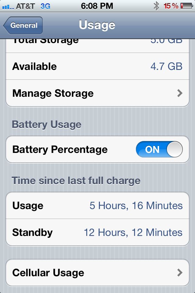

Had a Genius appt today and they said the diagnostics came back with a faulty battery. The phone would also randomly reset itself as well. Tried the restore to new phone, adjusted all the settings, etc, battery could barely make it 12 hours. Had the phone since launch day. The straw that broke the camel's back- I had it fully charged last night at 99% before going to sleep around midnight, and woke up this morning at 8a to it being at 74%. 8 minutes of usage and 9 hrs standby! 😱
Apple's customer service was awesome, I was in and out of there with a new phone within 20 mins. They even gave me a free screen protector since I had one on both the front and back. First iPhone, and while it's been some ups and downs this past week, today made me really happy with Apple.
Hoping this new phone's battery is better.
Quick update. I'm only on the 2nd full charge of the phone, but this battery is working out much better. This is with about 40 mins of gps/maps, some FB & Twitter, plenty of texting/email, wifi off, bluetooth on, and about 2 hrs of voice use. Exchange is push, Yahoo is fetch, iCloud is manual. Conclusion for me- defective battery/device. I essentially have this phone set up the same way as my last, so I can't blame any particular settings on the last phone. Not sure if it makes a difference, but my last phone was DNP, this one is C38.
If you are having issues, I suggest making a Genius appt.
