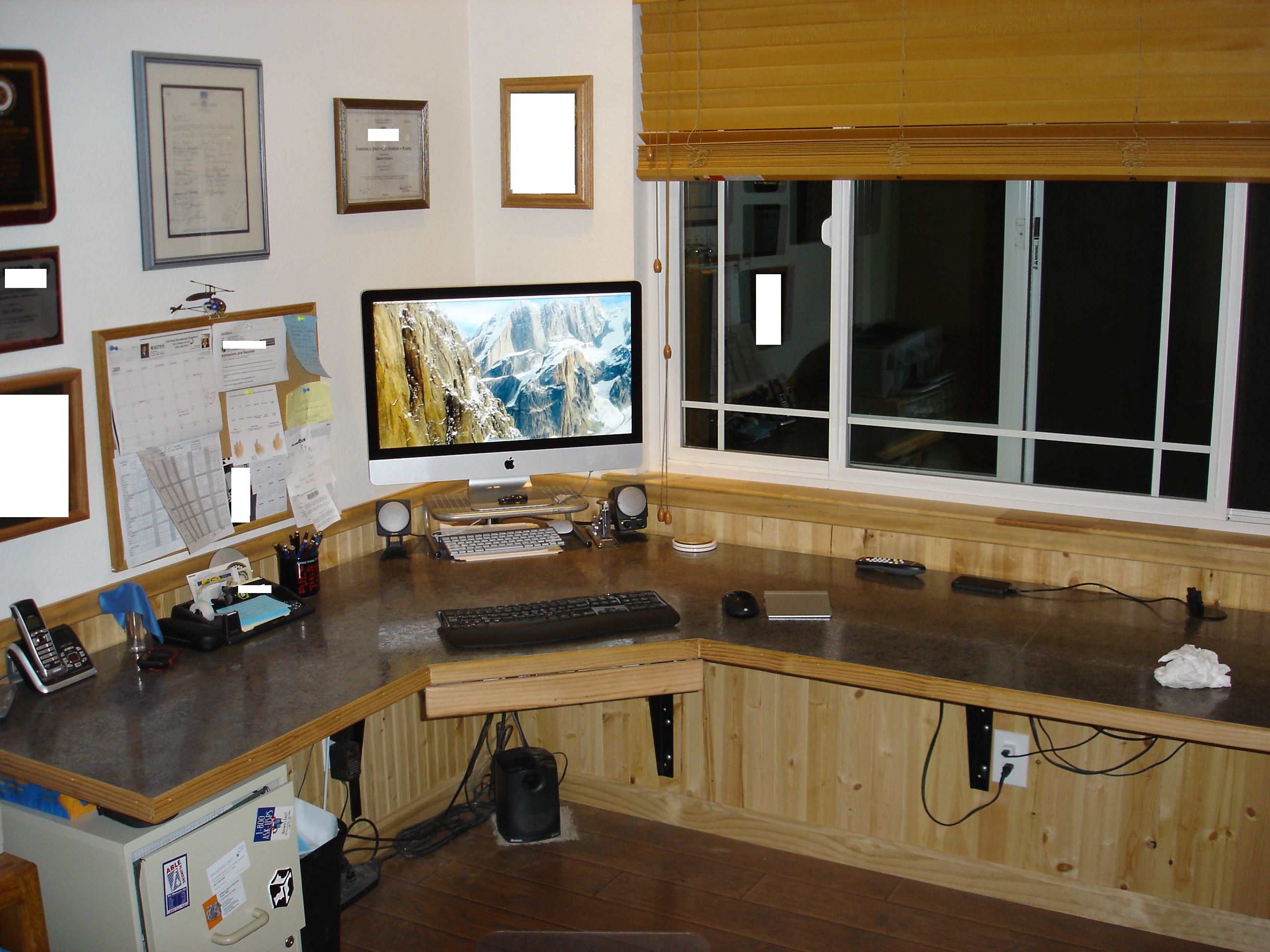

Not sure if this is in the correct thread... While I don't have my iMac hanging from an arm... yet, here is my setup.
The desk is attached directly to the wall, and only about half of it shows. The desk is roughly 12' wide (wall-to-wall) and 26" inches deep. Sorry it's a bit cluttered right now, but it serves me well. There are actually two 'workstation' corners, but a TV sits in the other. The window overlooks most of my 5 acres and at night I can see part of the valley where my Hometown is located.

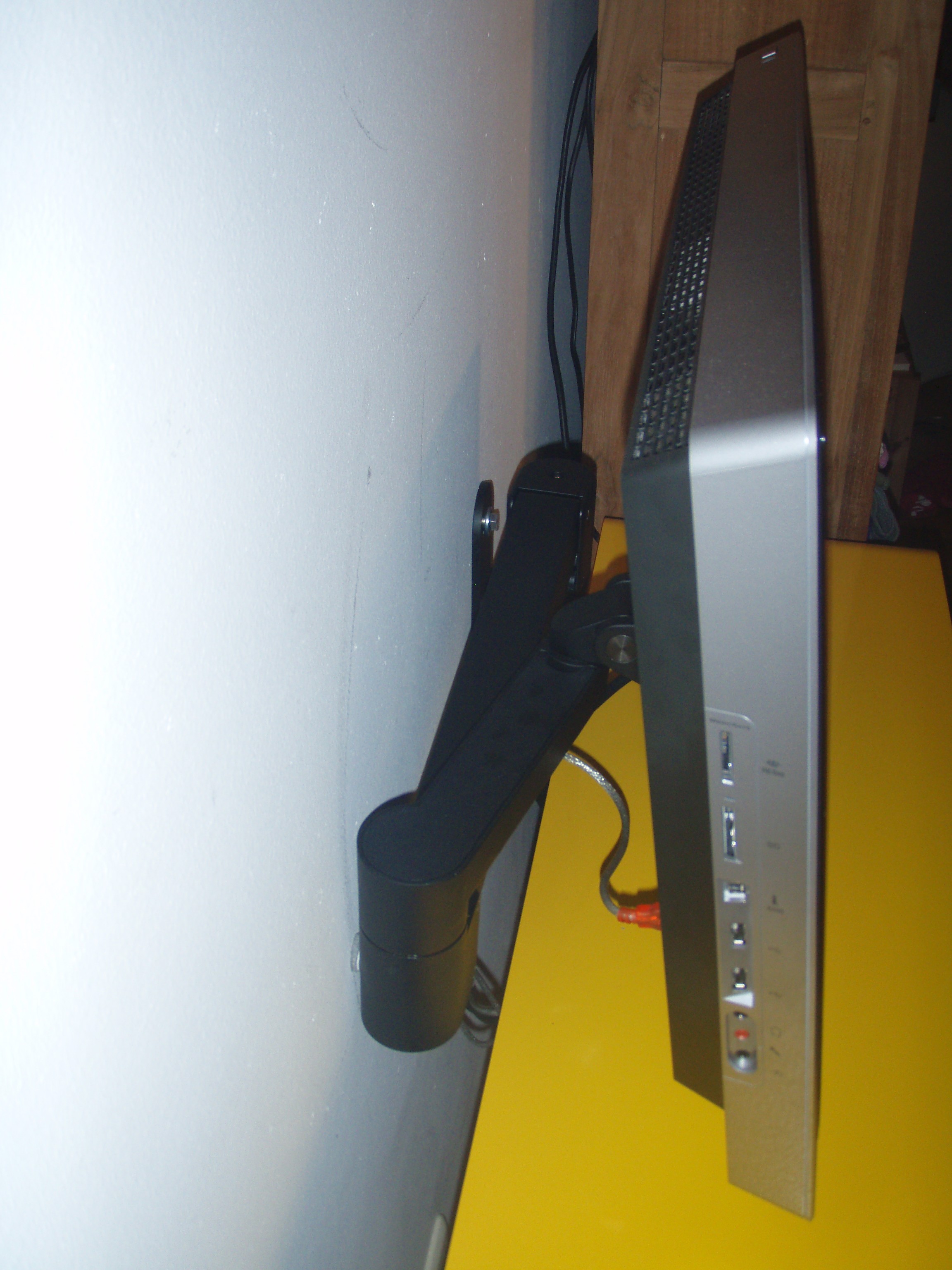

I got your email and thought to share my reply here in case anyone needs it. You can find your answer here, here, and here.
Depth of the iMac with the vesa plate is around 4 inches. As you guessed, both wall and desk mount needs around 8 inches from wall to the iMac surface. An extra inch is needed for the wall mount piece to keep everything "exactly" parallel but this is not needed to keep your iMac flat on the wall.
To make your arm fully hidden as in this picture (though not an iMac) and as flush as possible when not in use, the issue is not only about length and distance in my opinion. Hear me on this..
I have to extend the arm to bring my iMac to the center of the desk so I have to fold the extension part of the arm first if I want to push it away to the side. It is not convenient and at times very hard to do so I stopped trying. The arm is now always extended. Folding the extension part is a must to allow you to hide the entire arm behind the Mac as you wish. None will be shown (as you see in my pictures) but good luck with the folding step first. Not as easy as they show in the video! I believe mostly due to the arm and partly due to the the size and weight of the iMac.
For why I don't like it, I explained my reasons in my previous post. Nothing changed so far in the arm itself, only my behavior. I am adapting to the arm's shortcomings. It is not convenient and this is why I might try the M8 but still this arm is far better than the stationary stand.
Last question to answer is where I bought it? From here. I hope this answered your questions but feel free to ask again if I missed something. Cheer!
