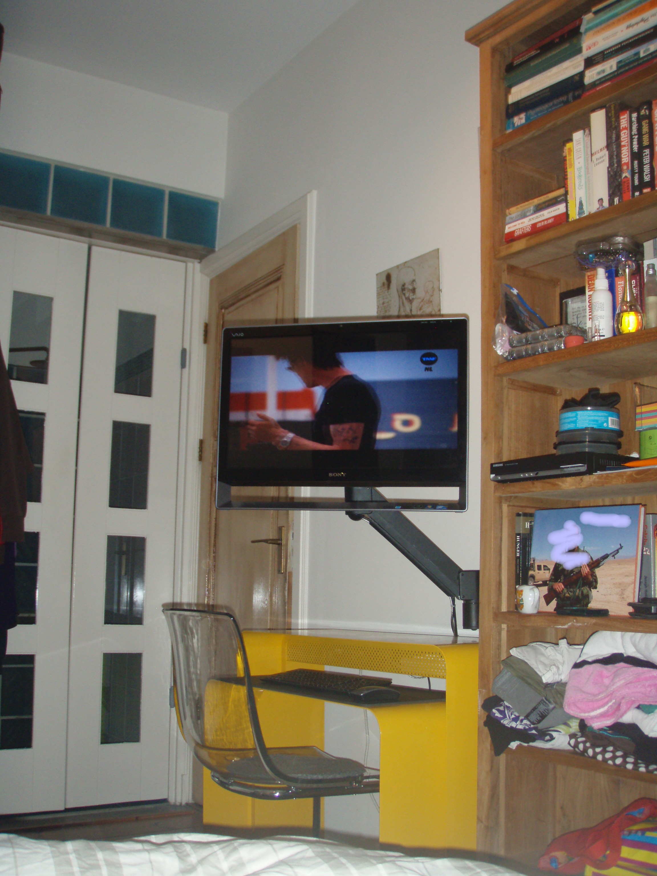

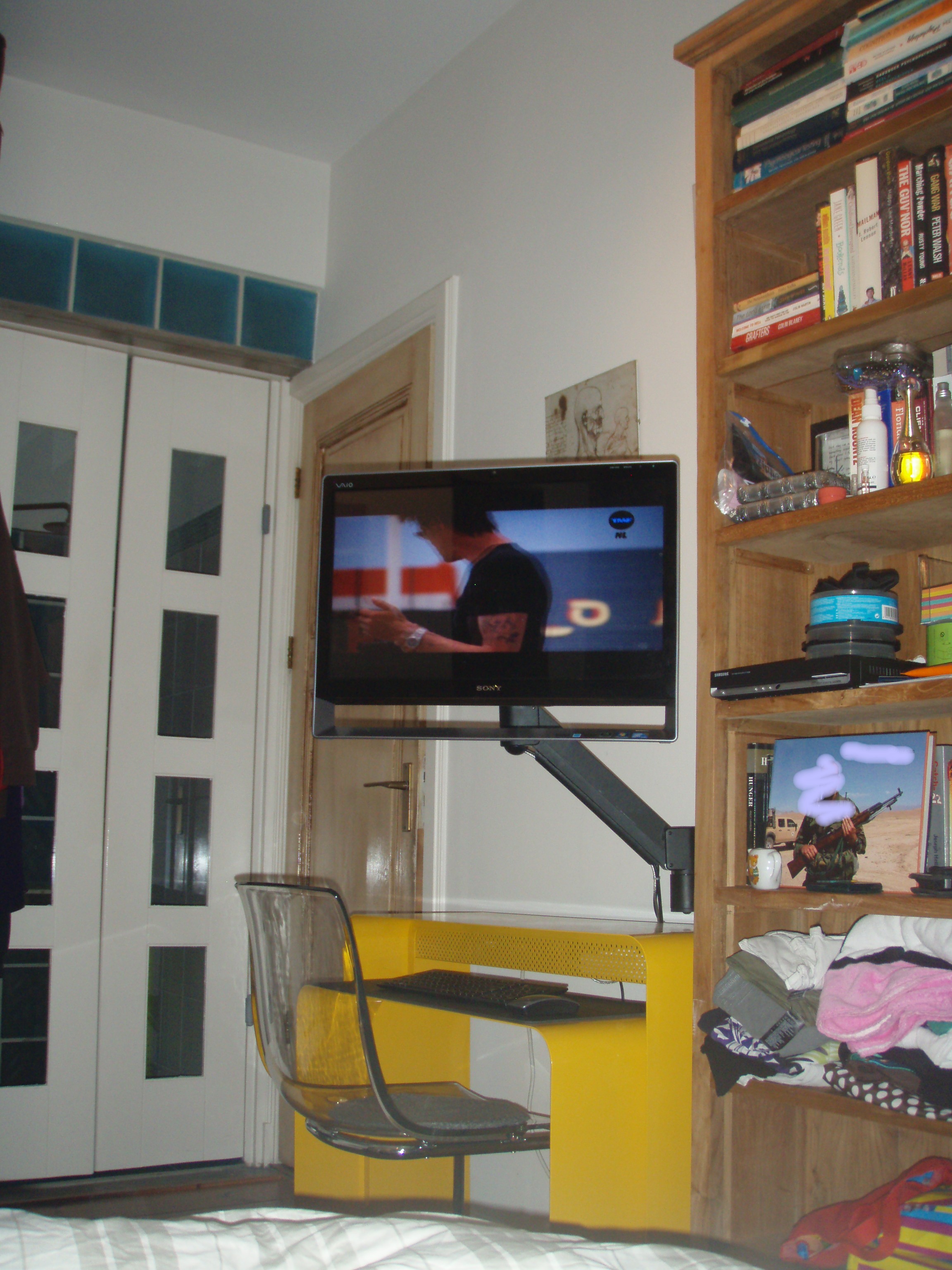

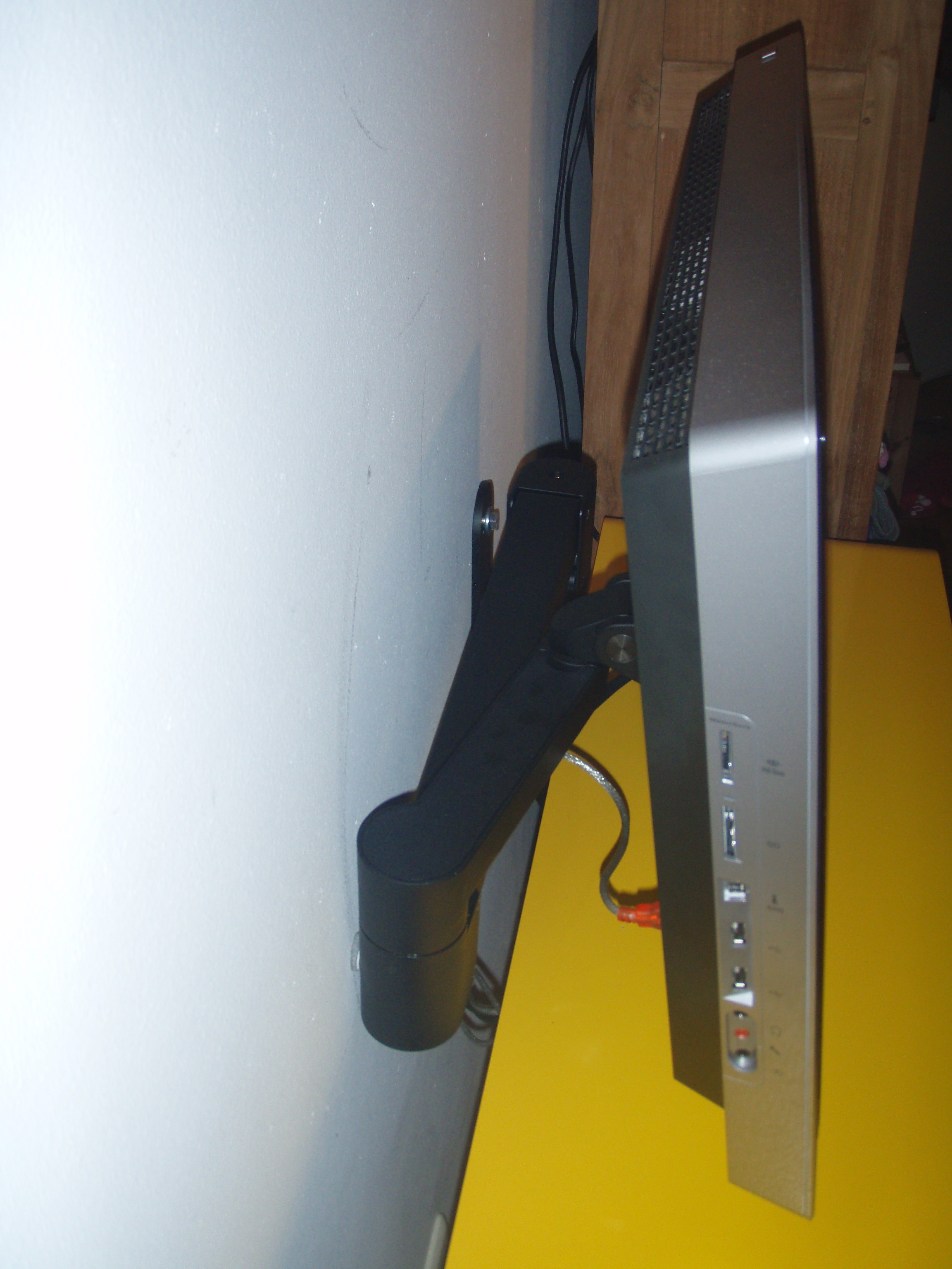

i just purchased the INNOVATIVE 8325-104 WALL MOUNT and the Innovative 7500-1500 arm. i like the looks of the arm on the desk but i think the wall would be much cooler. i'm not sure how to hide the power wire with the mount attaching to a stud. anyone have any ideas how to make it look good cosmetically? thanks for the feedback.
Well, if you don't mind paying quite a bit, you can do what I'm doing - I bought this wall track, and you can run all cables inside the track. They ship it with a black cover (not shown) that slides over hiding the cables completely. In my case, since my arm is white, I'll have to replace the cover to something white, but that should be trivially easy. The advantage of the track is that not only is it very solid and distributes the pressure on the wall very nicely, but it also means you can adjust the mount anywhere you want to - just loosen the screw and slide the mount up and down along the track rails. It's pretty expensive, unfortunately, depending on length (almost $200 for the 49") - but man, is it a good solution otherwise.

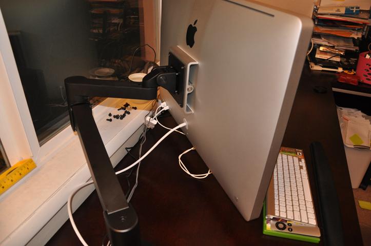

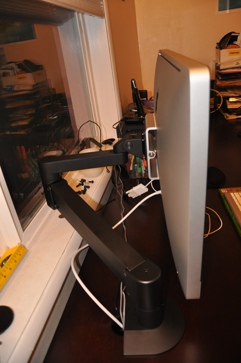

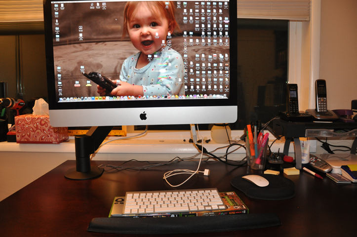

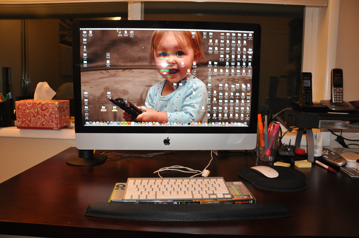

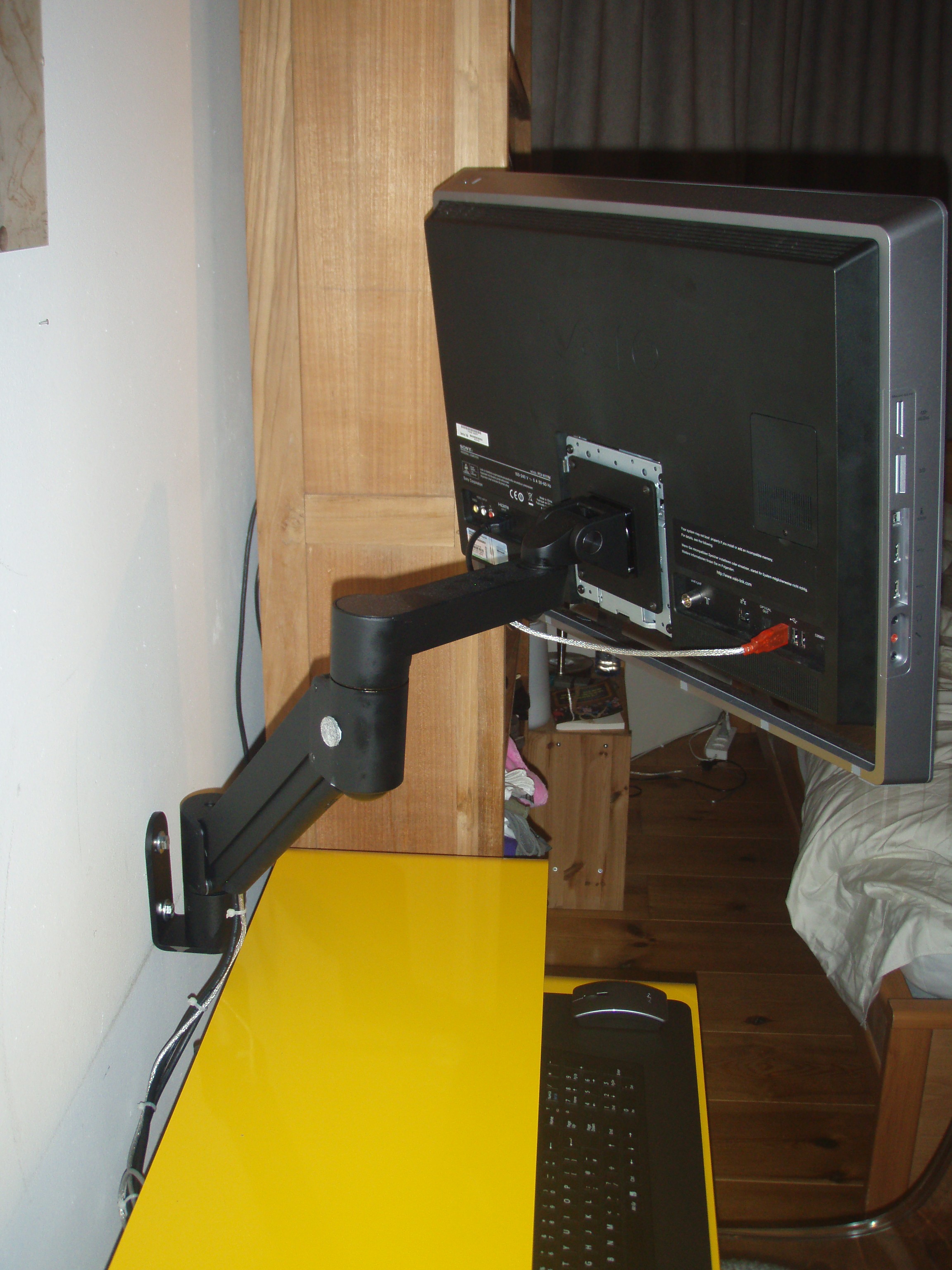

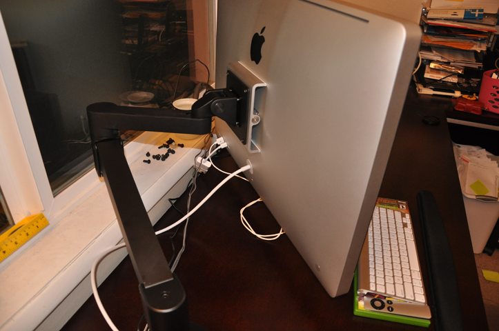

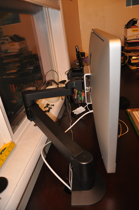

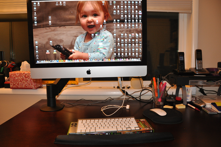

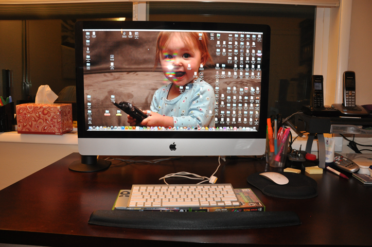

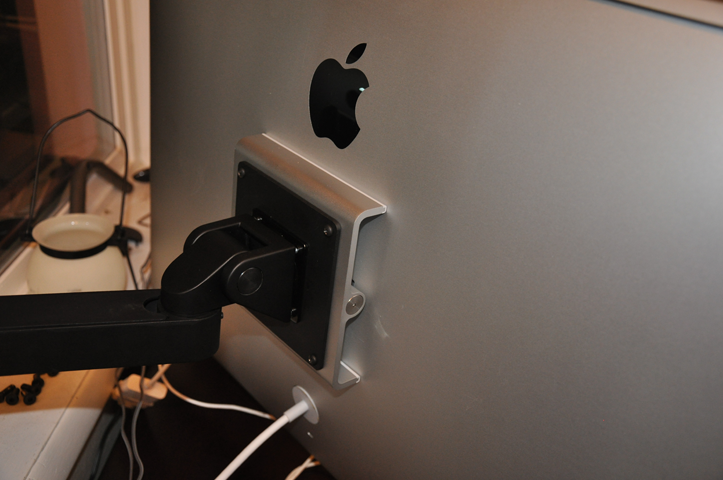

I purchased the 7500-1500 on Amazon, I had to order the VESA adapter from Apple since neither of two local stores had it in stock. It took about 20 minutes to decipher the image-only directions from Innovative and to get the flex mount installed (I used the grommet hole method) and the arm put on. I really had to loosen the hydraulic, that took awhile.
Installation of the VESA adapter was easy enough, though Torx screws are a pain in the butt. I do agree with everyone else that the tilt is pretty tight, I may try the lubrication method that was suggested.
I took a couple pic's for those interested. This was by far the best deal, I have been looking around for a lighter duty arm for my 24" monitor and I may end up with another one of these because they are such a great price.

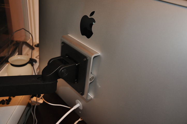

Here are some pictures of yet another person's 27" iMac arm set-up via Flickr.
They are notable in that they include a very detailed photo of the whole VESA adapter kit including the flange, mounting screws, and tools, and then a close-up of how the built-in Apple stand looks when released by the card tool before removing the 8 tiny screws - - I haven't seen pics of those details online before.
Interestingly, in the comments on the Flickr page, the photos' poster notes that the rather stylish looking, though not fully radially articulated arm is from a Japanese company - - the Win Techno LA-6A-1CR, which from the specs has a payload of 15 kg (33 lbs).

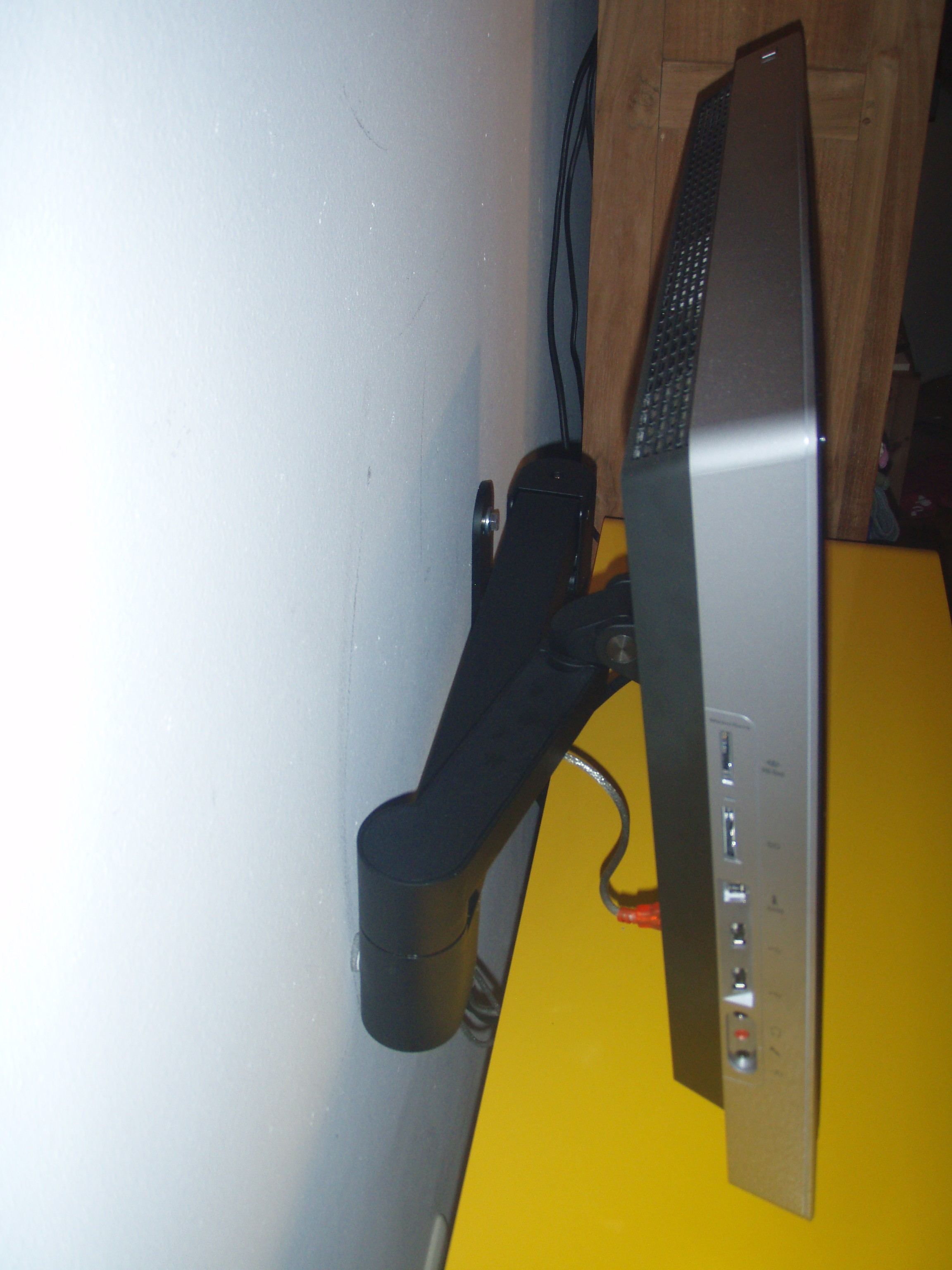

For those who have limitations/issues with the usual desk and wall mounts for their arms, here's an interesting variation made by a company called CyberResearch.
The model pictured above is called the SWA 753H. It is the high capacity model of their weighted desktop stand arm (which fortunately for 27" iMac owners) has a maximum payload of 30 lbs. It's reach of 17.3" is nothing to write home about (and likely offers a fairly limited up and down range for the iMac unless you perhaps sit it on a pedestal/riser/box/shelf of some sort), but for those with restrictions on their workspace or who perhaps want a "portable" solution, this arm may offer you a unique alternative to the other products out there.

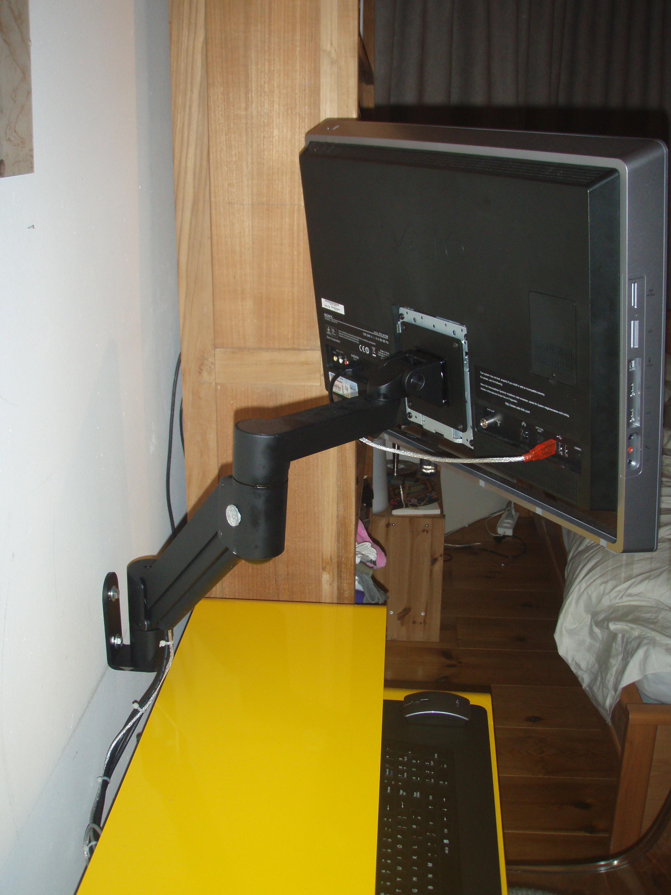

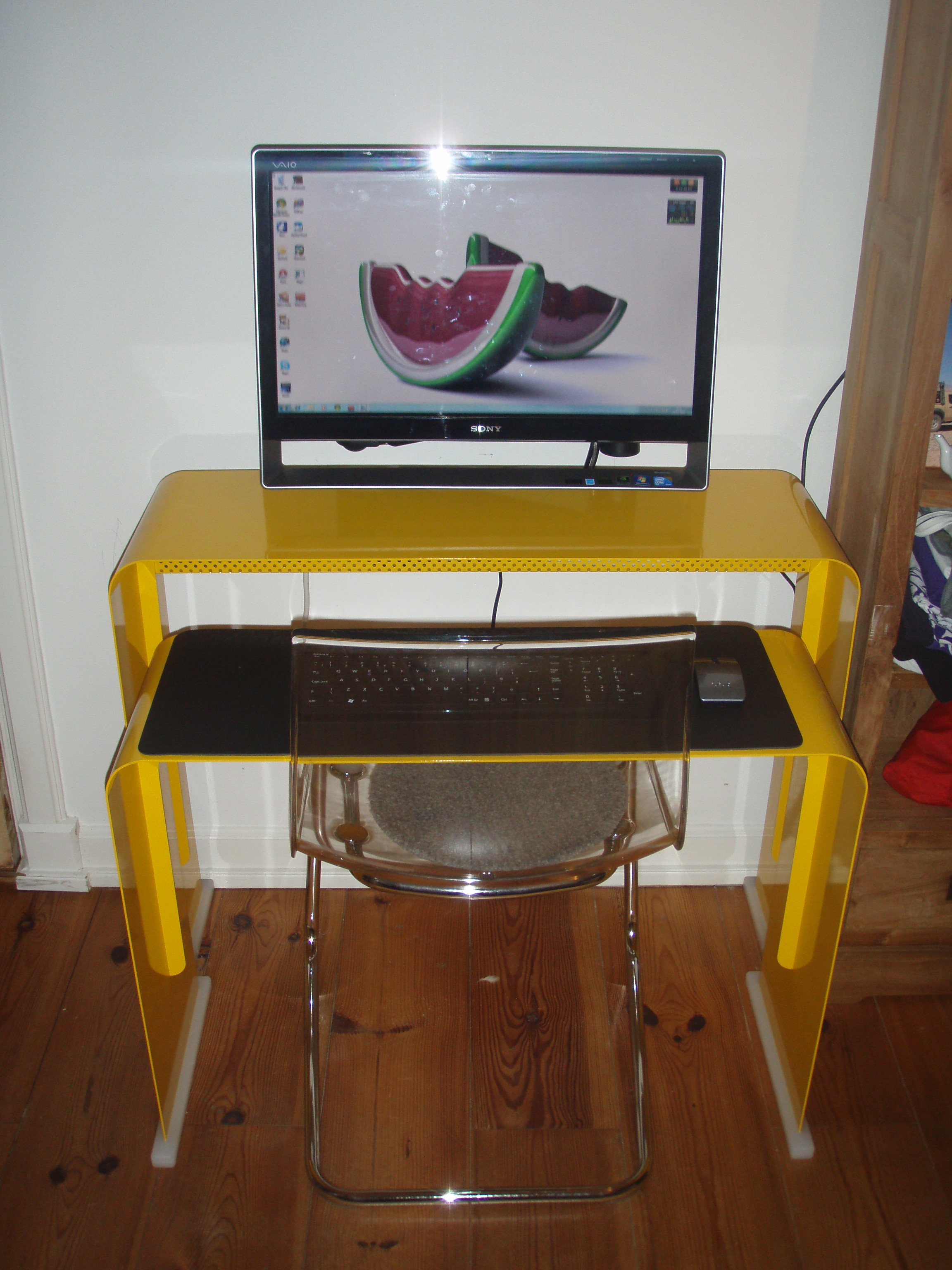

I have one of the new Sony Vaio L Series all-in-one touchscreen PC's (trust me it was a hard call between this and the iMac 27, but the Vaio's combined HDTV functionality sold me).
As the Vaio L is a very new and niche maket product, I could find no other reference to wall mounting systems for it, other than this forum. As it weighs in pretty much the same as an iMac 27, whats good for you guys is good for me 😉
I have added a few pictures of the system in place FYI (and to allow for the inevitable (and possibly deserved) iMac user mockery of a Windows based system 😱)
Sorry for leading you all astray 😱 but hey....the whole system (arm included) works like a dream...so im a happy bunny

prototype71, I too bought the Amazon arm, even though I have a $700 arm from Ergomart already... the deal is just so good I could not say "no"... eventually I plan on getting another iMac, this time a 21", toward the end of the year, and adding it on the new arm which I'll put on the same track... at some point in a few weeks, I'll upload pictures of my current set up.
Couple of points - you'll get no hassle from me, for buying that PC, the more the merrier, and competition is always good. If you were a good person though, you'd give us all a nice review of how you like that PC, what it's got that's good/great etc.
Your set up looks nice, though it seems like your full freedom of movement is somewhat obstructed for that arm. The other thing, is it looks like you got this in your bedroom. Bad, bad, bad, bad, bad, bad, bad, bad, bad, bad move. I try to keep all these kinds of things like TVs, computers etc. out of the bedroom - and even so I have insomnia. You're not supposed to have that stuff in your bedroom - the bedroom is for sleeping and nothing else. I get up in the morning, and leave the bedroom and don't come back until it's time to sleep. Please use your bedroom appropriately - also, you should not give such terrible ideas to people on the forums, it sets a bad example. Please remove that computer from your bedroom immediately. Thank you.
Nothing else?
Well, nothing else that's not bed-related. Besides, I don't need the bedroom to do some things 🙂... also, when I do use the bedroom for that purpose, it's strictly as a sleep aid 🙂 🙂 🙂 - romantic, no?
