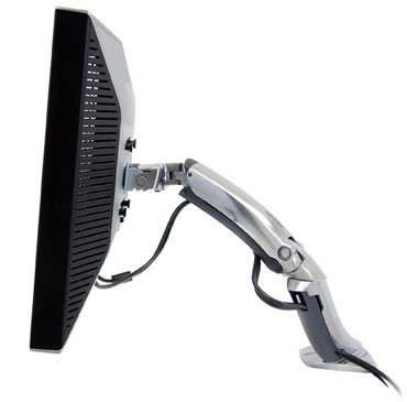

Ergotron MX
Just installed the Ergotron MX on my 27 iMac and it is great. Specs stated max 30lbs at max extension but it holds the imac up with no problems. Very easy install and looks quite nice if you ever decide to stare at the back of your computer.
Picked it up from buy.com for $107 shipped 2 day mail.
http://www.buy.com/prod/ergotron-mx-desk-mount-lcd-arm-30-lb-aluminum/q/loc/111/209871968.html
and look around the net and you'll easily find a $5.00 off $100 from buy.com.
pics to come once I get everything back to normal.
