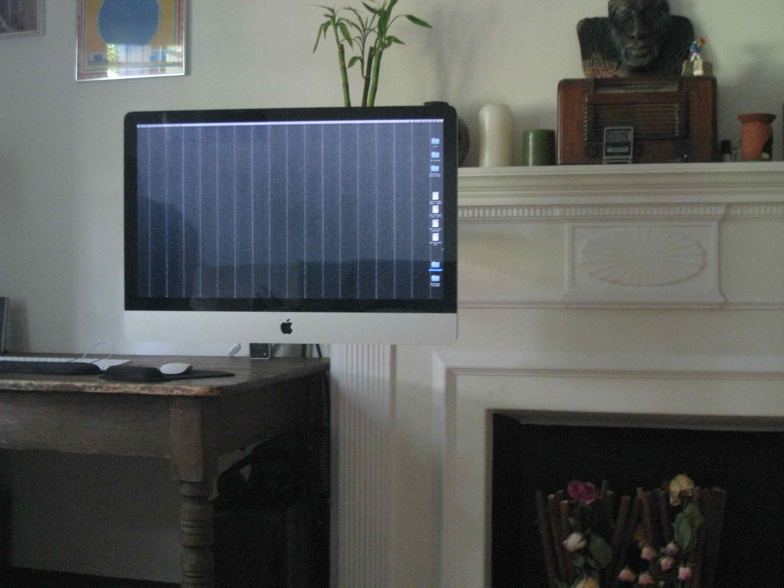

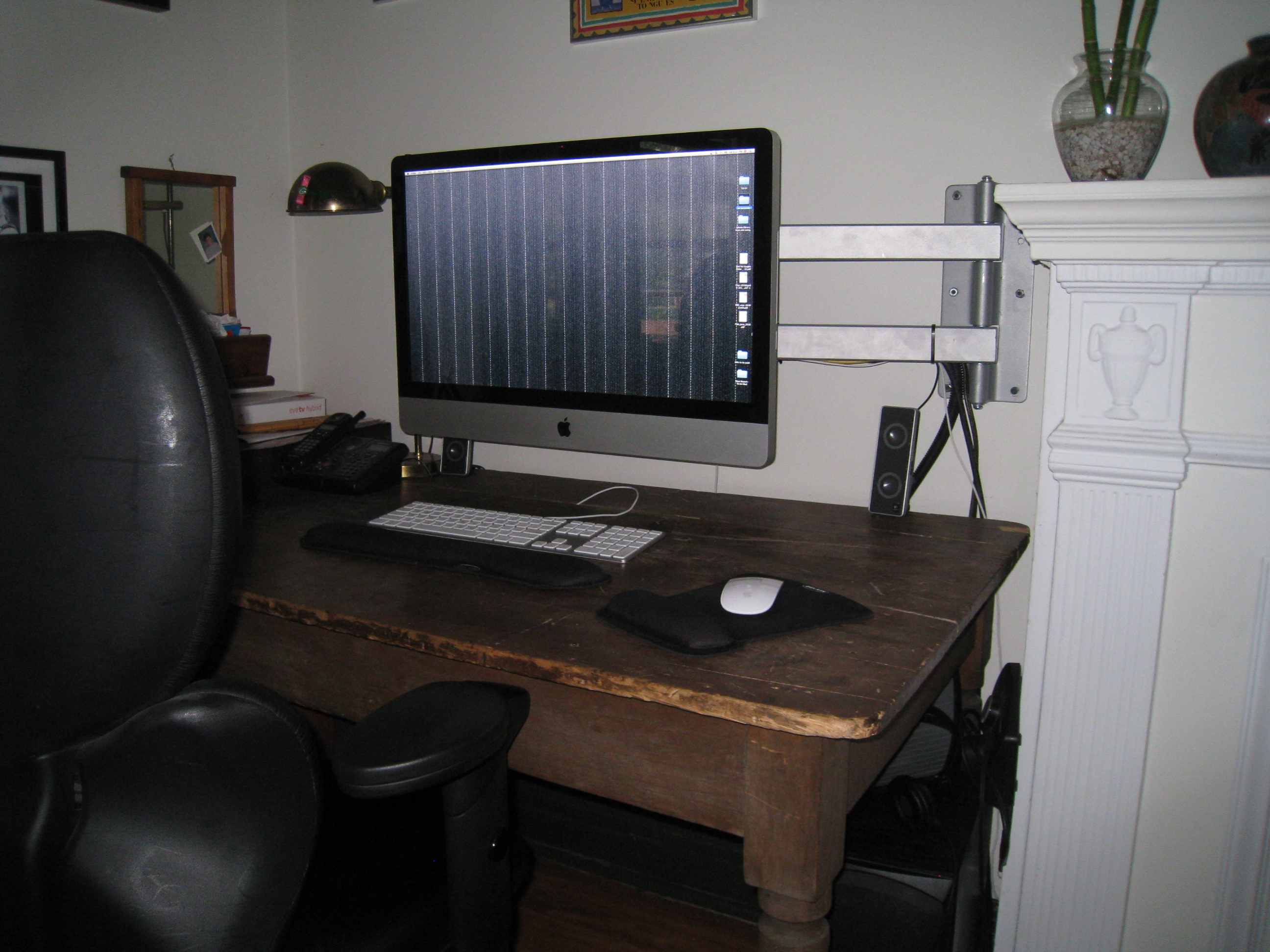

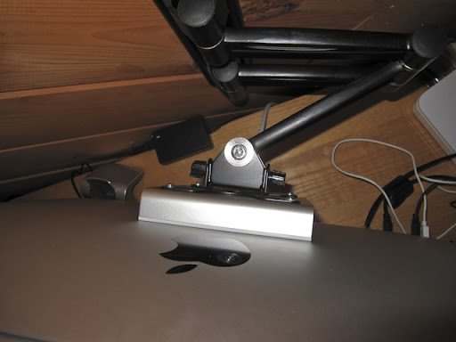

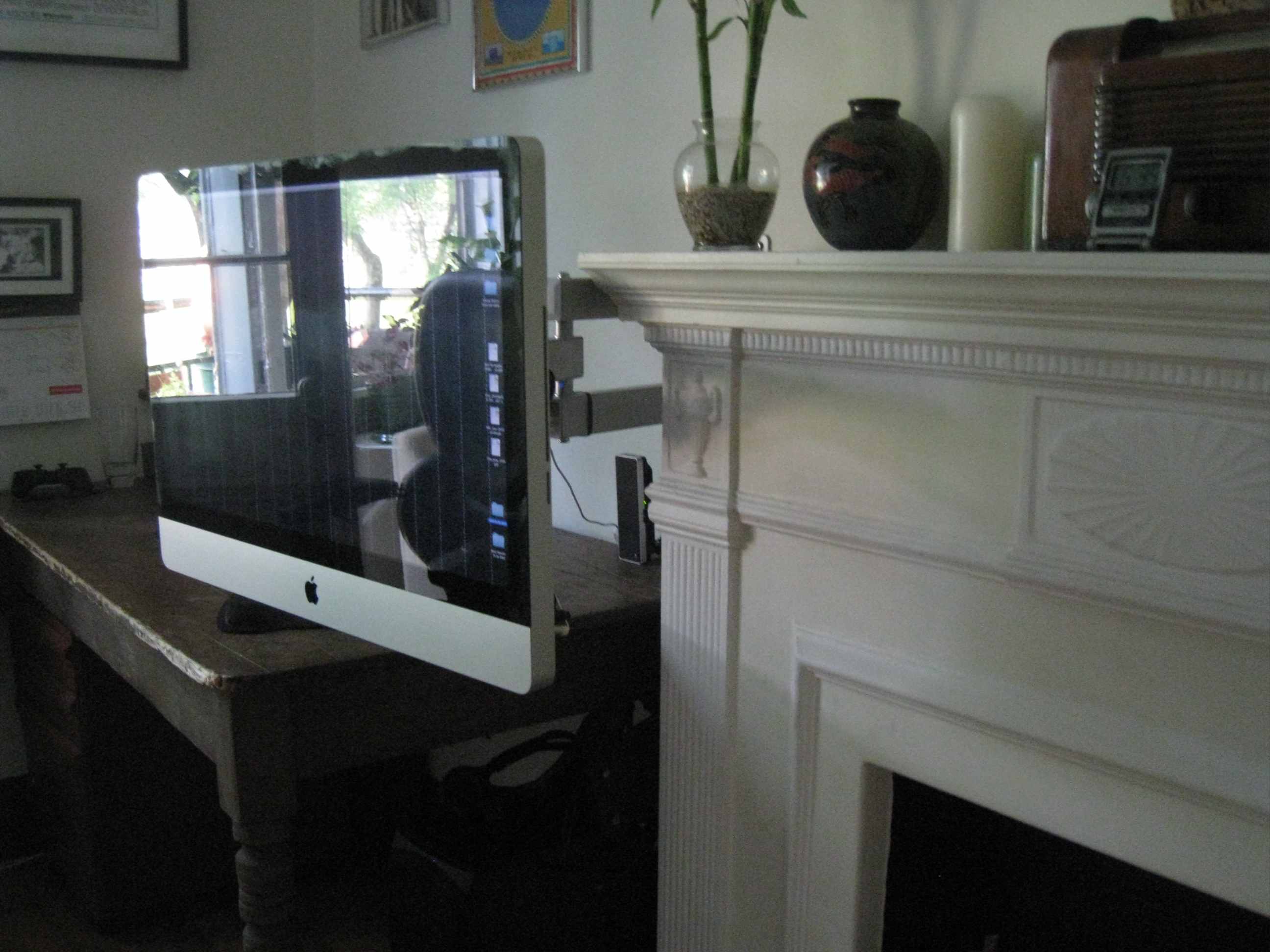

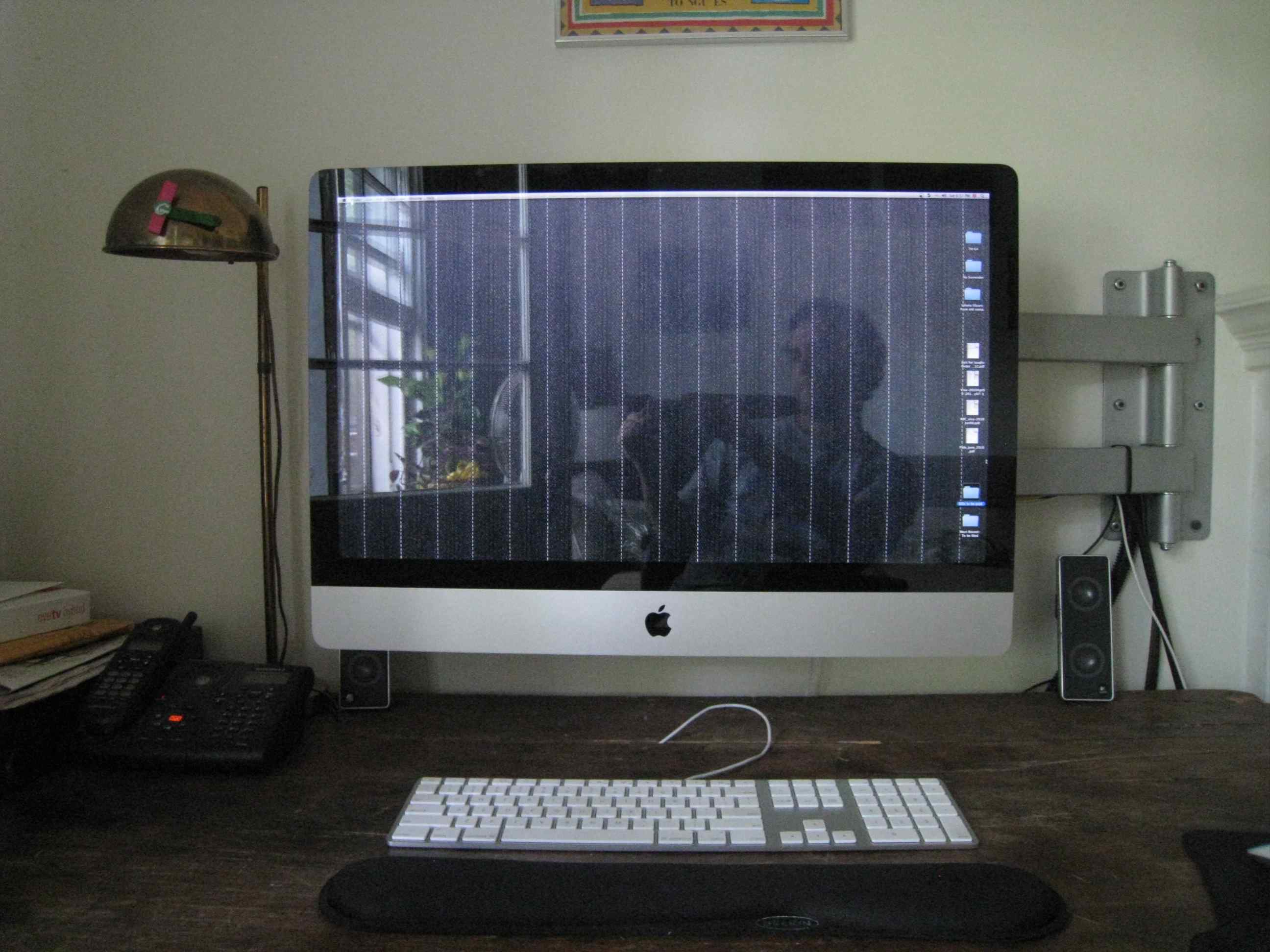

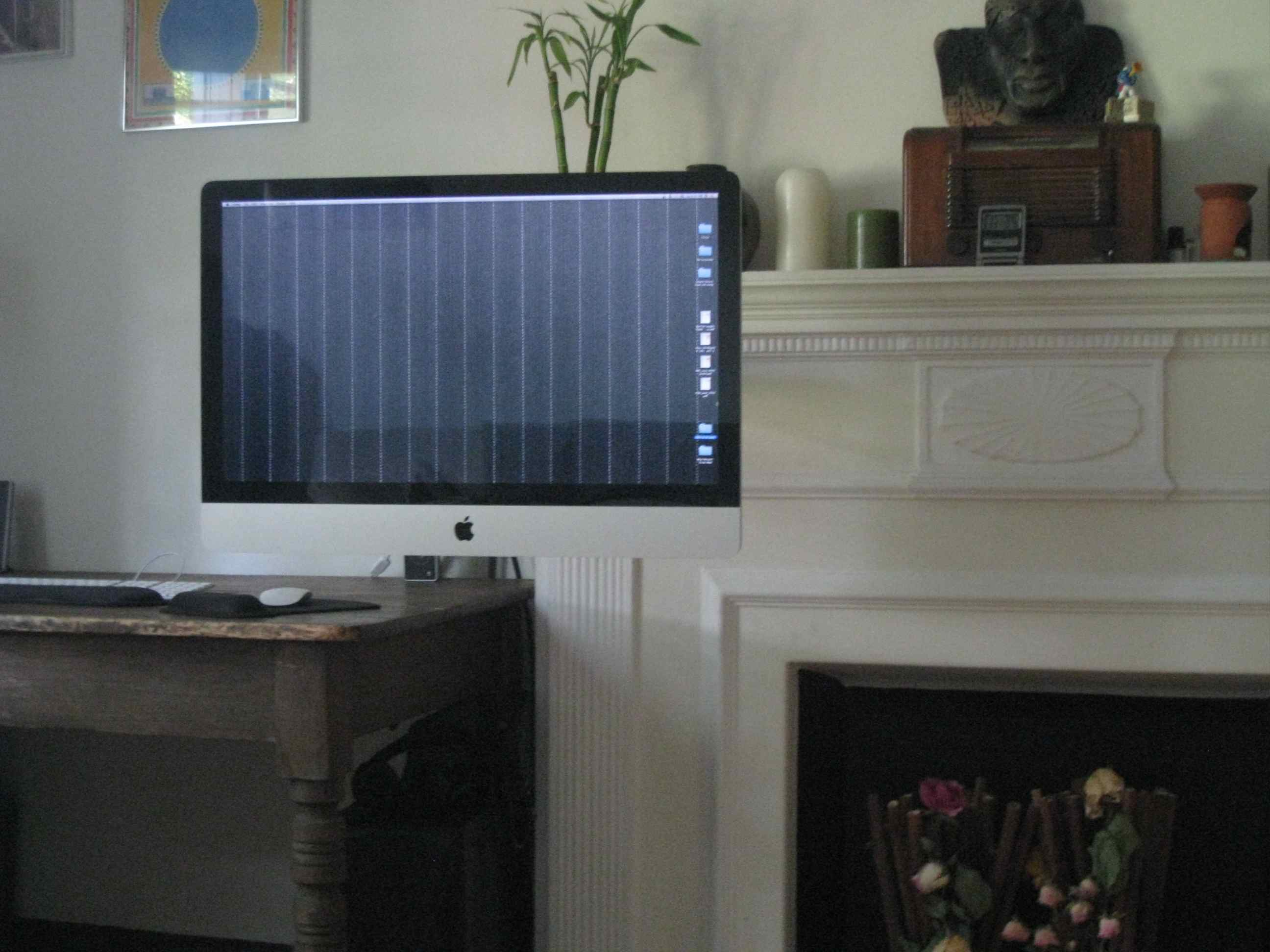

Got my Innovative 7500-1500 from Provantage few days ago. Here is a photo of my unfinished home office setup – as you can see, my master plan is to be able to work in dual positions: either sitting vertically behind the desk or laying down semi-horizontally in recliner: 🙂
(The plant is temporarily placed in corner to act as a counterweight when iMac is positioned over recliner.)
Good thing about the 7500 is that it works: it mounts to desk, carries the iMac without collapsing and can be moved. The bad news: with the weight of 27" iMac, don't expect super smooth movements as seen in Innovative's demo video. Especially forearm rotation and tilting are very stiff and cannot be adjusted "on-the-fly" (I think tilting is fixed in later revisions?). I was also let down by the mediocre finishing quality of the product and lack of manual / maintenance / safety instructions. That being said, it's not bad product – just don't expect any Apple-style elegancy with it. Would be interesting see a monitor arm designed in Cupertino!
Edit: The recliner with 27" screen floating in the front of you is absolutely heaven 😛
LOL what aer you going to do for a permanent counter balance? I cant imagine you will want to set the plant up each time you switch to recliner mode? You could bolt some weights to the underside of the desk!
Neat idea
Neat idea
bolt counterweights to the whole desk, or bolt the desk to the floor?
The plant stays there permanently, no need to set it up everytime. Leaves enough desk area for working. (As a sidenote, I've found myself to work 90% of the time in recliner mode.)

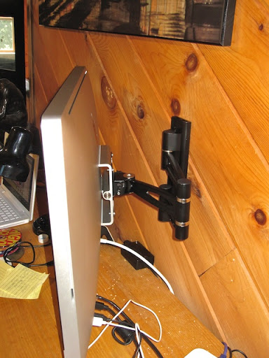

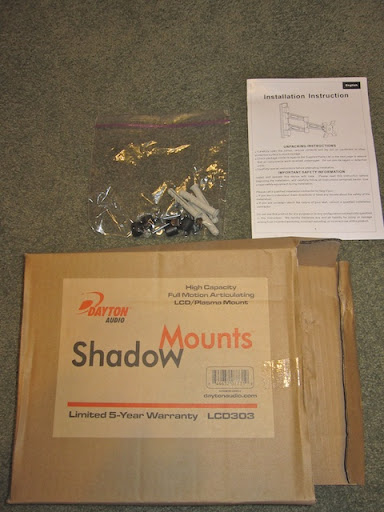

Here is my brief review of the Parts-Express arm I got for $50.
Directions pretty basic, easy to follow.
Mine is solidly mounted to a beam that's behind the loft knotty pine T&G.
Plan view

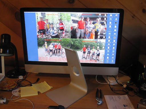

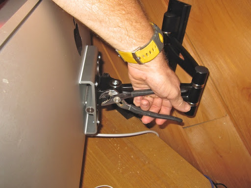

Everything seemed to be going fine, until after hanging the 27" iMac onto the articulating are, the rather small knobs had hard time clamping the tilt mech tight enough.
The iMac kept flopping forward.
I had to use these type of pliers to give them a extra "umph", so far (just 1 day) its holding well.
Here the 27" iMac "hanging" and the old stand in front of it.
I put the iMac at almost exact eye level as the stand did, in hindsight I wish that I put the iMac more center screen to center of eye level, so maybe 4-6" higher.

Finally, here's the box with "extra parts" for other ways to wall mount.
Now at least my kids can't knock it over and break the glass cover.

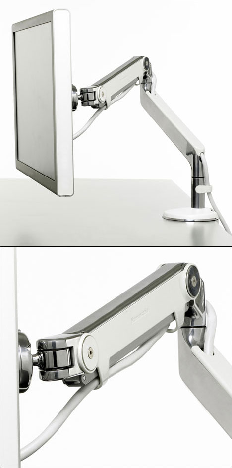

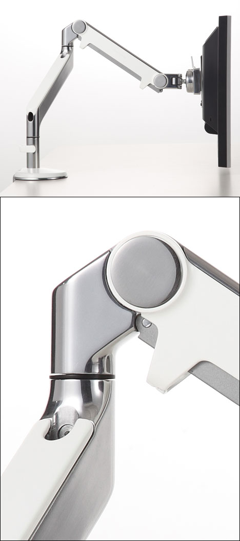

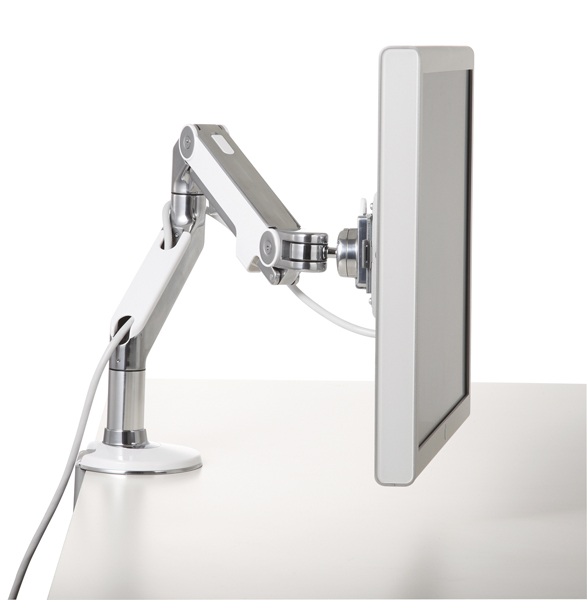

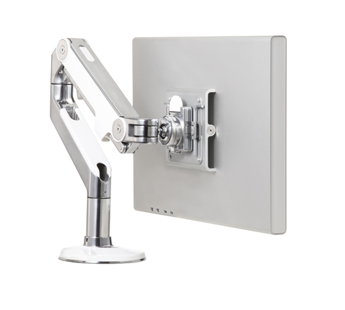

Hey look - - Gizmodo is featuring a story about a monitor arm today!
The arm they describe is the Humanscale M2, but unfortunately it's not strong enough to wield a 27" iMac. However, upon closer examination of the Humanscale website, I see that that they have recently released a new high capacity model with a similar design - - the Humanscale M8 Monitor Arm.
It's specifications include a 42 lb. payload and 22" reach and 11.5" height adjustment. It's MSRP is $460, but seems to be available from various resellers for under $300.
The available polished aluminum finish may make a nice match for the iMac, and one small feature I haven't seen on other arms is that the "VESA Plate stores 2 hex keys for instant access to adjustment tools"!
