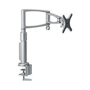

Here's a relatively low cost monitor arm - - the Loctek DLB372.
05788458000
It is specified to support 15 kg (33 lbs) so it is nominally strong enough to support the 27" iMac. It is available under the Sylvania brand name from Sears for a price of $65.99, so it's certainly one of the least expensive desk mounts suitable for the iMac. There is also a suspiciously similar model known as the Sylvania SYL-DLB371) available at Amazon for the same price, including a single moderately good review.
Here's a YouTube video of the DLB372 in action.

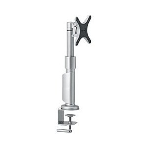

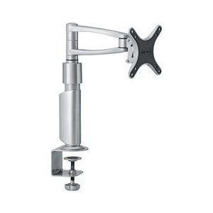

There are three models available - - the WS1, the WS2, and the WS3. All three are rated to support a payload of up to 30 lbs. The difference between the three models is in the number of arm segments or joints that they have. The WS1 is essentially just a "shoulder" or a pole mount, offering little difference from the stock Apple stand. The WS2 adds an upper arm, and the WS3 adds a forearm to that. Here are some pics to give a better idea of how these three models differ...
As to the cost of these arms, the MSRP for each model is as follows: the WS1 = $79.95, the WS2 = $99.95, and the WS3 = $129.95. They are available from various resellers on Amazon.com for about 30% less, putting the three models at $56.07, $69.99, $90.99 - - and possibly even lower prices if you shop around on the net.
Here is a detailed (and far from reassuring) YouTube review of the WS3 from a buyer specifically using it on a 27" iMac. Additionally, here is a more positive YouTube review of the WS2.
For those on an extremely low budget, the OmniMount WS3 may be a possible solution, but for most people who can already afford a 27" iMac and wish to have an arm that matches the build quality and functionality of their computer, I would suggest you read back in this thread for suggestions on much higher quality fully radial arms that may cost more, but will provide a much more satisfying arm experience.

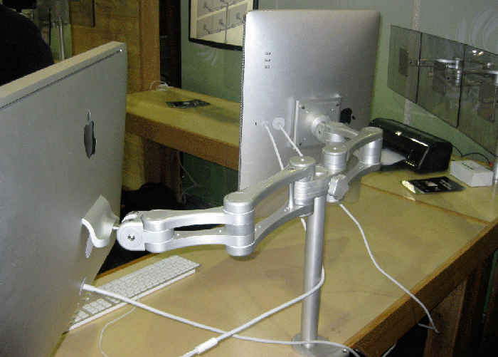

I tried the "arm" thing for a while;e and all I can say is get one that is rated for way over your iMac 27" weight as if not they do not work smoothly and can actually fail! I ended up with it attached hard to the wall😱

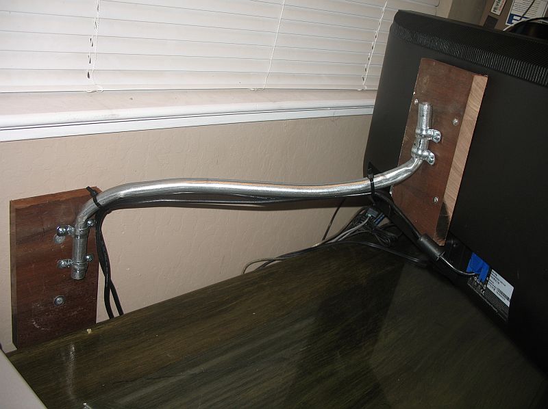

The lowest cost arm yet!
...decidedly for the DIYer's in the crowd, this homemade arm can be constructed for almost nothing if you have some spare parts in the garage. One advantage that the maker points out is that since "most [commercially available arms] didn’t extend from the wall as far as I needed" - - he could make the arm as long as necessary (and that the materials could support).
Here are the instructions by it's creator.

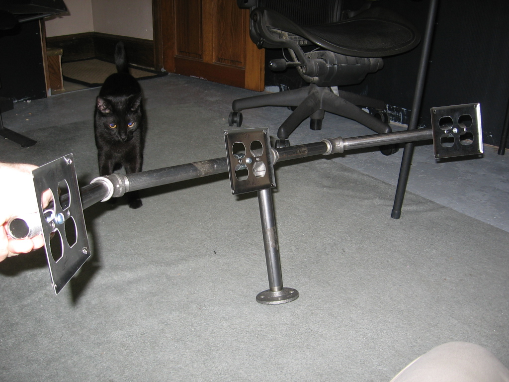

While we're on the subject of bootstrapped arms here is a homemade triple monitor stand built out of standard pipe fittings with the VESA adapters made from repurposed electrical faceplates...
Perhaps with that idea in mind, we might look forward to other creative handcrafted arms which might even include rudimentary articulation using rotating pipe fittings and some imaginative design.
