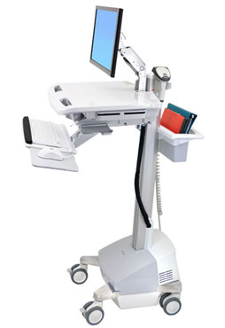

In the meantime I've found a better option. A free trolley from my mum which I can sit the thing on and wheel around. Why did nobody think of that? 🙂
One vertical market that uses trolleys or carts for computers on a regular basis is the healthcare industry. One especially tricked out model is the StyleView EMR Cart which features a built-in Ergotron articulating arm. Of course, being targeted at the healthcare market, it has a suitably hefty price of $2,699. This pdf brochure details it's many features (and may also provide some interesting ideas to general articulated arm fans). Even better is this funky YouTube video entitled: Fit 4 Every Body promoting the StyleView through dance (!) and flashy editing**.
