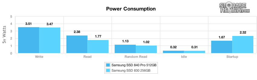

hfg, I think the power issue is a bit more complex then that. The manufacturer specs are highly idealized, not sure exactly how they came up with such a small number.
Here is some data found in a review of the 840 pro:
As you can see, during a heavy write workload it is quite possible to exceed or near 4W. Some SSDs are better, some are worse, and I think the Samsungs are on the better end of that scale, especially the 840Pro 512GB.
As far as thunderbolt power. I've been searching for exactly where in the standard it has a minimum power. The supply voltage that Thunderbolt provides can be spec'd as anywhere between 3.3V and 18V. It's really "up to 18V" and "up to 550mA" which makes it "up to 10W"? Can the Thunderbolt device specify the voltage and current it requires? And is the host obligated to provide it?
It is quite possible that some of these Thunderbolt HDD solutions request less than 10W, and/or can't dc-dc convert from 18V down to 5V. A quick calculation, if the device requests 5V (not having a dc/dc converter) and the Thunderbolt can only supply up to 550mA, that's 2.75W of available power.

There was (is) some confusion regarding the power consumption of the 840 Pro as presented by Samsung:
As SSDs spend much of their time in the idle state, low idle power consumption is a key factor in overall SSD power management. Samsung’s SSD 830 handled power management very well, but Samsung’s published power benchmarks for the 840 Pro, 0.068 watts in active operation and 0.042 watts in idle, were shockingly low. When we asked Samsung how they achieved such mind-bending numbers, they were unable to answer, which makes us think they were chosen to meet the needs of the press release, rather than reflecting real-world values.
Update 9/24/12 - Samsung has responded as to how they got their extremely low power consumption numbers. “The results presented are based on MobileMark 2007 and require DIPM to be enabled. This test is geared towards laptops. If the test was on a desktop machine, DIPM is not enabled by default, and power consumption results will be significantly higher.”

Power usage SSD
My bet would be that DIPM would reduce average and standby power, (perhaps by having the "device" micromanage with fine time resolution when it is in sleep mode and when its not), but likely not peak write power.
-Mark
