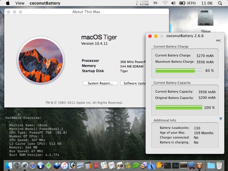

Which size were the cells you used in your battery? Mine are 2700mA and Coconut Battery reports them as something like over 2500mA (though battery health is shown as only 80%. I don't know if things will change after a few charge cycles). I'm getting well over four hours out of them, more than my modern laptop, so I'm happy with that.

The cells are listed as 3000mAh. Are these rating multiplied somehow when there are 8 cells in series?
Here is the output of Coconut Battery 2.6.6 (available here). Interesting, the clamshell is picked up as 109 months old (9 years) because the age is calculated by the serial number and the decade (1990) was not taken into account.
I'm not sure if the number of cycles was reset when I rebuilt the pack, because 130 would be about right. I've used it quite a bit over the months and my usage pattern for any of my portable macs is to run them off battery power until flat and then recharge while I'm not using it (most of the time). I feel this will result in the best conditioning of the battery instead of just running off mains power all the time and just topping up the charge in that 98-99% region.

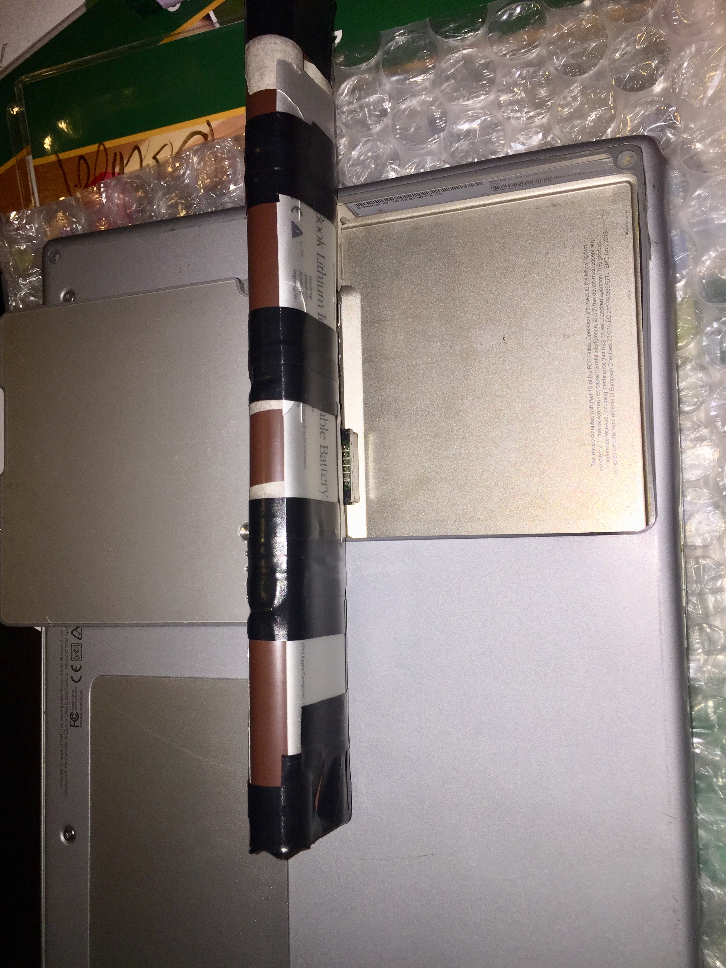

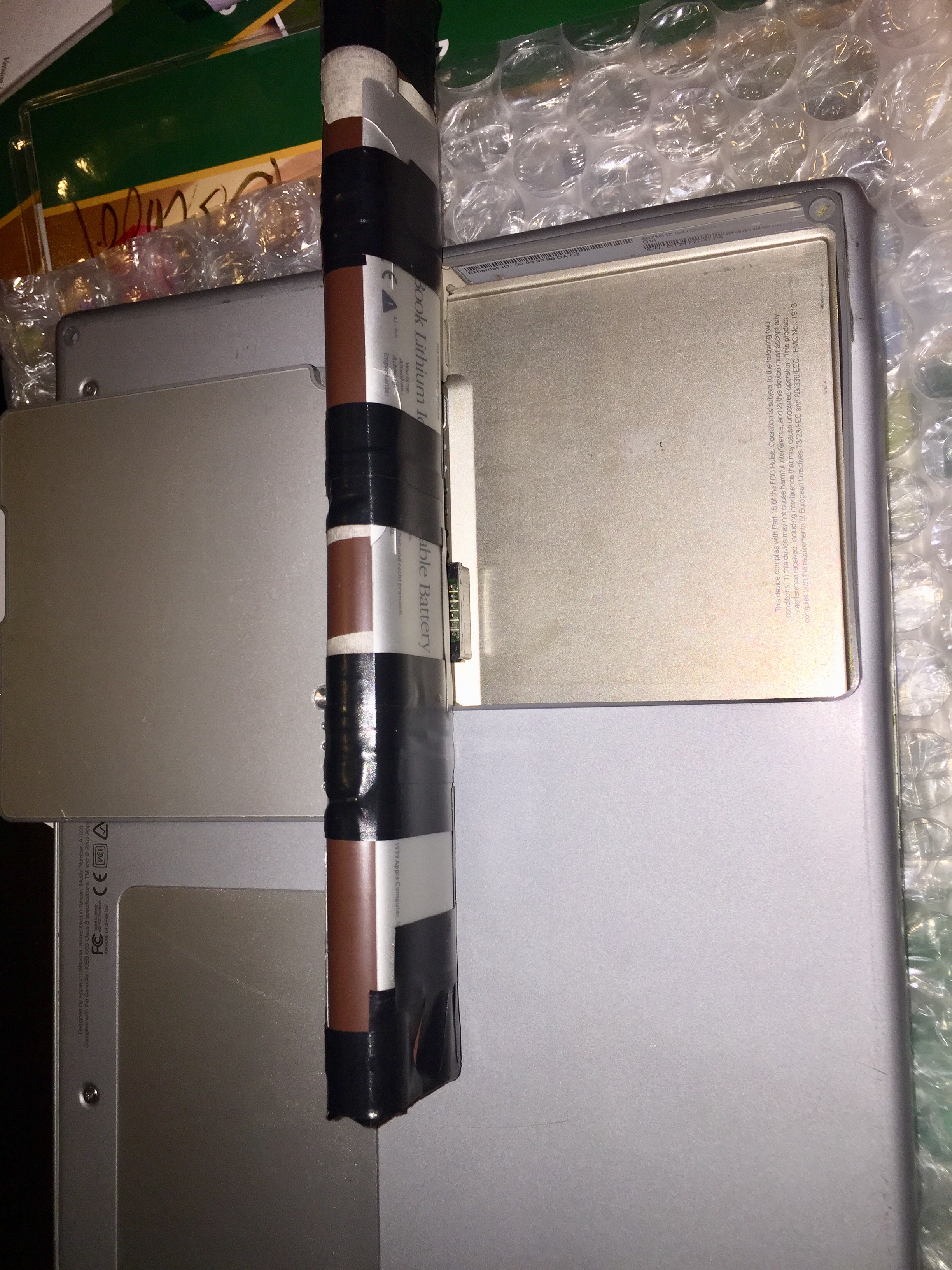

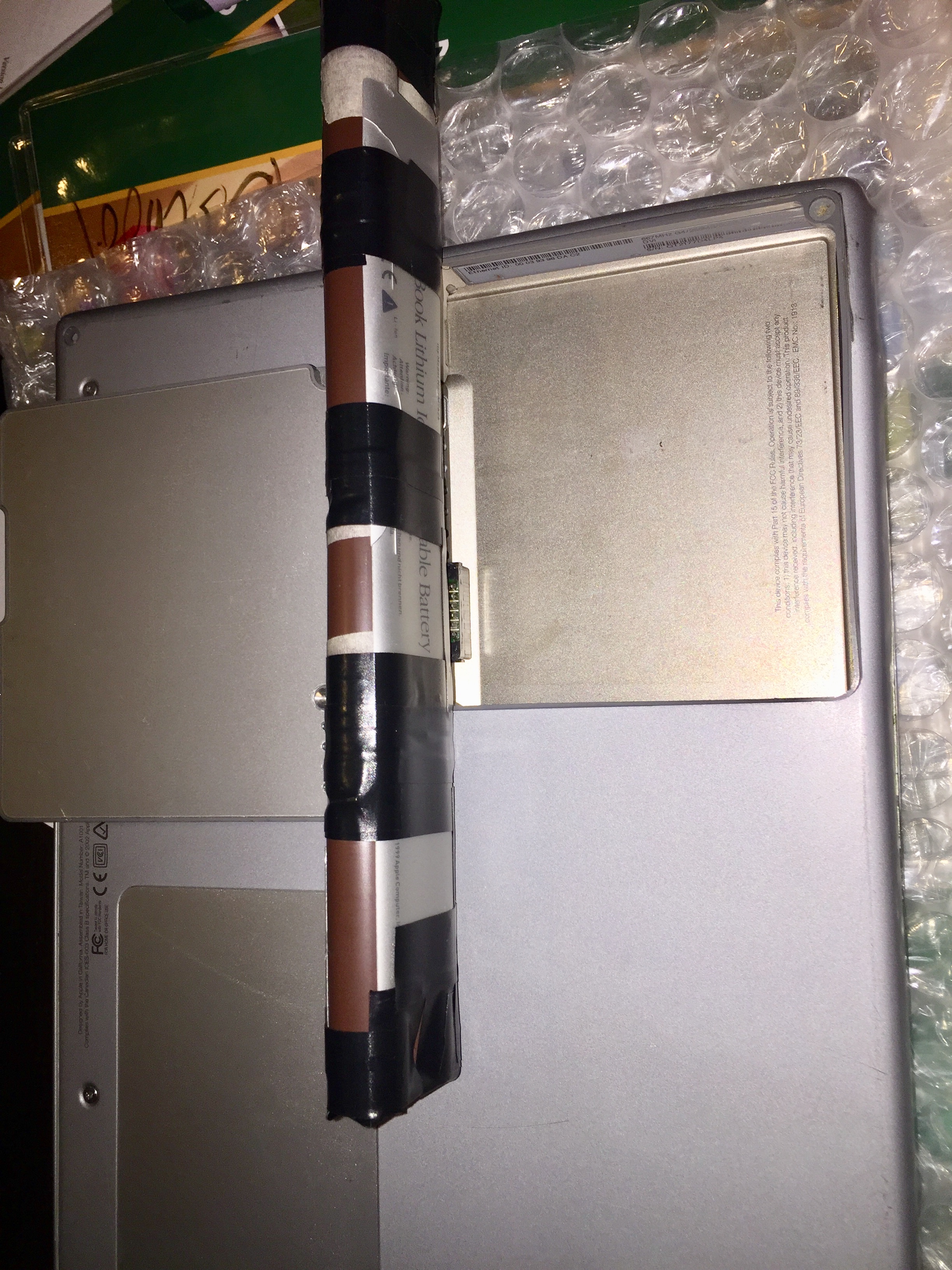

I had a wacky idea... I plugged my clamshell battery rebuild upside down into a tibook and whaddya know.. it’s charging and well past 10% already!
We’ll see what happens next... 😱
Hey @LightBulbFun, jump starting is the idea. I think it was @weckart who mentioned it earlier(?)

The TiBook and clamshell battery seemed to be a lucky combination. The battery charged to full, the light went green and I popped it back into the clamshell for a happy Blueberry iBook!
I’m running through the first cycle now. The test will be if the iBook can charge it from flat again.
