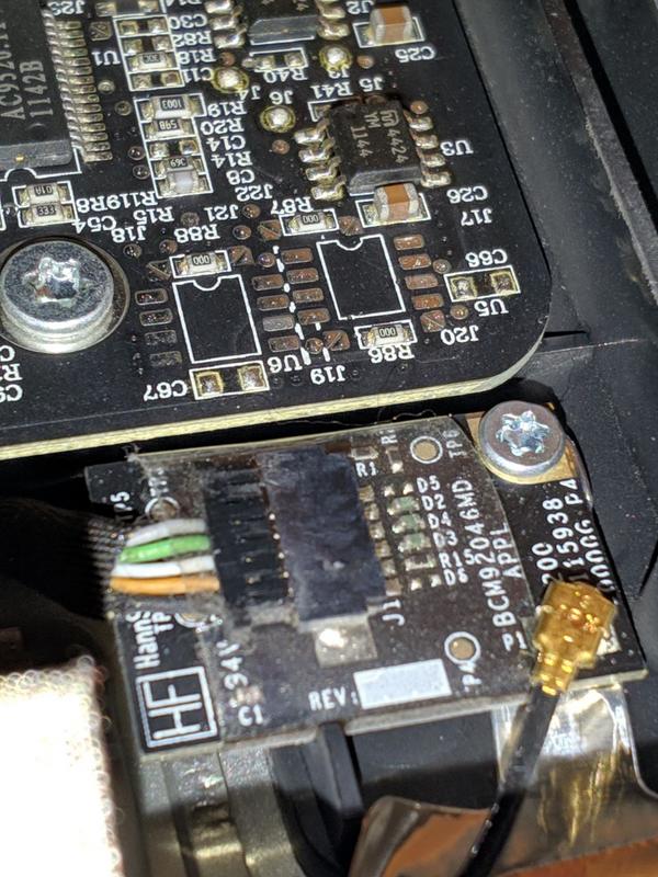

Hi everyone,
recently I replaced my old Superdrive (not even working anymore) of my iMac 21'' Mid 2010 with an SSD Drive. Unfortunately, even though the SSD is correctly detected by the machine, I’m not able anymore to use Bluetooth.
For some reason the computer does not recognise the Bluetooth module anymore, as I get no informations in System Informations nor the icon under Preferences.
I already tried SMC and PRAM reset but nothing changed.
I really don't get how could it be and hardware problem if I never touched the top corner with the Bluetooth module and cables.
Regards
Francesco

Thanks for your prompt response, but I went already back by reopening the machine and everything seemed to be untouched like this:

I understand your point but it is really strange though. I mean: 30 minutes before everything worked like charm and then, just after opening it, the Bluetooth Module is not even detected.
I swear that I didn't touch it.
Would it be a good idea to physically disconnect it and then reassemble it? Maybe some dust entered while I was installing the ssd.
EDIT: is there a way I could run Apple hardware test via USB drive? I already tried pressing letter D during the boot process but nothing happened.
Says everyone. With nothing to lose, you can try anything you want, to include disconnecting and reconnecting.
I opened the iMac again. Unfortunately nothing changed. Inside all the Bluetooth cables were well connected. I disconnected them and reconnected.
I'm now logged in one more time, but there are no Bluetooth modules detected.

Solved my issue.
The computer was extremely dirty and I cleaned it using an hairdryer on cold.
Now everything seems to be working fine.
Solved my issue.

I know it's crazy. Maybe the dust was interfering with the Bluetooth Connections. Luckily everything is fine now.
