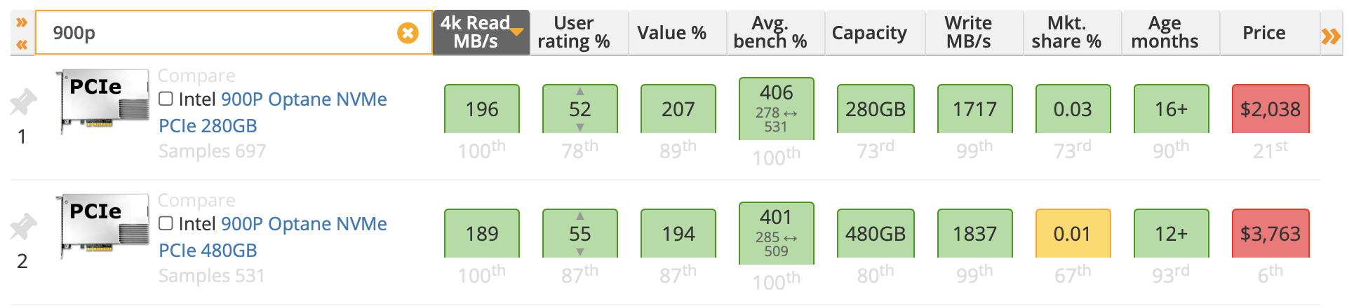

900P ~193MB/s

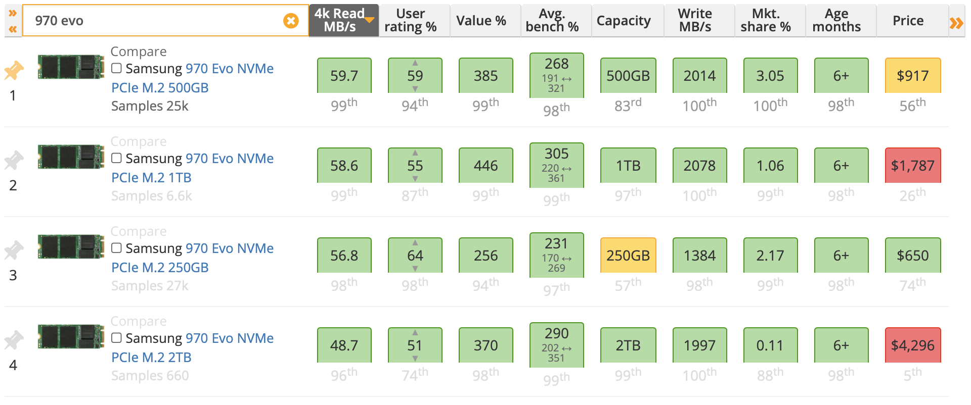

970Evo ~58MB/s

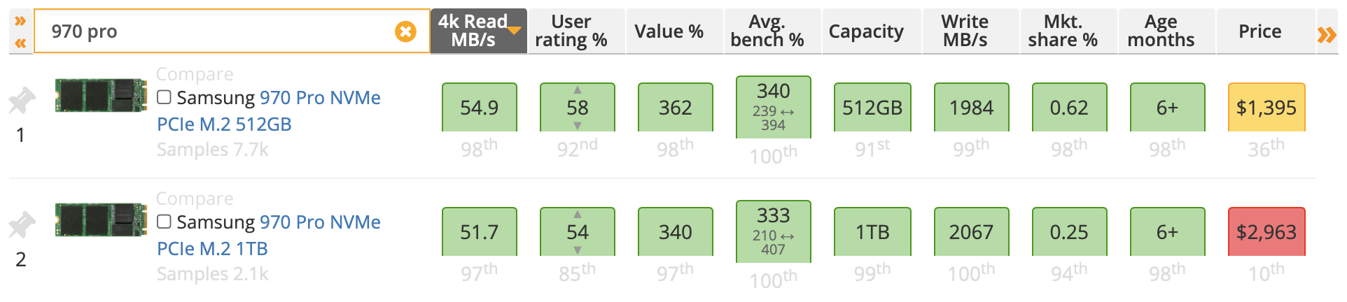

970 Pro ~53MB/s

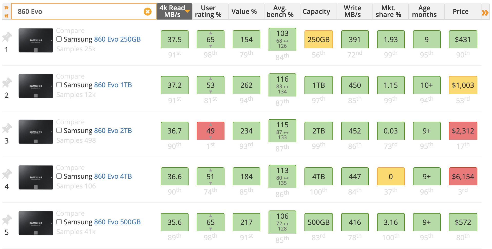

860Evo ~37MB/s

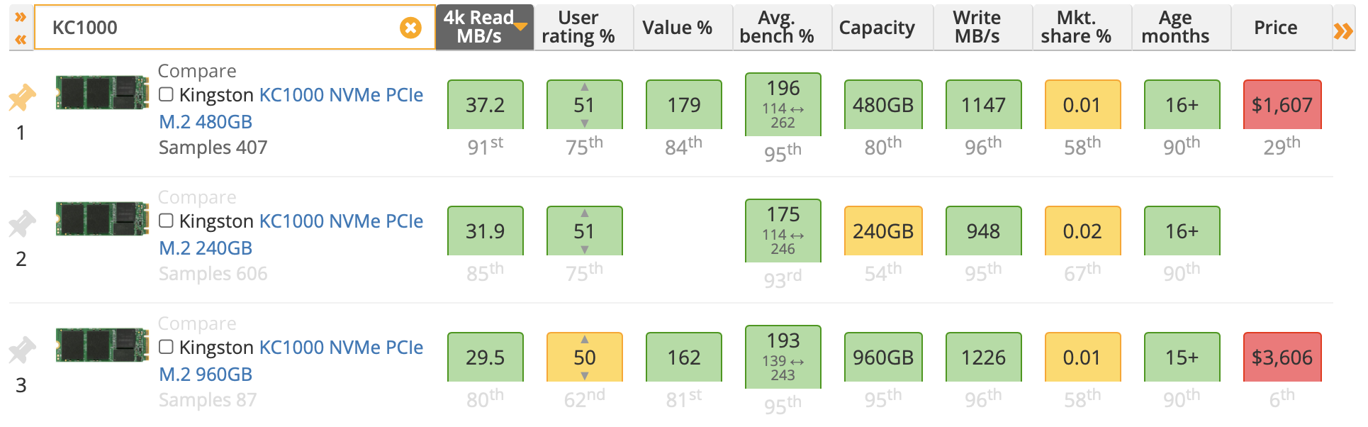

And for some "normal" NVMe, the performance may be even worse then SATA SSD in 4K read speed. e.g. KC1000
Therefore, if you upgrade to this kind of NVME. They may actually make you boot slower even no extra hardware initialisation time required.
