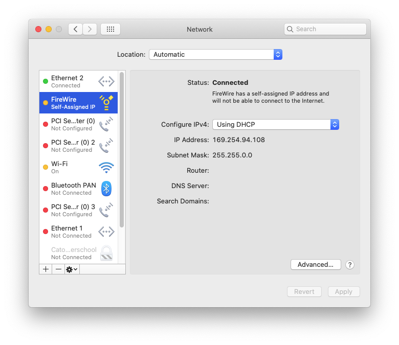

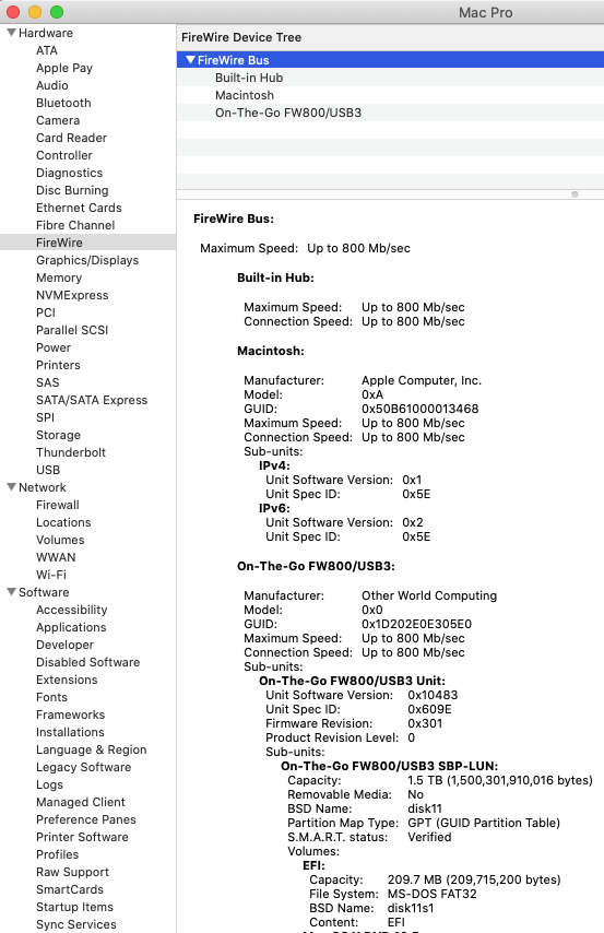

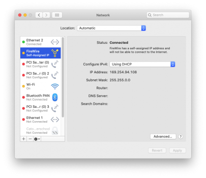

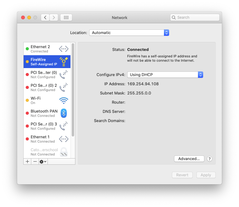

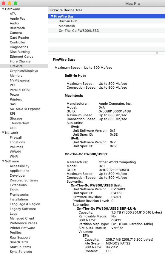

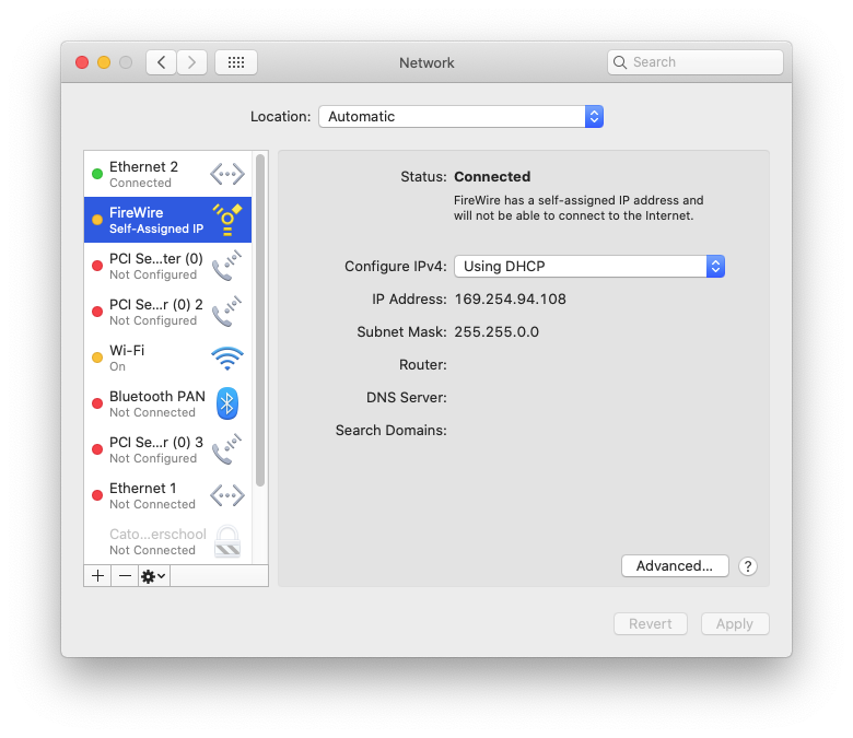

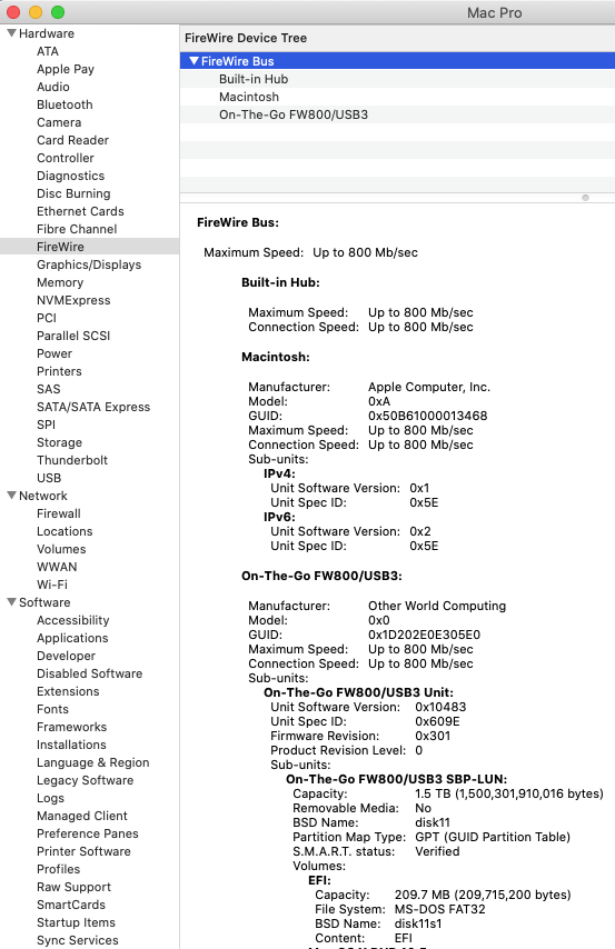

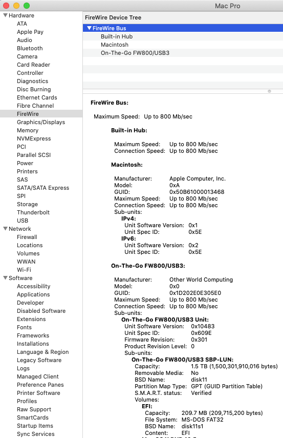

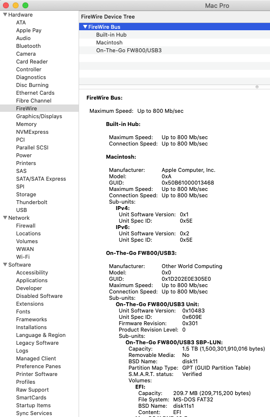

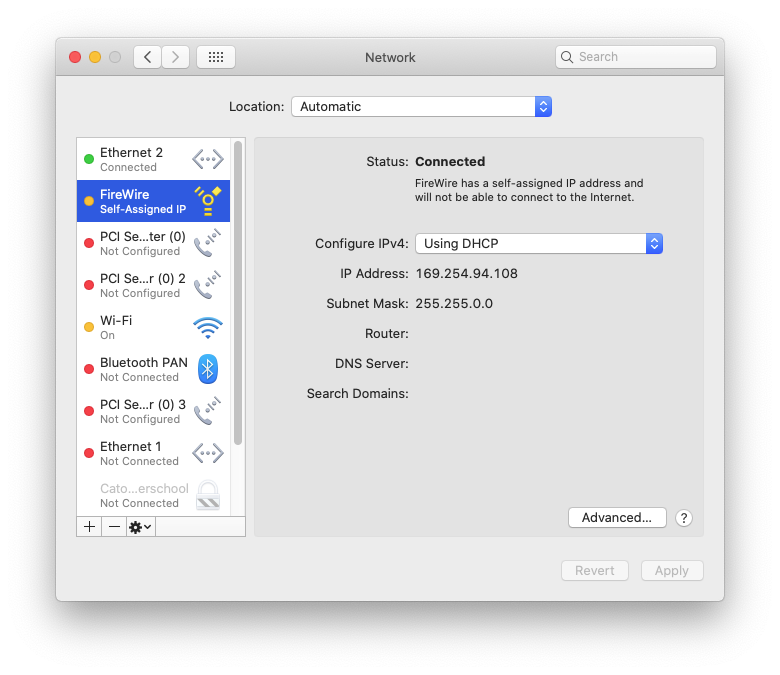

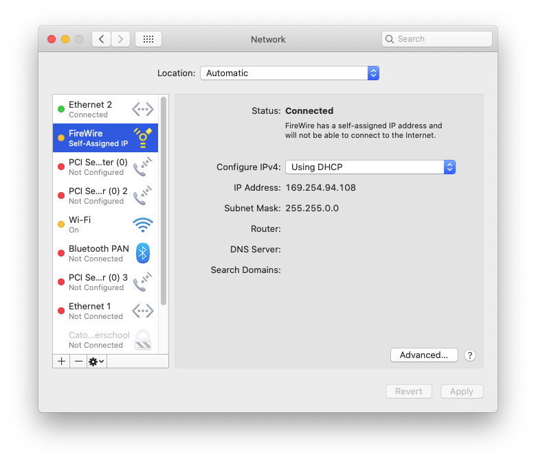

Today, I connected a FireWire drive to two Macs (Mac mini 2018 and Mac Pro 2008). One Mac can see the partitions (the first one that is connected). The other Mac can't. Each Mac can do networking over FireWire to the other Mac (the FireWire network interface for each Mac gets a self-appointed IP address). This worked in Catalina. Big Sur and Monterey don't appear to support FireWire networking.
Sometimes neither Mac will see the partitions. The drive has some bootable partitions and maybe both Macs can see the drive during EFI boot and in the Startup Mananger (hold option key at boot)? I don't think I want to test that too much. It may be that one was booting before the other so they took turns controlling the FireWire drive during boot?
