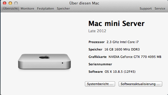

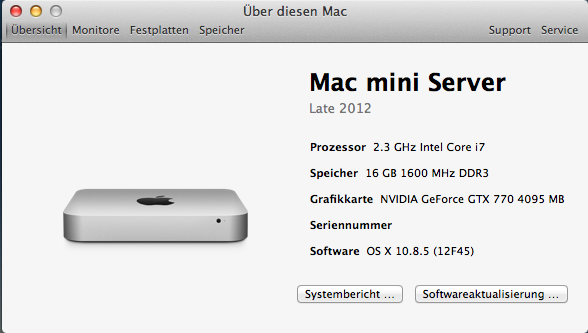

Macs with iGPU HD 4000 or other weak GPU's benefit the most from eGPU. For example with my GTX 770 OpenGL (Unigine Heaven, setting extreme) performance is around 1250% faster than the internal Intel HD 4000 of the Mac Mini 2012. And this was with my first weaker PE4L adapter. Also having CUDA. Smooth like an internal graphics card: https://forums.macrumors.com/threads/diy-egpu-for-mac-mini-2012-osx.1772495/page-2#post-20735233
An other benefit: You can connect a 4K monitor with a Kepler card or 5K monitor with a Maxwell card.

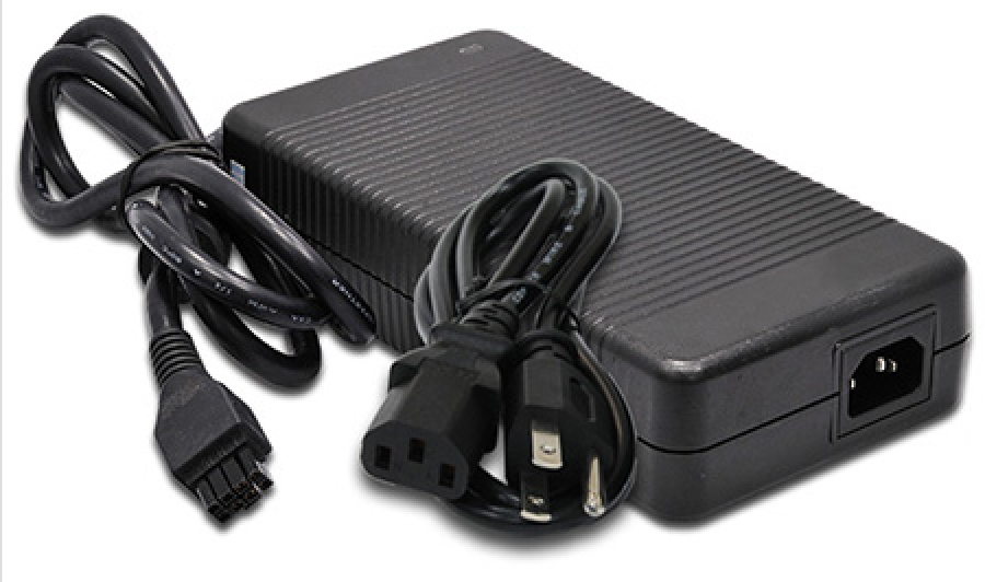

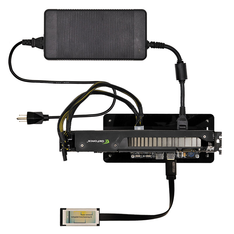

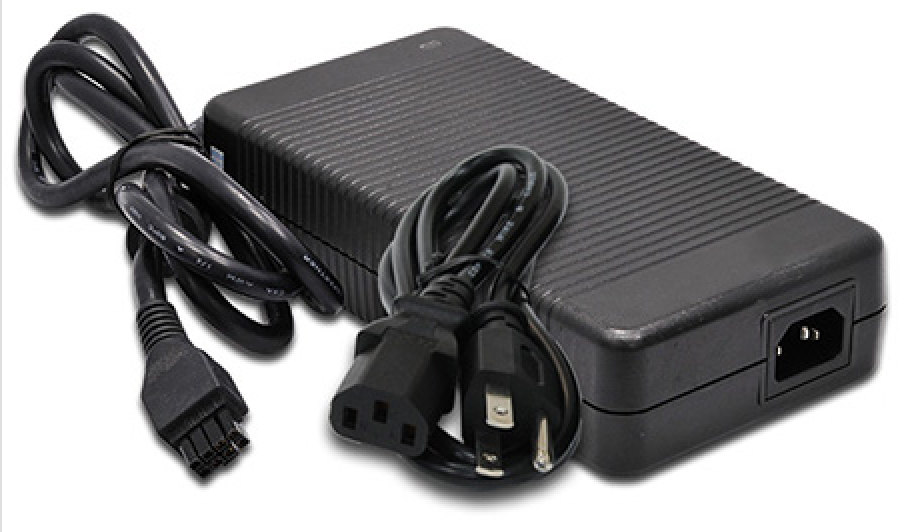

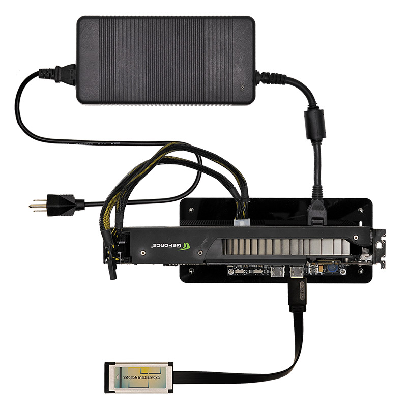

Just ordered the PE4C-EC060A V3.0 ExpressCard PCI-E adapter: http://www.hwtools.net/Adapter/PE4C V3.0.html or here: http://www.mfactors.com/pe4c-v3-0-ec060a-pm060a-hp060a/
No enclosure needed. PSU included. Supports graphics cards up to 216 Watt. Will try it with a Sonnet Echo ExpressCard Pro if I can get 4K 60Hz (with the Thundertek/PX it's no problem to get 4K 60Hz). But this configuration is much smaller:
