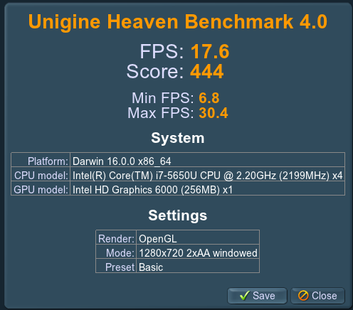

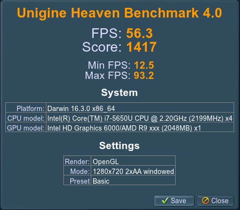

This was a lot more trouble than I had planned on, but I leaned a lot about kernel extensions so life level up. At least the hardware side of my RX 460 eGPU was relatively easy.
