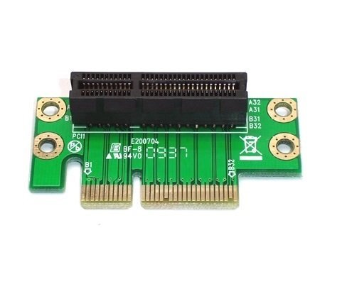

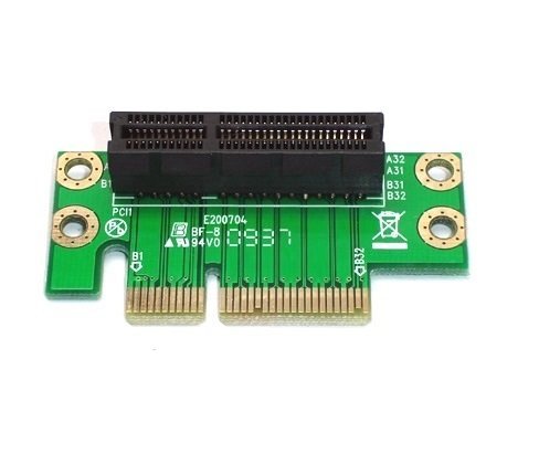

Reading that you can cut the x8 lane to fit an x16 card and the card will operate at x8. Going to try it... seems like a dumb idea but you never know.

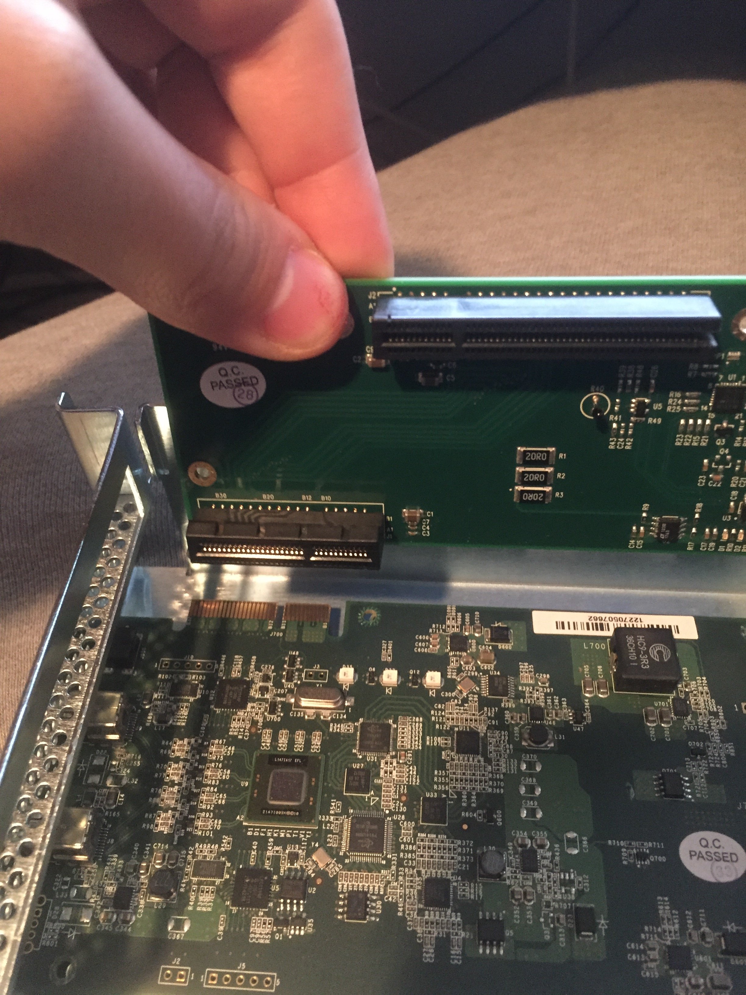

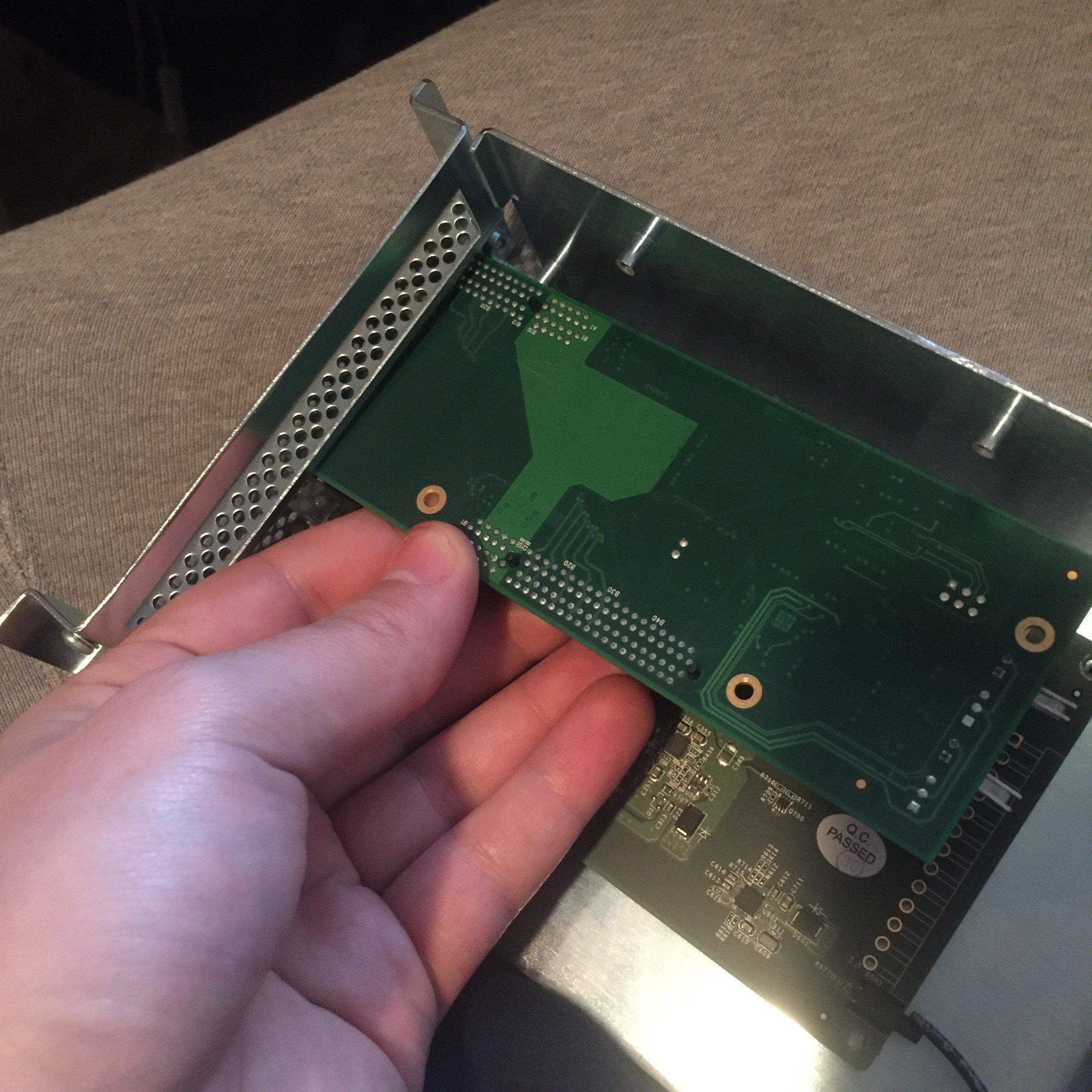

Serious progress but not working... Here are some pictures:
Modified PCIe slot:
Helios w/ card installed:
Card recognized!
Hanging on first boot:
Booting in verbose mode got it further but no dice:
The systems keeps hanging when the monitor is plugged in, otherwise it boots. I have another Mac Mini here that I am going to do a clean install on and see if that changes anything. Any other suggestions?
Update 3:
Modified PCIe slot:
Card recognized!

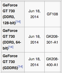

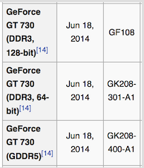

The mentioned GT 730 card is a Fermi card (GF). Make sure the GTX 730 is a Kepler card (GK208). There are three different versions:
Two of them draw less than 25 Watt (TDP), the Fermi version draws 49 Watt: https://en.wikipedia.org/wiki/GeForce_700_series

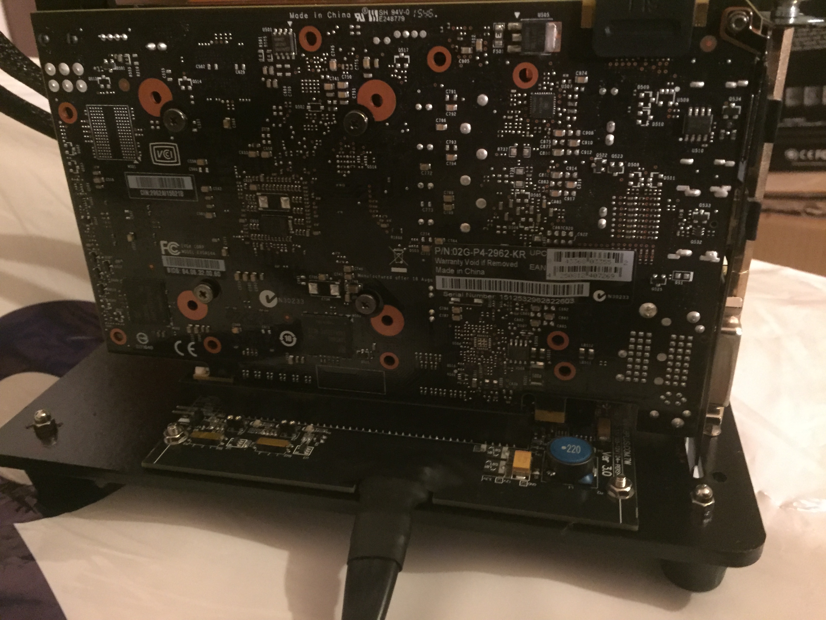

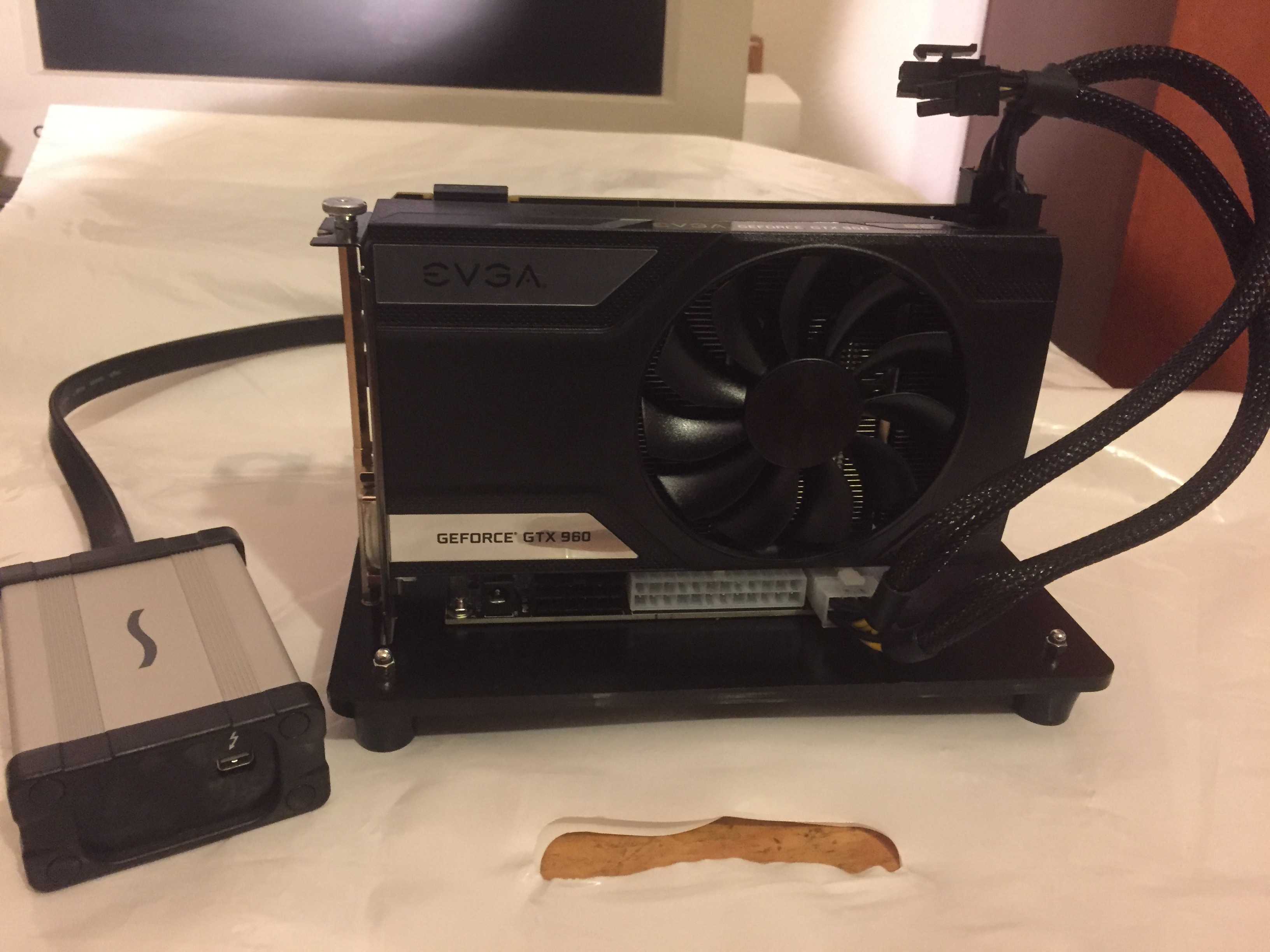

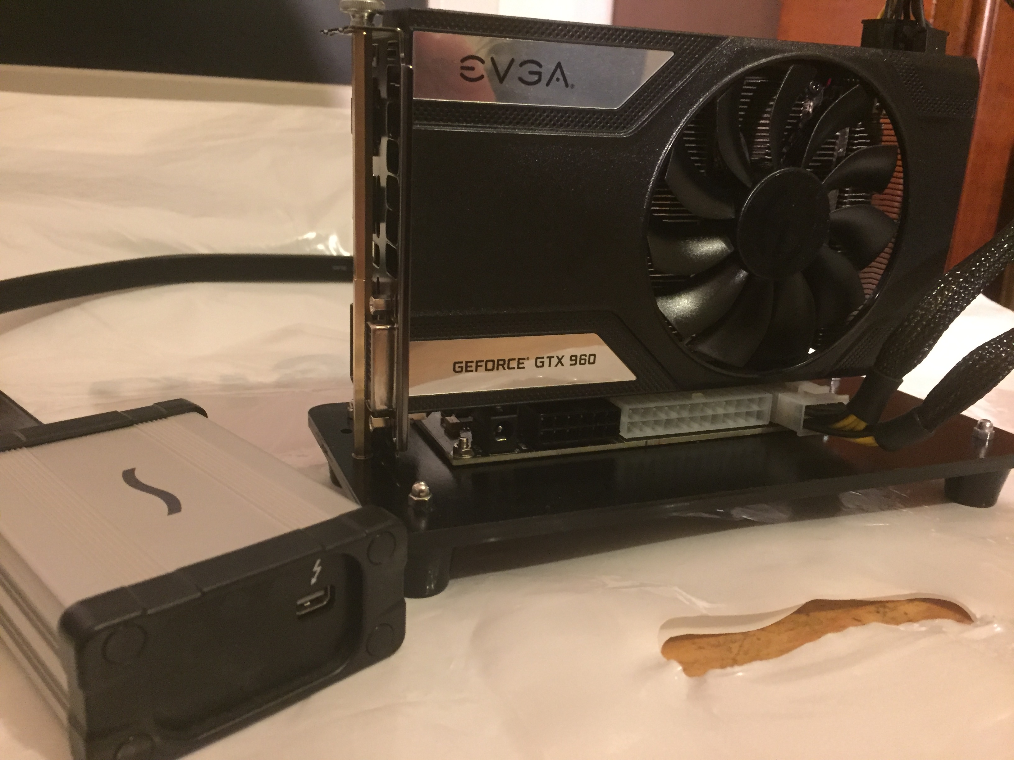

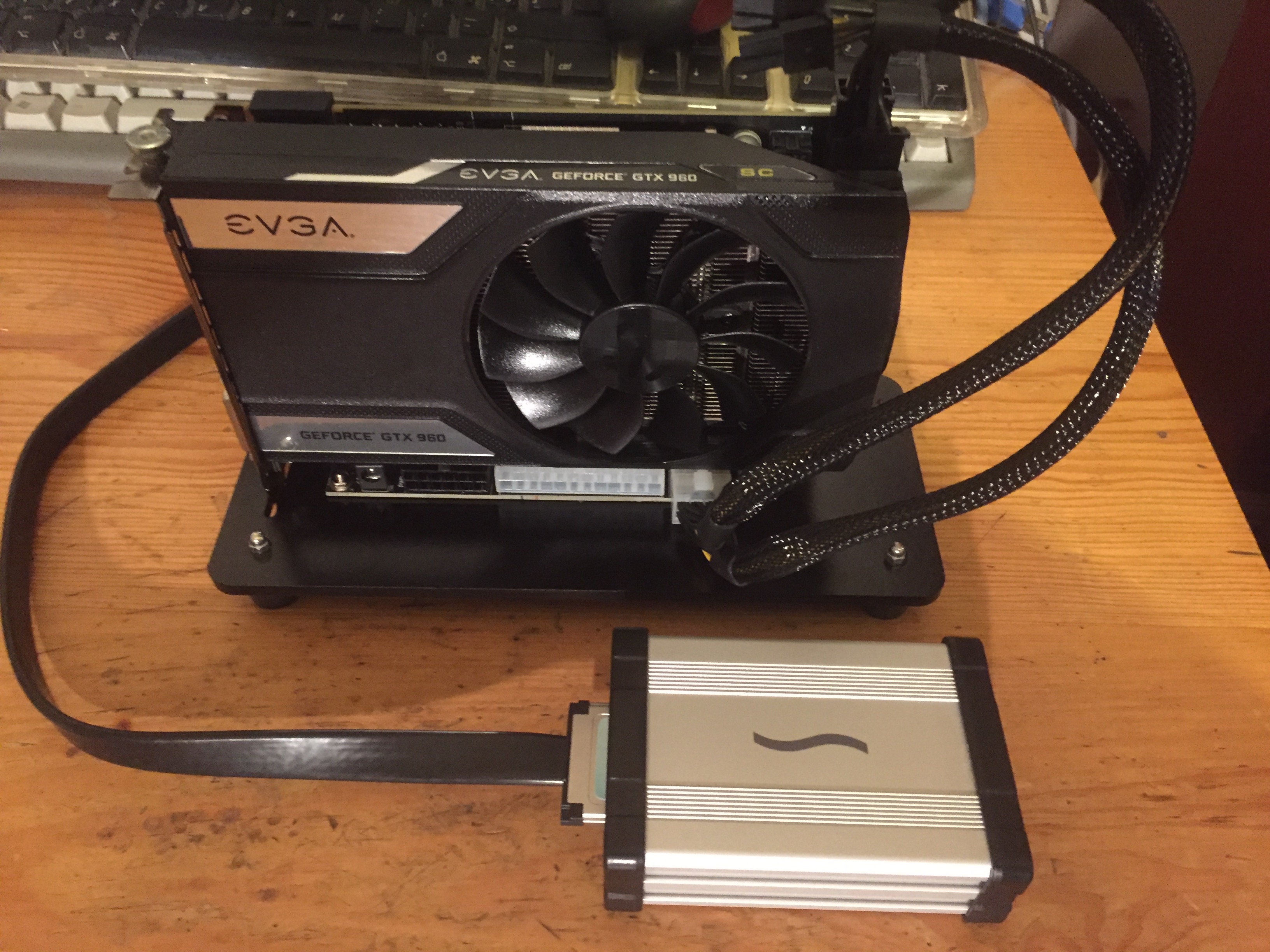

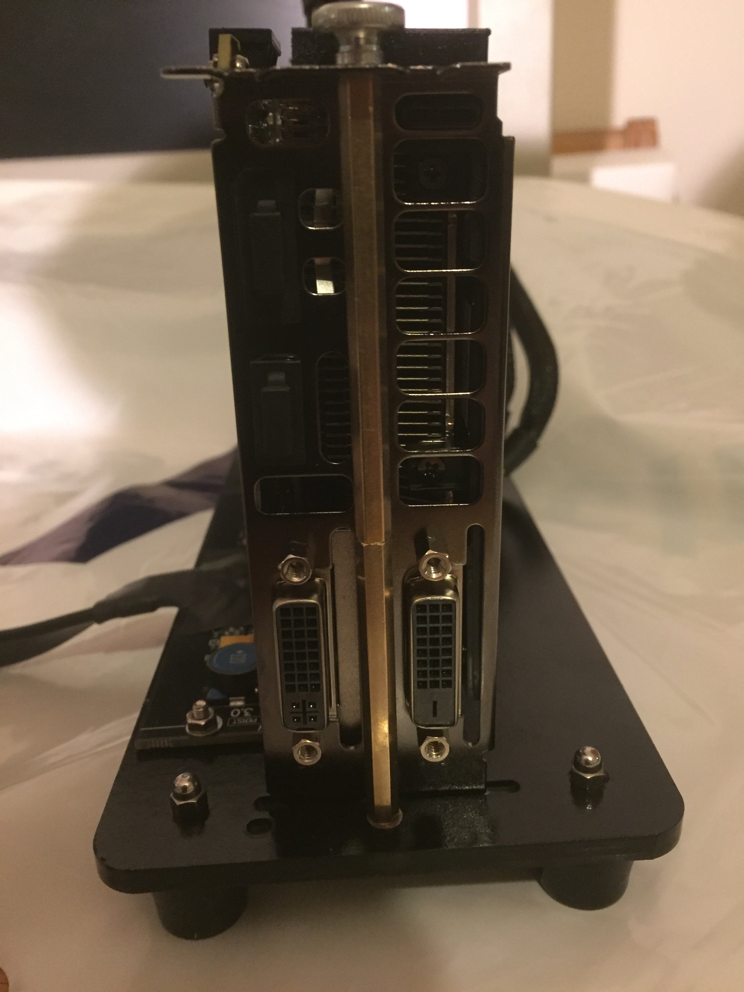

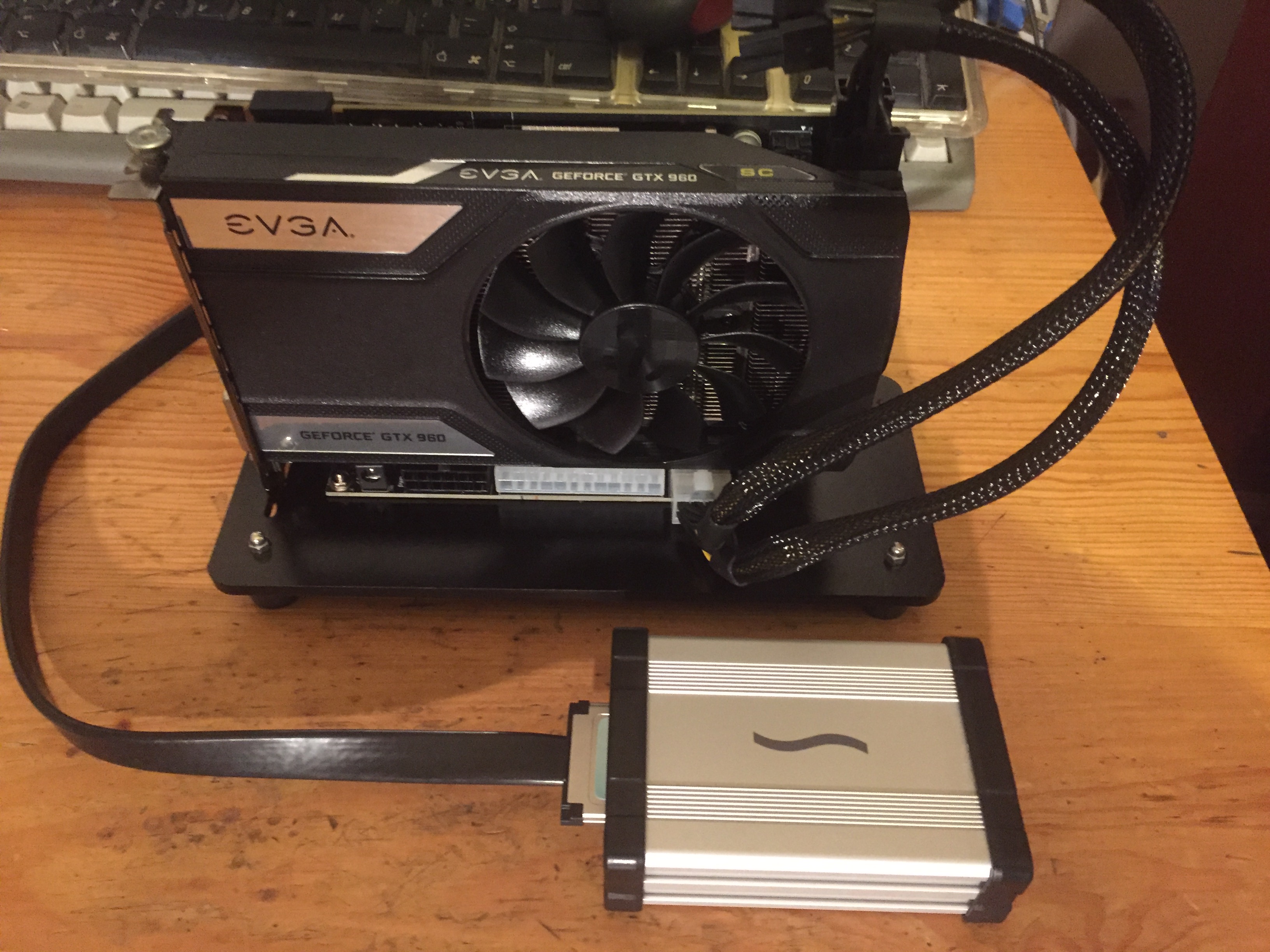

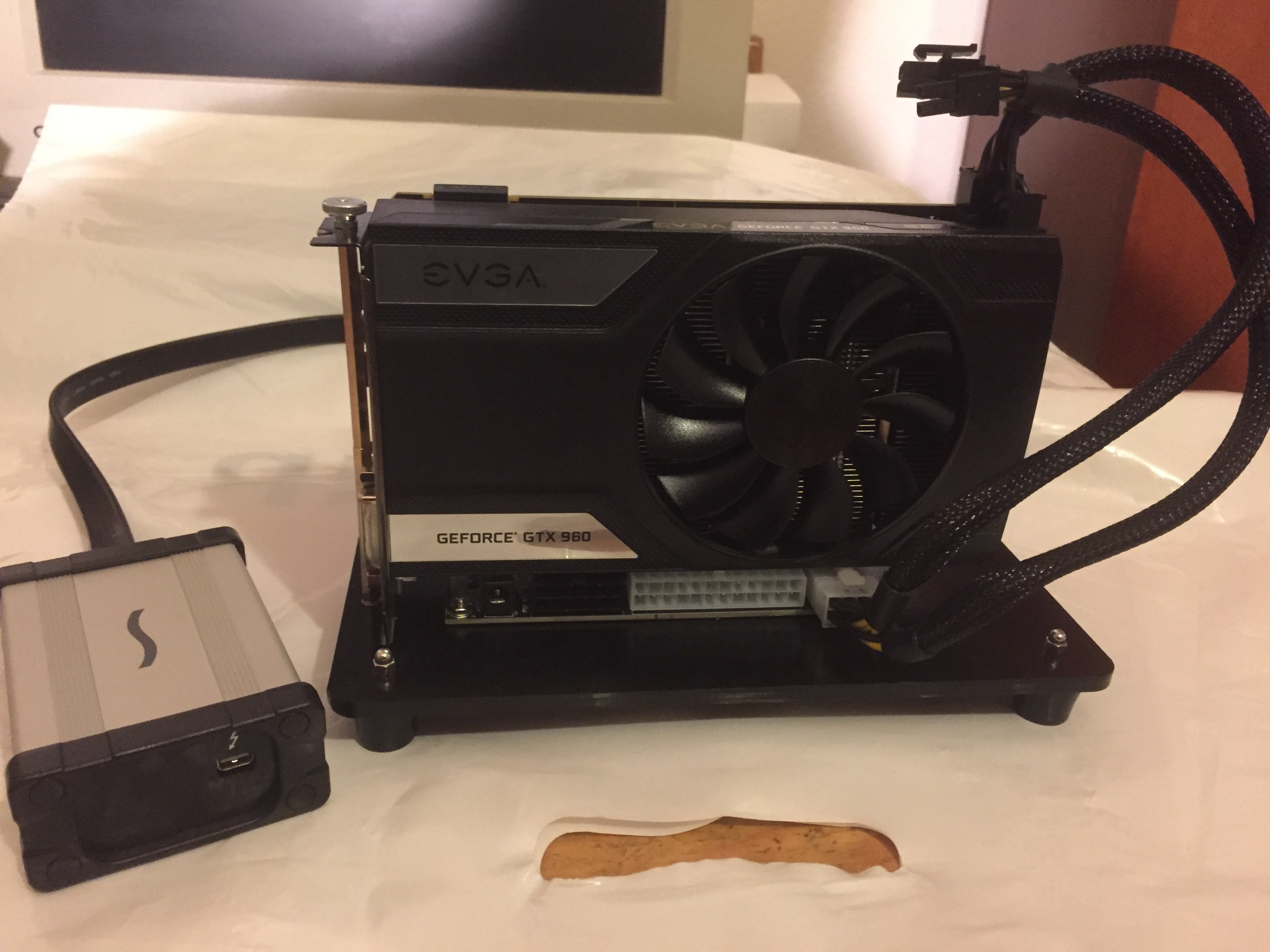

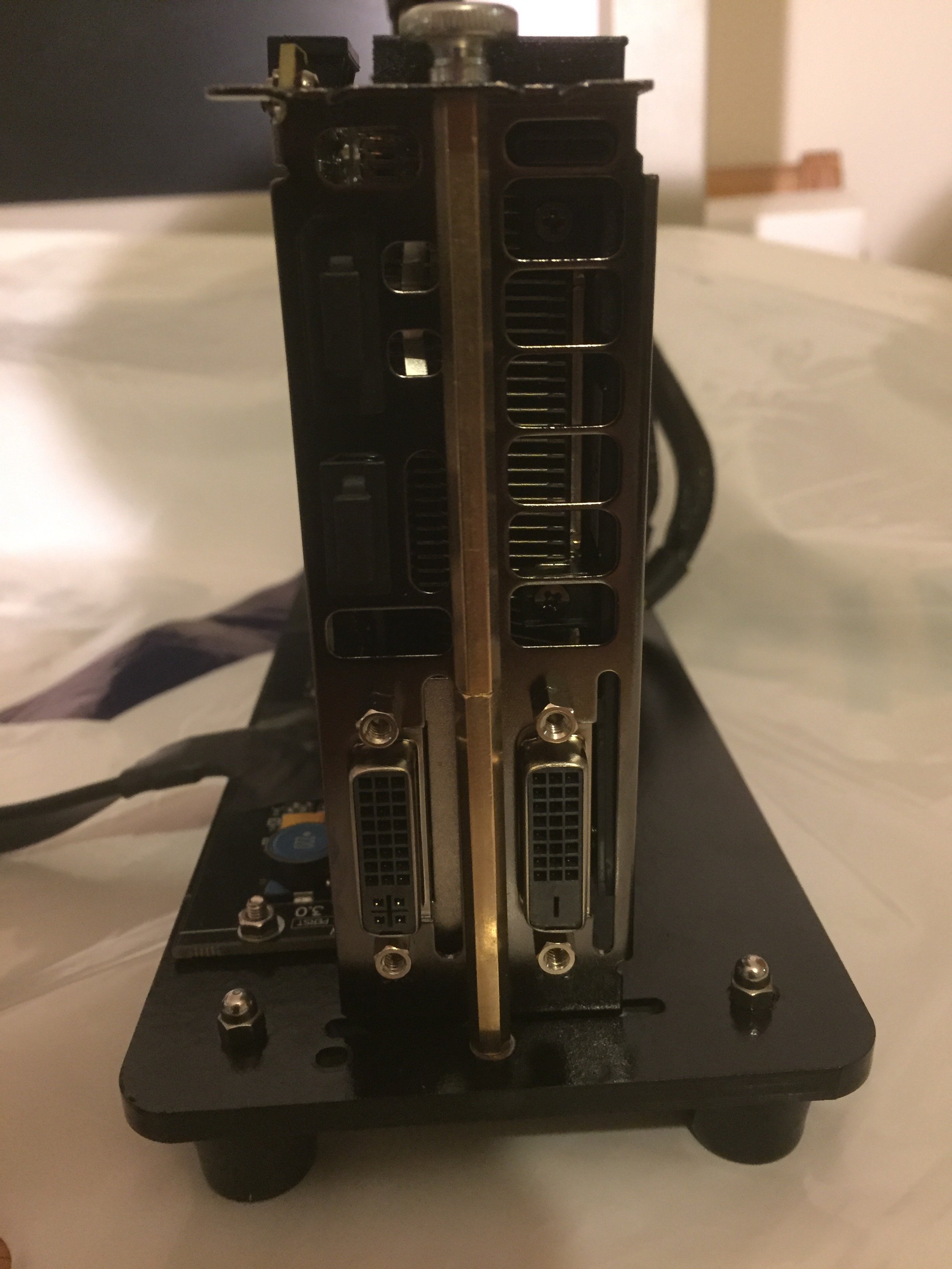

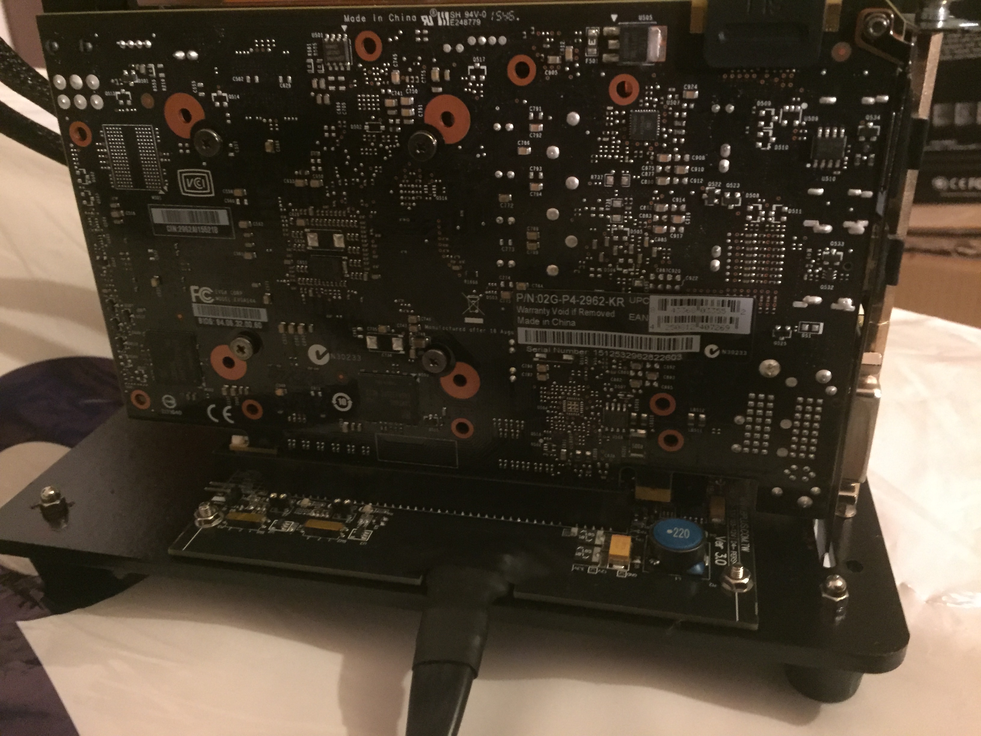

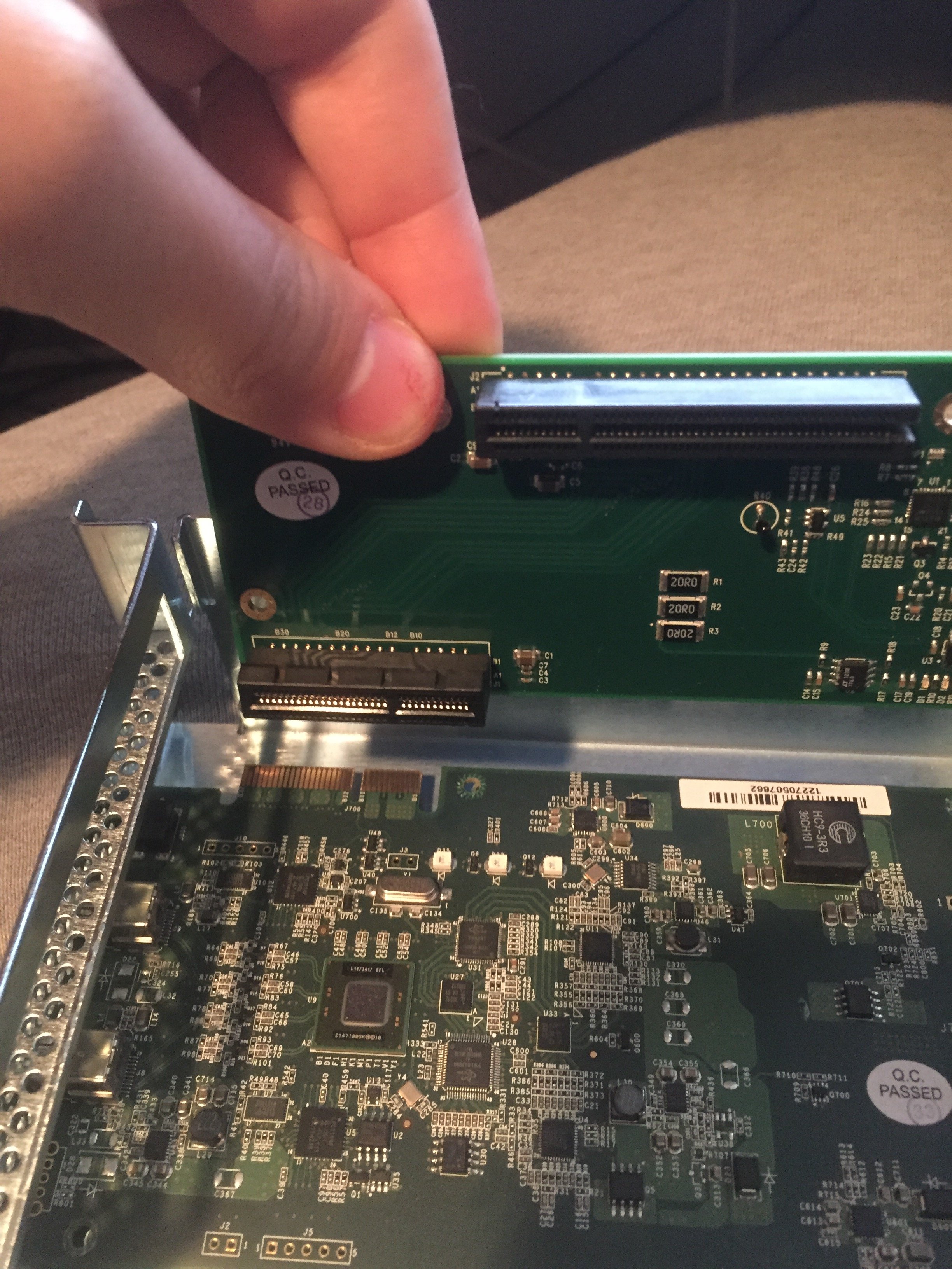

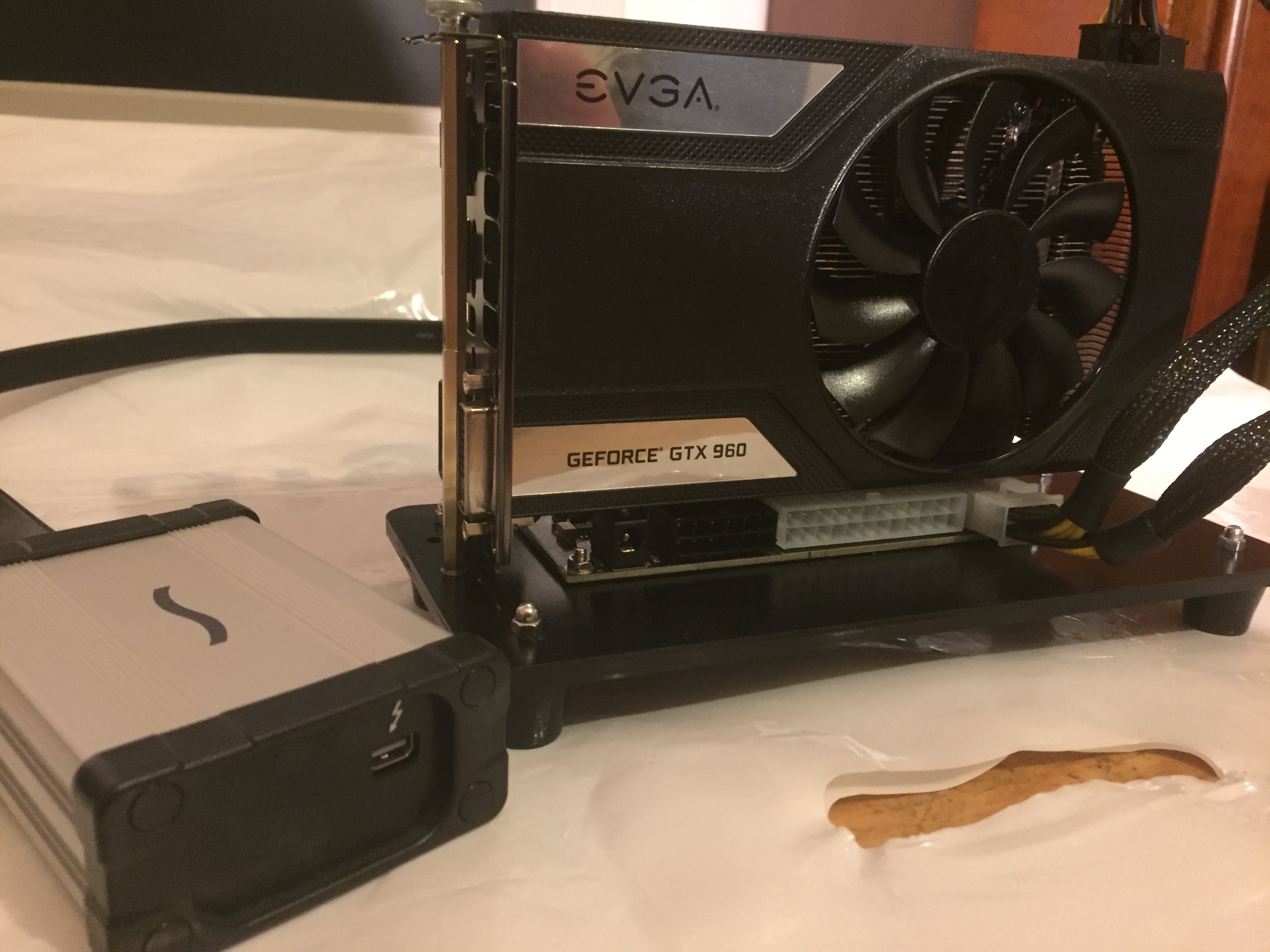

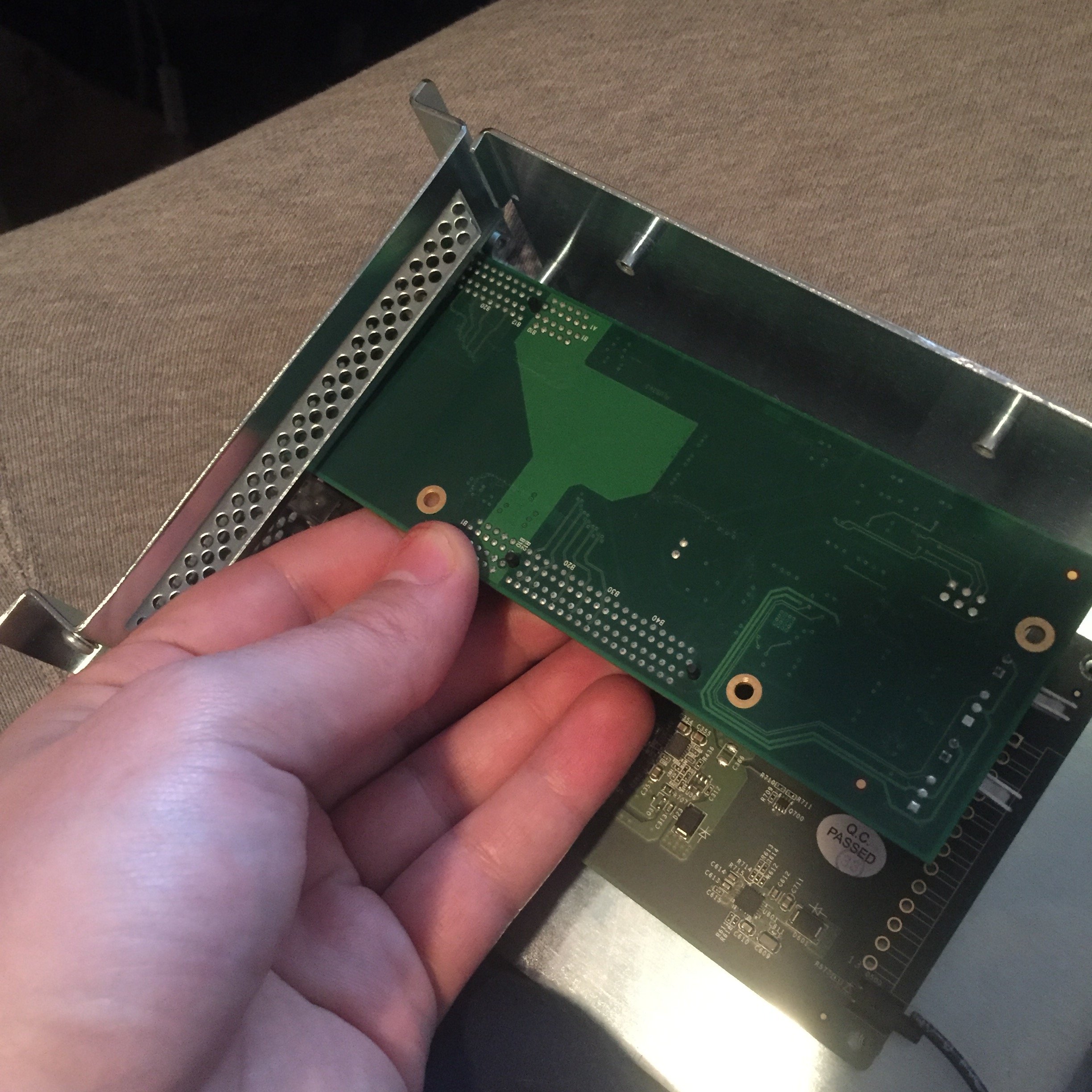

Building a straightforward eGPU
If you have a Thunderbolt 1 Mac and don't want to hassle with power requirements: PE4C v 3.0, reaches 400 Mbit via the Sonnet Thunderbolt-Adapter http://www.mfactors.com/pe4c-v3-0-ec060a-pm060a-hp060a/
Supports up to 220 Watt with a Dell DA-2 AC adapter http://www.ebay.com/sch/i.html?_fro...apter.TRS0&_nkw=Dell+DA-2+AC+adapter&_sacat=0 ore more with an ATX PSU. When I receive the Dell AC adapter I will do some tests, especially if the 400 Mbit have enough bandwidth for a 4K monitor.
Some pics:

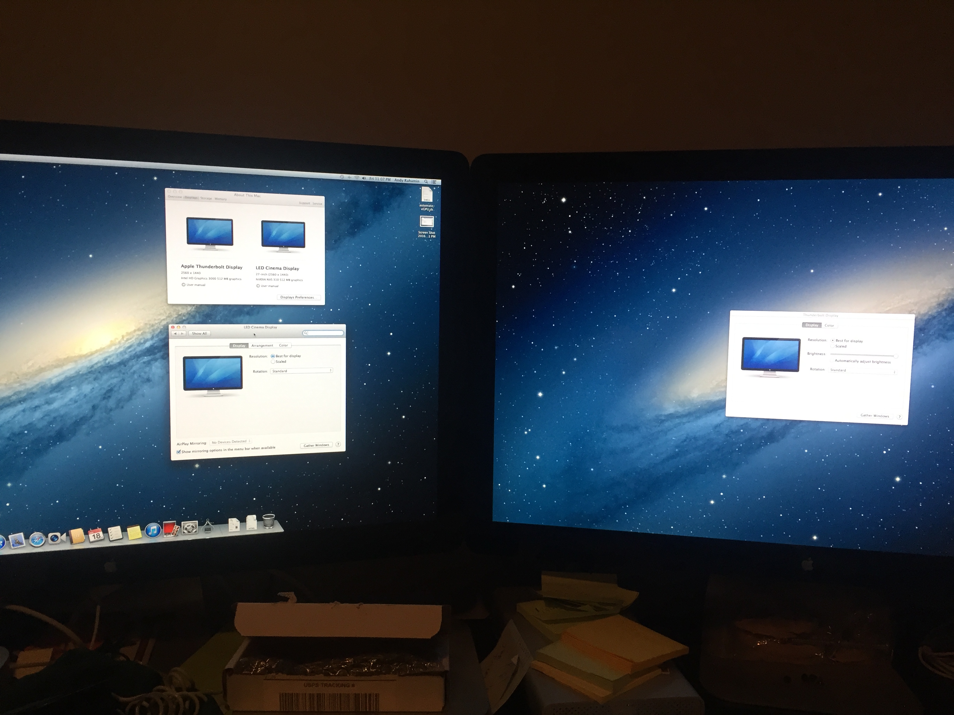

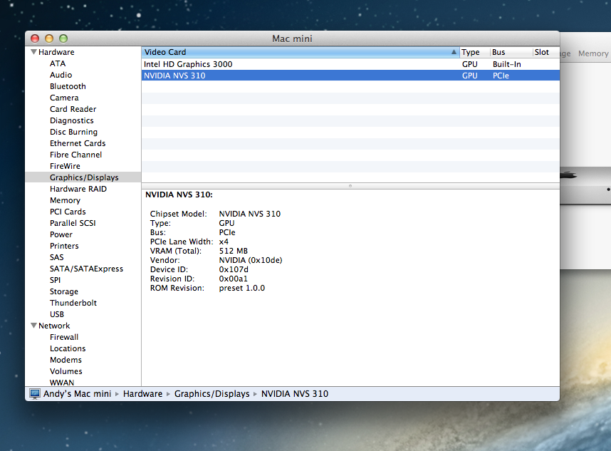

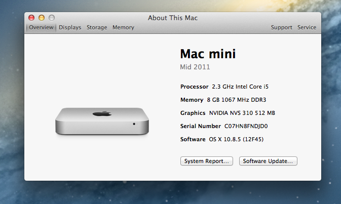

It works on 10.8.5! Going to try to do a fresh install of 10.12 and see what happens. Check it out:

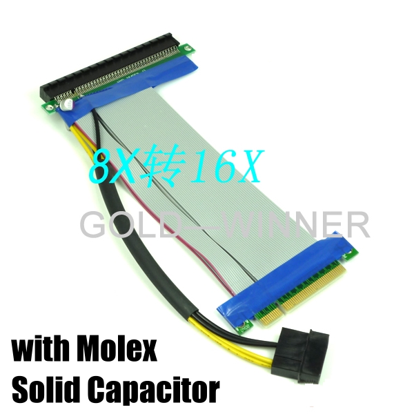

Problem is its TPD is 50W... Are you absolutely sure I need a powered riser for this? Even if I am only using 1 port out of the 3? Why would OWC use the word 'Minimum 25W'? The power supply they included is 12V 5A which produces 60W total.
If I get the powered riser can I use something like this which would supply an additional 60W rather then a PC power supply? https://www.amazon.com/Power-supply-4PIN-molex-connector/dp/B00OVC92QQ/
Yes, this is exactly the HP GT 630 with Kepler GK107 I have. Works without problems in all OS X. Faster than the internal Intel HD 3000 or 4000 iGPU. Supports two 4K and even one 5K monitor (via Dual DisplayPort cables).
You could try without powered riser cable , directly connecting the 60 Watt AC adapter to the Helios. ATX PSU is not obligatory. Maybe the AC adapter should have a little more Watt than the card.
But don't complain if you fry the Helios and the card. I fried a Thundertek/PX, but I must admit that I don't know the Helios. Workaround with powered riser cable is always the safest way.
30W overhead has to be provided for powered Thunderbolt pass through. Some enclosures (ex Akitio Thunder2) make at least part of that power unofficially available to x16 cards when thunderbolt chaining isn't in use. I have no clue if that is the case with your enclosure. Maybe the Helios uses the same circuitry. Maybe the 50W rumor if not chaining thunderbolt devices is correct. Maybe the Synchro's fried card was a fluke.
We aren't absolutely sure that a powered riser is required, its just the safe bet given the number of maybes.

2) You are talking about something like this for the riser to connect the GPU (I need to convert 8x to x16 even though I already melted down the connector on the main board)? The link to your eBay listing earlier in the thread wasn't working.
I am going to attempt to fit this all into the same enclosure as well. The PCI x8 board connects to the main board by a x4 connector. I am going to buy this riser and try to flip the board that connects to the card upside down on top of standoffs so I have space to install the GPU correctly with enough space to connect its riser.
From this:
To This:
I'll keep you posted on the progress!
This is the right powered riser cable (with capacitor). It gives power to both sides, the Helios board and the graphics card.
Looks like the Sonnet Echo Express SE is exactly the same as the Helios TB1... The boards and enclosure are identical (besides enclosure color)!
You didn't answer if the following P/S can be used: https://www.amazon.com/110v-Power-Supply-Molex-5000mA/dp/B002TJNDU4. It will only provide 60W (12V 5A = 60W) but if I use this additional power supply with the riser and the original P/S (12V 5A = 60W) will it combine to 120W?
I would buy a bigger PSU than the graphics Card (120 Watt), to have extra reserve for power peaks, but yes, this can be used.
Connect it to the riser cable, the riser should power both, the card and the Helios board. No Need for second AC adapter, if it works like my Thundertek/PX.
Google if the Sonnet Echo Express can provide 75 Watt via PCI-E port, maybe you don't need the riser cable.
