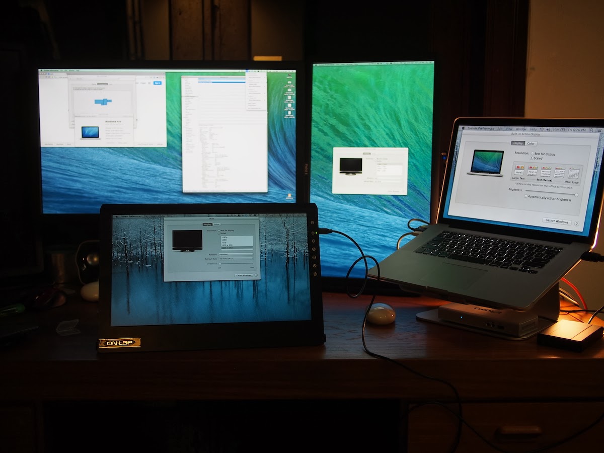

First, everything working after being left running overnight, just woke the macbook up, and both other screens lit up. It's a bit odd, as the first screen (the TB->Dvi one) lights up first, then the HDMI->Dvi one. But no kernel panics, just seems to work (for my configuration at least).
@MacModMachine Doingthatnow,closed macbook, two screens, keyboard and mouse via TBS usb3 connectors. May try bluetooth later....

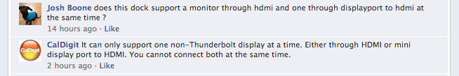

this is there official response to the question,

Next morning....
Well, the official response is right in that way, that caldigit's box isn't feeding the 3rd screen if you have in the tb-chain from computer first caldigit, then some other tb-device and finally take dp out from that second tb-device.
Basically this is pretty simple: all tb-devices have one tb-controller that can extract one dp signal out of tb-stream.
Also, there can be more than one dp-stream in one tb-stream.

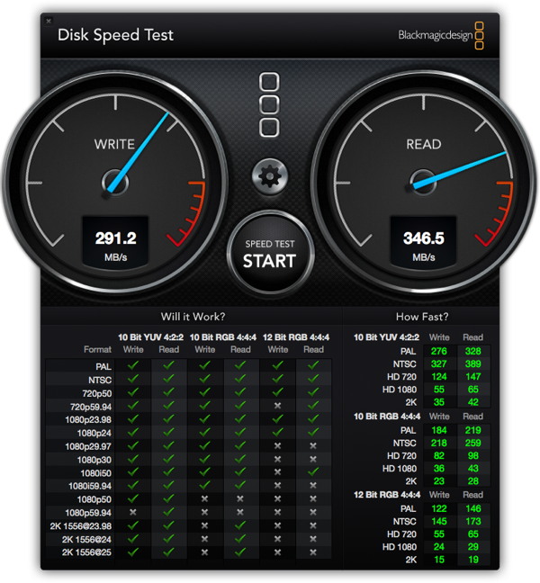

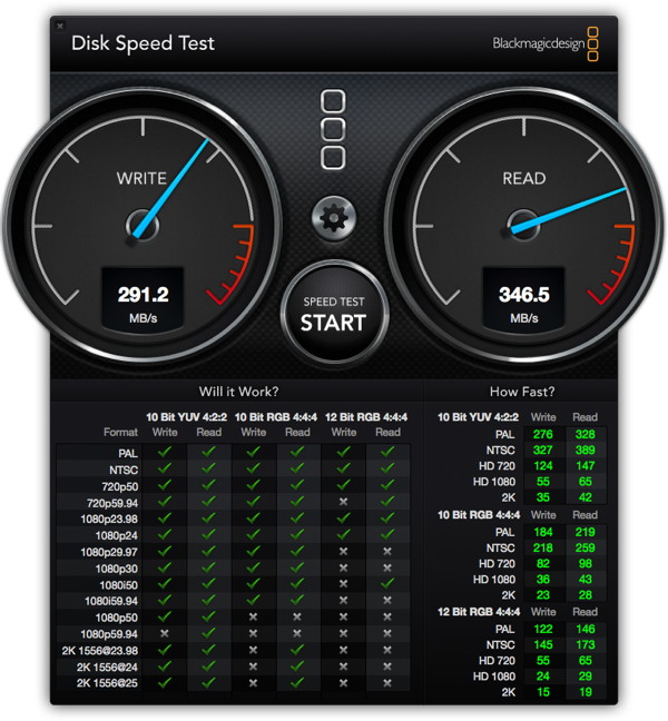

Mine just arrived, and here is a very quick test on an external SSD. The SSD is a Samsung 830 128GB, in an Oyen Digital MiniPro enclosure, plugged into the CalDigit Thunderbolt Station USB 3.0, which is in turn attached to my 2011 Macmini.

I am puzzled about the disparity in read speeds we each got with virtually the same externals (Samsung 830 SSD, Oyen Digital MiniPro enclosure, CalDigit TS), as mine reported just above were 291 MB/s write and 346 MB/s read. The only difference I see is I am plugged into a 2011 Macmini.
I tested that Samsung 830 connected to a couple of different docking options.
With the SSD mounted in a Plugable USB3-SATA-UASP1 docking station, the read and write speeds were virtually identical (not surprising, since both the Oyen MiniPro and the Plugable docking station use the ASMedia 1053e chipset).
With the SSD connected via a Koutech USC130 SATA->USB connector, the speeds were a bit less, at 243 MB/s write, 253 MB/s read.

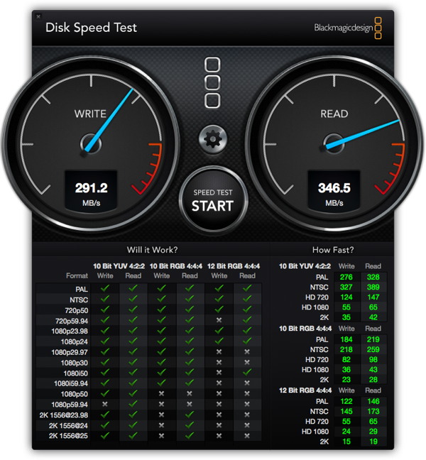

Thanks for the comments.
As for the differences. A few possible explanation:
1) SSD wear. That is a year old scratch drive I use for all my benchmarks. I also did a clean format. The reads may have degraded.
2) I had all the ports plugged into the Caldigit station at the time; full of USB, Thunderbolt drive chained, and ethernet going.
That may have impacted performance. However, that is the typical use case for this device. Expect it to be filled up and used as it sold.
