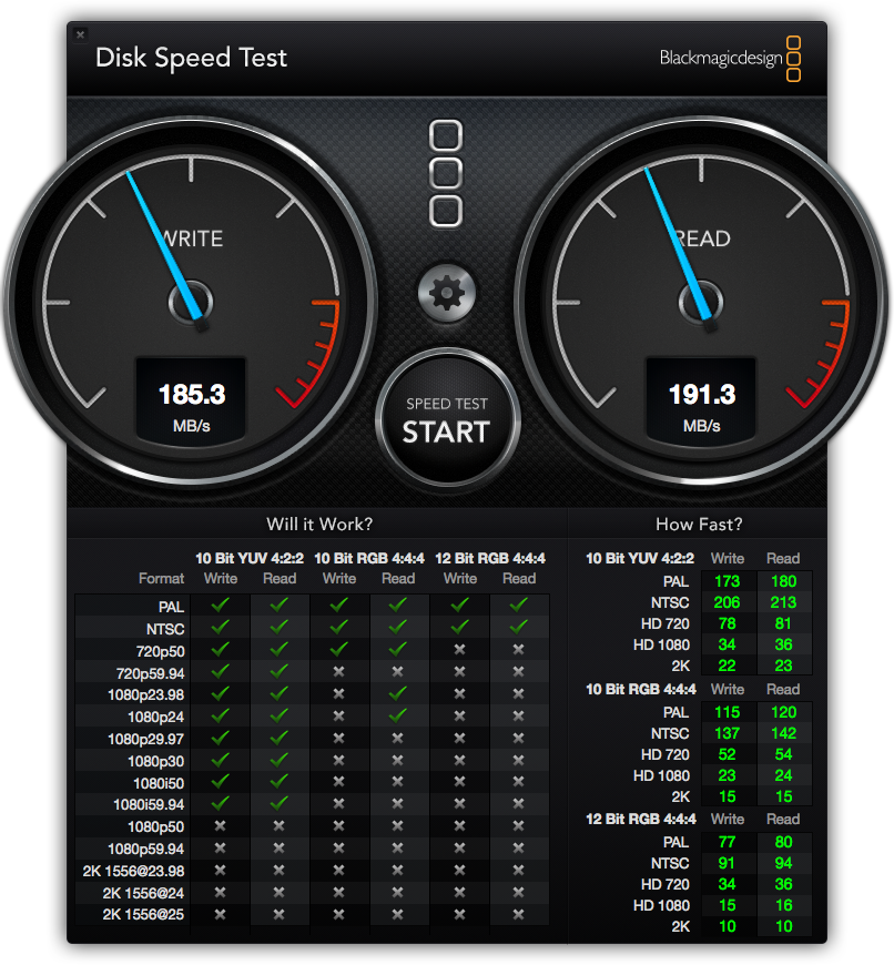

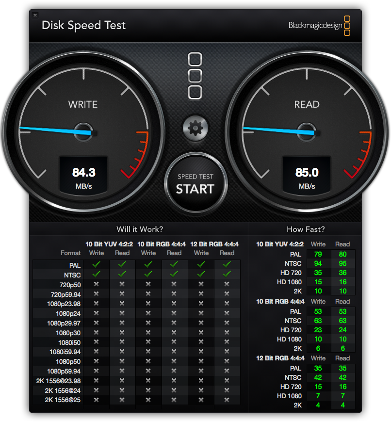

what speeds are you getting on your USB3 devices. I tried my WD passport and got speeds like the ones on the attached image. My best guess is that the device is just a bit slower on USB3. I will have to test my other drives when I get back in town on Sunday.

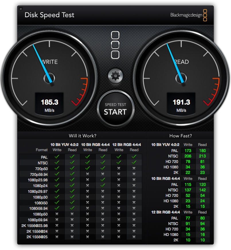

@cuestakid
see attached - seems faster than yours. Never do speed tests, but as I didn't have USB3 before the Thunderbolt station it's faster then before ;-)
