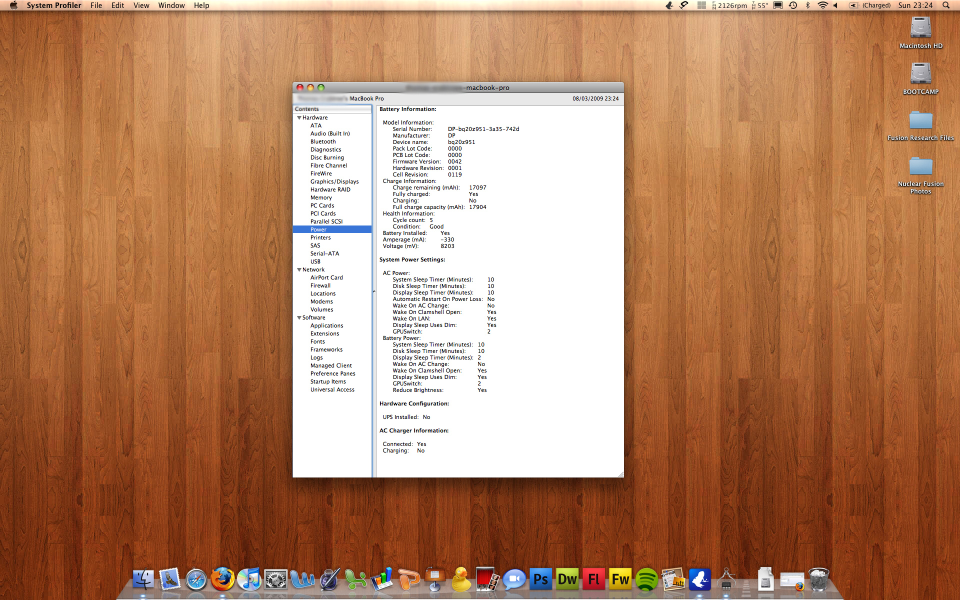

Here's the deal. Apparently, it seems that Apple's battery creation has some weird anomalies that is.. well.. just weird.
Here's how you do this:
- Goto The "Apple" in the Top Left Corner, select "About This Mac"
- Select "More Info..."
- Goto "Power" on the side
- Copy all info from "Battery Information" (Don't need System Power Settings)

or, 12518 mAh as 100% charged.
It seems that one of the users here have over 17000 mAh, which is awkward because iFixit stated their test system only had 12xxx mAh also.
I want to see how many people have the 12xxx mAh or if there's anyone else who is lucky, have over 17xxx mAh as their max capacity.

Picture posted below
I've already posted it, but you know, for starting off this thread i guess it wont hurt. I'll post my colleagues tomorrow as well because he has 17XXX mAh too. (we both live in the UK if that helps).
