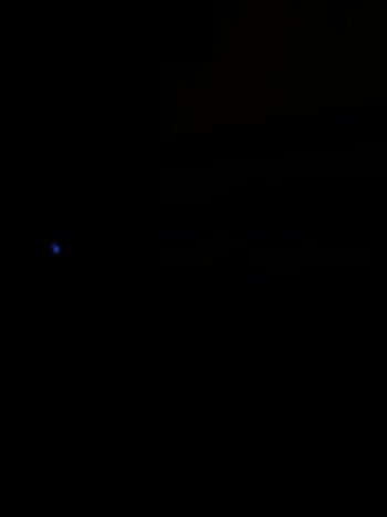

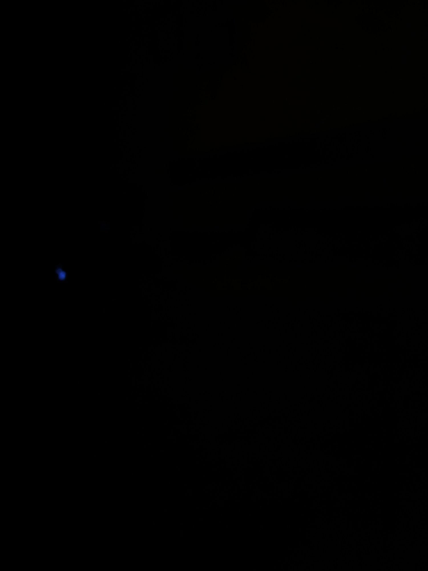

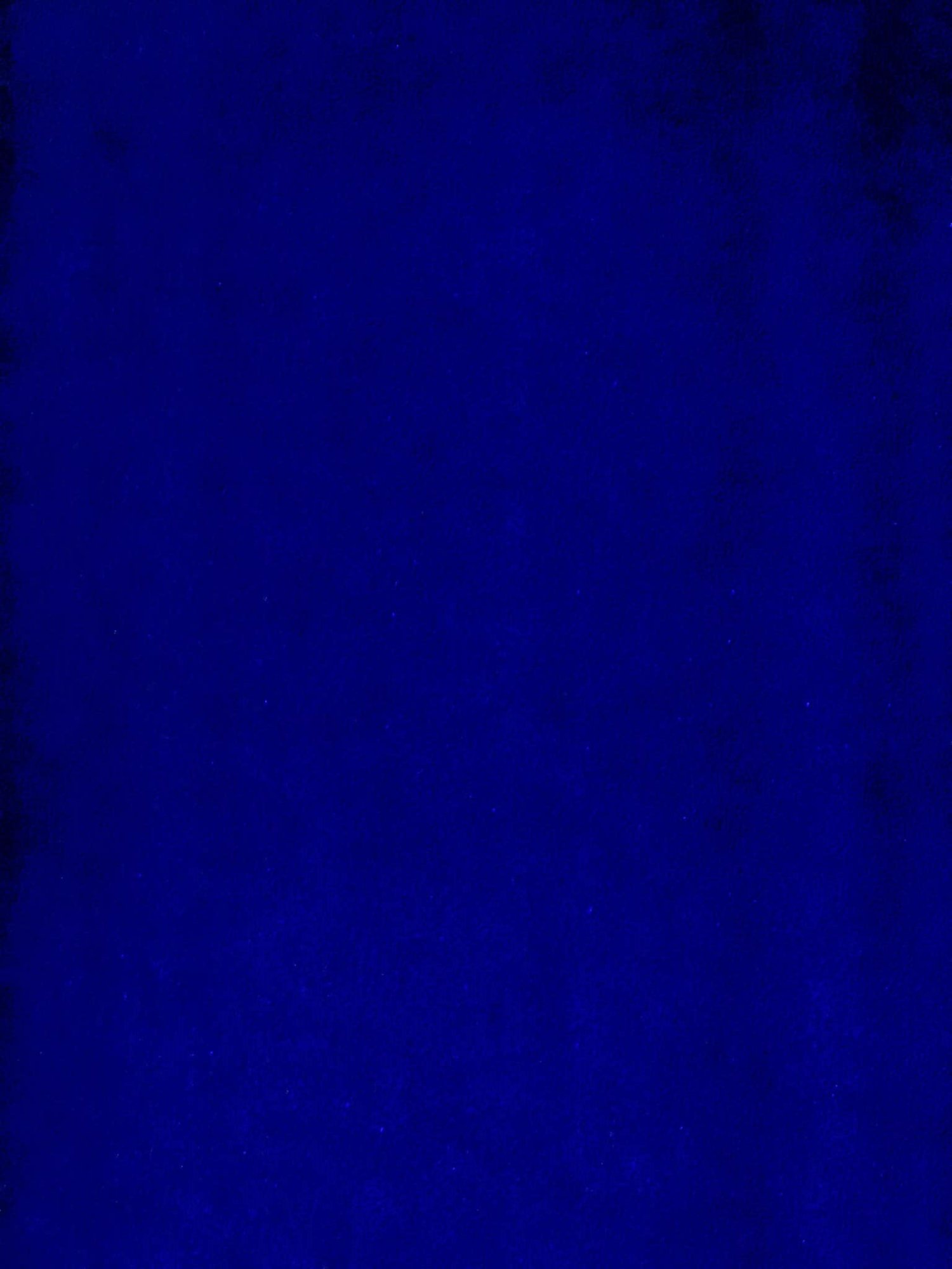

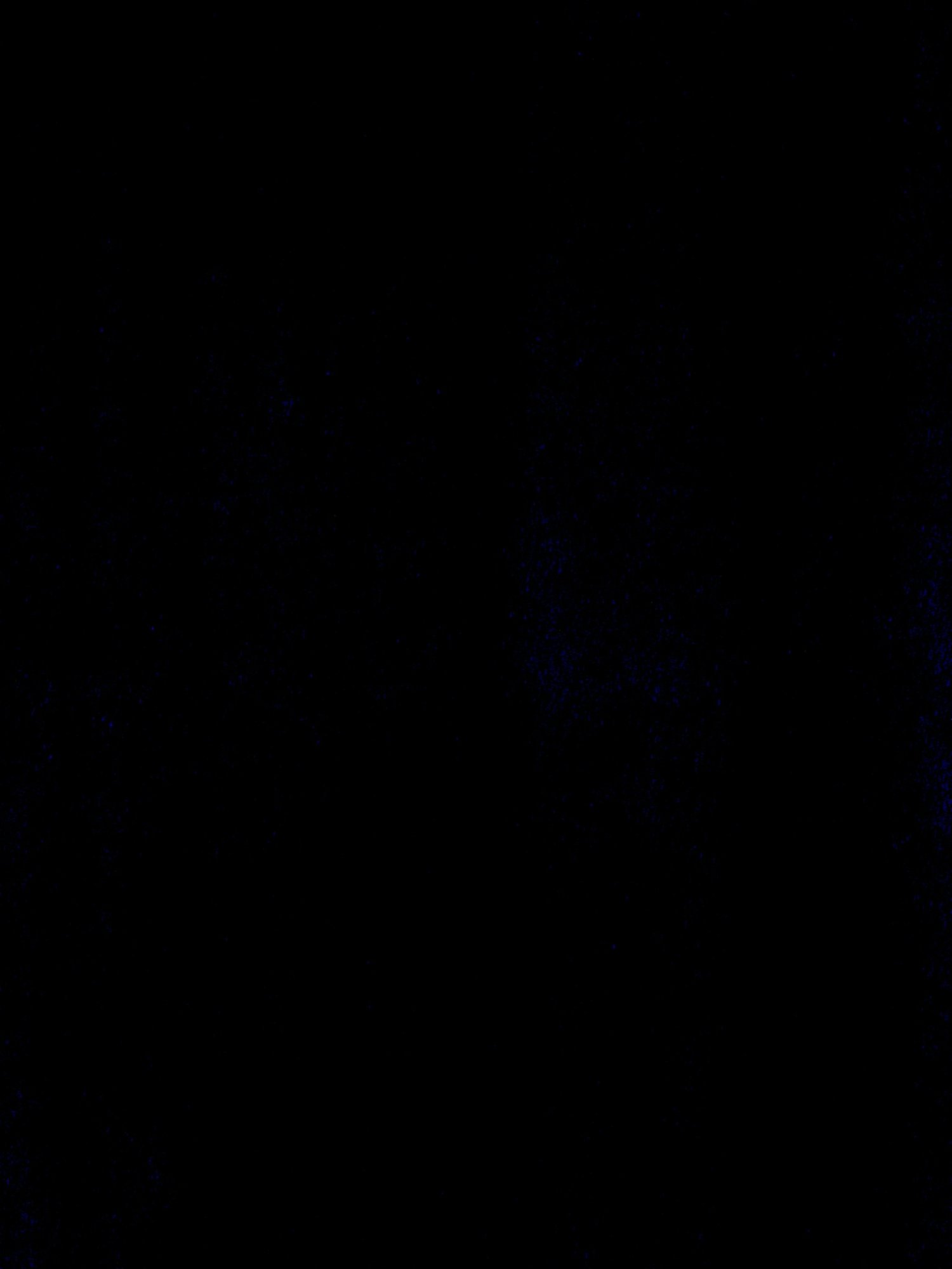

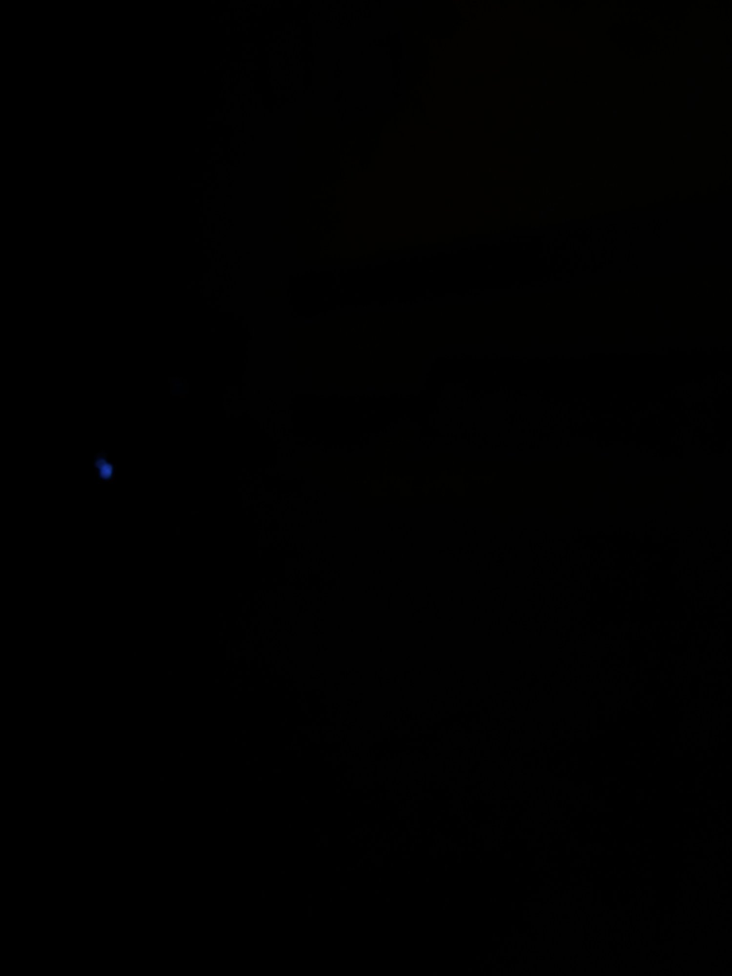

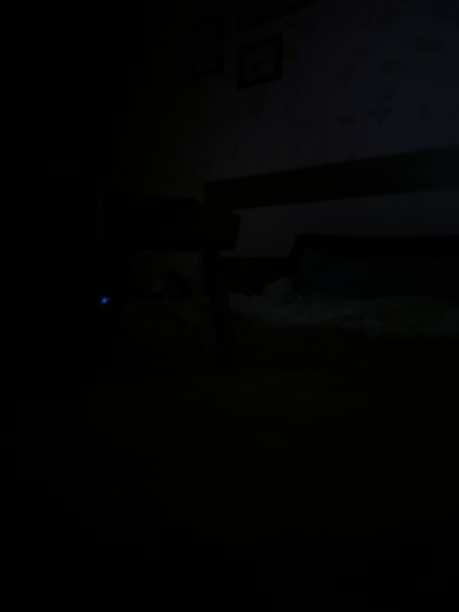

Here are my examples. The blue dot is the blue led on my mouse scroll wheel.

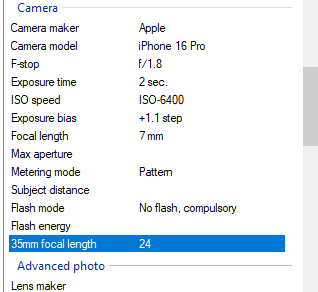

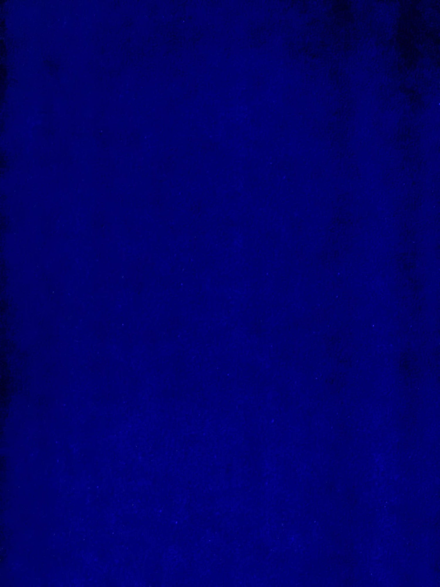

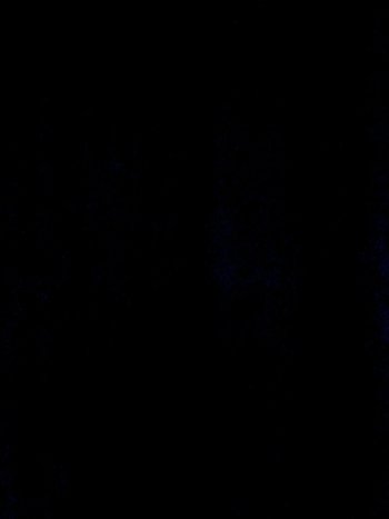

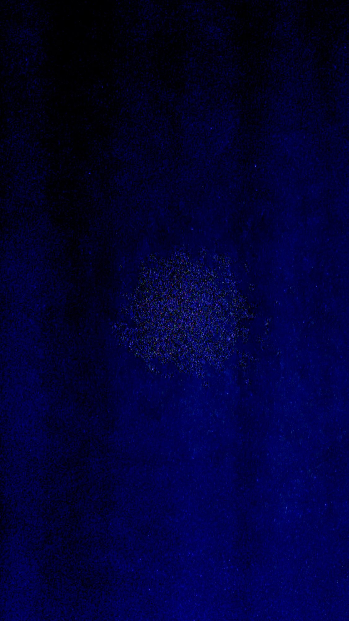

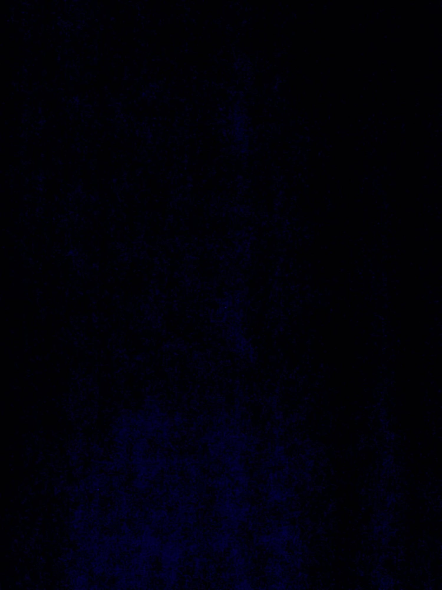

Edit: I just asked my sister. She has a Desert Titanium 16 Pro, and it has a slight tint even at 10 seconds. At 30 seconds, the whole image is blue. Her battery was manufactured in July 2024 (Bought in Germany), while mine was manufactured in August 2024 (Bought here in Bulgaria).
Edit 2. I'm attaching her results. 10.jpg / 30.jpg for seconds.
I made 4-5 photos with Reeheld in 30s (pitch dark room). All was dark and no blue haze. But photos was also much darker vs stock iPhone app.
Enhance the RAW file to match stock (exposure and shadows). There should be no blue blacks. Only pure black with luma/chroma noise.
I will try. So if here is fine like now, does this mean my camera is fine or still not? I'm really confused. 😀
If you have no issues in real photography then you are fine.
My confusion arises from the fact that Reeheld displays perfect results, while the stock app shows blue under the same conditions. This discrepancy leads me to question why one app has this feature and the other doesn't. Additionally, I'm unsure if Reeheld is indicative or if I should always rely on the stock app.

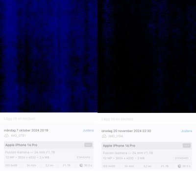

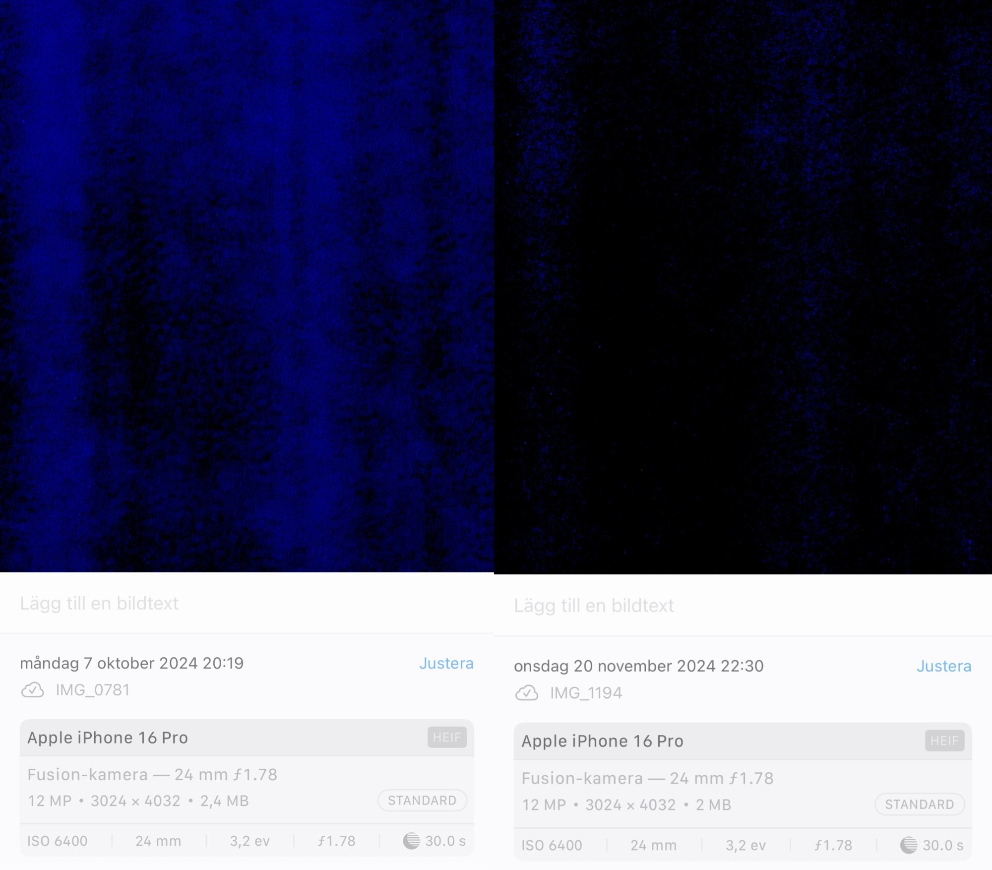

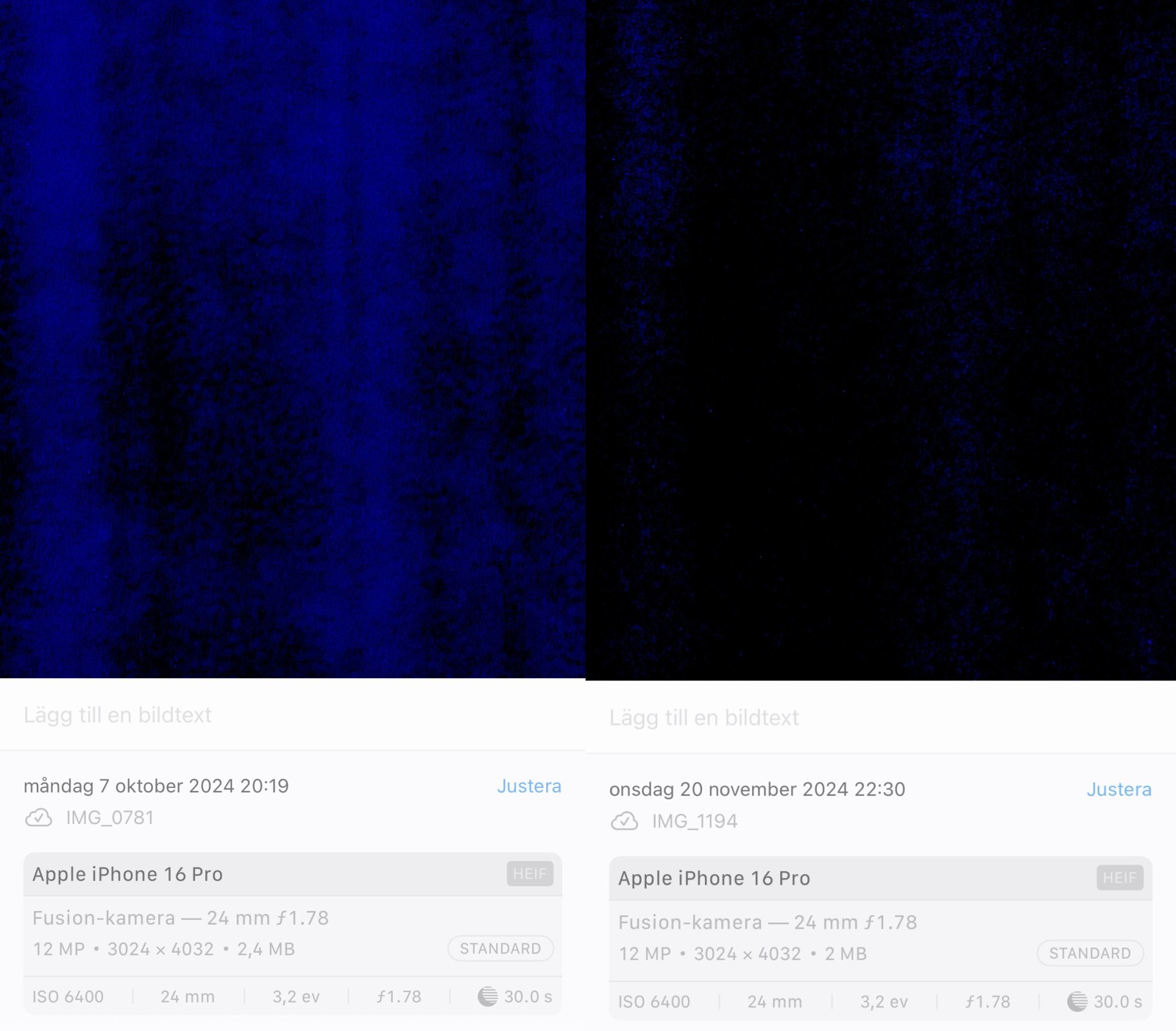

It seems like the blue issue has been reduced after one or two iOS updates on my device.
Both photos taken with same conditions and in the same ways (under blanket with Apple Watch as remote). Just took a few test photos, but it seems to actually have been reduced.
Unfortunately I have tried a few
I dont think so, I have both types of blues in all versions of firmware. Bear in mind the 30s is not consistent when you have a pure black target.
In real life very dark scenes, the type where you will trip and fall, the blue is not too horrible if you don't have another unaffected phone to compare with. But if you do you will see it in a few seconds.
Reactions: BorisDG
When I have tried 30s in pure black I have gotten consistent results. And now the blue colour is reduced.
That’s why I wrote on my device. Then again, I don’t see it in real photos 🙂

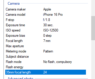

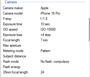

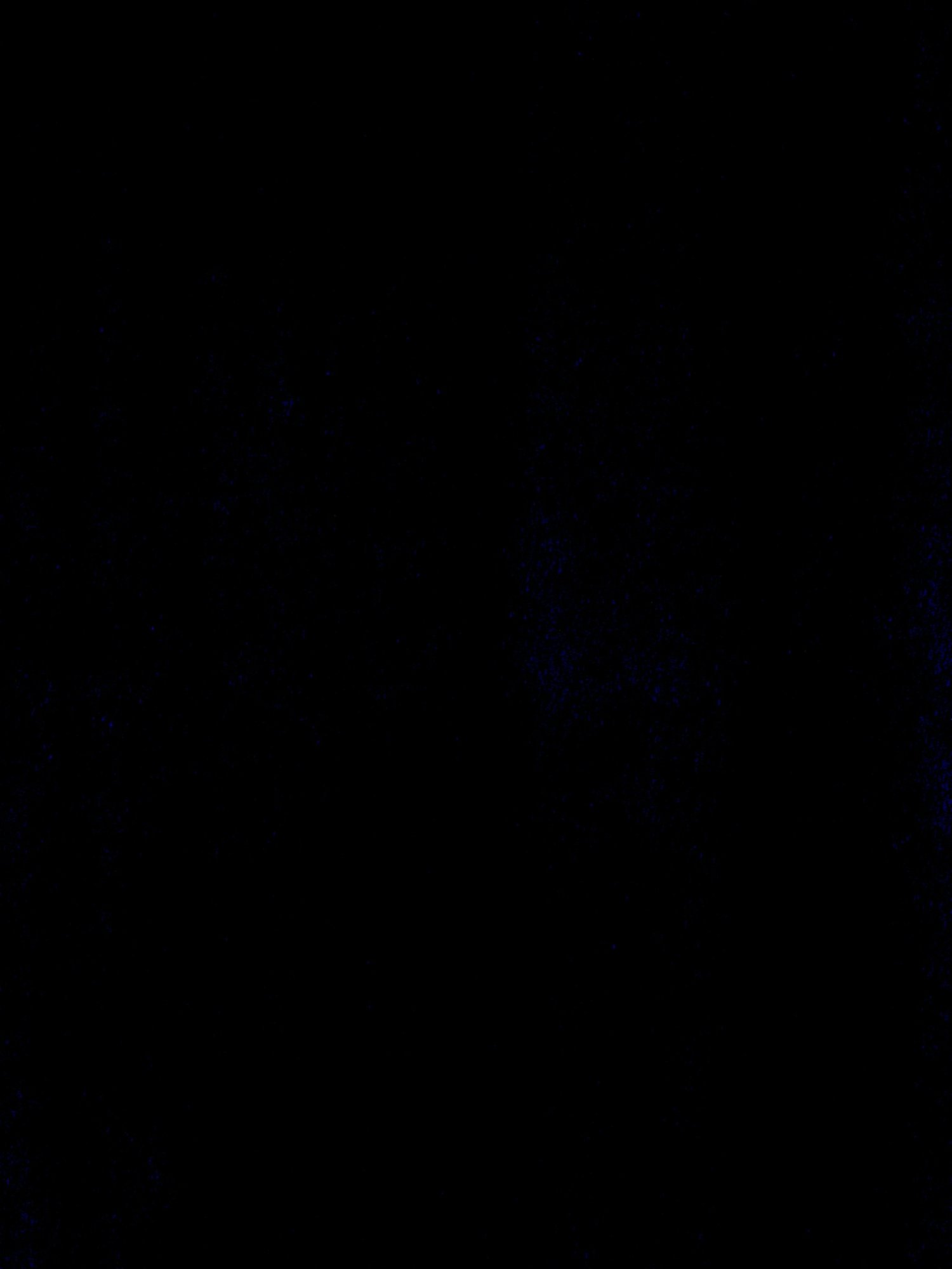

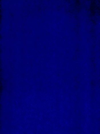

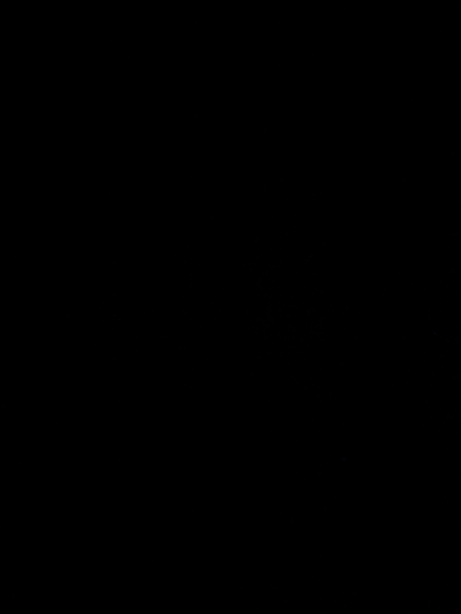

Here again tests. Pitch-dark room looking into the wall.
10 and 30 seconds. Info on the phone says 10 and 30 seconds, but If i check photos via "Properties" - 10s is 2s and 30s is 10s. No idea why. How it is?

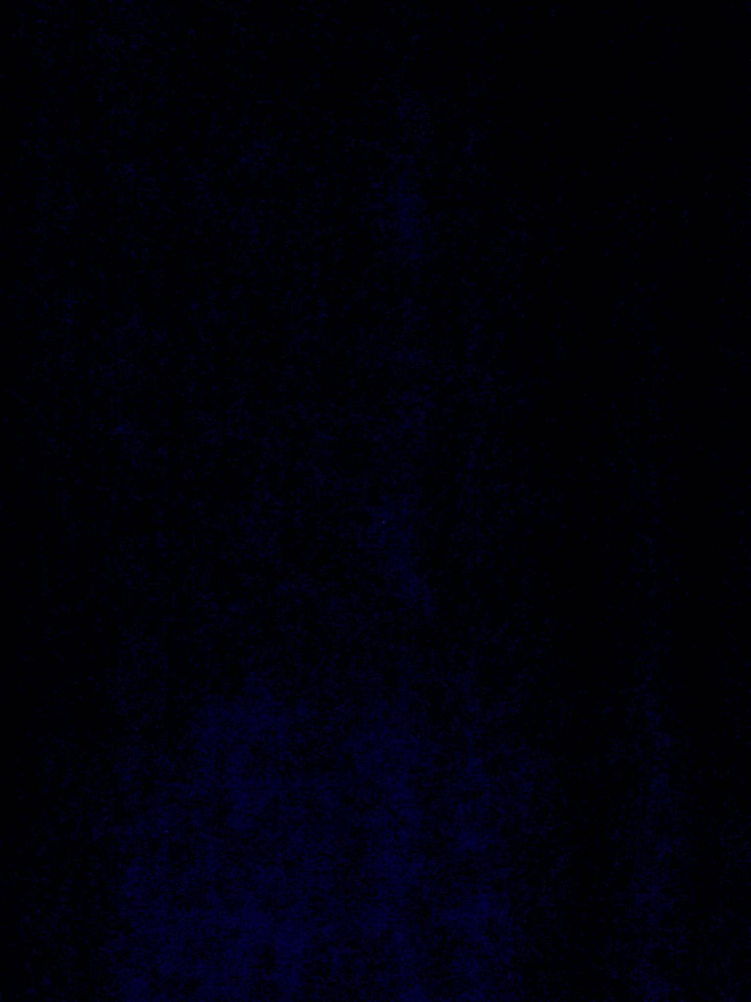

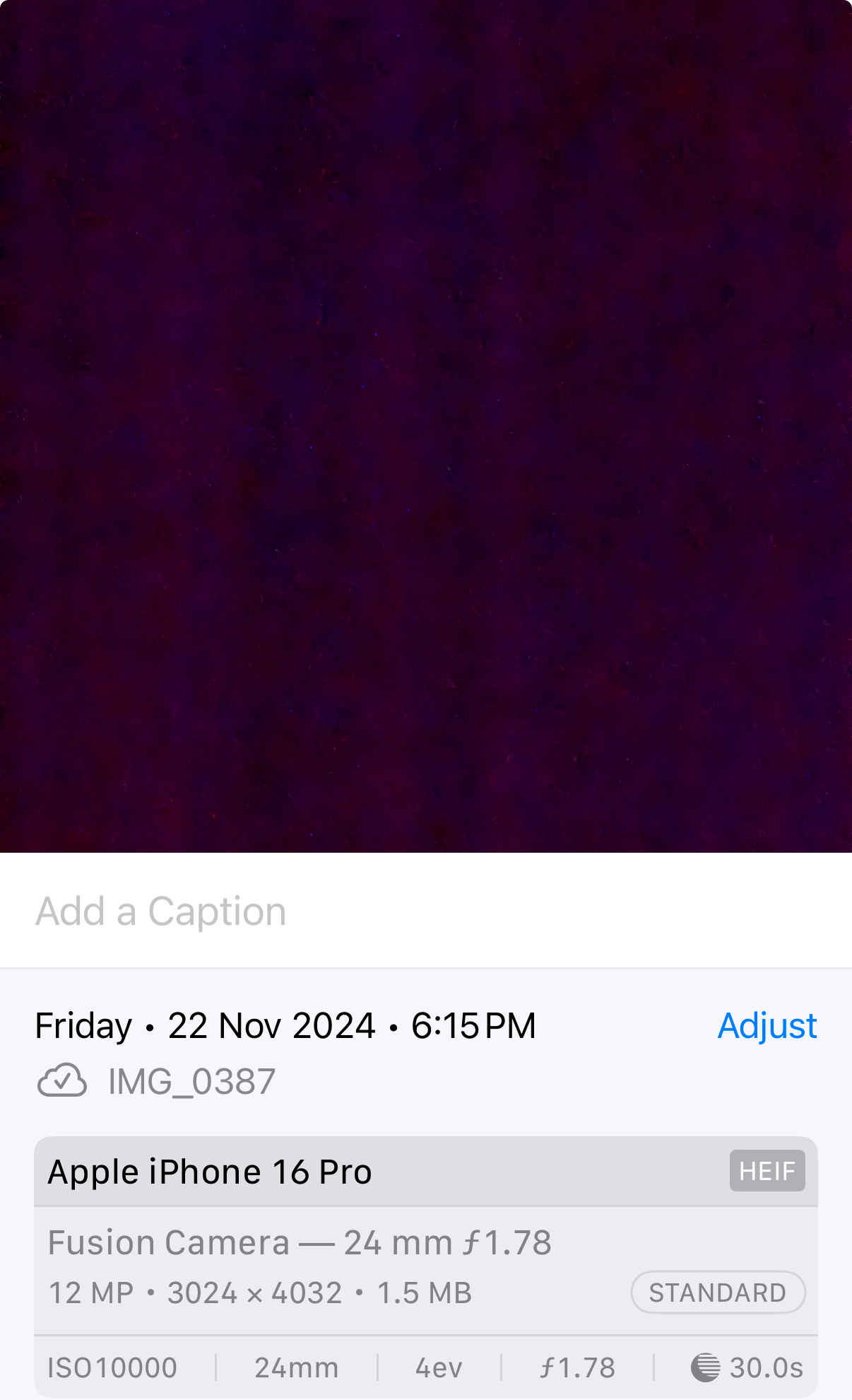

Running iOS 18.2 Beta 3 and they are working on fixing it through software. I think Beta 2 was better as it was more black with slight blue tinge. Beta 3 has gone more red 😆 this is just the camera flat down test. I haven’t tried a proper night photo yet
Reactions: BorisDG and lee82gx
Running iOS 18.2 Beta 3 and they are working on fixing it through software. I think Beta 2 was better as it was more black with slight blue tinge. Beta 3 has gone more red 😆 this is just the camera flat down test. I haven’t tried a proper night photo yetView attachment 2454511
Beta 2 was flawless for me (pitch black), now with beta 3 & 4 it’s indeed very red and blue.
