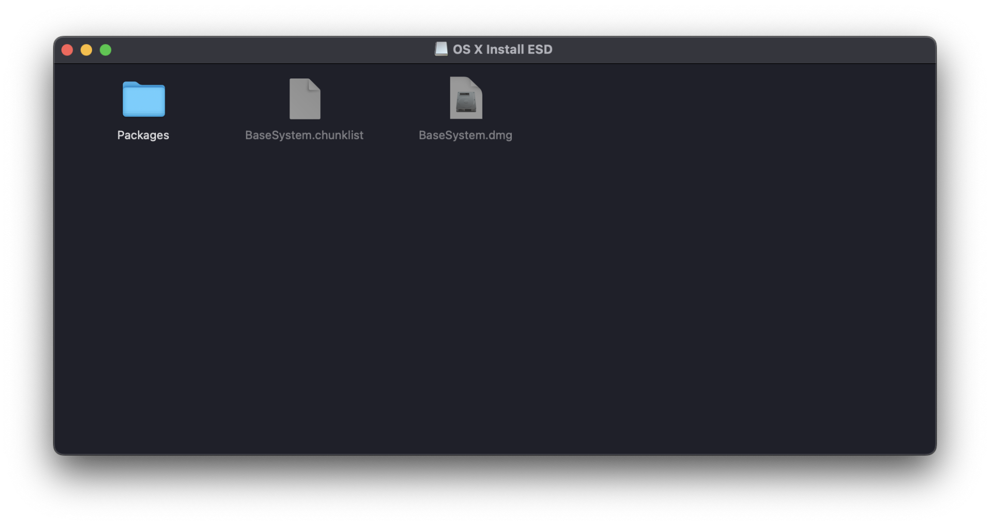

Also remind me again what the difference is between InstallESD & BaseSystem? I thought InstallESD had the "install osx.app" which had BaseSystem embedded inside of it (last time I analyzed this I remember that it did something clever where it uses an obscure kernel flag to effectively mount and chroot the core system libs). But it seems like you're doing the reverse, putting InstallESD inside base system?
BaseSystem has everything—including the installation app—except for the directory /System/Installation/Packages. Where this folder should be, BaseSystem just has a broken alias.
InstallESD has a single folder inside of it: Packages.

InstallESD itself contains a hidden BaseSystem.dmg - it is usable? It seems to be complete without packages, just like the RecoveryImage.
...Turns out the hidden one inside InstallESD is bit identical to the one from the RecoveryImage, so I'm going to go with yes, it's usable. 🙂 Great find!
This saves us a second download, but I think I still need to manually put the image together with hdiutil... right? Am I missing something? Why is the hidden DMG even in there?

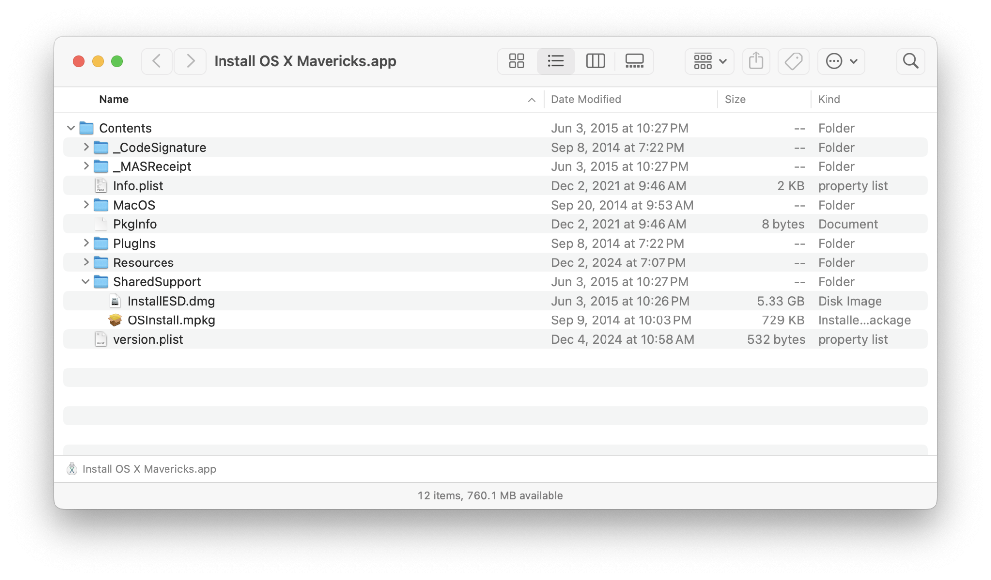

One final thing - I think the downloaded files can be turned back into an "official App Store" installer application!
Mount the BaseSystem, copy the application to somewhere writable, and inside the application contents, create a folder named SharedSupport.
Then, inside the SharedSupport folder, copy in the InstallESD.dmg image, and OSInstall.mpkg (which can be obtained by making a request to
http://osrecovery.apple.com/InstallationPayload/Distribution in the same manner as http://osrecovery.apple.com/InstallationPayload/OSInstaller).

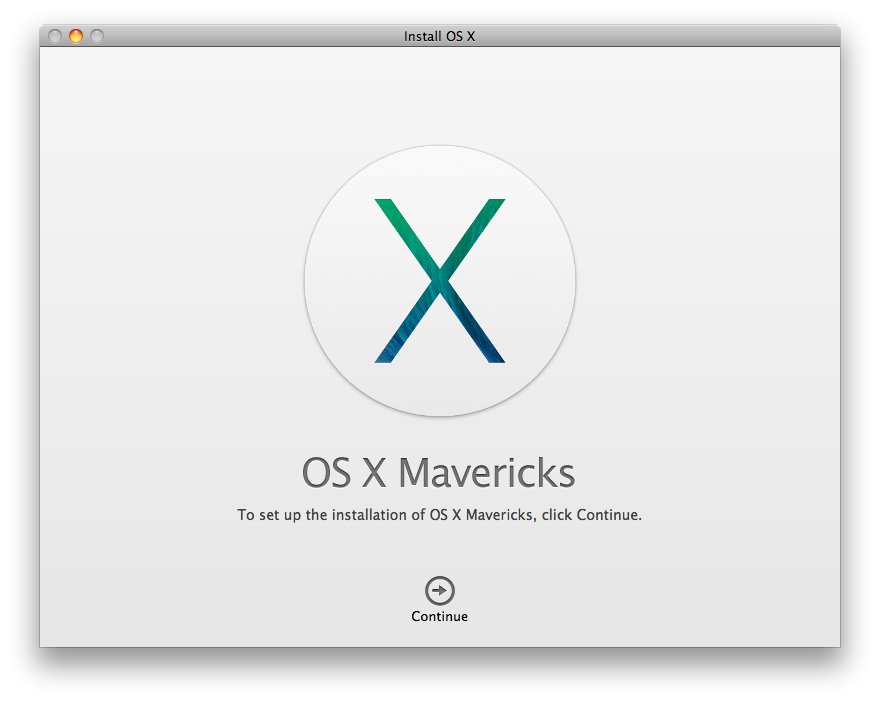

After doing this, running the installer prompts me to choose a disk and install as if it were an official installer.
If someone can verify that this installer functions normally (i.e. createinstallmedia and installing through the UI both work), then I think it would be a great addition to @Wowfunhappy 's script.

The installer from the disk image throws up a error stating "This is not a supported method of installing the operating system". I think having a 2-option menu (download installer application, download installer disk image) would still keep the script simple, but of course its your choice.

I wonder if it would be possible to copy InstallESD.dmg inside of SharedSupport instead of copying InstallESD's packages to /System/Installation/Packages, and still end up with an image that can be booted? (Doing both would be stupid, we'd end up with an image that is twice the size.)
...if that's not possible, maybe we do need options. Because as I think about it, there really are two equally canonical versions of the Mavericks installer: the GUI app you'd get from the app store, and the bootable image.
Edit: Actually—I think it would be best to just have the script output both. So at the end of the script you'd end up with two files: InstallMacOSXMavericks.dmg and "Install OS X Mavericks.app". The user can delete whatever they don't need.
Edit2:
I wonder what the difference is between OSInstall.mpkg obtained from OSInstaller, and the one inside of InstallESD.dmg/Packages. The two files are not bit-identical, although they are roughly the same size (729kb and 728kb, respectively).

- Copy BaseSystem.chunklist and BaseSystem.dmg to the root of the USB installer:
Code:
cp /Volumes/OS\ X\ Install\ ESD/BaseSystem.chunklist "/Volumes/OS X Base System"
cp /Volumes/OS\ X\ Install\ ESD/BaseSystem.dmg "/Volumes/OS X Base System"
The .mpkg files are actually xar files and can be extracted with xar -xf [file.mpkg].
I believe the file of interest is the "Distribution". When the Distribution from the IR OSInstall is diffed with the dmg OSInstall, it seems to be a slightly updated version.
