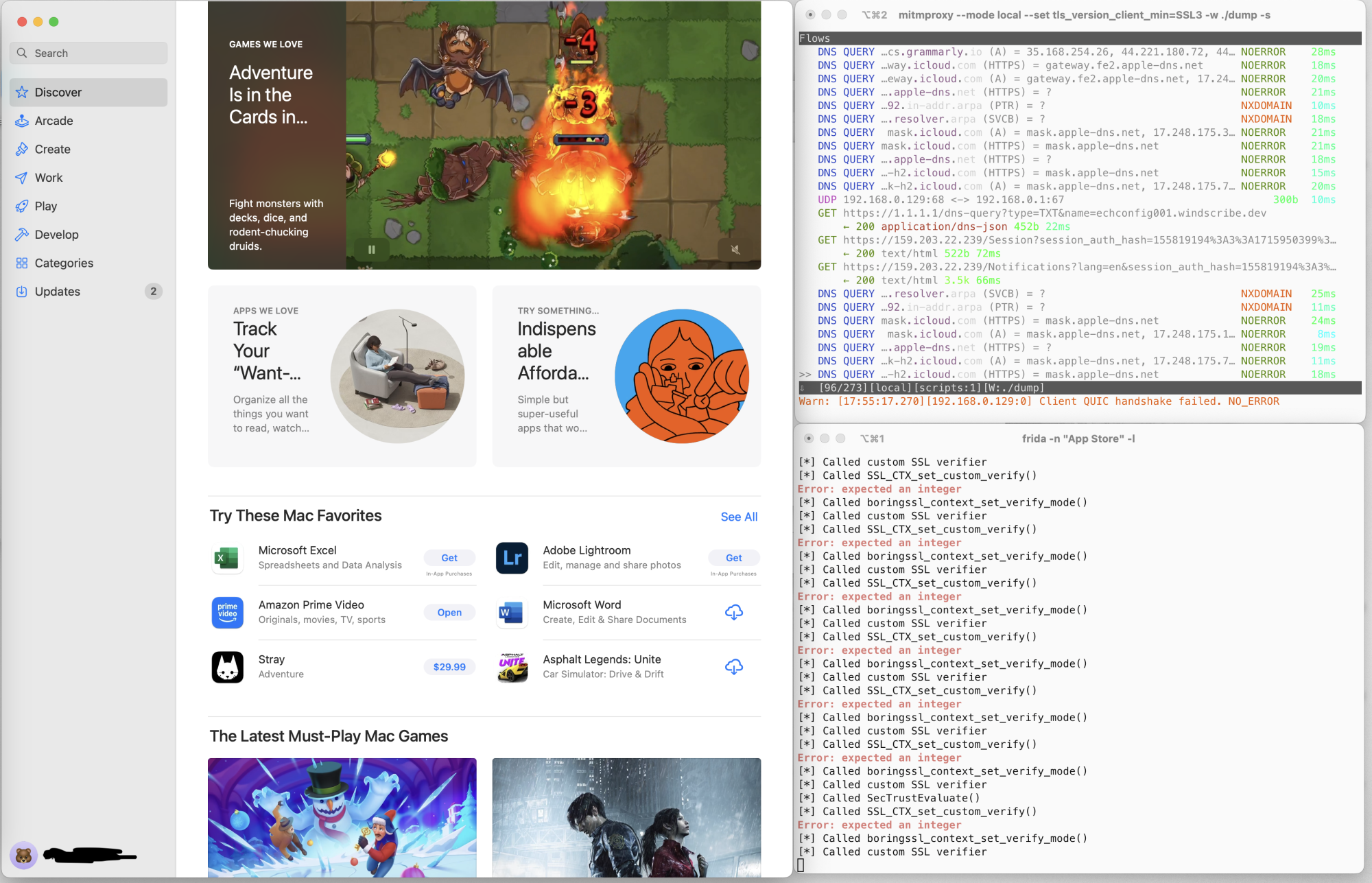

Dead end unless we could somehow bypass this...
Given that you're using Frida, if you've disabled SIP you should be able to inject into MASAgent (or whatever does that verification) and bypass signature check.
Unless we can bypass this with Frida, dead end... EDIT: Sorry, didn't see your previous post, my browser didn't show that this posted.

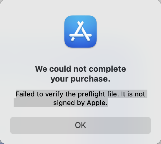

Currently learning to work with frida and hopper, I believe I found the trouble function (-[PreparePurchaseTask completeWithError:]) but I'm not entirely sure. Working on finding a way to make it do nothing when called.
Sadly, no luck. I've figured out that it is def in the appstoreagent process but as to patching it out I have no clue. I believe I know what assembly code has to be removed but actually going about that I'm not sure because I am not willing to pay $100 for hopper dissassembler on a hunch. For all we know the app store doesn't have the key to decrypt it and apple changes the key.

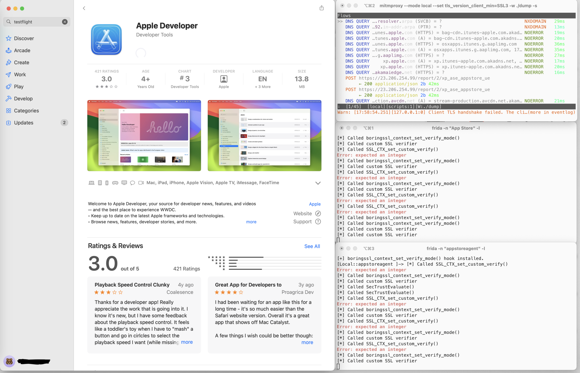

This is a bit of a task to ask, and no pressure at all, but if possible could you do this?
(I made these steps on sonoma, but theoredically they should work on any macOS version)
1) Set up mitmproxy and frida (SIP would have to be disabled)
1a) After mitmproxy is set up, you need to run sudo security add-trusted-cert -d -p ssl -p basic -k /Library/Keychains/System.keychain ~/.mitmproxy/mitmproxy-ca-cert.pem in order to get the certificate working
2) Download "https://gist.github.com/azenla/37f941de24c5dfe46f3b8e93d94ce909#file-disable-ssl-pin-js"
3) Open Terminal and start mitmproxy with this command: mitmproxy --mode local --set tls_version_client_min=SSL3
4) Open the App Store (It shouldn't be able to connect)
5) Open two more terminal windows and run these commands (one in each window) to bypass SSL pinning
5a) frida -n "appstoreagent" -l ~/Downloads/disable-ssl-pin.js
5b) frida -n "App Store" -l ~/Downloads/disable-ssl-pin.js
6) Open the mavericks page and download mavericks, keep an eye on the mitmproxy window!
7) In the mitmproxy window, look for these get requests:
7a) Something similar to "/WebObjects/MZBuy.woa/wa/buyProduct?"
7b) Something similar to "/v1/catalog/us/apps/"
8) For each aforementioned get request, either click on the request or navigate to it with the arrow keys and press enter. Then navigate to response, press x, and select raw_response. Name it to whatever you like
9) In finder, go to your home directory (or wherever you ran the commnds from in terminal) and see if the files you just exported are there
Those are the files that I need, I would like to use the original store page (technically it isn't required tho) and I would really like to use the buyProduct page because it should have the hashes and other info already set. I don't believe there is any information about your mac there, but you're welcome to check if you'd like. I at least didn't find any when I checked the buyProduct page I've been modifying. I understand if you're uncomfortable with this, it's certainly quite a request and hassle to do, seriously no pressure at all.

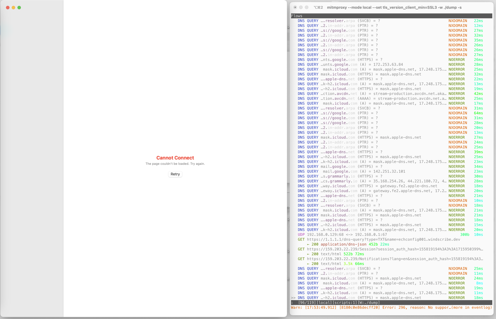

@WaterOtter78 I've used mitmproxy before (that's partly how I was able to make the existing Mavericks download script) and I'm very familiar with setting that up. However, Frida doesn't install on Mavericks (at least not out of the box), so I'd have to spend time getting that to build properly. I could also use a VM with a newer version of macOS, but that's also a pain...

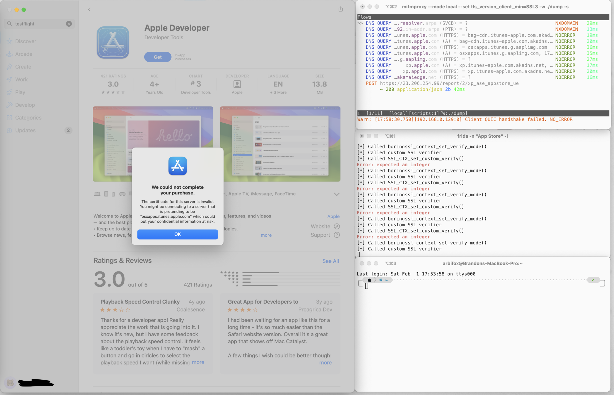

I can't download Mavericks when connected to mitmproxy, I get an error. I tried this back in December. (I can't remember if I tried other apps too, I think I did but don't quote me, it's theoretically possible that operating systems are special.)
It works fine when I use Squid but one of the Apple subdomains I excluded from ssl_bump might be letting it work.
Yeah I had the same issue initially.
I don't think 10.9 has ssl pinning for app store?
The app store throws an error when downloading items with mitmproxy enabled from SSL pinning. This is where the frida script comes it, it bypasses SSL pinning on the appstoreagent and the app store itself, both are required for downloading things.
Mavericks (10.9) doesn't have SSL pinning for lots of things which modern macOS does, which would mean we wouldn't need Frida. I don't think the App Store is one of them, though.
