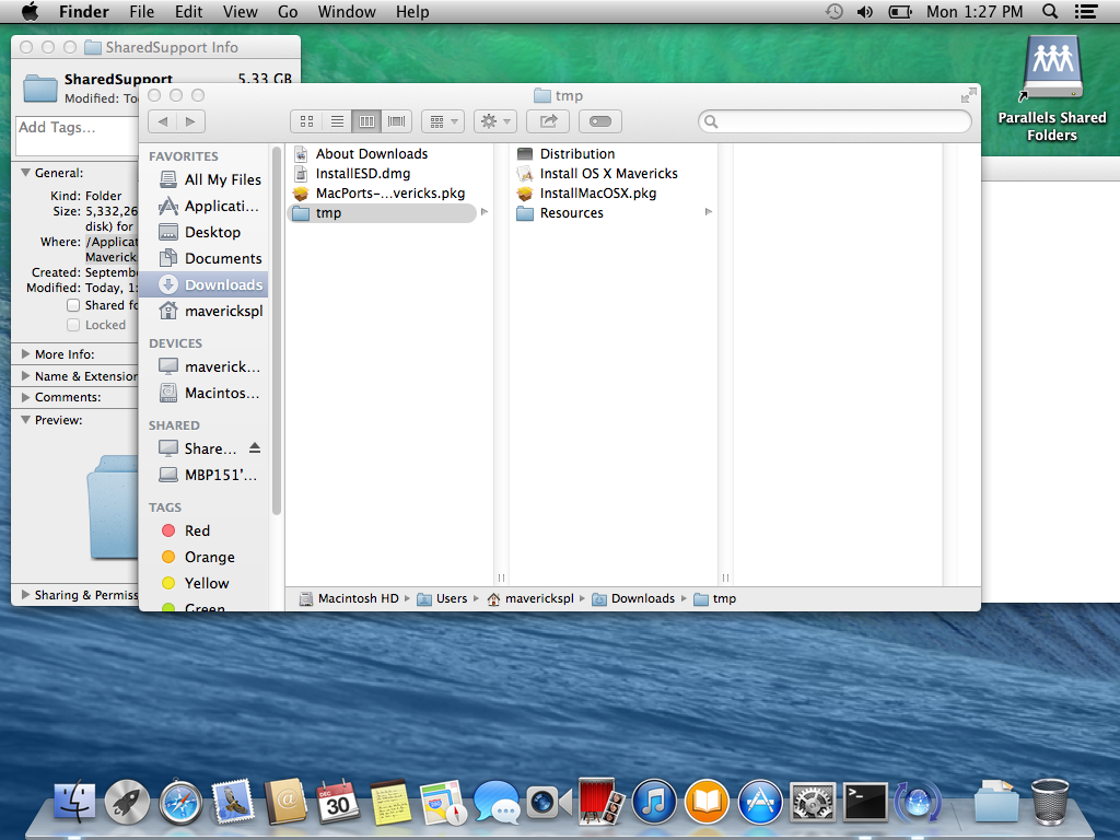

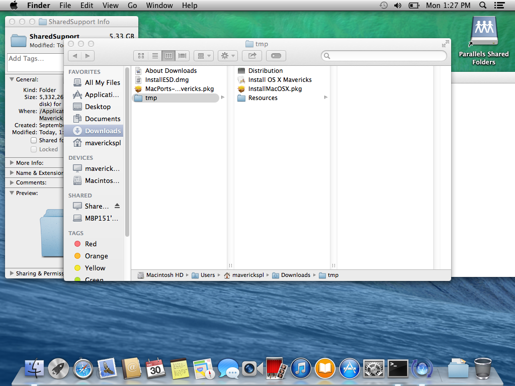

More from the emailer. We definitely cannot recreate the installer app unfortunately. @f54da you will find this interesting!
I have learned a little more about the specifics of the InstallESD, which I thought you might be interested in knowing as well. I believe it will not be possible to turn the recovery server downloads into a fully working Install OS X Mavericks.app.
Install Mac OS X apps downloaded from the App Store first come as a pkg that installs the app to the /Applications folder. However, a regular pkg install would require double the amount of storage space to copy its contents to a new location, and would add significant overhead to the install process. So the pkg file containing the installer (such as the one for Yosemite you can still download from Apple) is actually simultaneously a pkg and a dmg — the InstallESD.dmg. So you can effectively rename one of those pkg files to dmg, and it will successfully open with Disk Image Mounter utility instead of the Installer.
When opened with Installer and installed, the pkg copies a version of the Install Mac OS X app that does not yet contain the InstallESD.dmg into /Applications. The Installer then hardlinks the install pkg itself as InstallESD.dmg inside of SharedSupport, and you end up with a full Install Mac OS X app without the need to duplicate over 5 GB of data.
So how can a file be simultaneously a pkg and a dmg? A pkg is typically a xar archive, which has a header, while a dmg file uses a footer. This means that a pkg would be read from the beginning of the file, while a dmg would be initially read from the end of it. Among other metadata, the dmg's footer contains values for the offset (where the actual disk image starts relative to the start of the file) and the length of the data, so only that section of the file is read when using it as a dmg.
The InstallESD.dmg file you're downloading from the recovery server is only just that — a disk image, and does not contain the necessary data to also be a pkg, which is why the Install Assistant is not accepting it and logging "pkgdmg is missing a footer" and "pkgdmg validation has failed".
I have attempted the low hanging fruit of prepending a few bytes of data to InstallESD.dmg and updating its footer metadata so the offset would not start at 0 (as well as updating the offset of the XML property list to match). This made the install process progress past the "pkgdmg is missing a footer" step, however it now fails with "pkgdmg is not signed or altered".
My understanding is that Install Assistant still expects real pkg data to be at the start of the file, possibly to use its xar signature or checksums to verify the integrity of the data. I'd be more than happy to be proven wrong, but as it stands, if even possible to overcome this, it would require significantly doctoring the InstallESD.dmg, which would defeat the purpose of downloading it directly from Apple.
Fascinating. Yeah I do remember from our earlier analysis that the MAS download is a pkg file, but never expected it to be such an interesting procedure to dynamically construct at the final .app on disk.
If the InstallESD.dmg from a true MAS copy is also a .pkg, then it might finally solve https://forums.macrumors.com/threads/os-x-mavericks-10-9-5-file-integrity.2427955 where @Faloude wanted to find a way to validate things. The InstallESD dmg is not signed (nor are the packages within the .dmg signed), but if InstallESD .dmg is itself just a (presumably properly signed) pkg that dynamically generates the .app, then you can verify the signature of that .pkg.
One thing I don't understand though, if all this is true then why does createinstallmedia fail even though a manually created bootable image succeeds? I assumed the two were doing roughly the same thing, but it seems that the .pkg signature is never verified with the latter approach. How does the resulting structure differ?
if the InstallESD.dmg from a true MAS copy is also a .pkg,
It is a XAR archive containing the actual InstallESD.dmg i.e it is labeled InstallESD.dmg on the outside, but it is a XAR. In fact all of them legacy MAS installers are using the same XAR package wrapping the InstallESD.dmg. That is why you can't use createinstallmedia directly on the outer package.

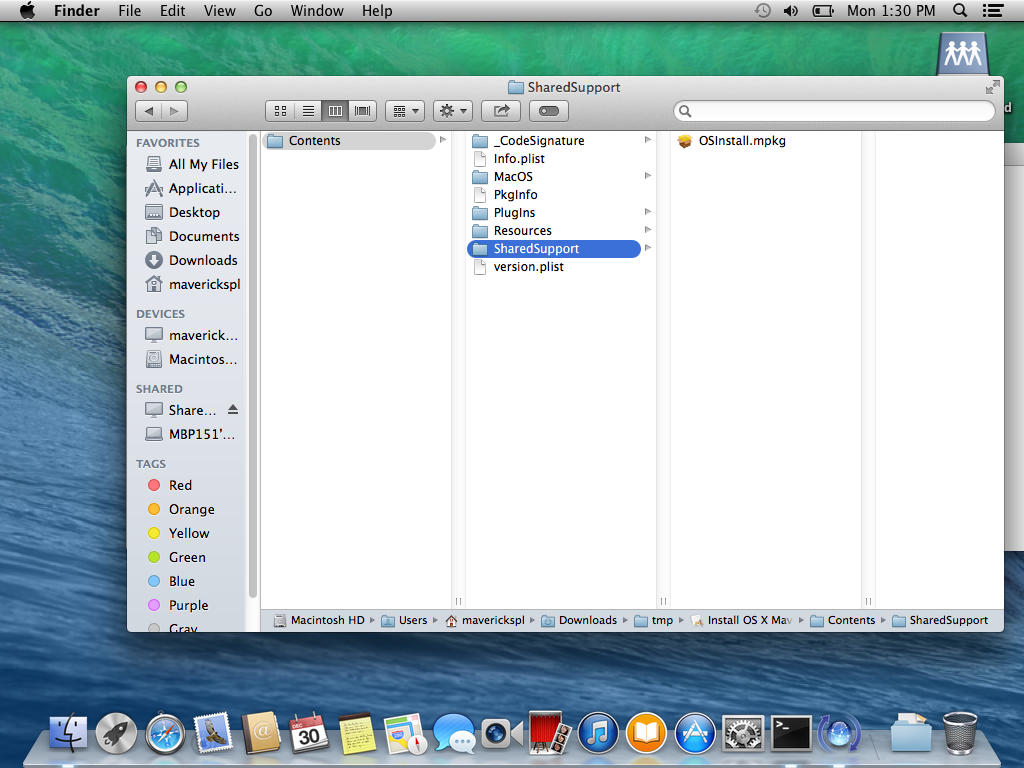

Analysis of the MAS Mavericks macOS installer:
Code:
cd "/Applications/Install OS X Mavericks.app/Contents"
macos:Contents maverickspl$ ls -l
total 0
-rw-r--r--   1 root  wheel  2289 Dec 30 12:49 Info.plist
drwxr-xr-x   3 root  wheel   102 Sep 20  2014 MacOS
-rw-r--r--   1 root  wheel     8 Dec 30 12:49 PkgInfo
drwxr-xr-x   5 root  wheel   170 Sep  8  2014 PlugIns
drwxr-xr-x  60 root  wheel  2040 Sep 20  2014 Resources
drwxr-xr-x   4 root  wheel   136 Dec 30 12:49 SharedSupport
drwxr-xr-x   3 root  wheel   102 Sep  8  2014 _CodeSignature
drwxr-xr-x   3 root  wheel   102 Dec 30 12:49 _MASReceipt
-rw-r--r--   1 root  wheel   532 Dec 30 12:49 version.plist
macos:Contents maverickspl$  cd SharedSupport/
macos:SharedSupport maverickspl$ ls
InstallESD.dmg    OSInstall.mpkg
macos:SharedSupport maverickspl$ file InstallESD.dmg
InstallESD.dmg: xar archive - version 1

Unpack the archive:
Code:
mkdir tmp && cd tmp
xar -xf ../InstallESD.dmg
Find packages:
Code:
find .
./Distribution
./InstallMacOSX.pkg
./InstallMacOSX.pkg/Bom
./InstallMacOSX.pkg/InstallESD.dmg
./InstallMacOSX.pkg/PackageInfo
./InstallMacOSX.pkg/Payload
./InstallMacOSX.pkg/Scripts
./Resources
./Resources/ar.lproj
./Resources/ar.lproj/Localizable.strings
./Resources/ar.lproj/VolumeCheck.strings
./Resources/ca.lproj
./Resources/ca.lproj/Localizable.strings
./Resources/ca.lproj/VolumeCheck.strings
./Resources/cs.lproj
./Resources/cs.lproj/Localizable.strings
./Resources/cs.lproj/VolumeCheck.strings
./Resources/da.lproj
./Resources/da.lproj/Localizable.strings
./Resources/da.lproj/VolumeCheck.strings
./Resources/Dutch.lproj
./Resources/Dutch.lproj/Localizable.strings
./Resources/Dutch.lproj/VolumeCheck.strings
./Resources/el.lproj
./Resources/el.lproj/Localizable.strings
./Resources/el.lproj/VolumeCheck.strings
./Resources/English.lproj
./Resources/English.lproj/Localizable.strings
./Resources/English.lproj/VolumeCheck.strings
./Resources/fi.lproj
./Resources/fi.lproj/Localizable.strings
./Resources/fi.lproj/VolumeCheck.strings
./Resources/French.lproj
./Resources/French.lproj/Localizable.strings
./Resources/French.lproj/VolumeCheck.strings
./Resources/German.lproj
./Resources/German.lproj/Localizable.strings
./Resources/German.lproj/VolumeCheck.strings
./Resources/he.lproj
./Resources/he.lproj/Localizable.strings
./Resources/he.lproj/VolumeCheck.strings
./Resources/hr.lproj
./Resources/hr.lproj/Localizable.strings
./Resources/hr.lproj/VolumeCheck.strings
./Resources/hu.lproj
./Resources/hu.lproj/Localizable.strings
./Resources/hu.lproj/VolumeCheck.strings
./Resources/id.lproj
./Resources/id.lproj/Localizable.strings
./Resources/id.lproj/VolumeCheck.strings
./Resources/Italian.lproj
./Resources/Italian.lproj/Localizable.strings
./Resources/Italian.lproj/VolumeCheck.strings
./Resources/Japanese.lproj
./Resources/Japanese.lproj/Localizable.strings
./Resources/Japanese.lproj/VolumeCheck.strings
./Resources/ko.lproj
./Resources/ko.lproj/Localizable.strings
./Resources/ko.lproj/VolumeCheck.strings
./Resources/ms.lproj
./Resources/ms.lproj/Localizable.strings
./Resources/ms.lproj/VolumeCheck.strings
./Resources/no.lproj
./Resources/no.lproj/Localizable.strings
./Resources/no.lproj/VolumeCheck.strings
./Resources/pl.lproj
./Resources/pl.lproj/Localizable.strings
./Resources/pl.lproj/VolumeCheck.strings
./Resources/pt.lproj
./Resources/pt.lproj/Localizable.strings
./Resources/pt.lproj/VolumeCheck.strings
./Resources/pt_PT.lproj
./Resources/pt_PT.lproj/Localizable.strings
./Resources/pt_PT.lproj/VolumeCheck.strings
./Resources/ro.lproj
./Resources/ro.lproj/Localizable.strings
./Resources/ro.lproj/VolumeCheck.strings
./Resources/ru.lproj
./Resources/ru.lproj/Localizable.strings
./Resources/ru.lproj/VolumeCheck.strings
./Resources/sk.lproj
./Resources/sk.lproj/Localizable.strings
./Resources/sk.lproj/VolumeCheck.strings
./Resources/Spanish.lproj
./Resources/Spanish.lproj/Localizable.strings
./Resources/Spanish.lproj/VolumeCheck.strings
./Resources/sv.lproj
./Resources/sv.lproj/Localizable.strings
./Resources/sv.lproj/VolumeCheck.strings
./Resources/th.lproj
./Resources/th.lproj/Localizable.strings
./Resources/th.lproj/VolumeCheck.strings
./Resources/tr.lproj
./Resources/tr.lproj/Localizable.strings
./Resources/tr.lproj/VolumeCheck.strings
./Resources/uk.lproj
./Resources/uk.lproj/Localizable.strings
./Resources/uk.lproj/VolumeCheck.strings
./Resources/vi.lproj
./Resources/vi.lproj/Localizable.strings
./Resources/vi.lproj/VolumeCheck.strings
./Resources/zh_CN.lproj
./Resources/zh_CN.lproj/Localizable.strings
./Resources/zh_CN.lproj/VolumeCheck.strings
./Resources/zh_TW.lproj
./Resources/zh_TW.lproj/Localizable.strings
./Resources/zh_TW.lproj/VolumeCheck.strings
Code:
cpio -i < ./InstallMacOSX.pkg/Payload
And there you go. Once you copy the InstallESD.dmg to the Shared Support folder you have Install OS X Mavericks.app Created solely from the InstallESD.dmg XAR archive.
Code:
total 0
List the contents:

Code:
Code:
cd tmp/InstallMacOSX.pkg/
macos:InstallMacOSX.pkg maverickspl$ file InstallESD.dmg
InstallESD.dmg: VAX COFF executable not stripped - version 376
DMGs compressed with zlib often incorrectly appear as "VAX COFF", due to the zlib header.
Code:
hdiutil imageinfo InstallESD.dmg | grep Format
Format Description: UDIF read-only compressed (zlib)
Format: UDZO
