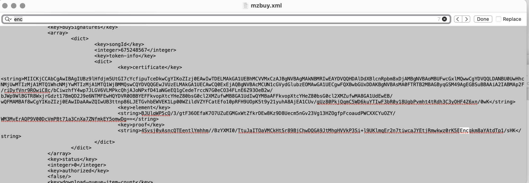

Apologies, I didn't mean to be ignorant, I did not understand it very well. On a different note, I feel that this might be the key to decrypting the app store package, but without an official mzbuy.woa from a mavericks download I can't confirm.
Reactions: Jazzzny
Well, we could try to use the key to decrypt the package and see if the result is valid, right? Do we actually know what encryption scheme is used?
No, but we don't need to. The current issue is that we don't have the MAS Maverick's MZBuy.woa and therefore Maverick's decryption key. This key is just the key of a random app that I was trying to modify the MAS page of to get the MAS to download and decrypt a locally hosted encrypted Mavericks pkg. I initially though the key was in the appstoreagent binary, but it seems to be unique to the app. The only way to get this, however, is by intercepting a MAS Mavericks download with a proxy or mitm. I never purchased Mavericks, so I can't get it.
Side note: Why is it not possible to just recreate the XAR InstallESD.dmg? Sure, the XAR's other files would not be able to be downloaded from Apple but the actual disk image InstallESD.dmg inside the XAR InstallESD.dmg could be downloaded from Apple.

I don’t think you will have great success with the MAS download. You can’t boot it anyway. Maybe in the past, but not anymore without modification.
I mean, if we can get it downloaded and decrypted I don't see why it wouldn't boot using createinstallmedia. The only "modification" required would be changing the date to get around the certificate. Correct me if I'm wrong, though. Even so, I would like to keep exploring this if possible, even if it's just for fun lol.
Date modification was a fix on an early downloads back in 2013-2014. This is not the case anymore for any MAS downloaded installer before HS. These MAS downloads now come with the InstallESD.dmg wrapped in a XAR archive. I am not sure that an installer created after unwrapping the XAR with createinstallmedua will boot with the date change only or even will the createinstallmedia work.
But the pkg is downloaded from apple today and could be decrypted on any OS newer than HS. It would decrypt just like a mavericks download from someone who owned it.
I can download that MAS APP directly from my account and it is not good without heavy modifications. The one being downloaded with the script is similar to what you can get from the recovery partition which is a different animal.
Because the package seemingly needs to be codesigned:
I have attempted the low hanging fruit of prepending a few bytes of data to InstallESD.dmg and updating its footer metadata so the offset would not start at 0 (as well as updating the offset of the XML property list to match). This made the install process progress past the "pkgdmg is missing a footer" step, however it now fails with "pkgdmg is not signed or altered".
...are you saying if I redownload Mavericks from my purchase history today, I'm not getting the same app I would have gotten if I'd downloaded it in 2014? I wasn't aware that Mavericks downloads from purchase history were broken. I have access on my account but I admittedly haven't tried in a long time.
Isn't it just downloading http://osxapps.itunes.apple.com/app...2194ba4d688a/encrypted5063122388219779779.pkg, the same as it always has? If we could just find the encryption key, which I believe is what WatterOtter78 is trying to get, we'd have a download that would work for everyone.
All of this said: to be entirely honest, I don't understand the purpose of this line in inquiry. We are now able to download Mavericks installer images from Apple's official OS recovery server, which anyone can use to install Mavericks on a compatible computer. The installer itself is not bit-for-bit identical with what you would get from the app store, but it is an official Mavericks installer, just for the recovery boot pathway rather than the app store pathway.
