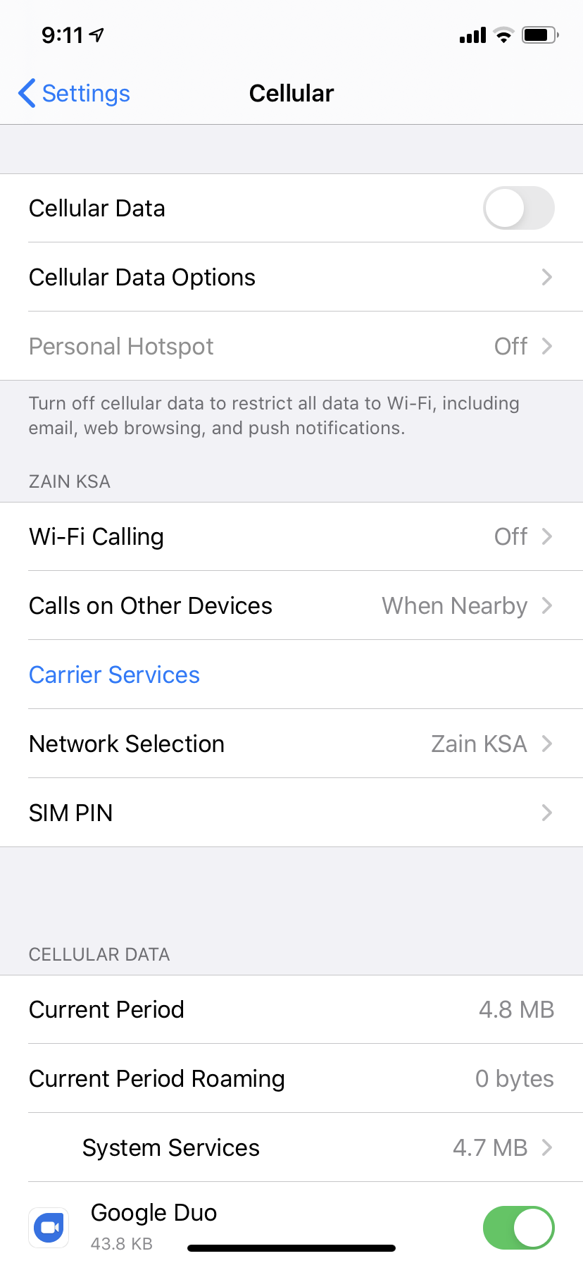

I'm having the same problem.
I can't find the option for Add cellular data plan on my iPhone 11.
It is replacement after my HK iphone stopped working.
Please help.
Thanks in advance.

I am sorry to tell you that nothing helped.
I did a DFU, and set up as a new phone, but still can’t see ADD CELLULAR PLAN.
Apple doesn’t always know the answer to each problem.
In case of the OP it was software. His phone was fine till restored from backup. His new iPhone behaved the same way after restore.
In your case it is hardware.
