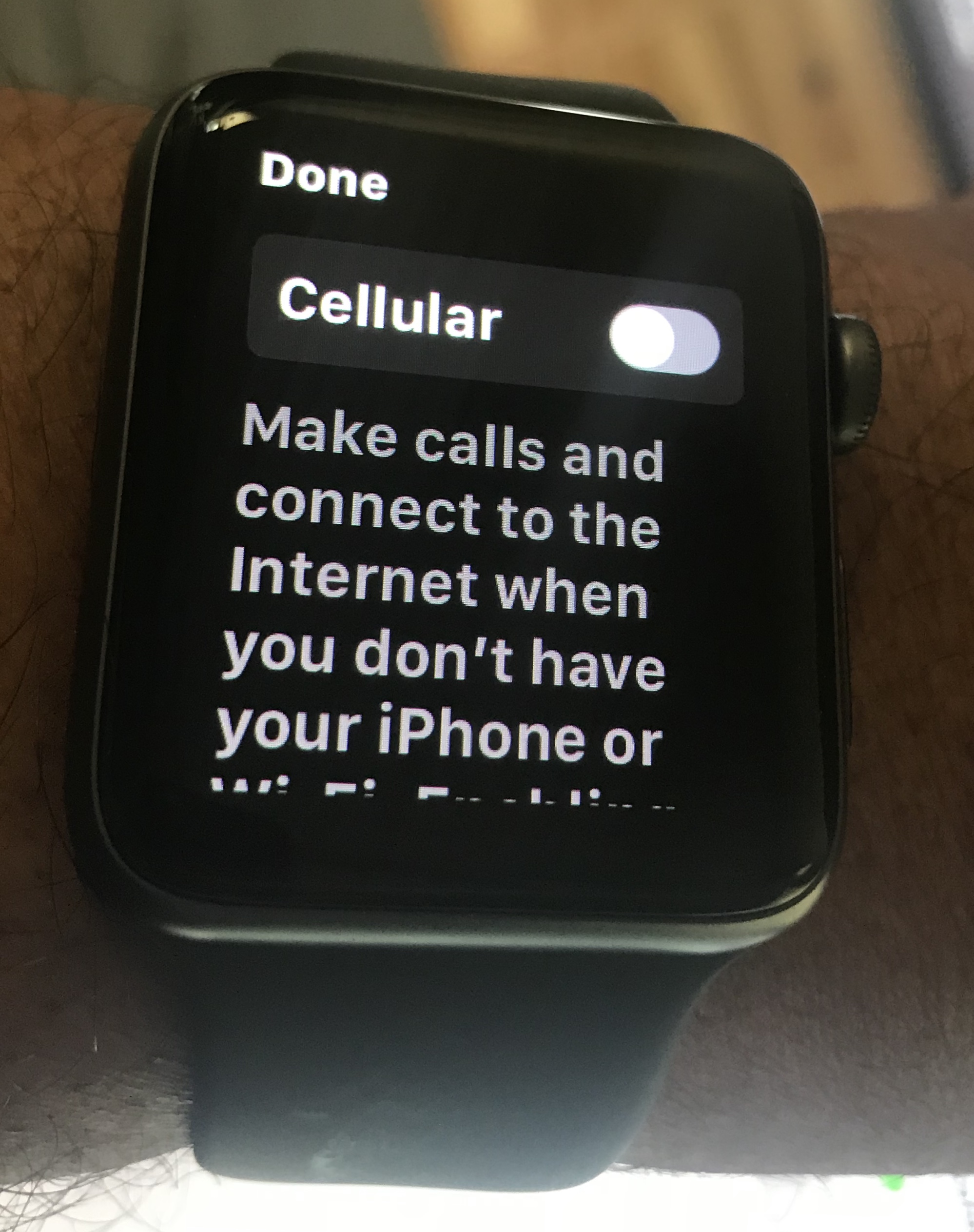

I have AT&T and been reading this thread. My watch is activated and I decided to test whether my watch could do wi-fi calls. So I turned on airplane mode on my iPhone and turned off cellular on my watch. I can't make a call from the watch despite having Wi-fi Calling turned on the iPhone. Here's my issues:
  • I don't have Wi-Fi calling listed in the Watch app, despite having it on my iPhone.
  • In the Phone section in iPhone Settings my watch is not listed under Calls on Other Devices.
  • I can no longer toggle Cellular back on on my watch (see pic) even after rebooting my watch.
What should I do now?

Hey @PTVMan did you setup your Watch as new or did you restore from a backup? Did you power cycle your Watch to see if the Cellular returned to an enabled state?
The "Grayed out" state indicates that Cellular is not "set up". So take a look in the Watch app on your iPhone and let us know if your Cellular plan is listed with an Information icon next to it.
Dave
Dave
Thanks, Dave! I did an unpair, pair as a new watch and the cellular plan with service now work fine. I still don't have Wi-fi calling toggle in the Watch app or my watch listed un Call on Other Devices in iPhone settings.
