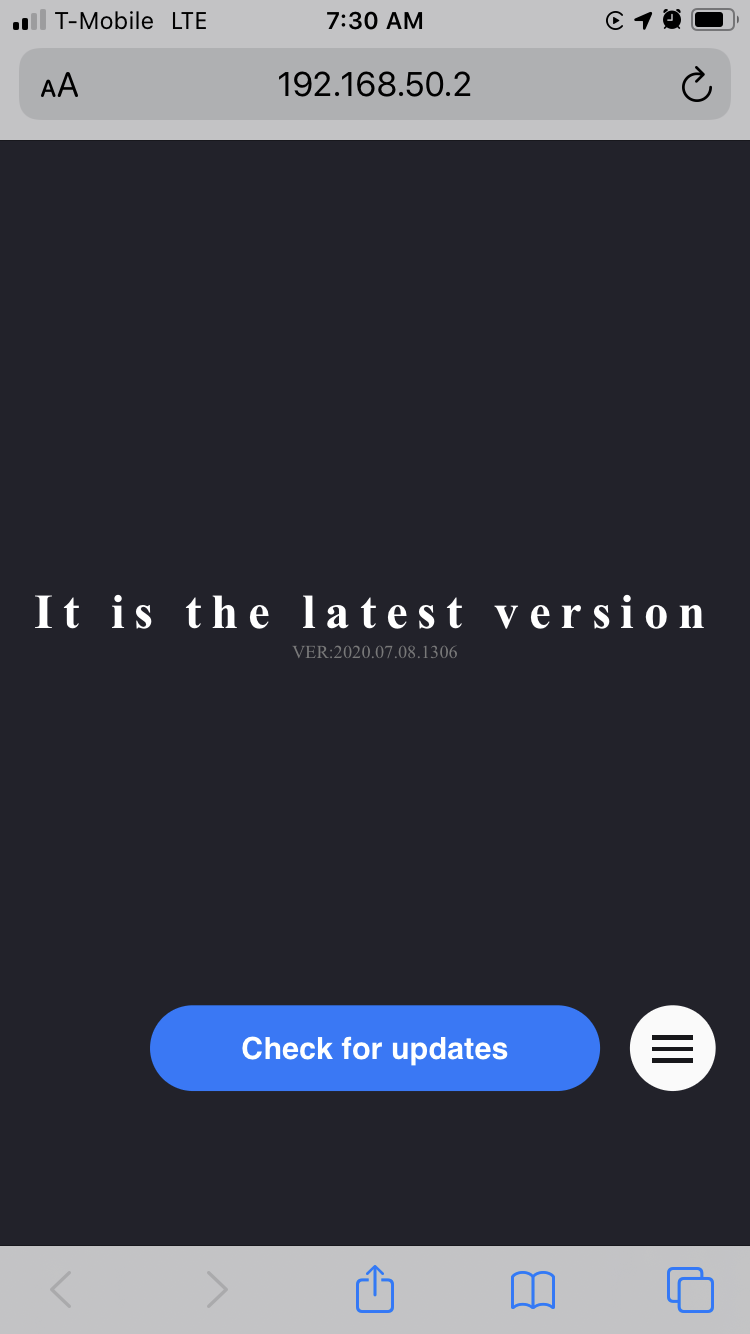

I saw earlier that a July update was released, can anyone confirm if this is available OTA? I don't want to go dig my unit out if it's not available OTA yet.
Have you flashed this yet via USB? What version does it report? Work ok?
He did. (Denali did too.) It's in his screenshot: 2020.07.08.1306. Evidently it works, but doesn't resolve the 5min audio glitch.
NOT available OTA. Just a daily build; flash at your own risk!
You can always check this URL to see if a release has gone officially OTA:
OTA - JSON LINK
If "filePath" is incomplete and "fileSize" is zero, they did not post an OTA version.
