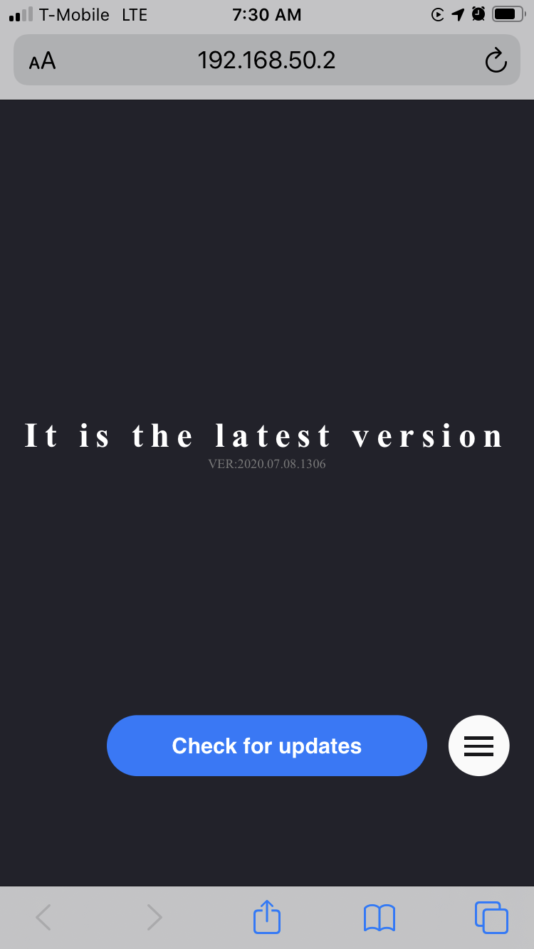

New update posted today.
It is 6.3mb this time and brings the version up to 2020.07.08.1306.
I only did a test install to see if it was a full image or not, have not played around with it yet. Going back to sleep now.

New update posted today @ http://112.74.112.110/download/2020-07-08/U2W_Update.img

I have attached the new firmware update.
  • 2020.07.08.zip
So I just updated my Carlinkit USB-c from 6-19-20 to 7-8-20 and the 5-6 minute audio issue is still there for GM trucks.
