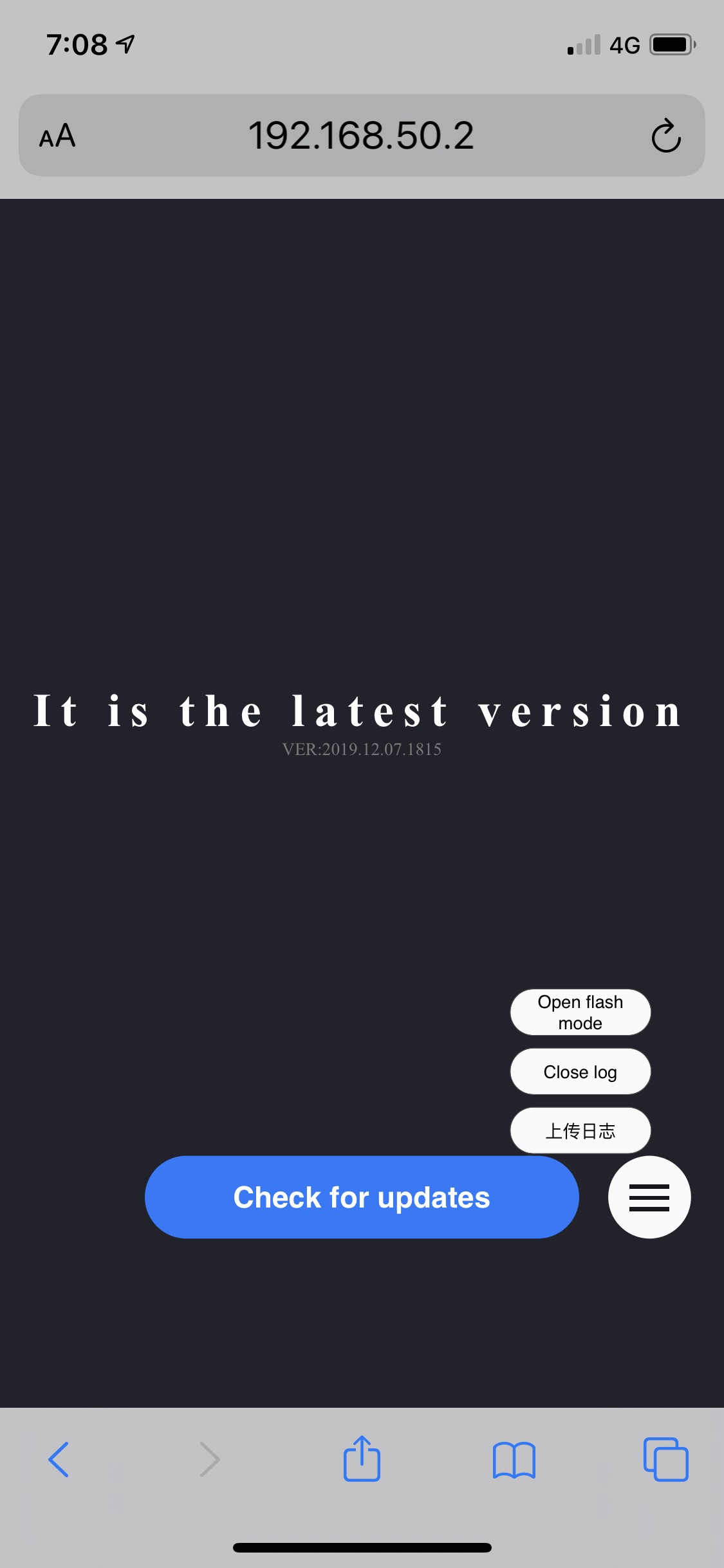

There was some more messing around with the connection to wifi - and for some reason it seems to connect, but doesn't actually appear to be connected as far as the iPhone is concerned (4G icon is still present, with no indication of Wifi) but on the off chance I tried to connect to 192.168.50.2 and it connected, and told me that it as activated and up-to-date. Rebooted, connected again via Bluetooth (nice that it's now an AudiXXXXX bluetooth name and an AudiXXXXX wifi name).

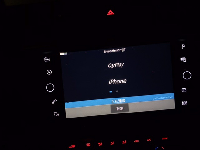

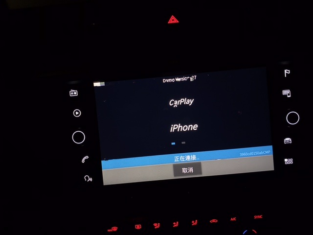

I get this screen and audio is playing through system when I start something like spotify of my phone.. screen is just like before update a bit garbage / not updating at all.

Hmmmm...so as mentioned I download the carlinkit fir,ware from above but it didn’t do anything. Plugged it into car and still 07 version with no update available. However....demo mode still shows as 0, but I don’t have to activate it every time now. I might try forget WiFi Bluetooth trick, and see what happens
Well I just went back after a while and the screen comes up saying looking for device. I was able to unplug the adapter in and reconnect it and it did connect to the phone. But if I have to do this each time I may as well just plug in the phone.

I’m not seeing a check for upgrade screen or is that from the phone interface in safari?
Once it’s booted and connected just go to 192.168.50.2 on your iPhone. That’s where the check for updates button is.
It just says its the latest.
