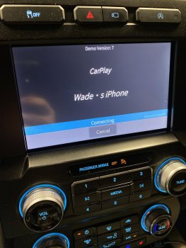

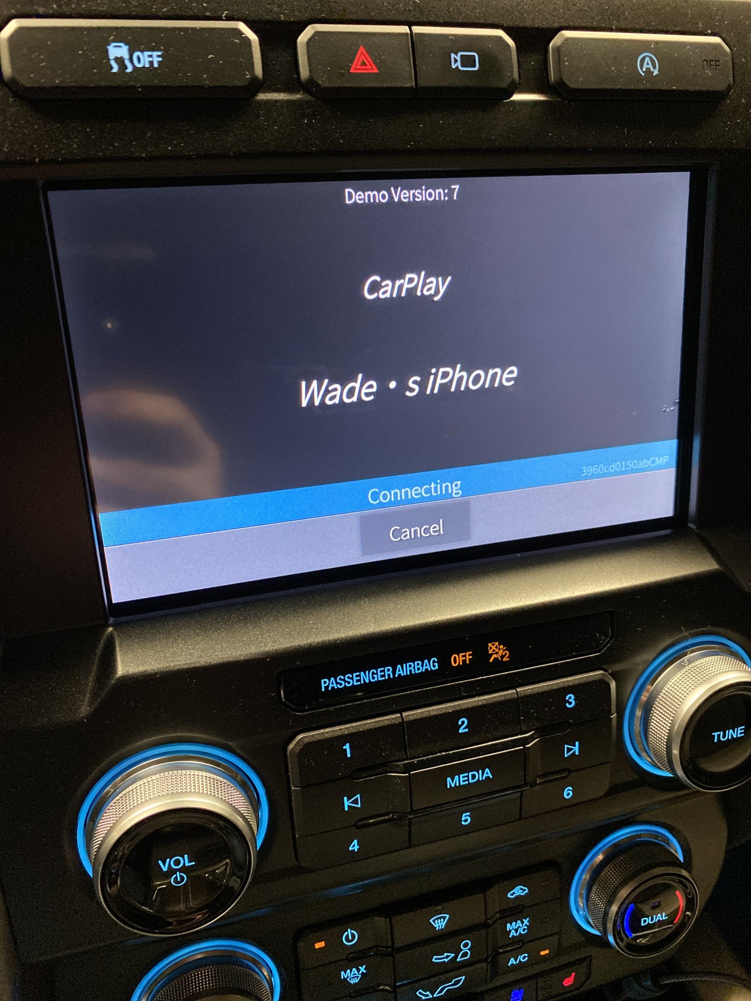

Anyone had luck getting past this screen with the new firmware? I’ve tried repairing every way I can possibly find. Audio streaming will work fine but screen just stays on this.

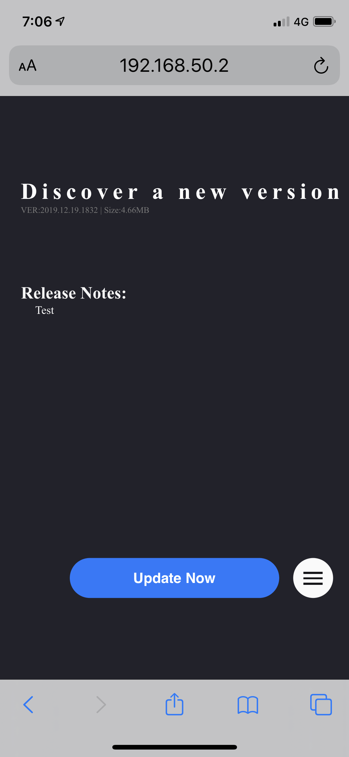

Just tried the server this morning and there is a new update. Release note says Test but it installed ok. When I refreshed the server screen it still came up the same but the unit boots fine and there is no longer a demo counter.
Does anyone know how to switch "Mode" on the new firmware? Mine connects ok, but the screen is pixelated the same way it was until I switched to Mode 3 on the old firmware.
Yes....same for me. I installed the update and no more demo. Back to working 100%
However, if you visit 192.168.50.2, it permanently now says there is a new version even though its the same one you installed, but I dont care. My dongle is back to working 100% again. YAY
In one of the Seat LEON's I have access to, it did this....I turned the screen off at the power button, and when I turned it back on again, the screen painted and worked. Only in the LEON though, tried it in an Ibiza and it still didnt work.
