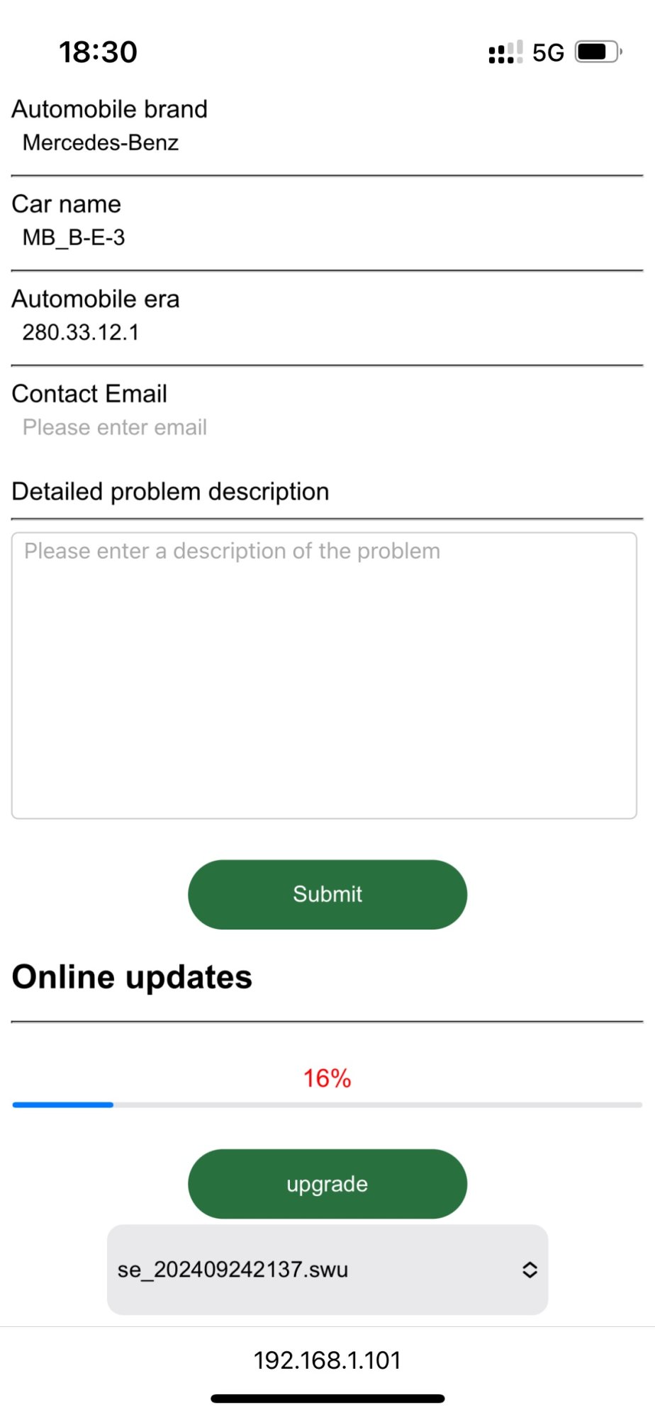

To update the FW, I had to try multiple times. A bit annoying but I can deal with it because it’s been the most stable dongle for me so far.

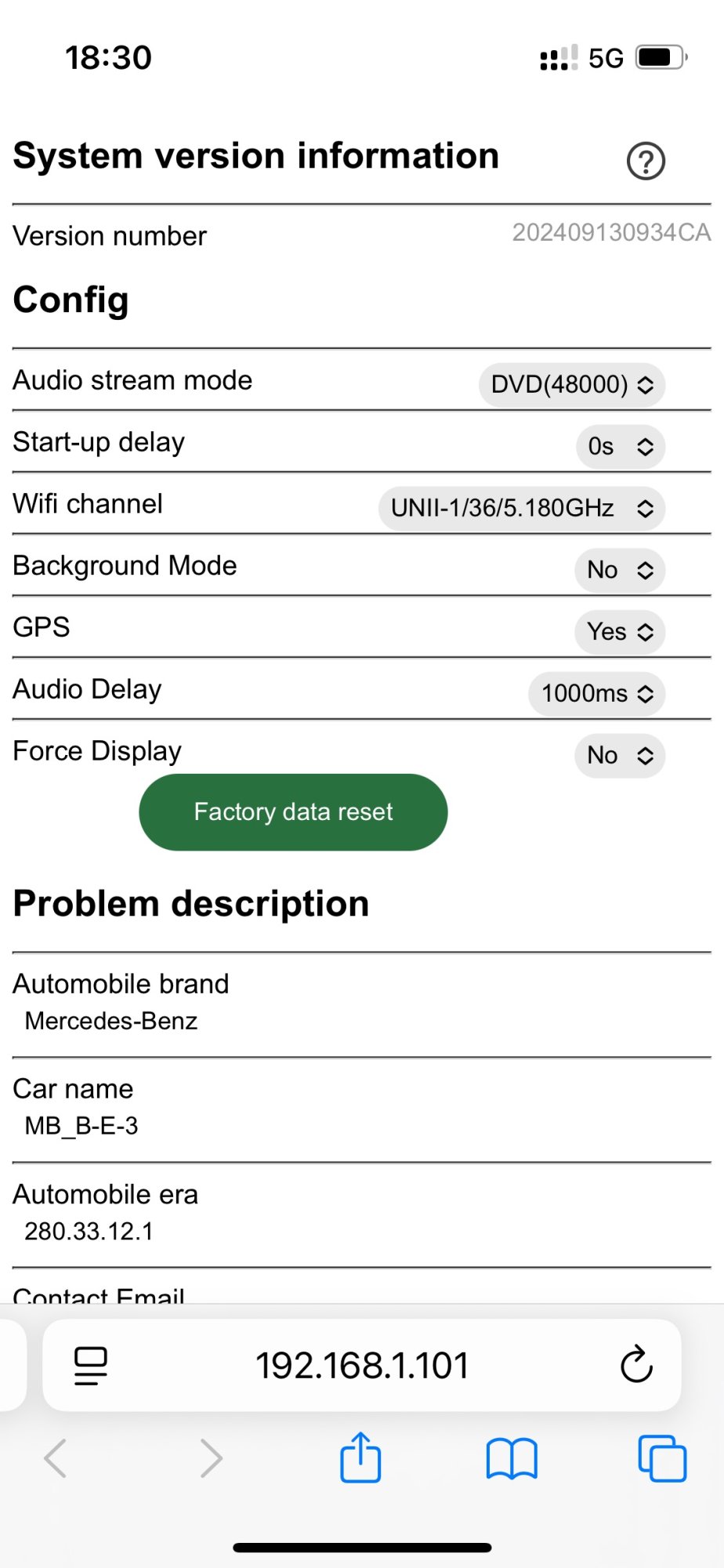

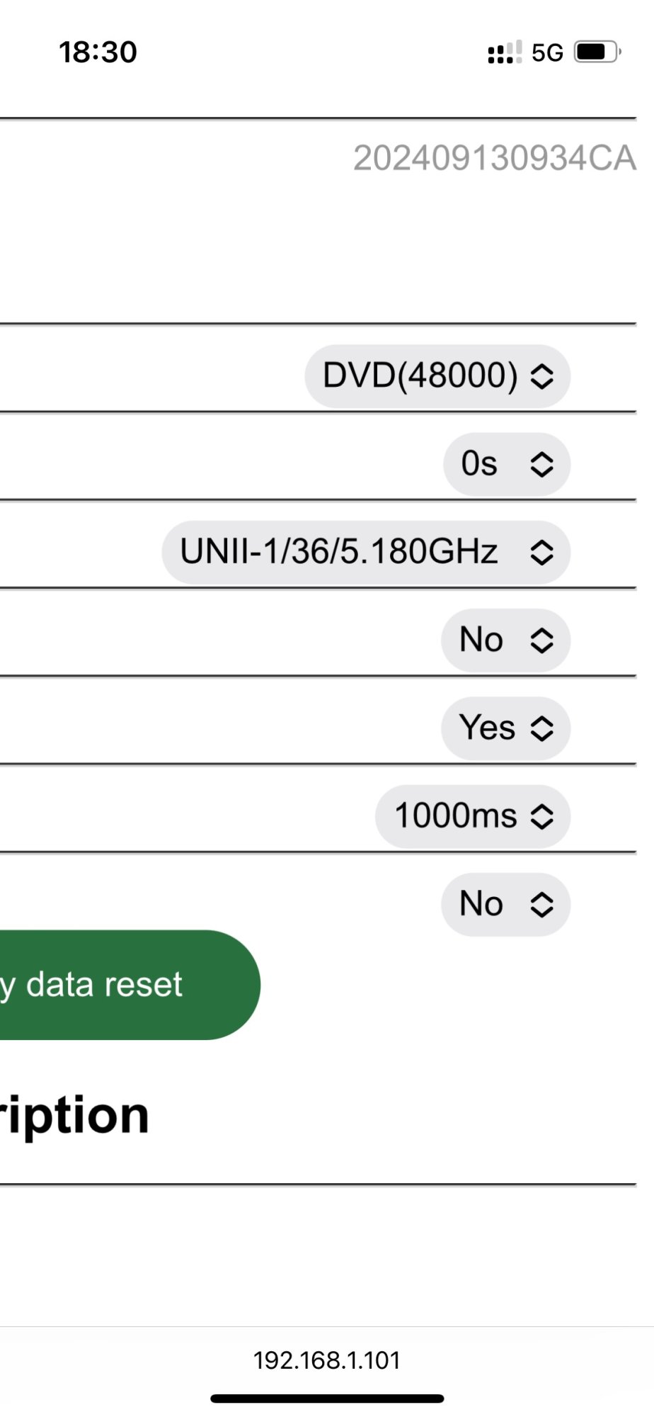

The darnedest thing... I can connect to 192.168.1.101 despite only seeing the IPV6 address. Interface was nicely in English and with an update available. Past tense because I updated and now it is in Chinese 😂\
I attach some screenshots before I updated.
A couple of notes:
  • The wifi channels listed are only 5GHz
  • The default setting Background: Off switched to On in the updated firmware.
  • The selector for firmware version to update does not list a previous version once updated, at least not this time.
  • Performance has been very good for the couple of short runs that I made today.

View attachment 2443274View attachment 2443276View attachment 2443277
If you power cycle and go to the web interface again, it should be in English again? I have audio delay set to 500ms and both background mode and force display set to yet. Haven't messed with the wifi channel much.

Power cycle does indeed work. A side discovery that I have not timed: I have the impression that if you wait too long after booting up the web interface no longer responds: browsing to 192.168.1.101 just hangs as has been described higher up this thread.

Sometimes I can’t time it right and by the time I get to the web interface, it’s already in Chinese and unresponsive. Kinda annoying. Not sure what causes it but a fix would be nice.

In my experience, the web interface is accesible as soon as I see the CarPlay screen (home menu) in the infotainment. You prob have about a minute to use the interface before it becomes unusable. It may even be less.

Edit: I chatted with them via WhatsApp. Apparently the latest firmware version fixes the web interface behavior. It should be uploaded to their server by tomorrow.

The latest FW seems to fix the odd web interface behavior.
To update, I plugged in the adapter to a wall adapter (not sure if the power source matters), I then connected to the adapter’s WiFi network and went to the web interface as soon as the adapter’s green LED started blinking and then began the update.
The first time I tried updating it, I had waited too long to go to the web interface so the update failed. You get a message about it. I think it failed at 2%. I then power cycled the adapter and was able to update on the 2nd try. You have to get to the web interface as soon as possible.
