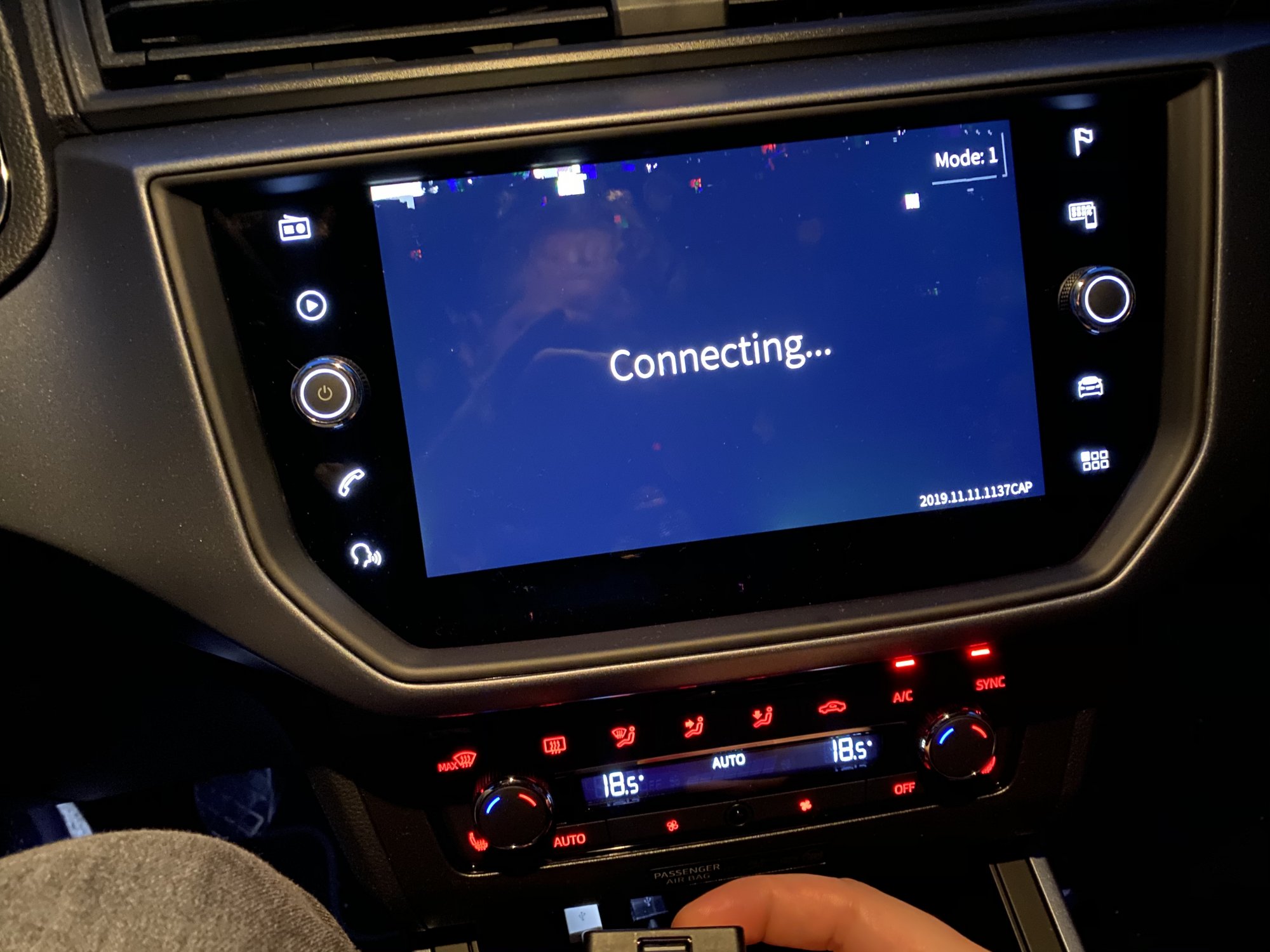

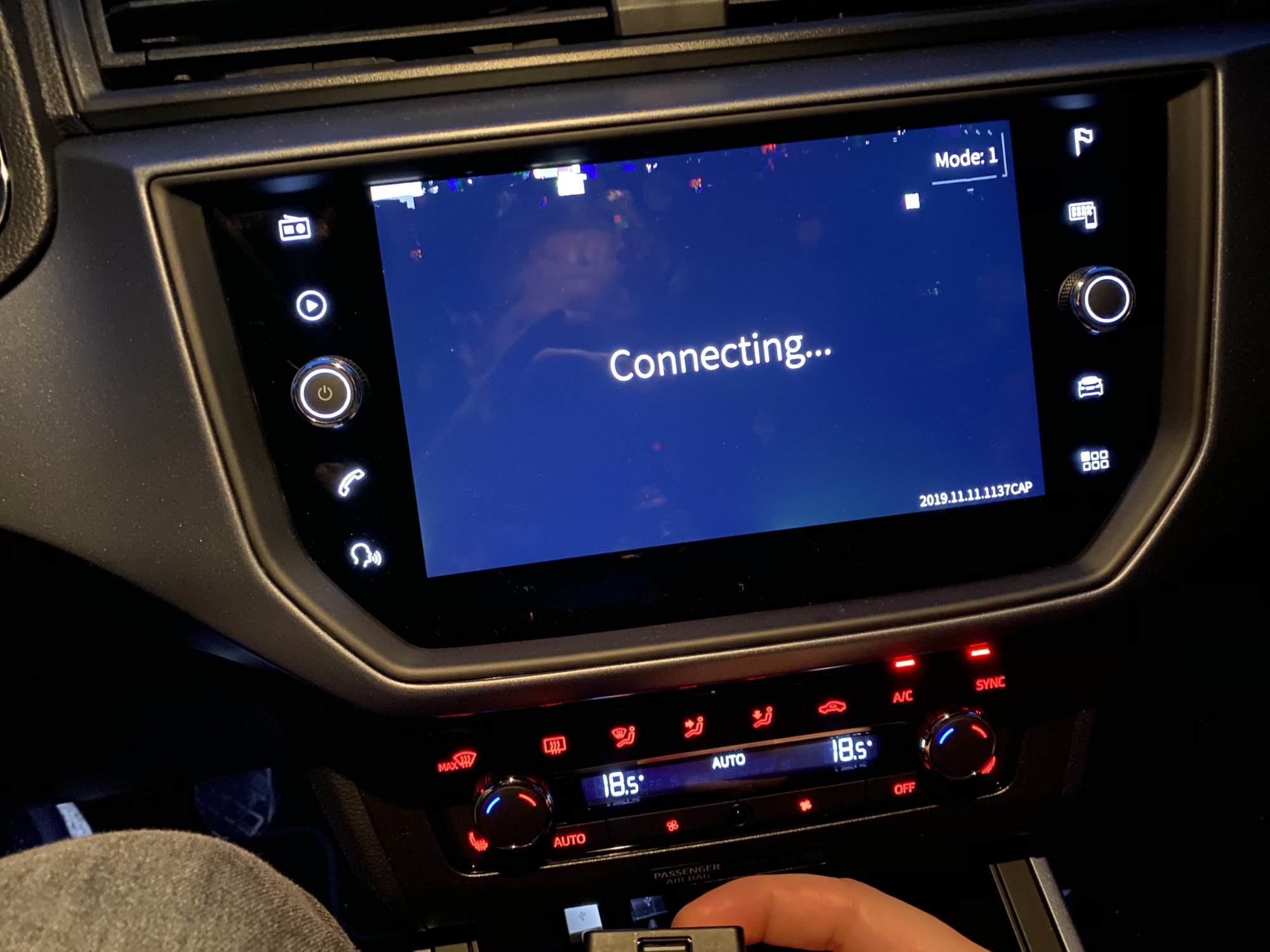

I'am using a 2019 Seat Arona. Carplay2air isn't working for me. Somehow it can connect but on the screen I see nothing / only some garbage and it keeps saying 'connecting'.
Somehow sound is working / I can play for example spotify and then music is going through my car speakers but nothing more is working.
I tried all modes / reconnects / reboots everything but it always is the same.
Tried contacting the seller and after 2 mails he stopped answering.
Change your mode to 3.
Tried that already.. nothing changed? did reboot everything tried multiple reconnects in mode 3.. (all modes btw) but I cannot get it to work.
Undo everything. Remove the CarPlay setting in settings on iPhone. Remove the Bluetooth. Reboot phone. Unplug dongle.
Plug dongle back in. Attempt to connect to Bt. Make sure to change it to mode 3 right away. Once connected don’t touch anything on the screen or phone for up to 45 seconds.
