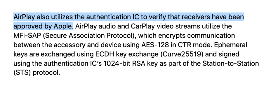

The few aftermarket head units I found on Crutchfield say 1.5amp is the Android Auto Android device and Apple CarPlay iPhone devices max charge rate. There will be loss through a Lightning Cable but in a perfect world that is around 7.5watt charging maximum.
Apple also uses a authentication IC (lockout chip) for CarPlay...

https://www.apple.com/business/docs/site/iOS_Security_Guide.pdf
That is probably the "proprietary chip" CarPlay2Air mentions on their webpage.

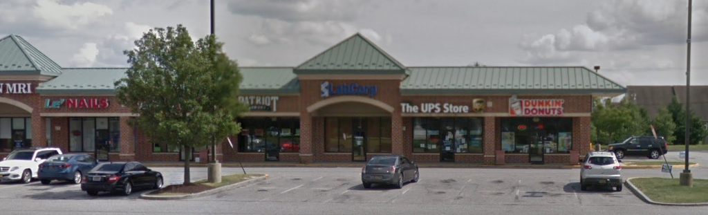

What should be most concerning is looking up their address. This is sketchy foreign businesses operate to fly under the radar. They can literally turn off their entire business and its gone without a trace.
364 E Main Street, Suite 1012, Middletown, DE 19709
If you Google maps that its a UPS Store...
They have a lot of online fronts I could probably keep finding for days upon days. This is a few results Google the address...Maybe they are working out the back of that Dunkin Donuts?

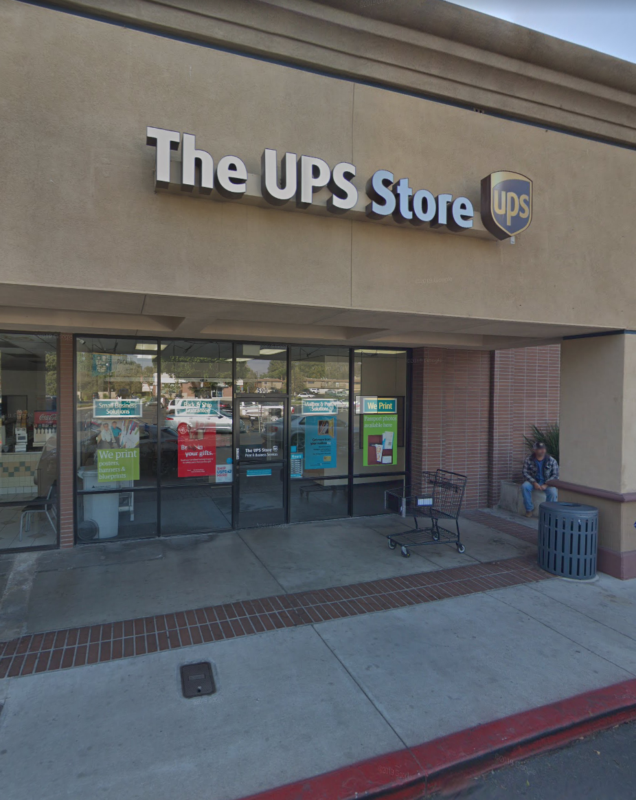

If you Google SF Finances phone number you get Light Speed Motors at 590 W Main St Santa Paula CA which is to no ones surprise......... another UPS store....

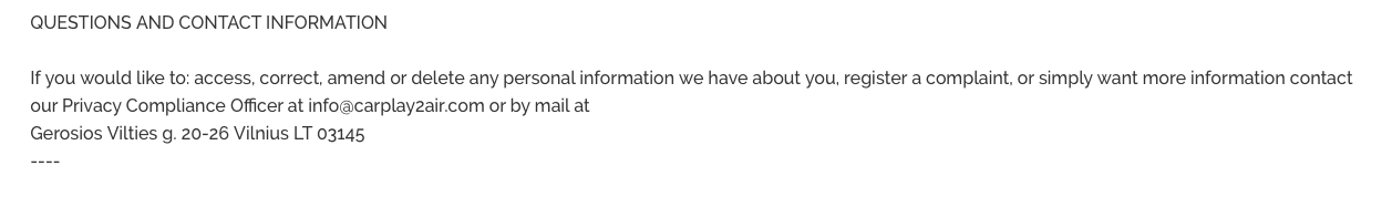

I guess if you do have a problem you can contact the Gerosios Vilties (Good Hope) residential apartment building in Lithuania.

I'm disappointed there isn't a UPS Store sign out front...

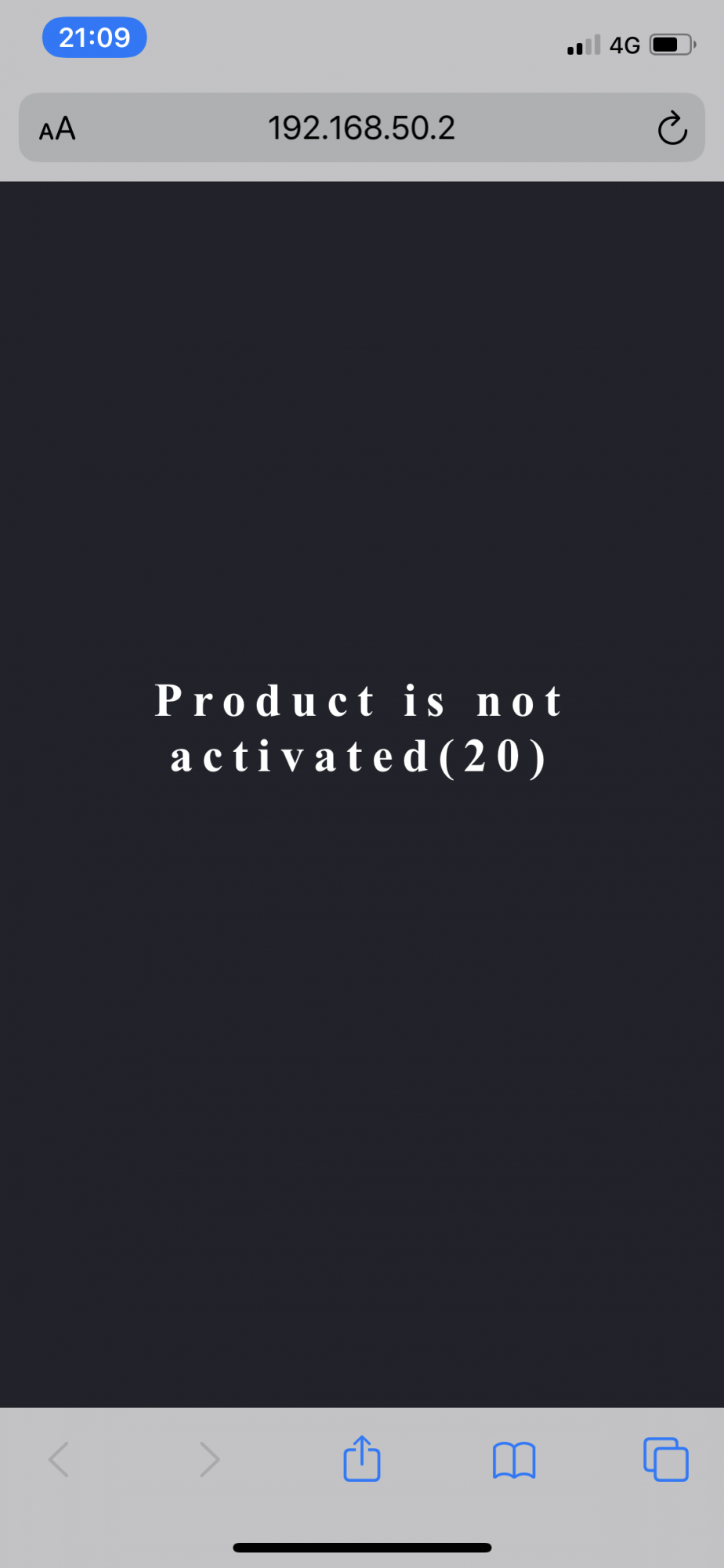

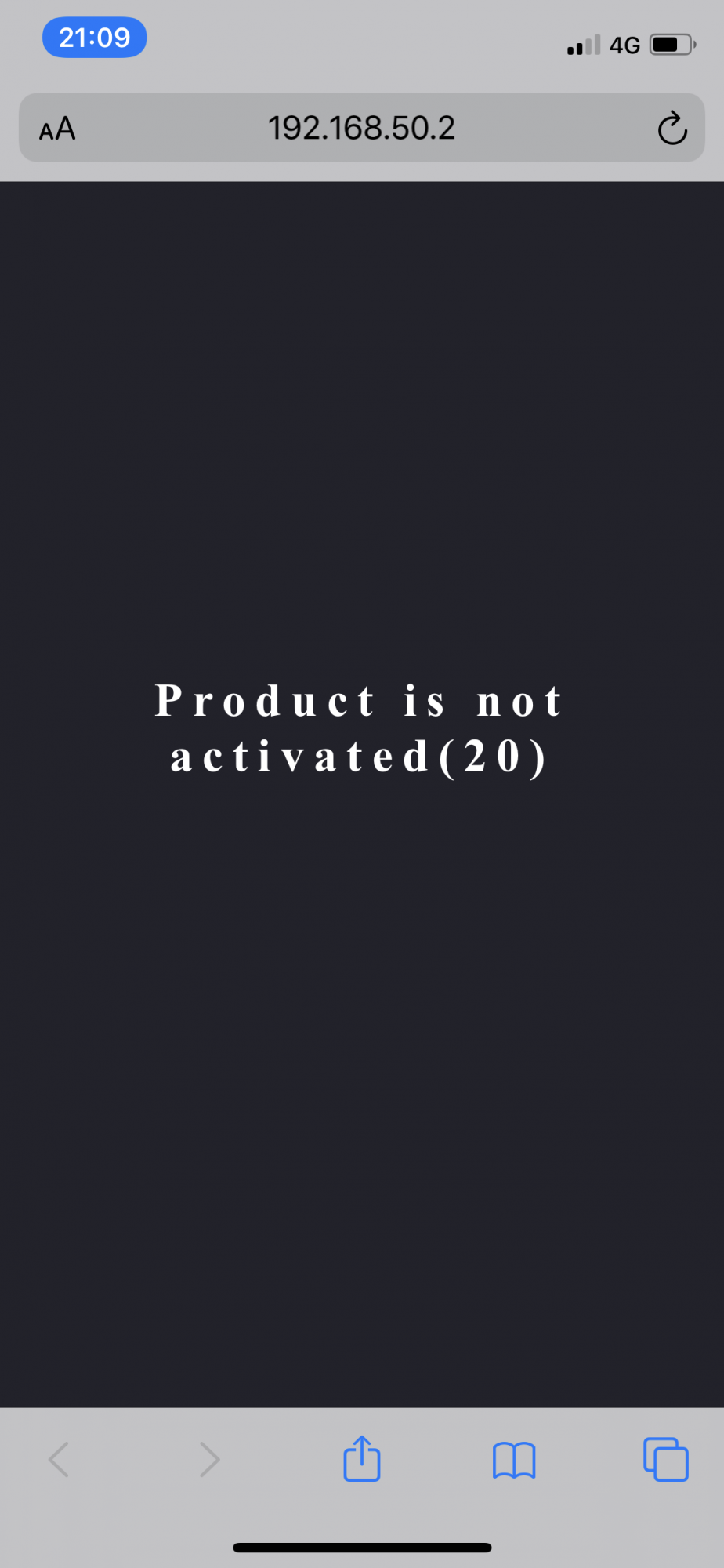

I cannot get past the 'product is not activated' screen on my iPhone. So I did the update via USB stick.. then I go to my car and there it says I have to connect to wifi and scan the QR code.. after that all I get is a black screen with 'product not activated'
Anybody know what the problem is?
