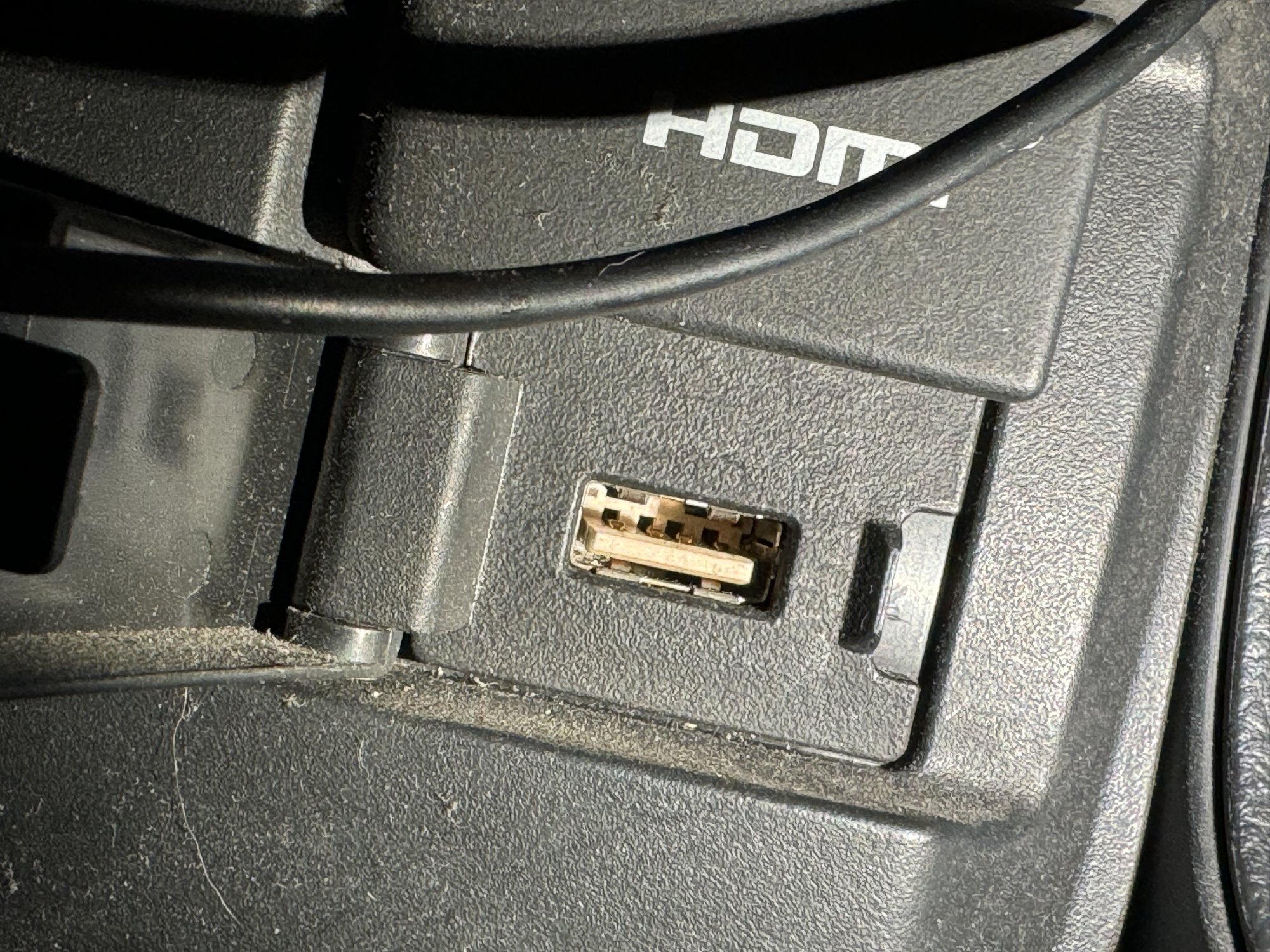

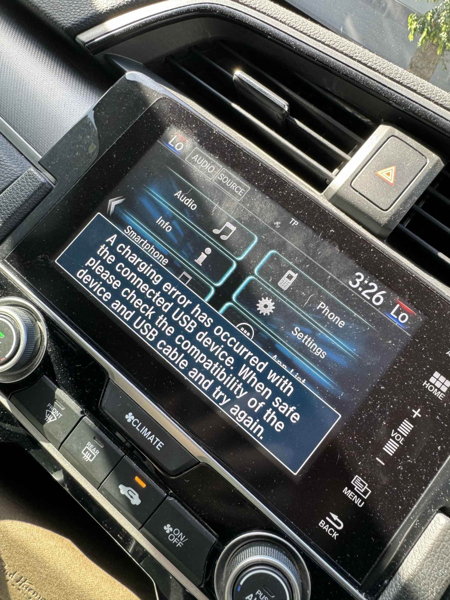

I'm facing a problem that I'm no longer able to use Carplay and Android Auto. I'm using iPhone 15 Pro Max 17.0.2 since I first got it. I connected the phone to the car with the same USB C to A cable I have been using for 2-3 years. Initially it worked and able to get Carplay working for like 3 different days. But now it constantly says
"A charging error has occurred with the connect USB device. When safe please check the compatibility of the device and USB cable and try again"
whenever I connect the cable. It shows charging status for 5 seconds and than disconnects with the above message pop up and constantly on loop cycle while connected.
So I tried using the official cable that came in the box and since its C to C, needed an adapter to convert to A. But even with an adapter, this still didn't fix the problem. So I tried another 3 different C to C cable (iPad pro cable, USB C 3.1, thunderbolt 3). All of which didn't work.
So I thought, it might be the adapter that might be causing this to not work. So I decided to boot up the android phone that I have been using for the past 2-3 year using Android auto. Tried connecting using the original cable and now Android Auto is no longer connecting. I have tried all the other cables and all the same result. What ever apple did has seem to corrupted my infotainment or at least the port. The port itself doesn't appear to be damaged nor the cables.

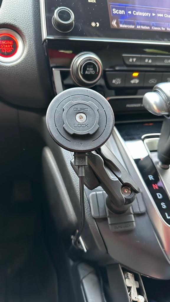

This probably isn’t going to be a popular reply, but I’m a fan of the QuadLock line of products.
I have the QL Mag case, wireless charging head and mount, and wireless CarPlay adapter in 2018 and 2019 Honda CRV’s. It solves the 3 issues:
Wireless CarPlay
Wireless charging
Magnetic mount
I have it mounted next to the shifter as it keeps it low and out of the way but also easy to place when I get in and out of the car.
Yes, there are definitely less expensive products out there, but I’ve been using QL for years and never had any issues.
